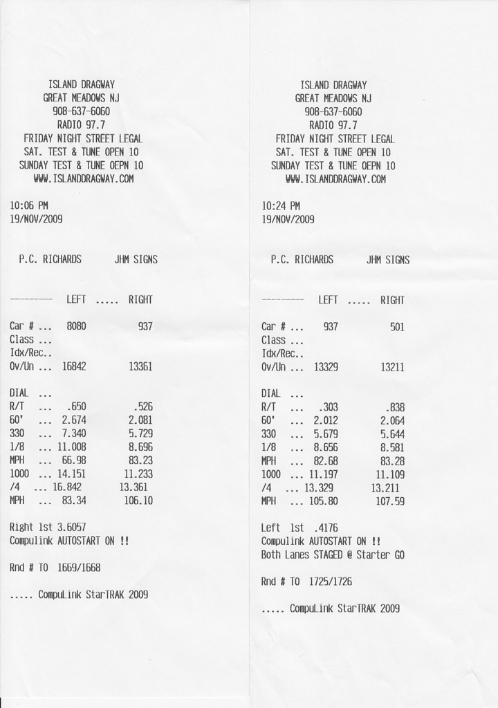

I went out to Island Dragway tonight for the last Friday Night Street Legals. I made back to back 13.3 passes.
I still haven't been able to get the 1.8-1.9 second 60' times other Mustang owners got on stock tires. Maybe its just the track prep at Island Dragway. With a 1.8-1.9 second 60' times the car should run 12.9-13.1. I'll have to wait for next season and passes at a different track for that I guess.
My Konis are still on backorder. The ship date keeps getting pushed back. First it was August, then September, then October. Koni North America recently said mid December to late December until they get them. Then they have to ship them to me.

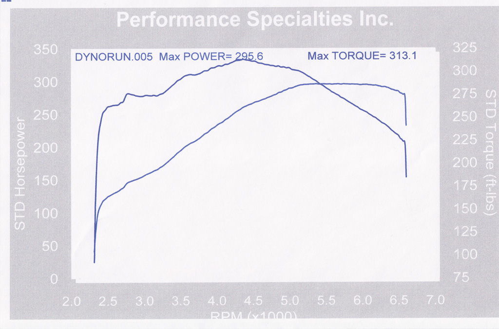

I finally got around to dynoing the car after I put on the Steeda intake and Steeda 91 octane Cali Emissions tune. It gained gained 15 HP and 18 lb-ft of torque peak at the wheels from just an intake and a tune. The stock programming is for 87 octane gasoline and California emissions. Both dyno pulls were done on the same dyno with 10% ethanol gas from the same gas station.
With the intake and tune, it makes more torque at the wheels from 3700 RPM to 5300 RPM than it did at the peak stock and it makes more power from 4800 RPM to 6400 RPM than it did at the peak stock. THe maximum horsepower gain was 20 HP at 6000 RPM and the maximum torque gain was 19 lb-ft at 4700 RPM
Top is stock dyno bottom intake and tune dyno.
Sorry about the crappy print quality. The shop needs to clean the heads on its printer.

Nice pick up dude! You gotta get those headers on.

It really doesn't matter much. HP and Torque only cross at 5252 because the formula used to calculate HP from torque uses 5252. It makes it easier to see small changes in both HP and torque if they do the auto scaling.

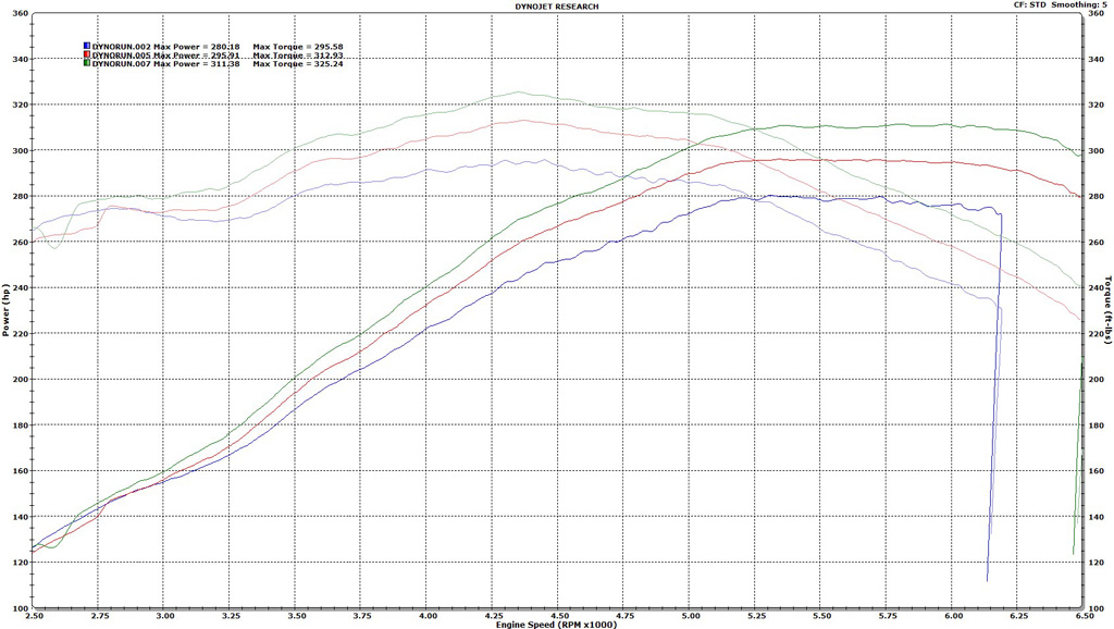

I installed the Kooks long tube headers, high flow cats, and H pipe on Feb. 28th with the help of a friend. The car isn't much louder at idle, but definitely is louder and has a different tone at full throttle.
I dynoed the car this afternoon. Stock it made 279.9 HP and 295.5 ft-lbs at the rear wheels. With the Steeda CAI and Cali emissions tune for the CAI, it made 295.6 HP and 313.1 ft-lbs at the rear wheels. With the headers installed and the same 91 octane Cali Emission tune, it made 311.3 HP and 325.2 ft-lbs at the rear wheels. The A/F ratio was nearly perfect from 3500 RPM to 6500 RPM. I have a 93 octane 49 state tune that I haven't installed yet. It should get me a few more horsepower at the rear wheels.
The peak numbers don't tell everything. The area under the curve is much greater. Also, now the car makes more horsepower form 4600 RPM to the rev limiter than it made at the peak when it was stock. It makes more torque from 3500 RPM to 5500 RPM than it made at the peak when it was stock. After the headers and intake, when compared to stock, the greatest HP gains were an additional 37 HP at 6100 RPM and 31 ft-lbs at 6100 RPM. When the car was stock I only wound it out to 6100 RPM on the dyno. Now it pulls well to 6500 RPM+.
The shop's printer is low on one color ink, so the printout of the dyno doesn't look great. I got a copy of the dyno runs on floppy(yes 3.5" floppy disk. The dyno computer is running Windows 95 ) and used Dynojet's WinPep software to make a screen capture comparing my results. The blue line is stock, the red line is with the intake, and the green line is with the headers.

Great results Chris! The graph looks excellent, broad gains over the entire band.

I'm suprised to see uncorrected numbers, been a long time. so corrected stock 268.61, modded 299.34.. lil more realistic but certainly respectable...love the car and wish i had it

They aren't uncorrected, they are Standard corrected. There is actually a long story about how the Standard correction for Dynojets came about involving a popular 1980's motorcycle. Going with SAE corrected its around 273 HP stock and 303 HP modified. Uncorrected results were even higher than the STD correction. Uncorrected with just the intake and tune was over 300 at the wheels.
