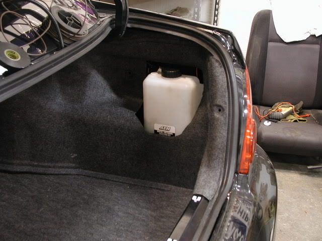

super shweet. perfect numbers on pump.
meth added into the mix should get around 430+...super awesome.

some more pics.
