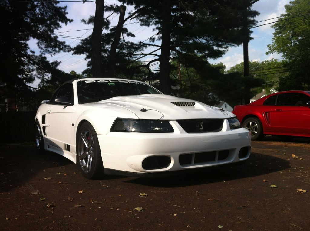

Yea dude a lot of these cars are really slow and cheap, lots of wide body and mexiflush but I'm learning a lot of good bondo work so that's a plus.....
But on a serious note that white terminator is stupid fast, can't remember the dyno numbers, but driving in it with my boss to get gas and meet our emissions guy was a crazy experience, never thought I'd love a mustang

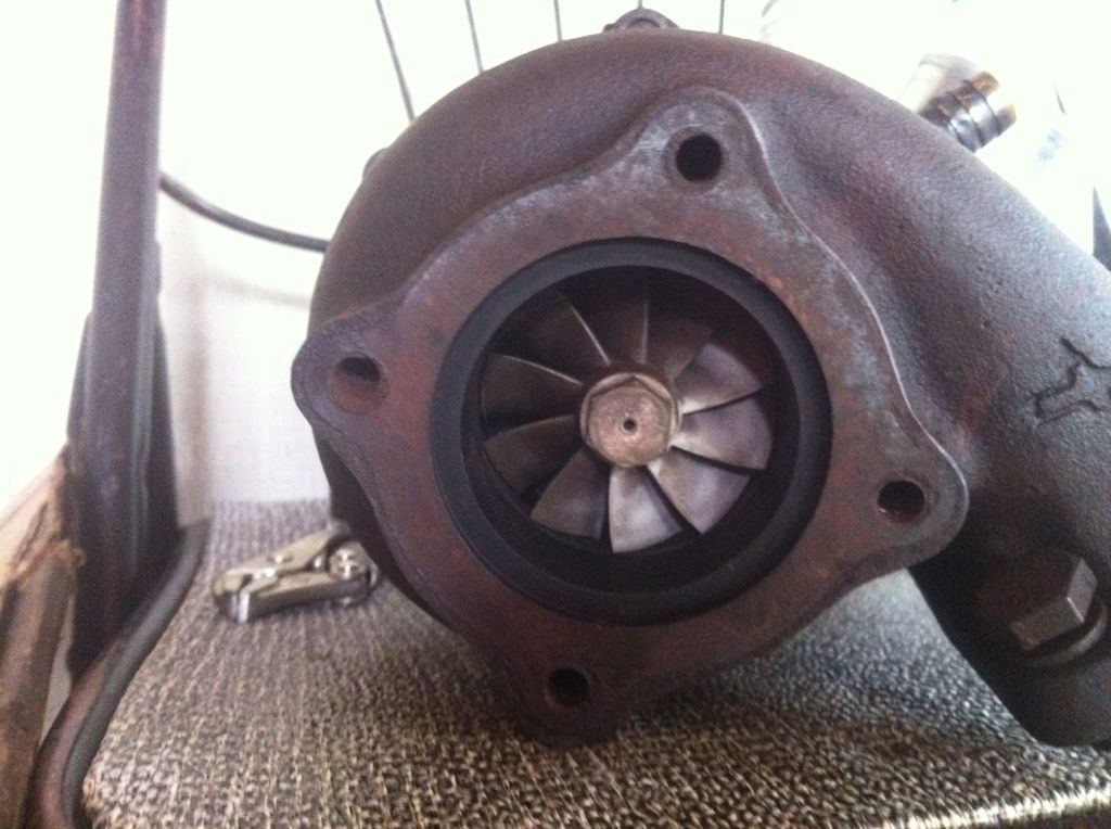

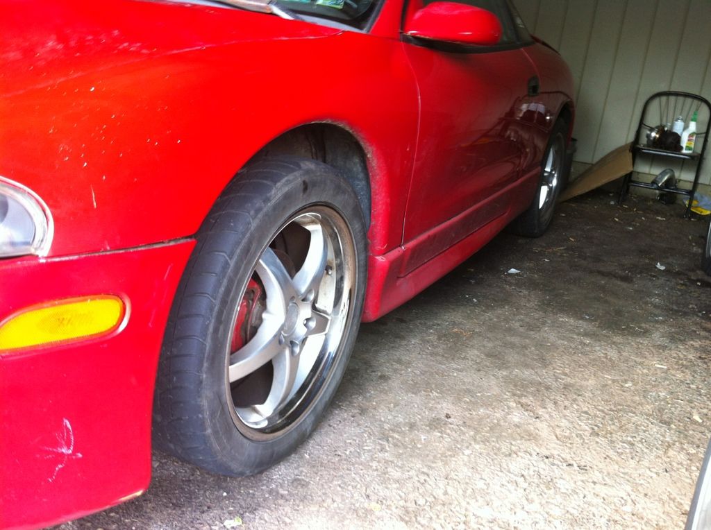

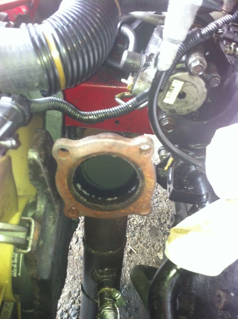

Oh yah update on the eclipse
Typically I love shaft play when it's from my bitches, but this shaft play was a bitch, it's a turbonetics t3 so the down pipe is a four bolt flange but I'm finding it impossible to find a t3 turbo for less then $600 so I'm goin to up grade to a t3/t4 down pipe but this being me first turbo car, will I have to change anything else to run a t3/t4?
By the way its actually my brothers car but he's not very mechanically inclined but he wanted to learn so I'm walking him through everything i have been doing, oh it's got cool wheels too guys! Their made by Voxx
And one more for fun
T3/t4 is a loose expression to describe a t3 flange turbine housing with a rough sculpture of a t4 compressor housing. It's more directed at marketing a turbo rather than performance specs. What counts is how the turbo is cooled, area over radius and what bearing system it utilizes.
As for the downpipe, t3/t4 downpipes don't exist. You've got a open selection to choose from DEPENDING on your turbine housing. 4 bolt turbine housing = 4 bolt downpipe...5 bolt turbine housing = 5 bolt downpipe (sometimes ford style watch out!)
Another tip. When choosing a turbo, make sure the wastegate set up is what you want. Internal or External. If you are currently Externally gated and end up purchasing a internally gated turbo you would have to weld the wastegate chamber shut.
+1
+1
It's oil cooled, external waste gate, so the real problem is I'm having trouble finding a t3 with a 4. Bolt compressor housing I don't know if pictures will help but this is what I'm working with

Old 07-29-2012, 06:00 PM   #32
Twisted tuning
Former Vendor
Join Date: Jul 2011
Member #21378
Call arizona tractor and turbo supply. They will upgrade and rebuild the one you have. Tell them your setup and hp goals. They rebuilt a turbo for a cobalt for a customer for 250.
Twisted tuning is offline   Reply With Quote
