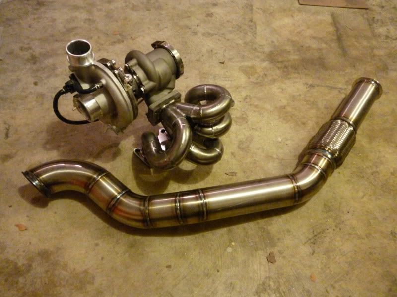

Theres another system coming early next year that I might wait for using the EFR 6258
Apparently going to have quicker spool than a gt2554, same power capability or more than a GT2871.

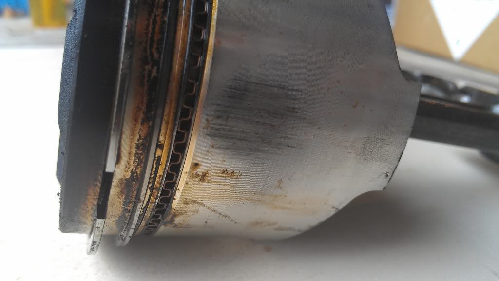

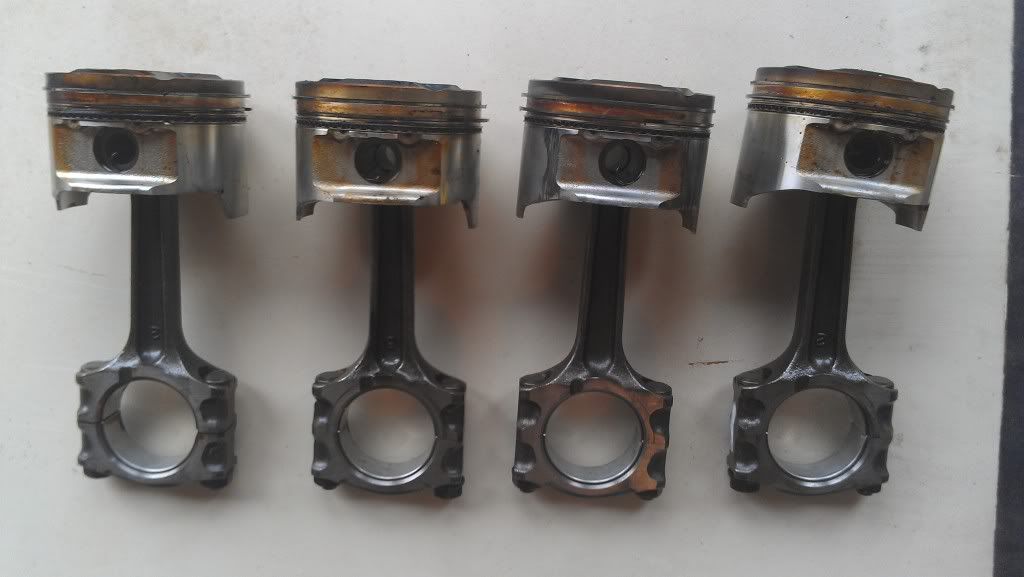

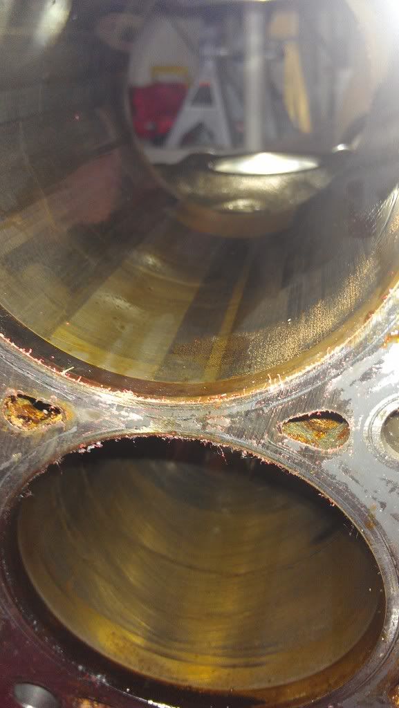

More photos of the old now that all is disassembled. I have not cleaned these
Almost all of the pistons have this small wear on the sides
Comparison of the bad bore next to a not so bad bore

And the potential base for the next turbo setup, oh SO pretty
