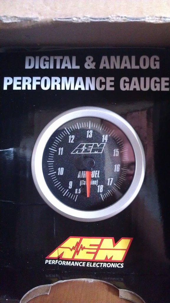

Decided to just invest in one of these
Should be installed today, already have the bung for it and all. Unfortunately it didn't come with a white face so I messaged the vendor, I hope I get one cause that's really what I want. We'll see how it reads though, at least with the gauge in I can drive the car and monitor this stuff on my own instead of having to run somewhere all the time.
All new brakes sitting in my room yet to be installed, maybe next week if the weather allows it on my day off. They should definitely feel better, I'm still on stock never-cut 75k mile rotors and 3 year old pads.
Old 06-06-2012, 09:43 AM   #3917
Wideband is in and the readings are much better, but still need to be corrected some.
At 10psi I hold 12.5AFR to redline
At 11psi I hold 12.8-13.0 to redline
I'm not sure if I'm going to turn it up to 12 on the dyno yet to log it so they can adjust or wait until its safer.
