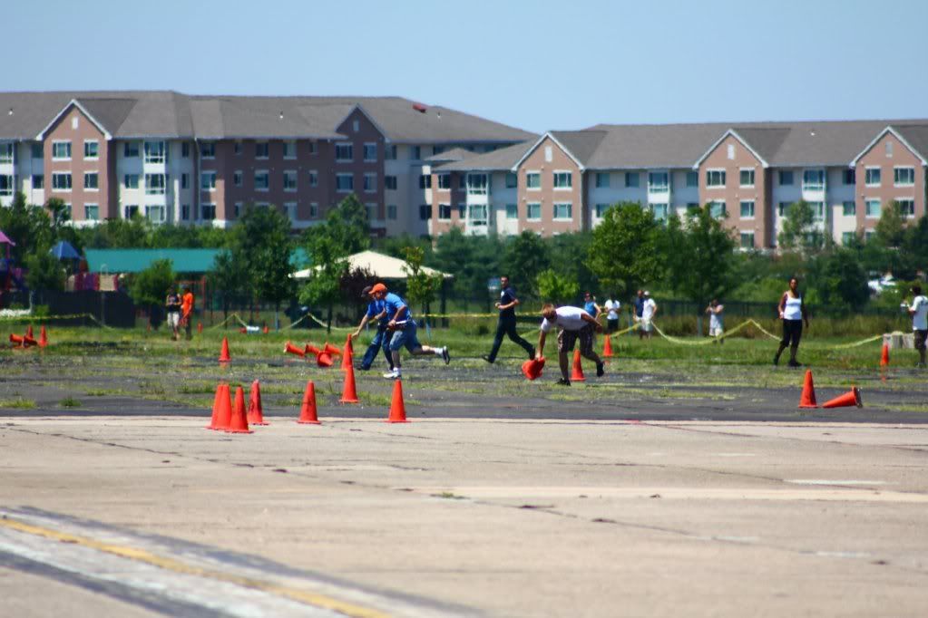

My best was a 58.99x, car has a LOT more IMO but seeing as this was my second time out, it was fine. First run I took out almost the entire first slalom, second run I spun going into the first offsets, third was a 61 second that I'd like to forget, and 4th was my fast time and also when I lost my 3rd gear.
Going transmission shopping ASAP, pretty sure my synchro 2nd to 3rd has dissolved completely because anything over 3000rpm shifts grind, double clutching does not help either. Was a really fun day though! Some pix.
First run slalom
The mess I made
Taking off for run 2, you can kinda see some debris behind my rear wheels, I was really happy with the launch and pissed when I spun it around
Tires after I drove home, still packed with rocks.
New setup performed really well, first 2 runs were skittish, then I borrowed someone's tire gauge and realized they were at 37psi, dropped it to 30 and the car felt worlds better. In conclusion, this was the most expensive autocross I've done.
