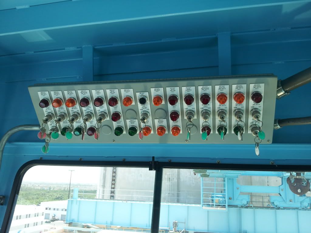

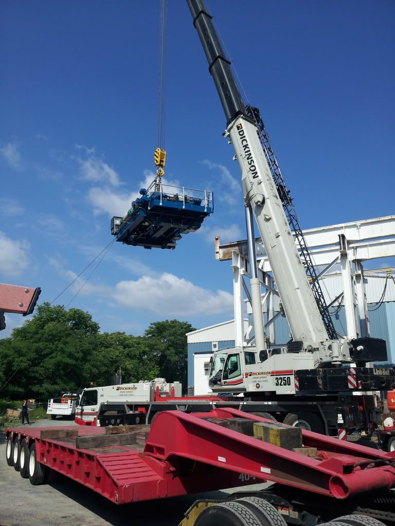

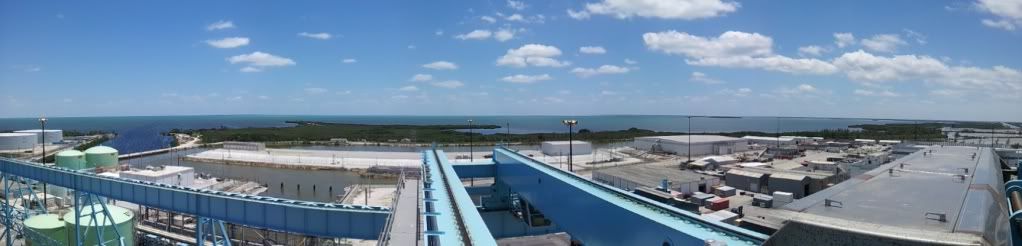

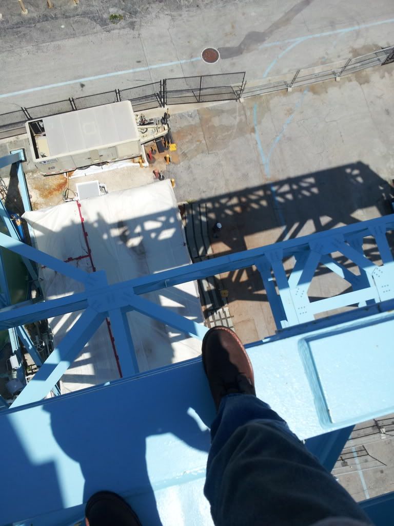

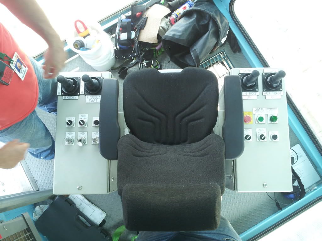

i have been working on this bitch down in Miami, Florida....130 Ton single failure proof crane, 130 feet high, 90 ft long
the view
long way down
operators cab
switches for the bitches

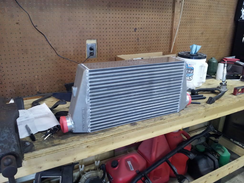

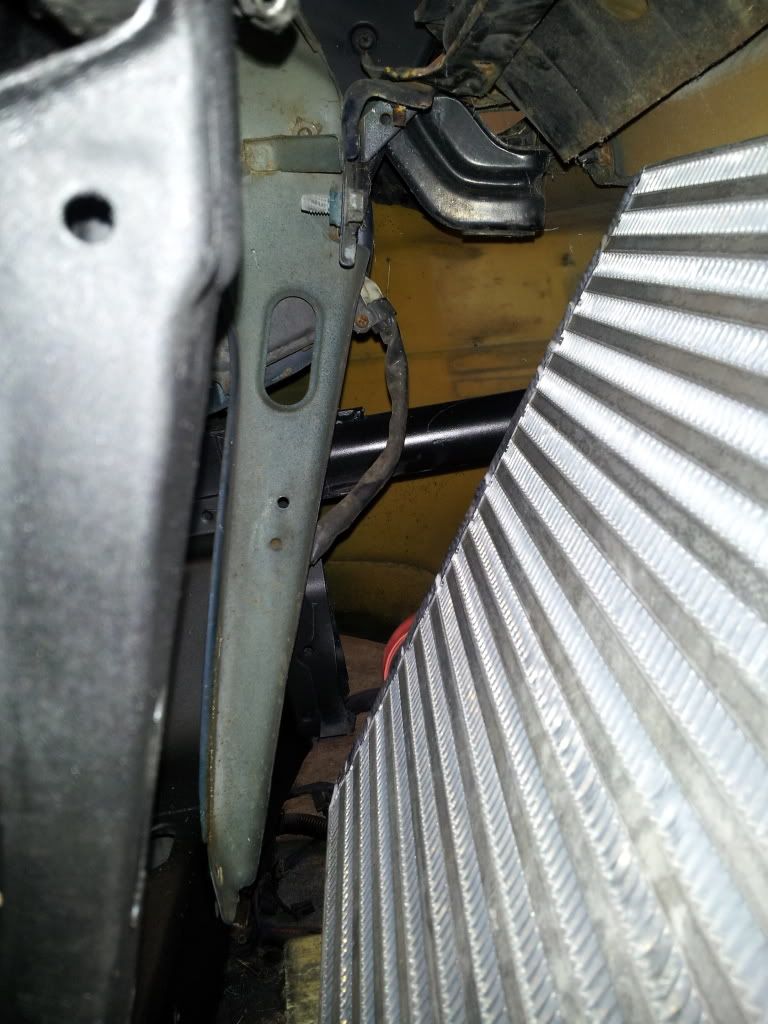

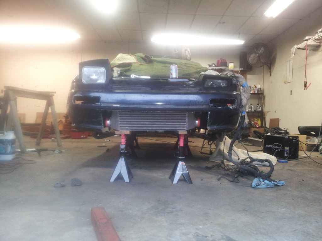

big fmic

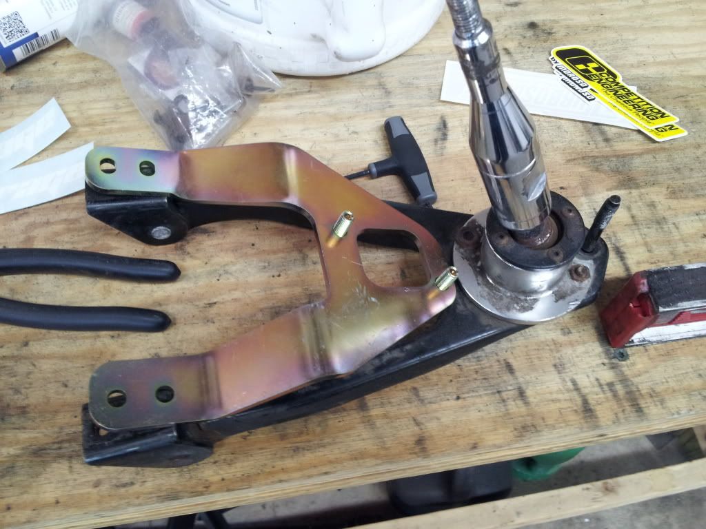

new shifter bracket and new mazworks short shifter.

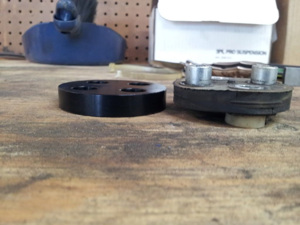

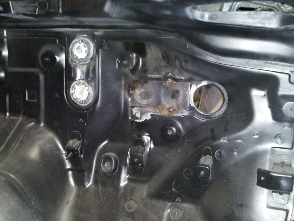

replaced the steering column bushing with a new solid aluminum piece

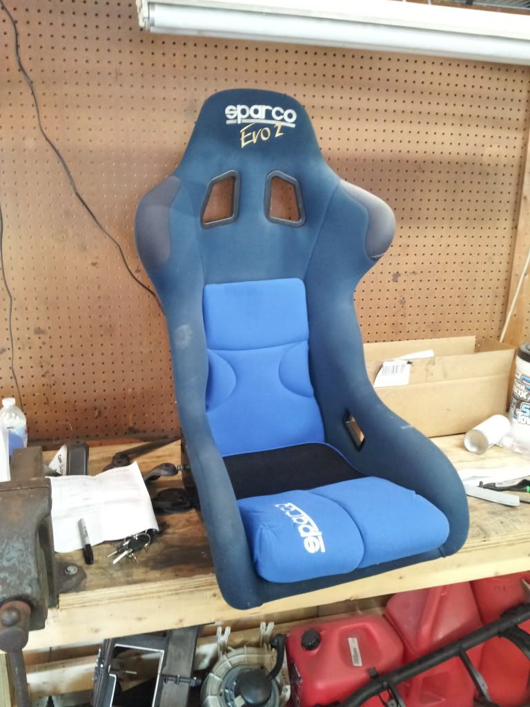

slightly retarded seats, apparently sparco changed colors of the seats to a lighter shade of blue. i bought new inserts since they were wore out and i didnt get the bottoms

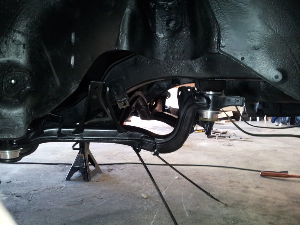

i was able to work on the car a little bit today. got the rear subframe solid bushings in after about a 2 hour ice bath to shink em down, cut up my stock sliders and tacked on my side mounts, and got the gas tank ready for the sump to be welded on. phone died so i couldnt take any pictures....

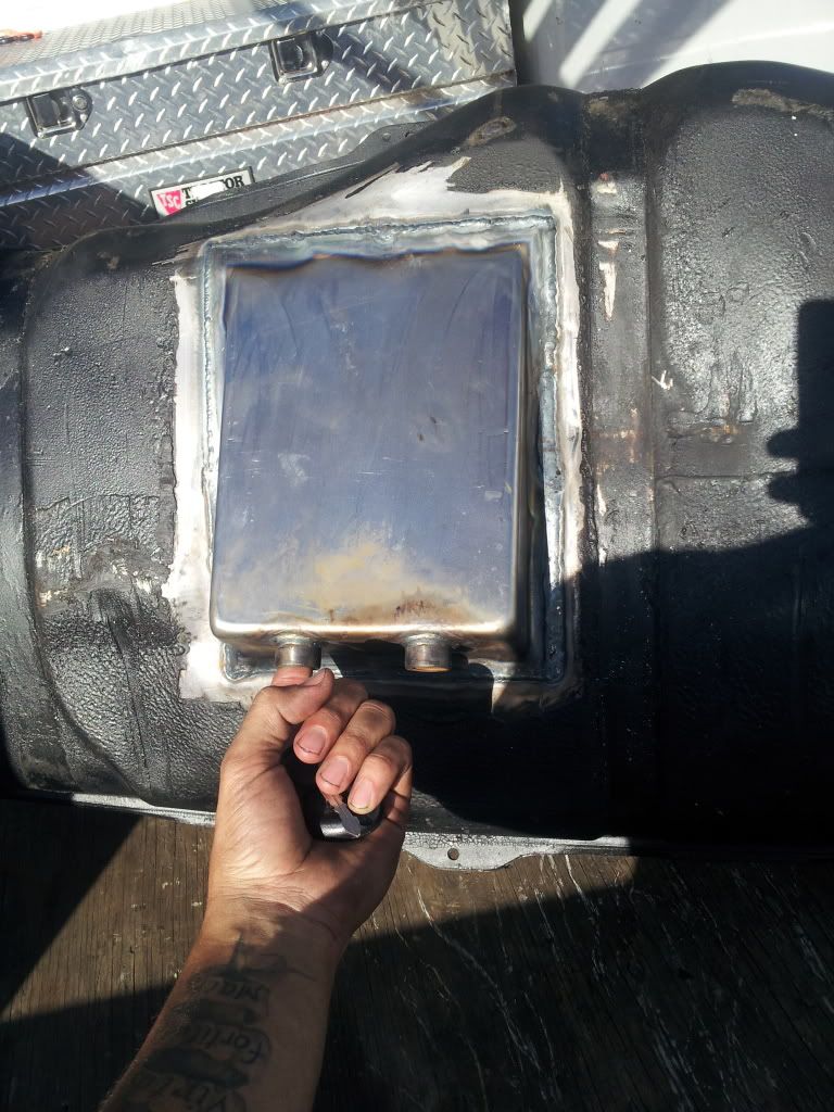

just dropped off my tank at rubright racing in limerick to get the sump welded on. hoping to have some progress pictures Saturday.

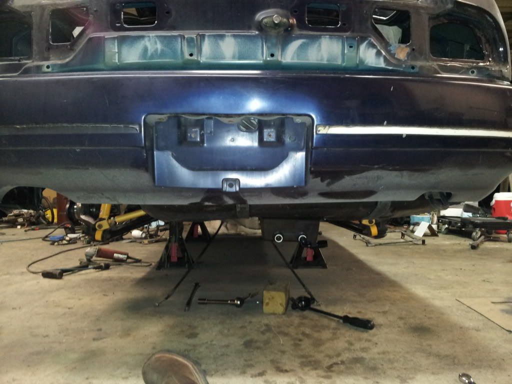

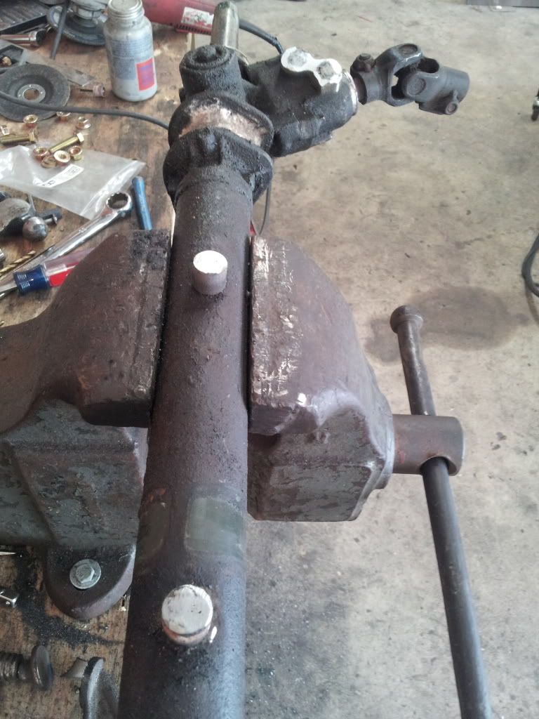

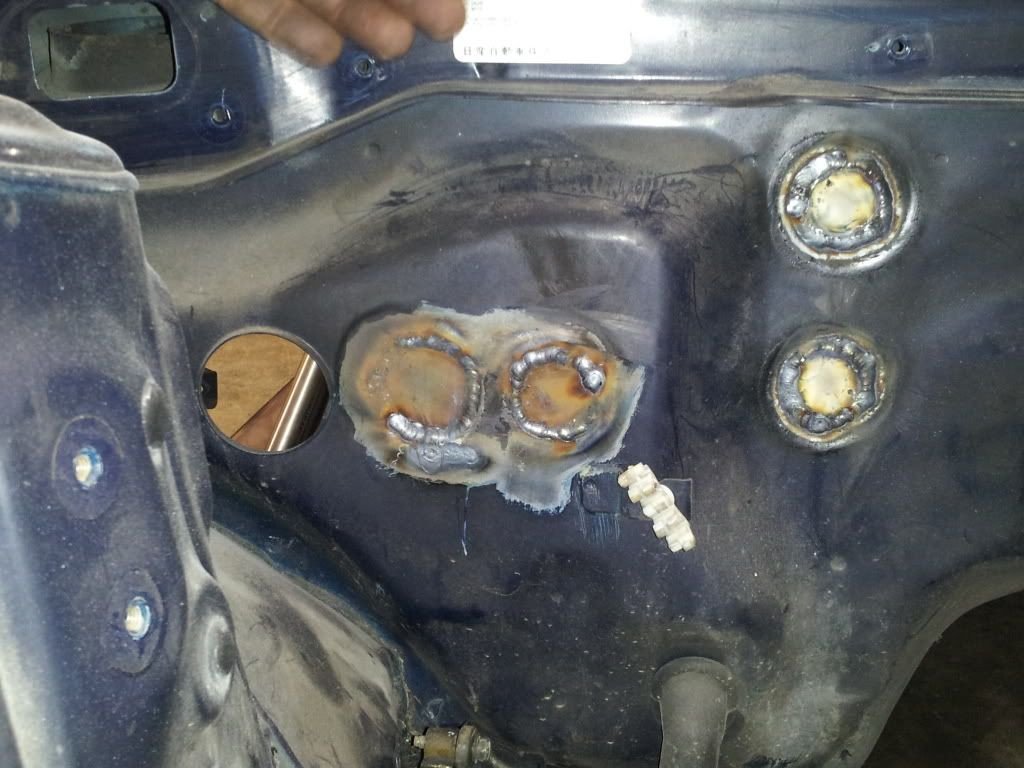

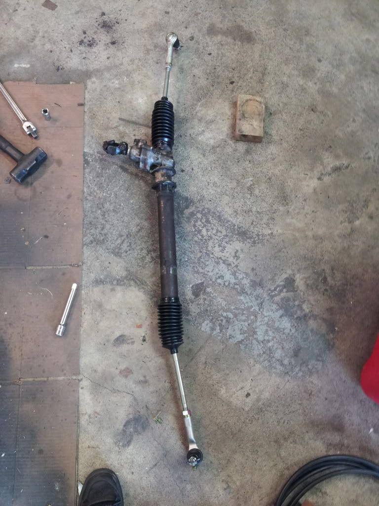

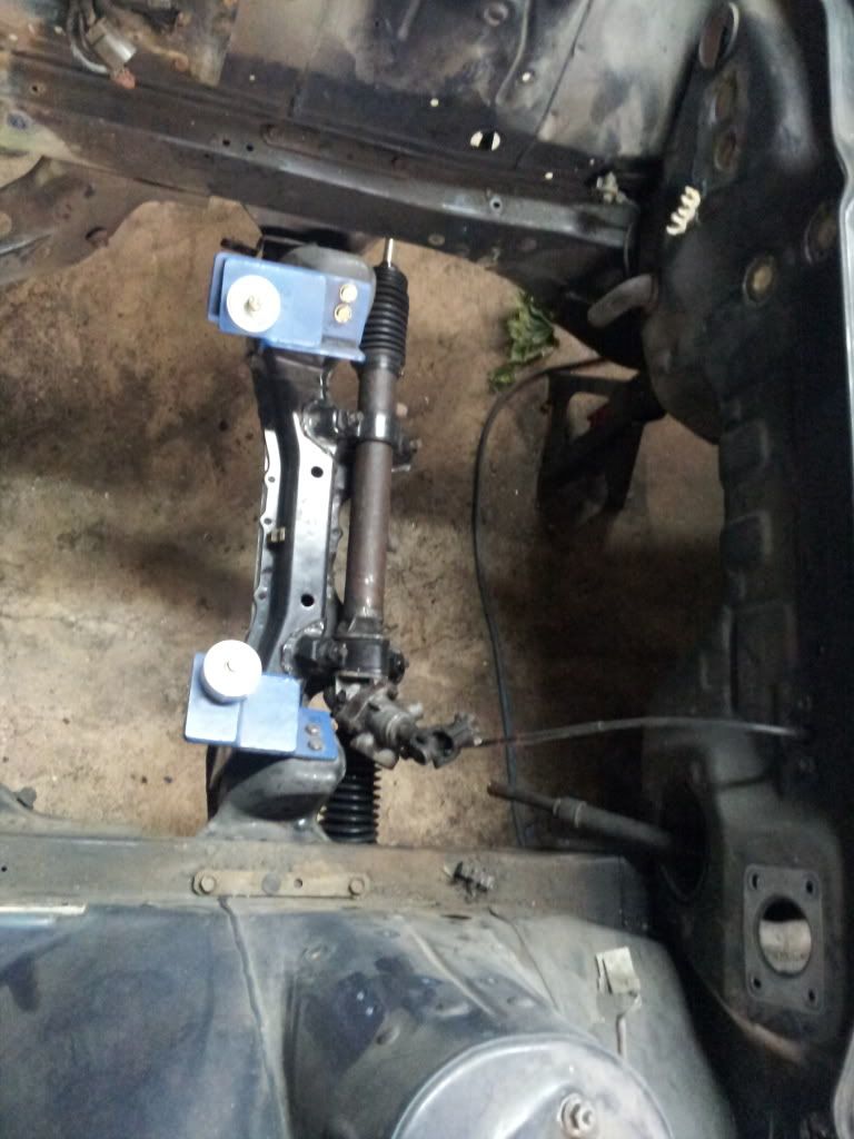

welded the fittings shut on the rack..no going back now
rebuilt it and packed it with grease..

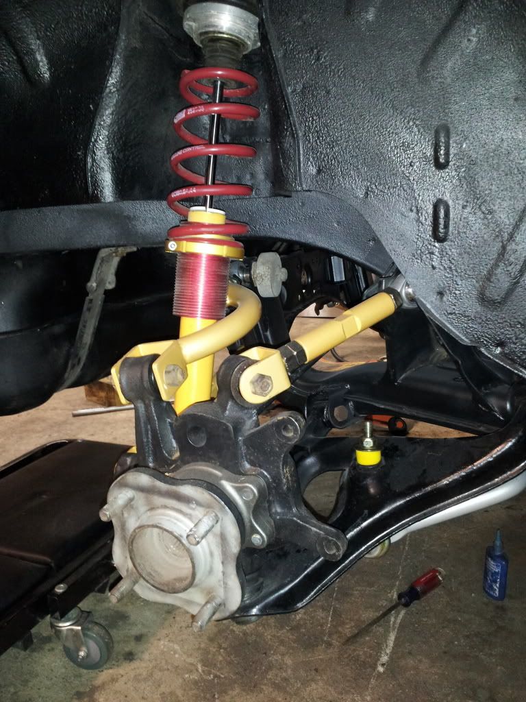

installed the subframe and full rear suspension

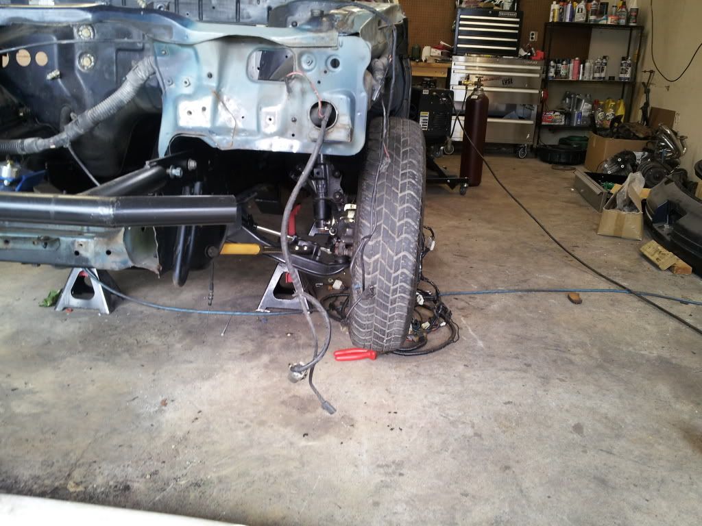

sat the rear down on the tire, couldnt set the front due to incorrect back spacing and lack of passenger front hub

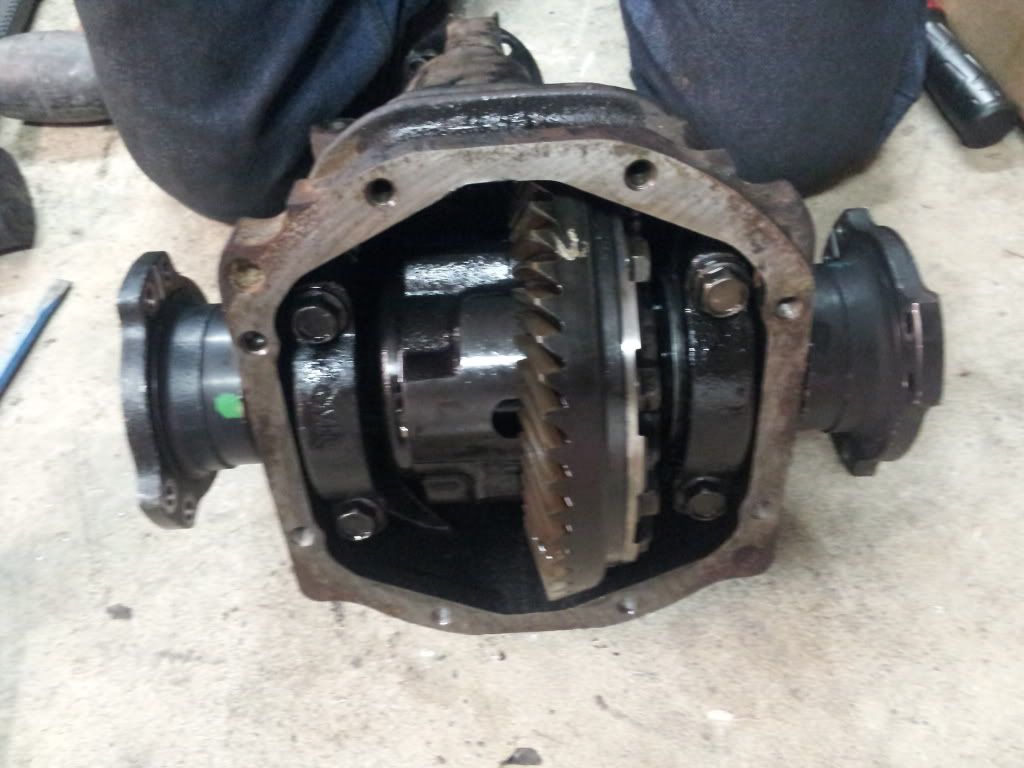

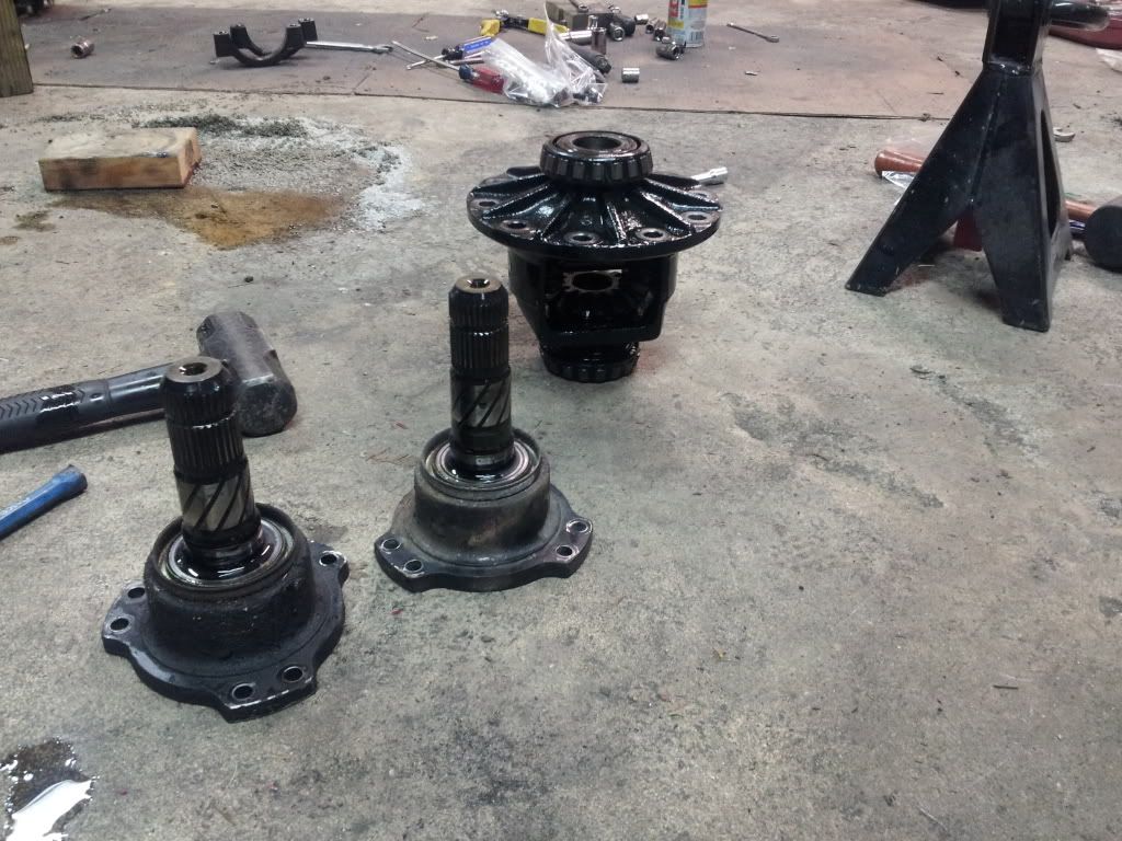

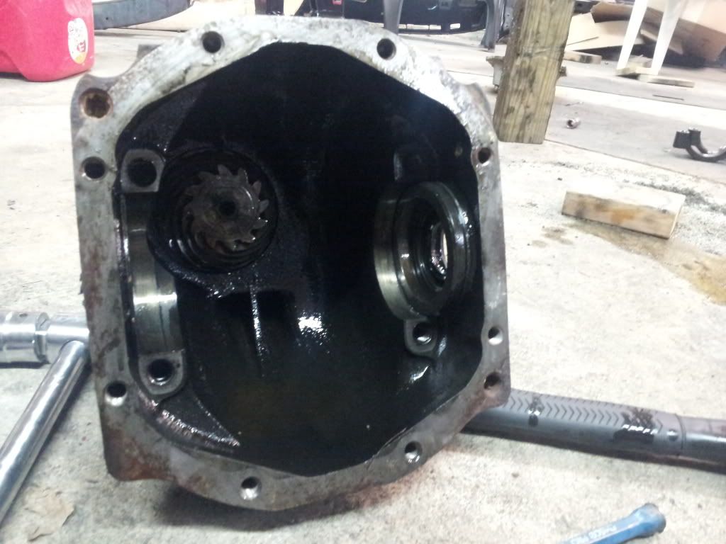

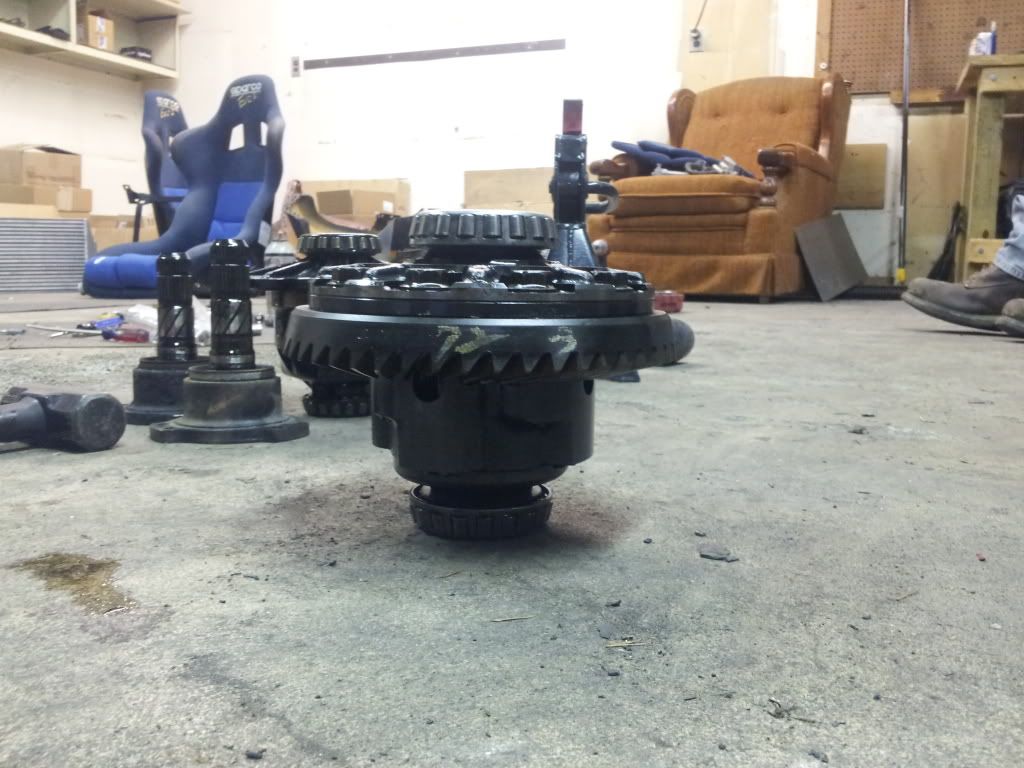

tore apart my diff and installed the S15 HLSD in. just need to have a few things checked by rt on the bearings and she will be good to go
old
pinion
HLSD with old ring gear installed
all done

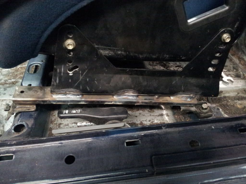

custom seat mounts

Is that the Xcessive solid shifter mount? How far front does that move the shifter approx. Hopefully I can use the same on my VH swap. I pushed the engine back 1-1/4"... Looks like it moves it forward more than that :/

it is actually a mckinney shifter mount. its meant the the vh swap into 240s but i still have the cut my shifter location due to it being on an rb which moves the trans back like 2-3"

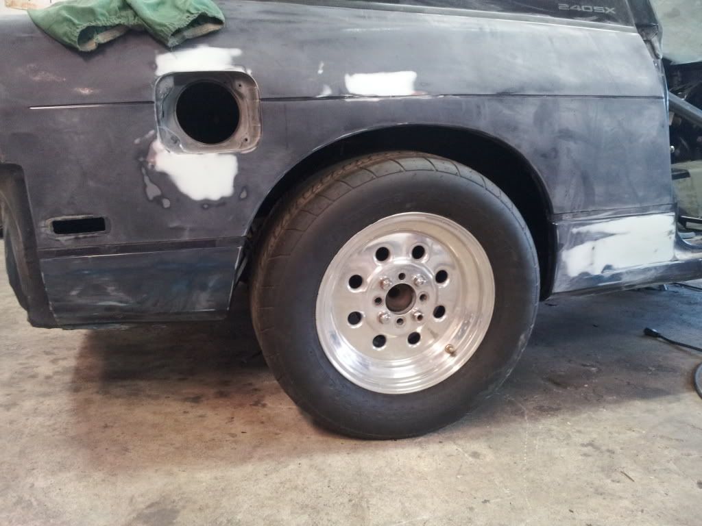

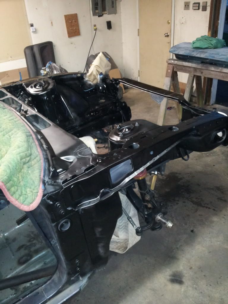

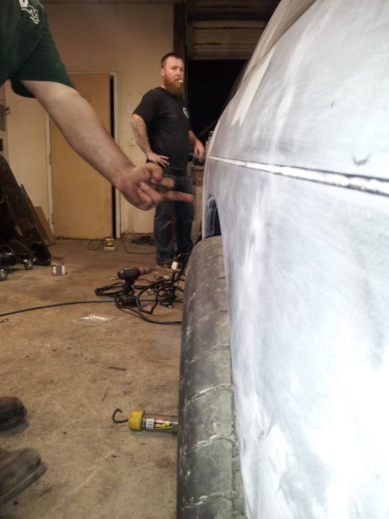

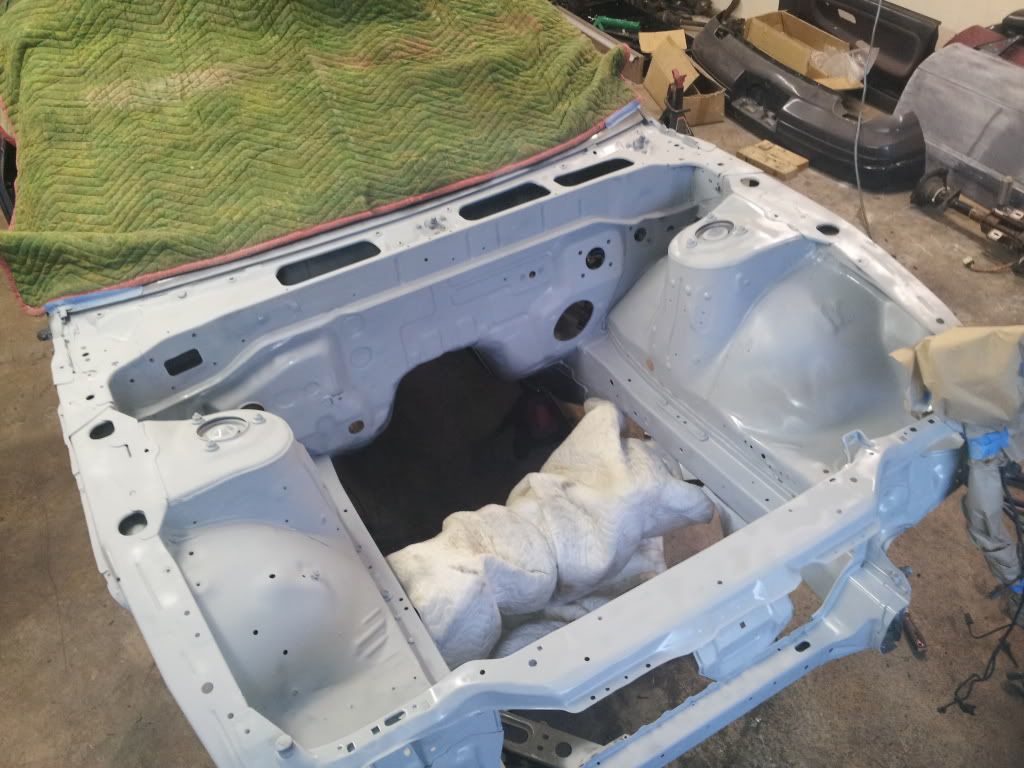

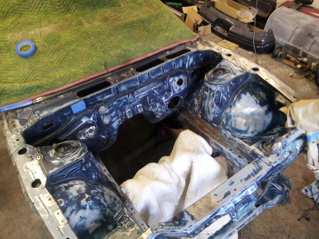

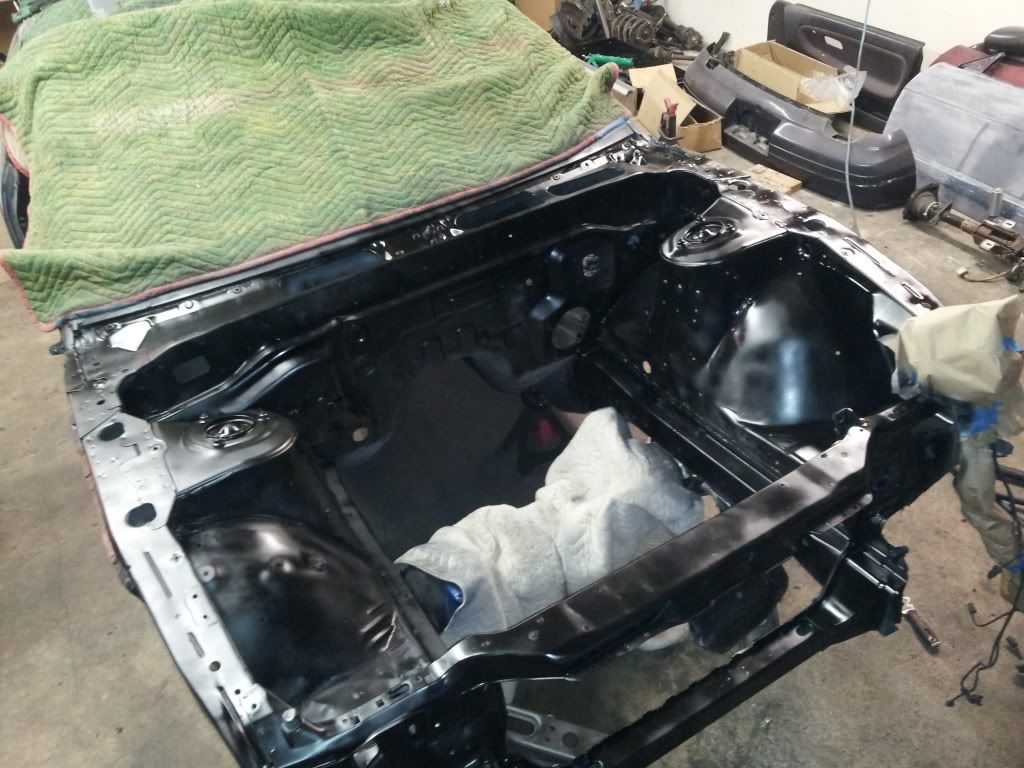

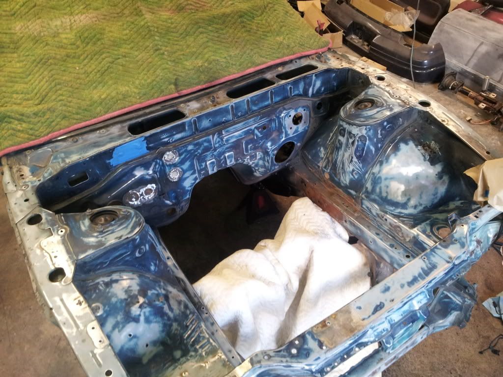

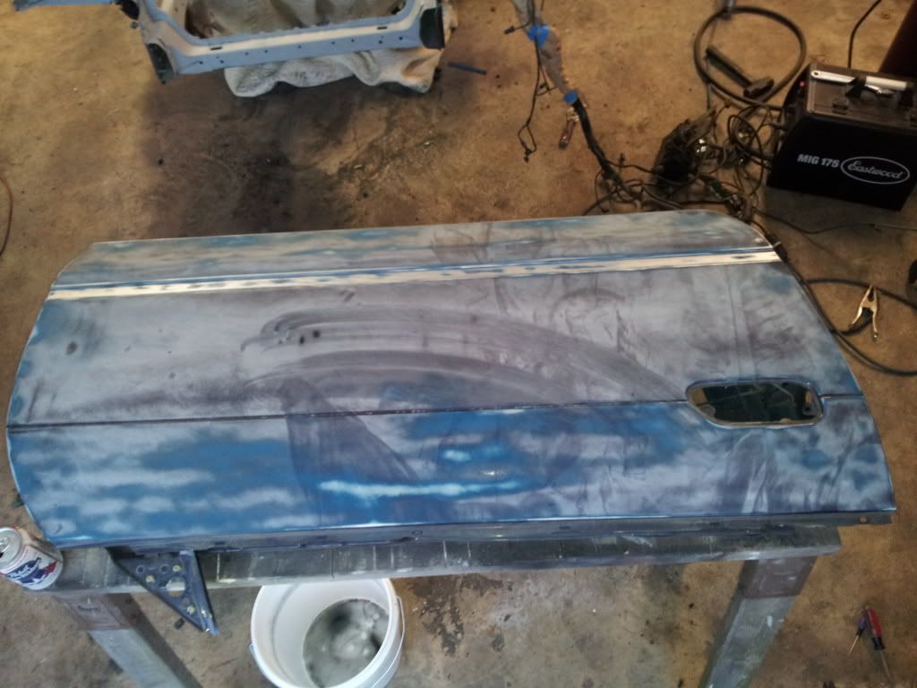

sanded
prepped
primer
satin base
doors prepped for bondo

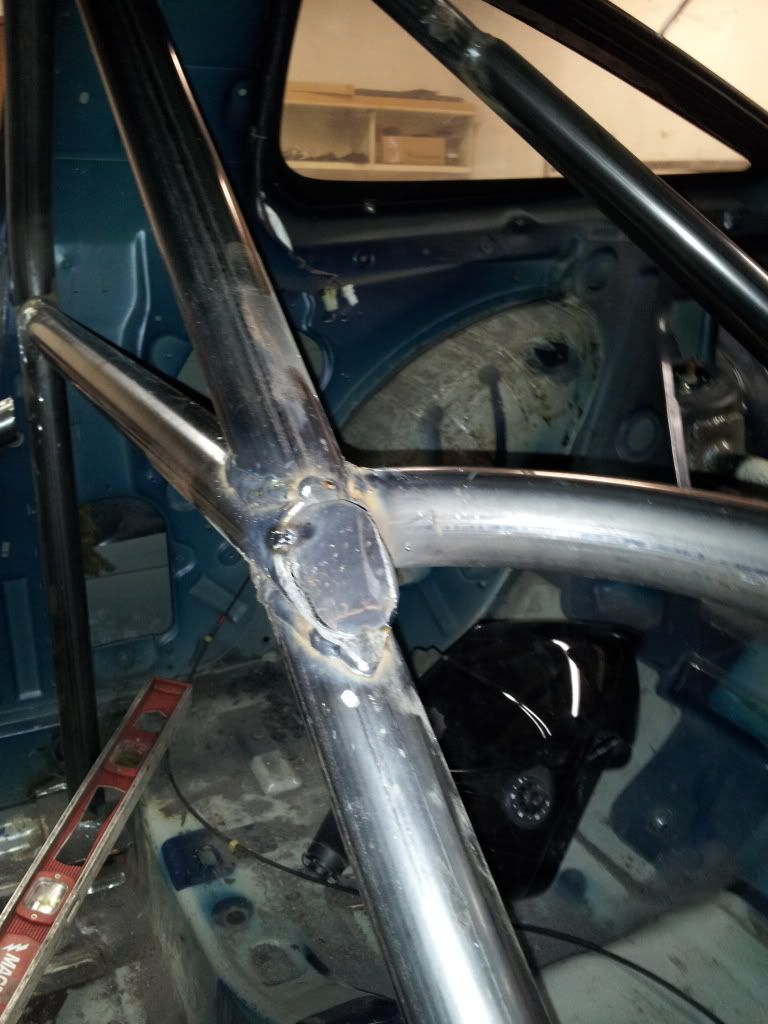

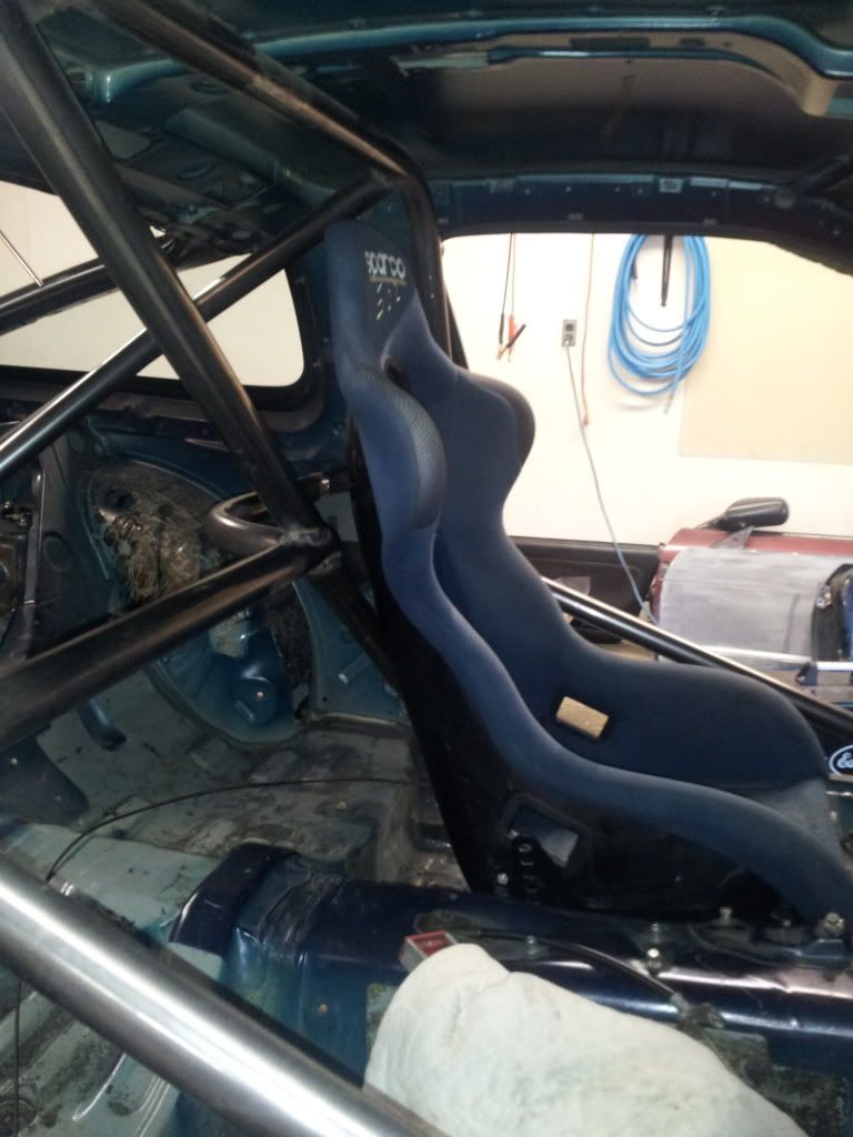

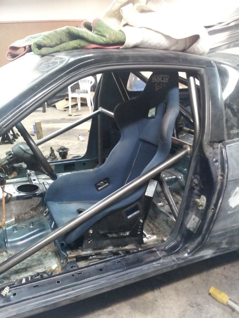

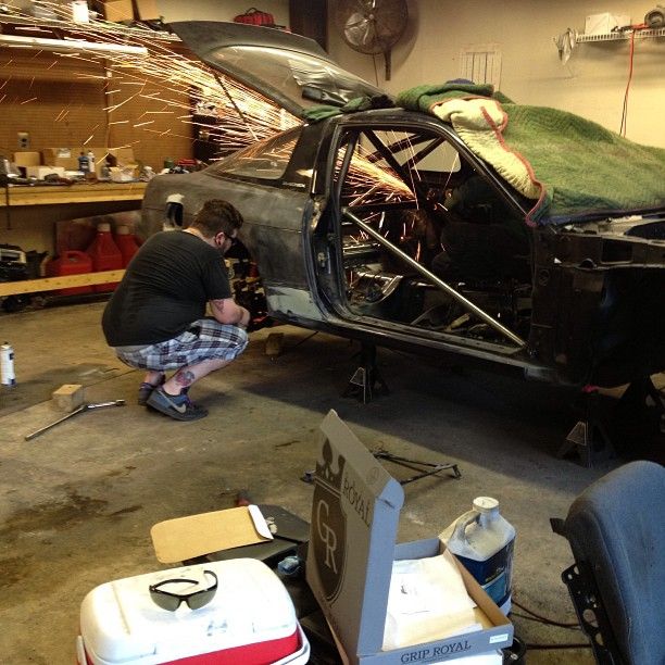

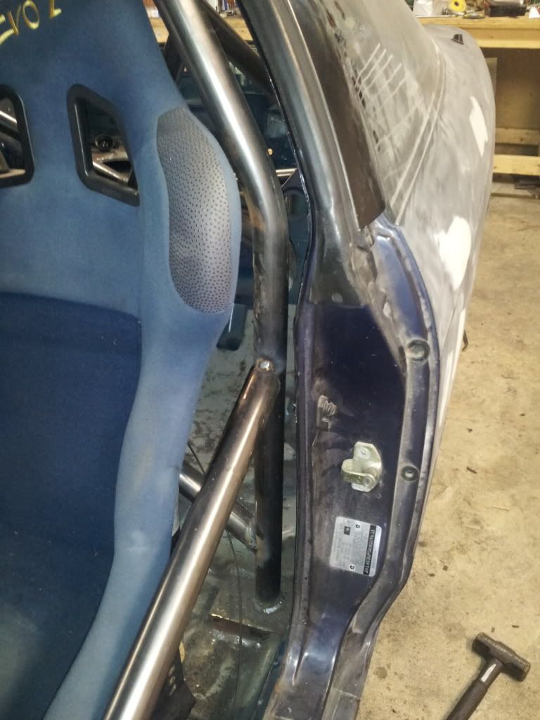

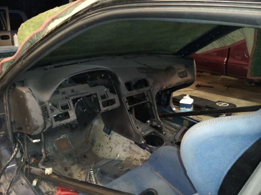

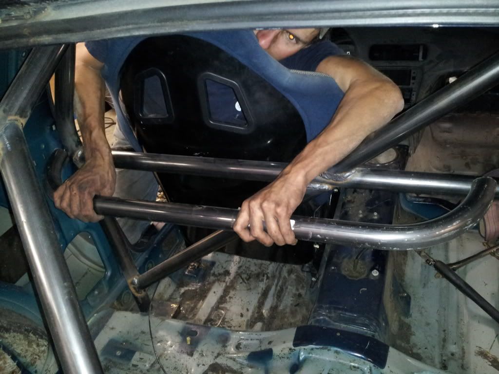

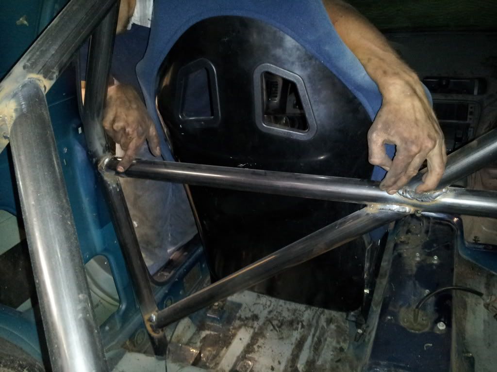

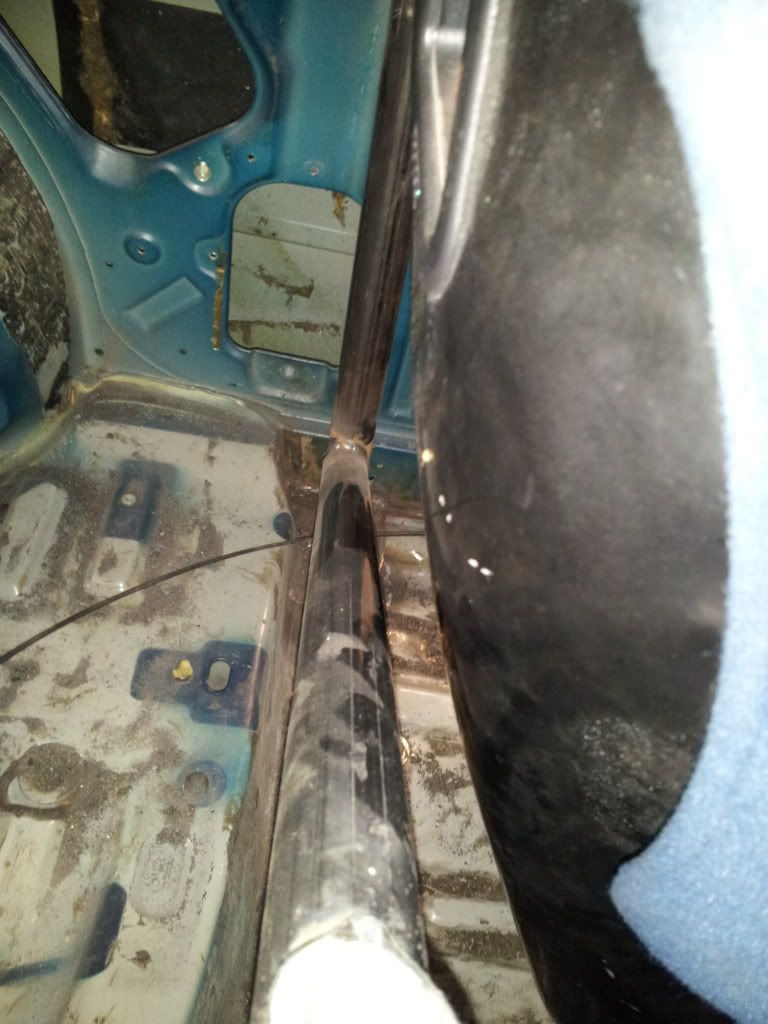

put this in and realized i dont fit....this is my first cage so im learning a few things real quick lol.
im gonna cut at the main hoop and at the diagonal brace.
then weld in this piece over i shorten in up so i can move my seat back like a foot. im hind sight i should have had the seats and dash in it when i did the cage but i didnt. you live and learn. i also have to move the door bars now but thats a simple fix.

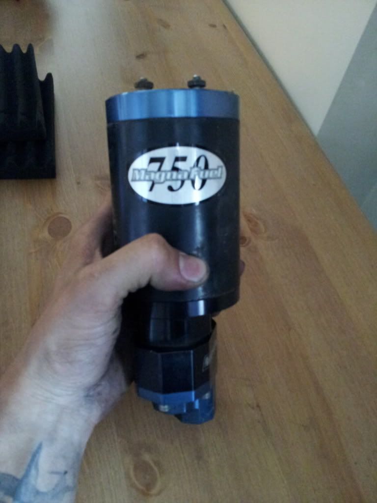

also got this today from a good friend. just shipped it out to be rebuilt.

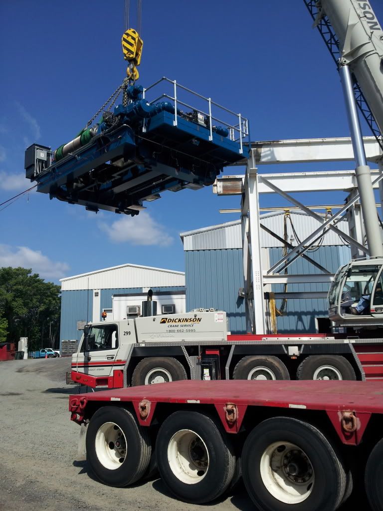

did this today at work. thought you would enjoy some pics

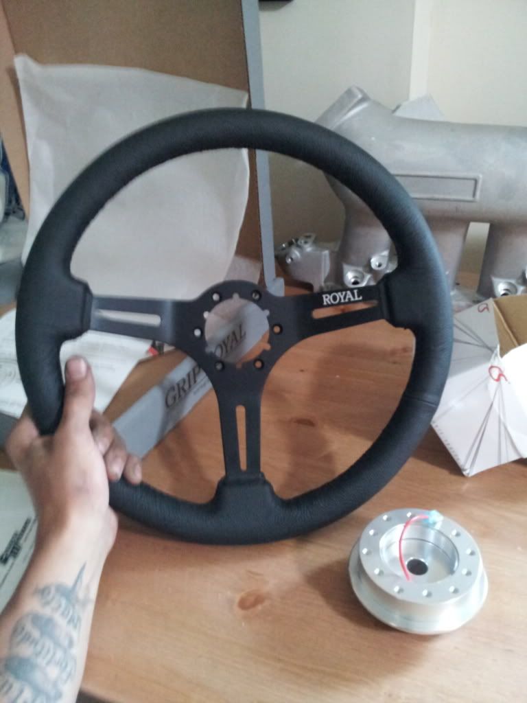

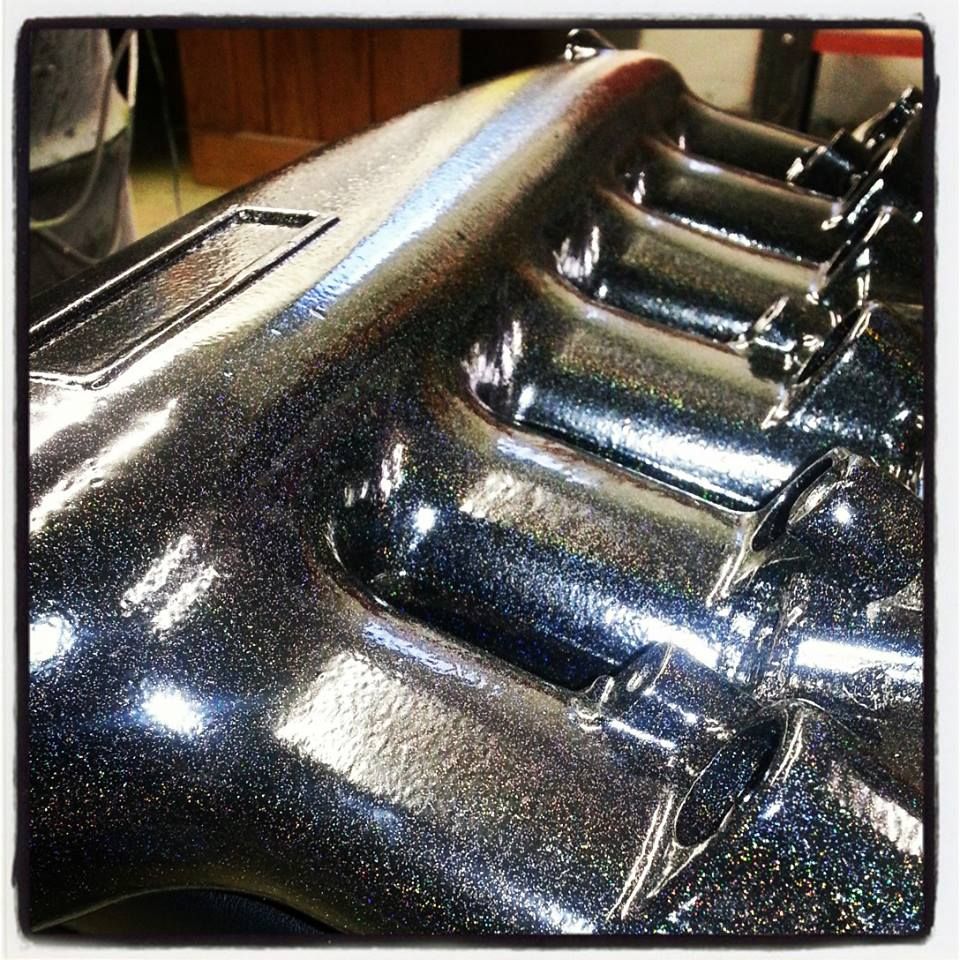

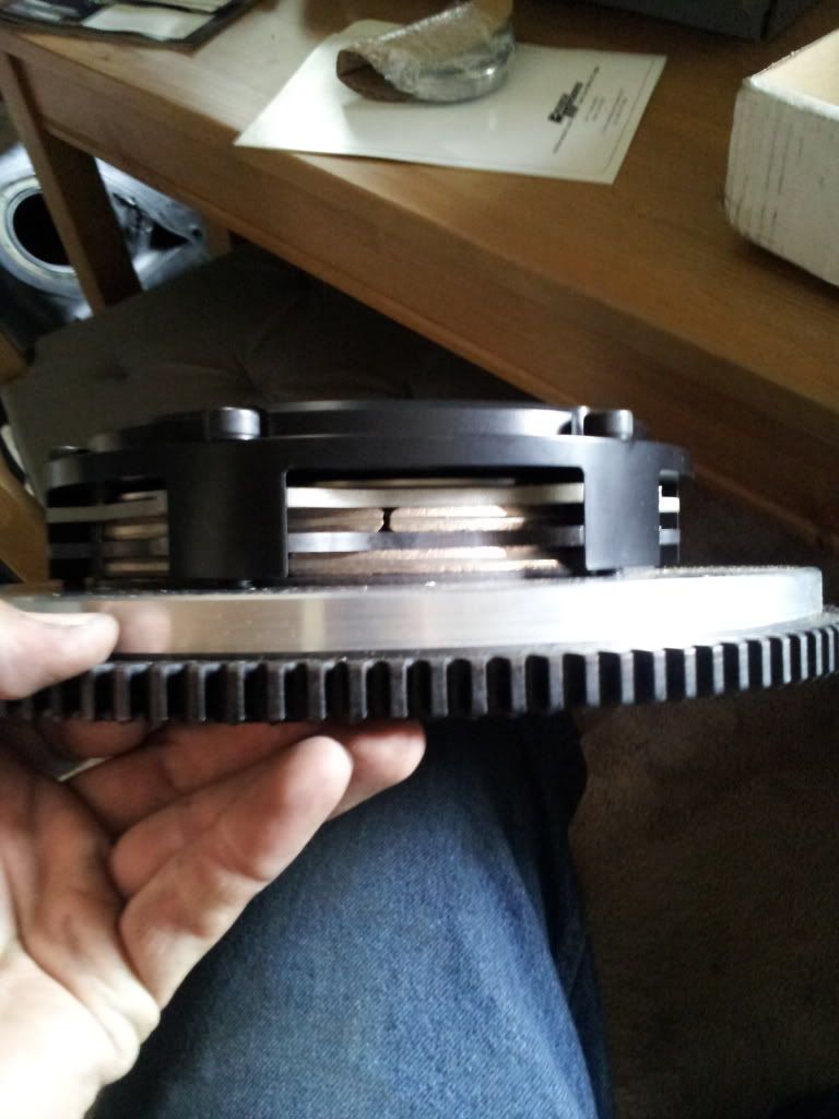

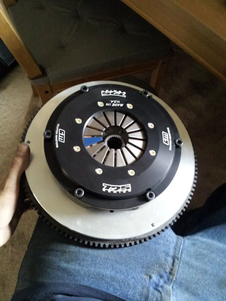

just got these new shiny parts in today. it was like Christmas...
grip royal wheel with circuit sport short hub

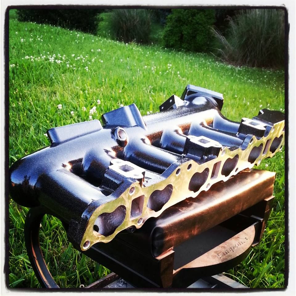

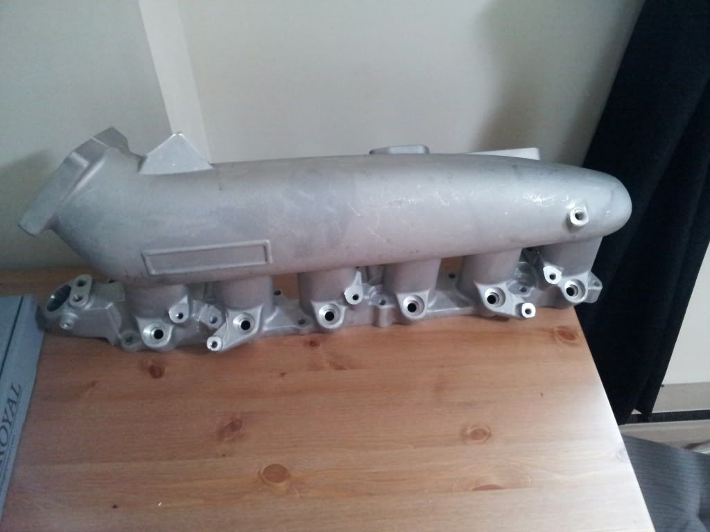

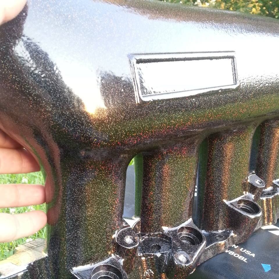

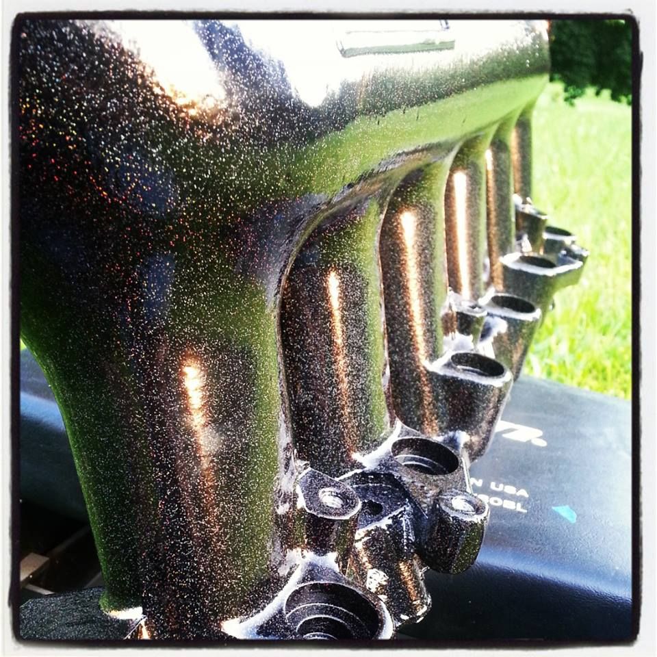

isis manifold since my original manifold was total garbage
clutch masters twin disk
just dropped off the manifold and the valve covers at the powder coaters

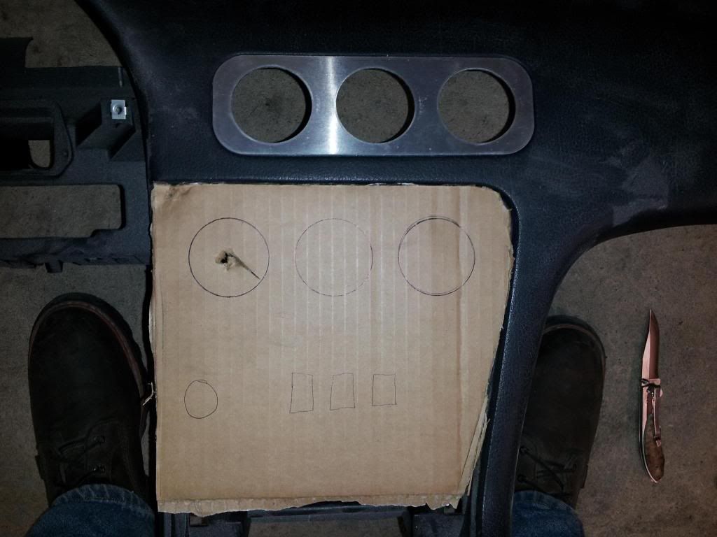

started working on my switch/gauge panel for the dash
cut the harness bar and door bar, i got about 2 inches to move the seat back. i may tilt the seat forward a bit to give me a lil more leg room

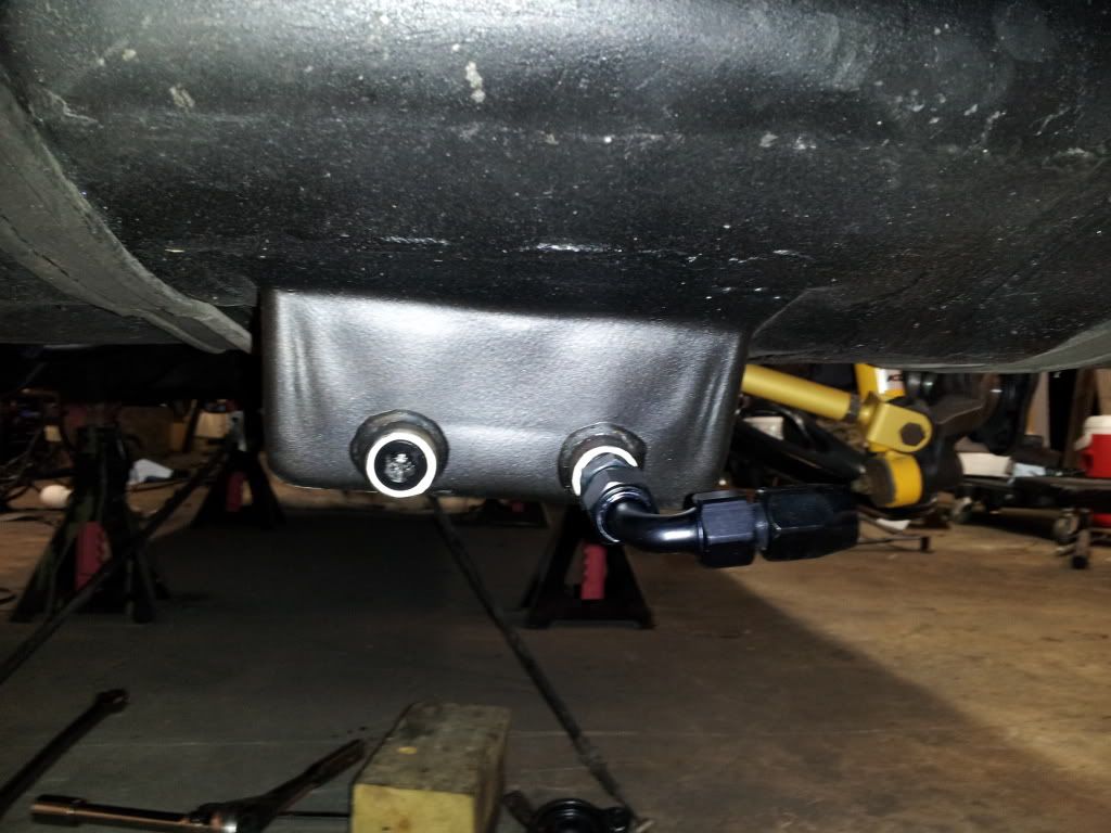

mounted the tank with sump

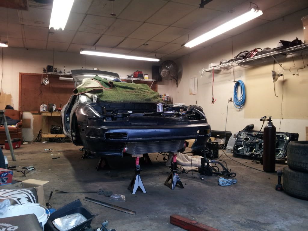

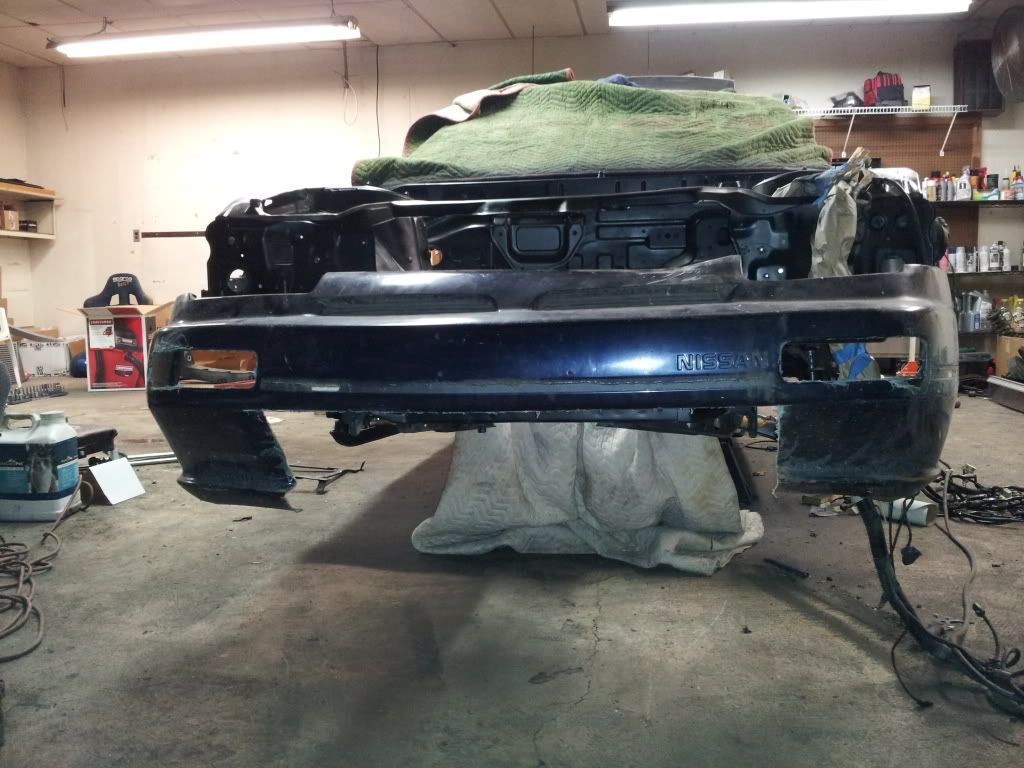

i cut the front bumper for the front mount. this is just a fitment bumper so i know it looks like ****. i plan on running a front lip to tie the two ends together

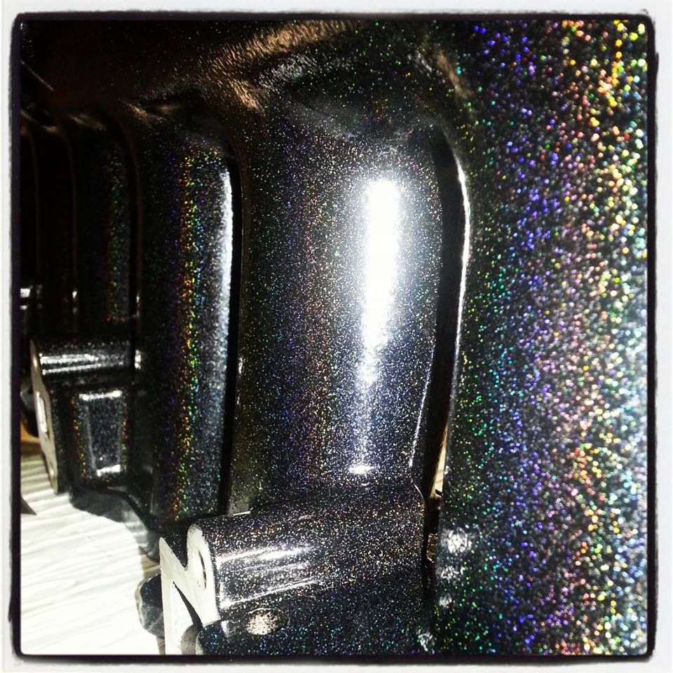

and i got these pictures from the powder coater today. nice and shiny
and of course a working shot from tonight

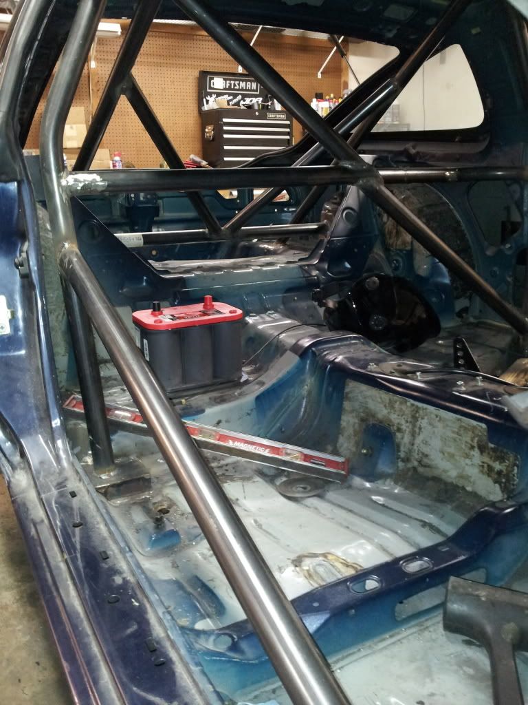

fixed the cage...

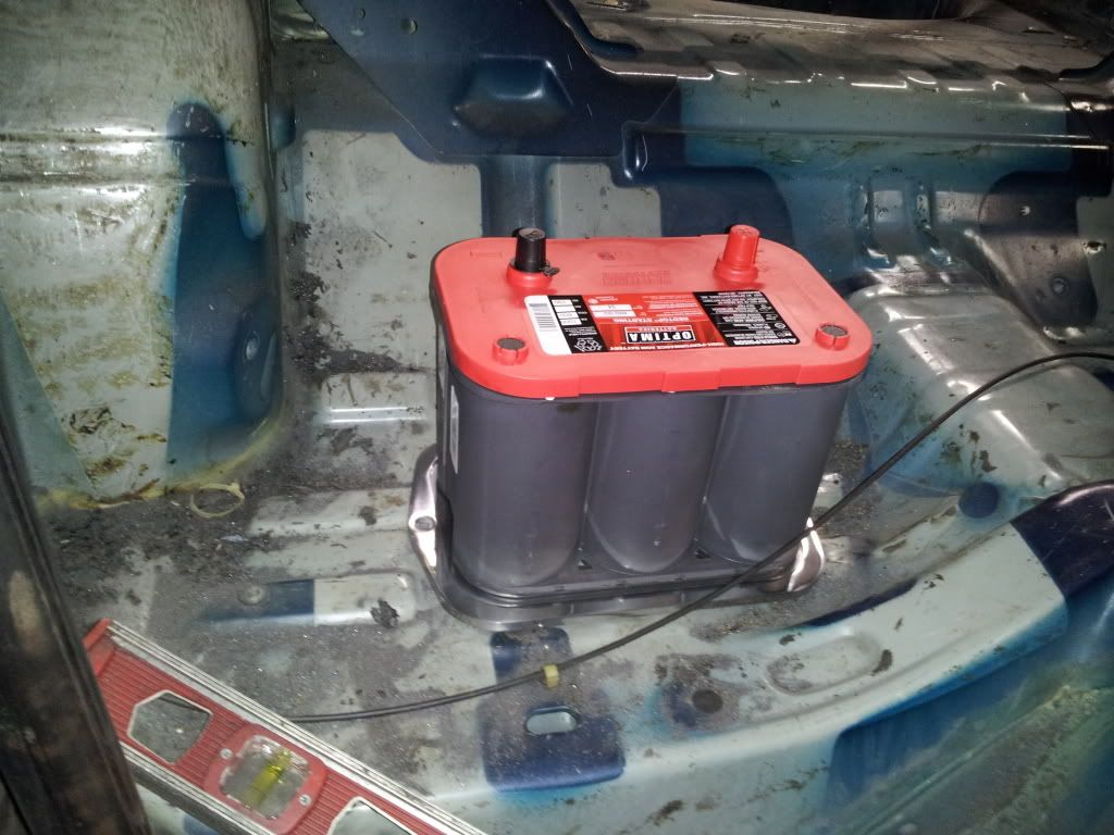

battery mount and location

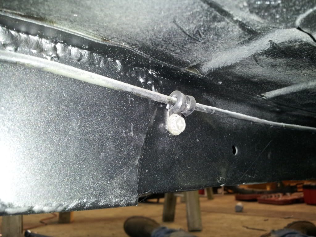

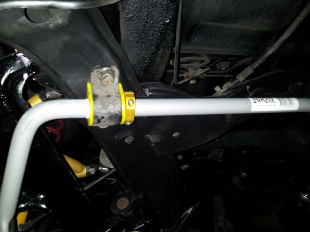

got everything with the rear suspension done. installed the rear sway and lateral stops for the sway
found these bad boys at work. gonna use them on my fuel lines too, just a lil bigger

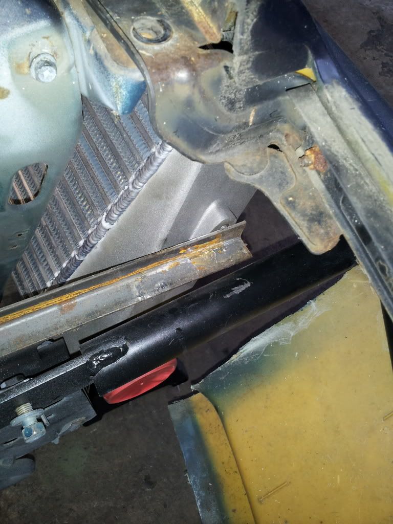

started mocking up my front mount
im gonna use 2x2x1/4 angle and weld it to the crash beam with a full pass top and bottom.
