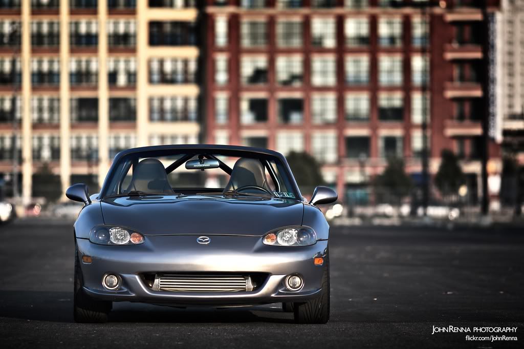

Old 09-21-2009, 12:54 AM   #2325
More from JhnRX7
Couple new ones from this weekend.
Old 09-21-2009, 01:09 AM   #2326
BigWhiteTodd
BigWhiteTodd's Avatar
Location: North Wales
Member #8795
01 camaro
so clean, your car makes me like miata's.
