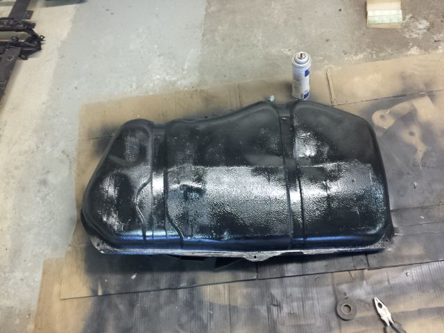

gas tank is coated

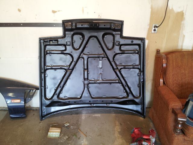

hood is almost ready

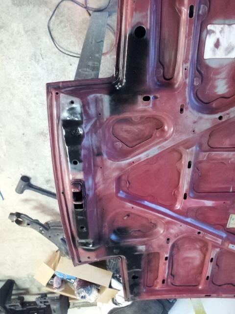

treated the rust spots
rattle can primer on the hood. im going to be spraying high temp paint on the hood and engine bay..

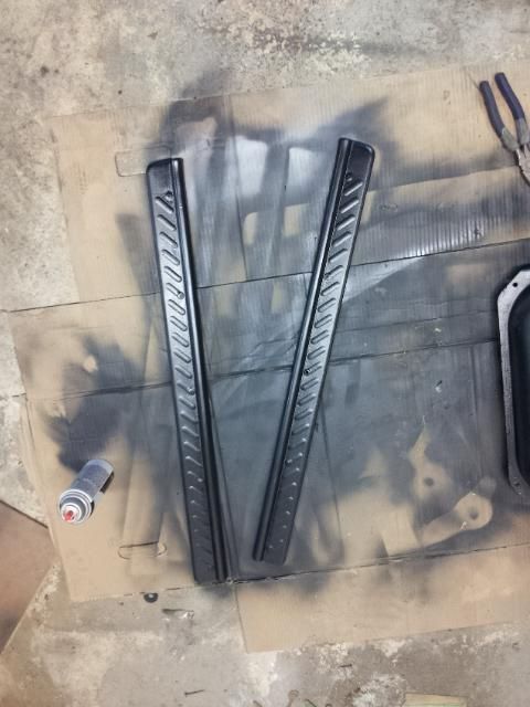

blue door sills painted black

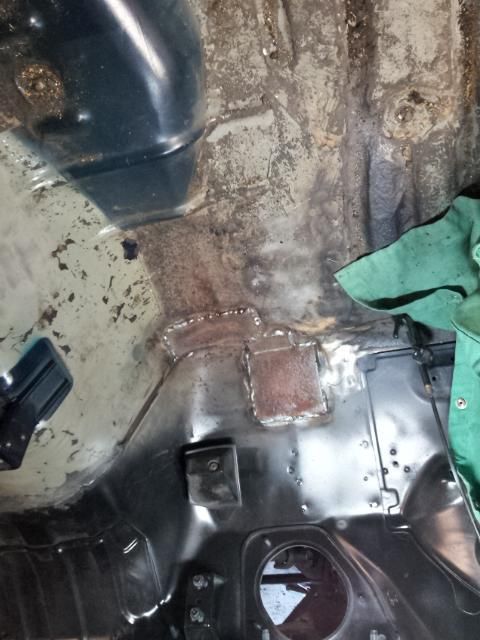

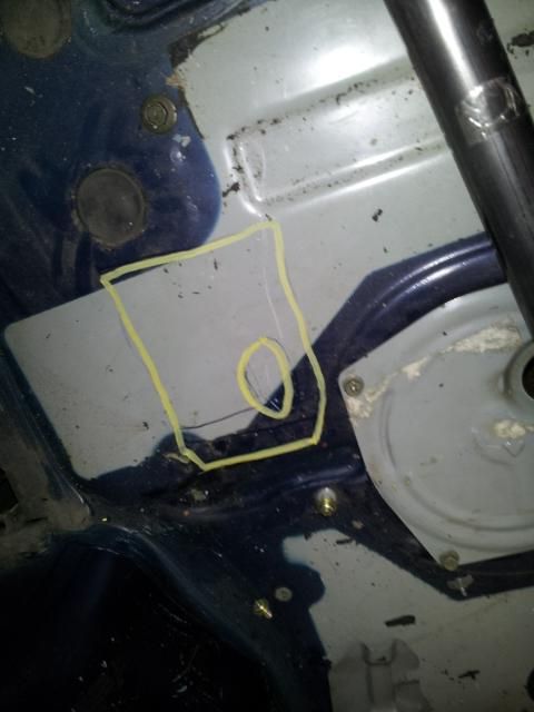

holes in the floor patched

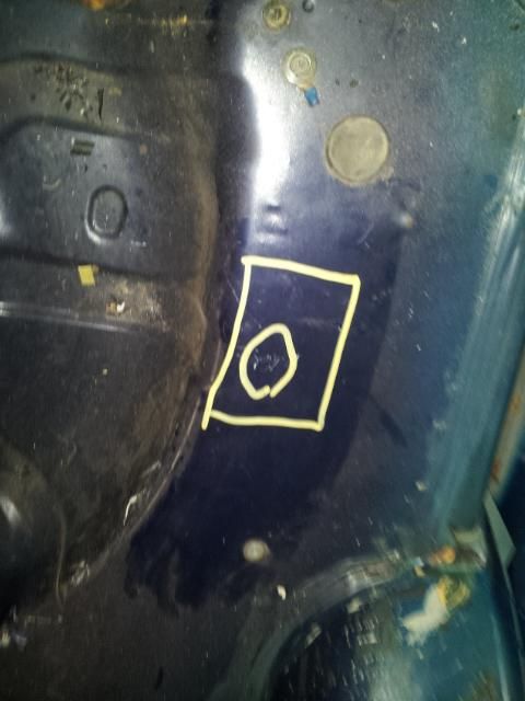

frame rail done, just need to do the under side of the floors yet

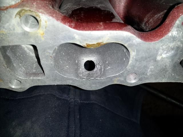

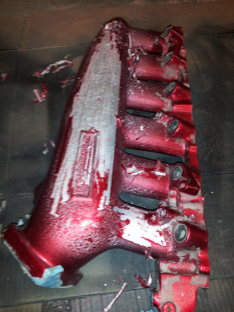

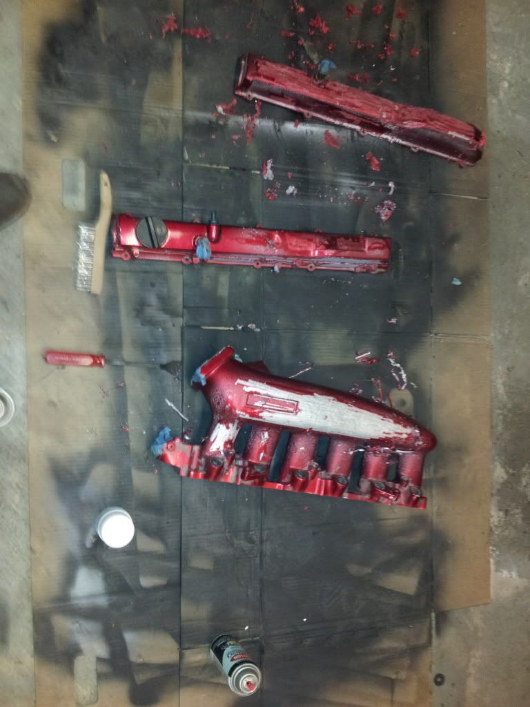

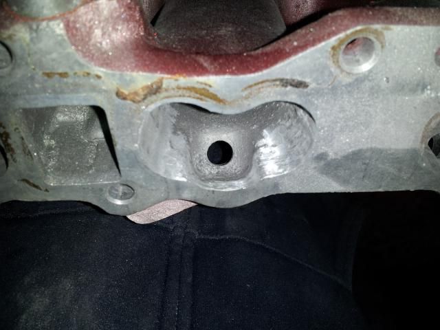

started cleaning up the runners on the intake manifold
before
after

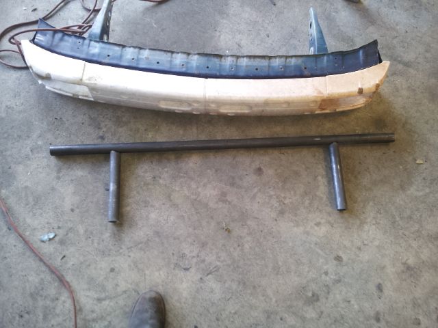

im picking up tubing on monday to fab up my own bash bar so i can fit a larger front mount yet still protect myself in a collision...

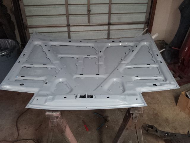

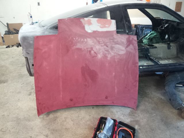

hodd has three coats on it. one or two more then its 4-5 coats of clear.

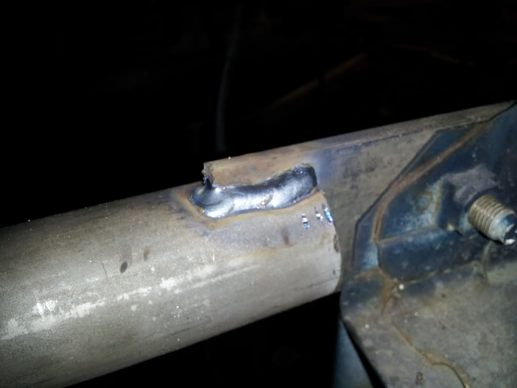

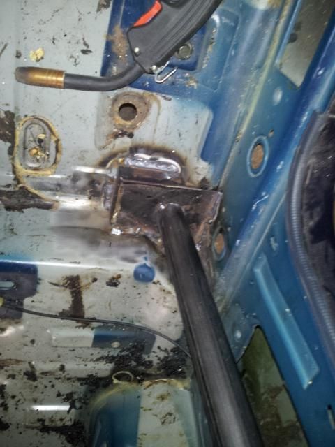

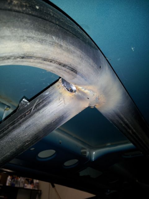

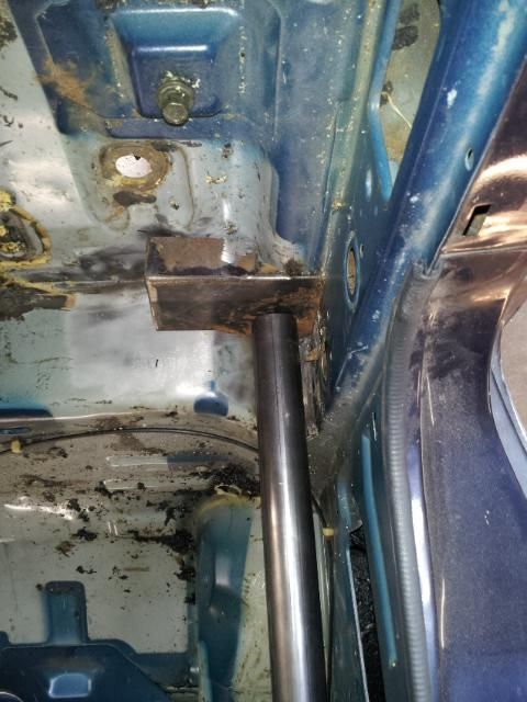

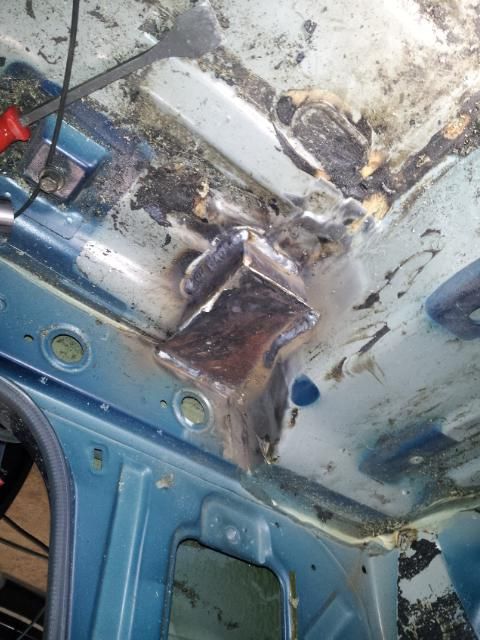

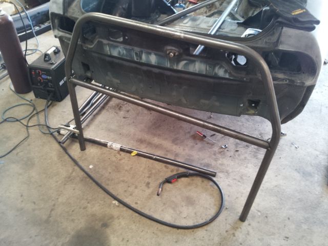

tacked in the harness bar

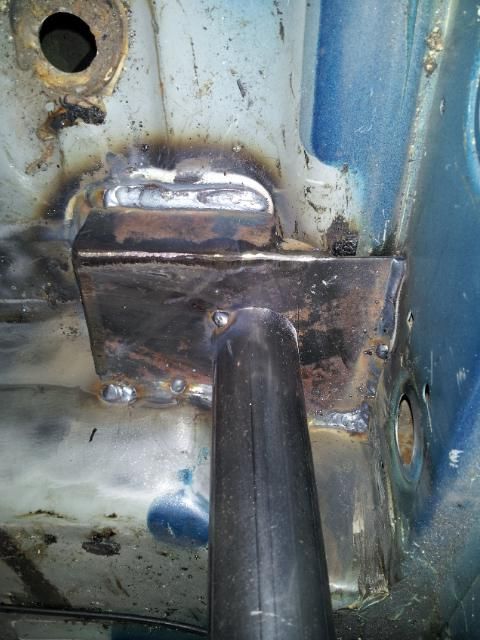

main hoop mounts
need to clean these welds up

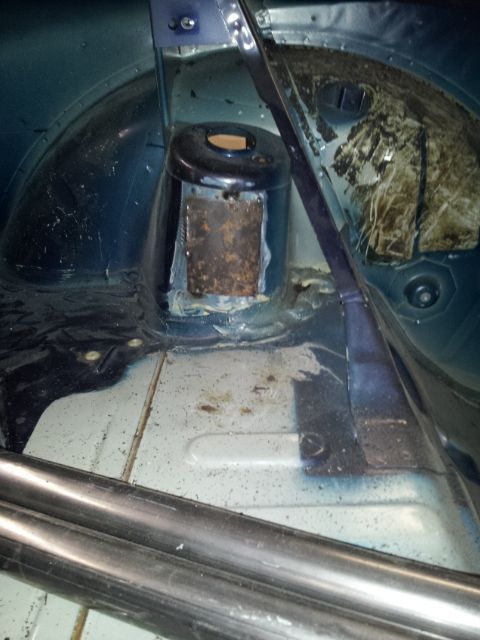

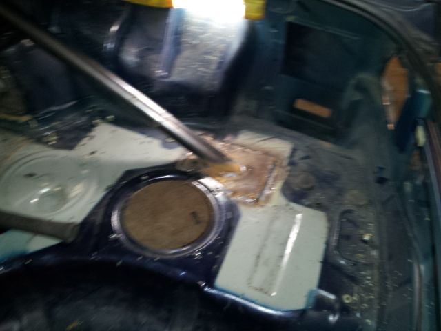

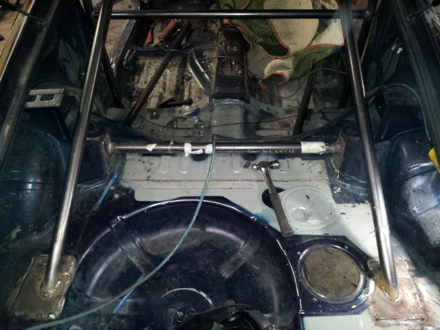

locations for the rear tie backs. im gonna x-brace them and put a bar between the strut towers.

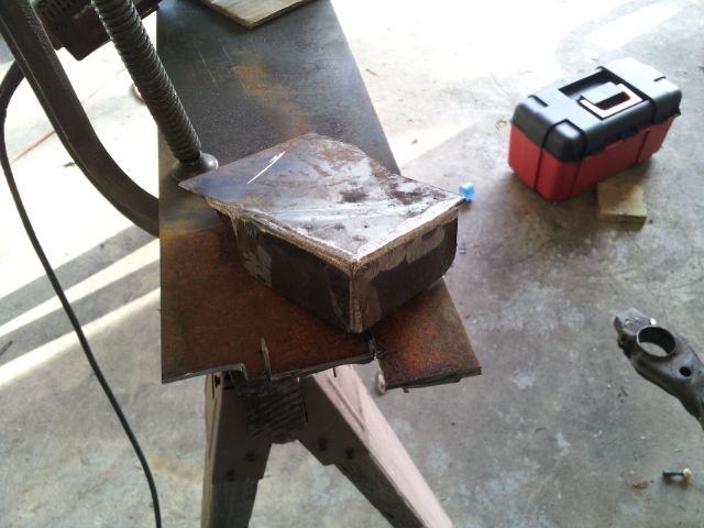

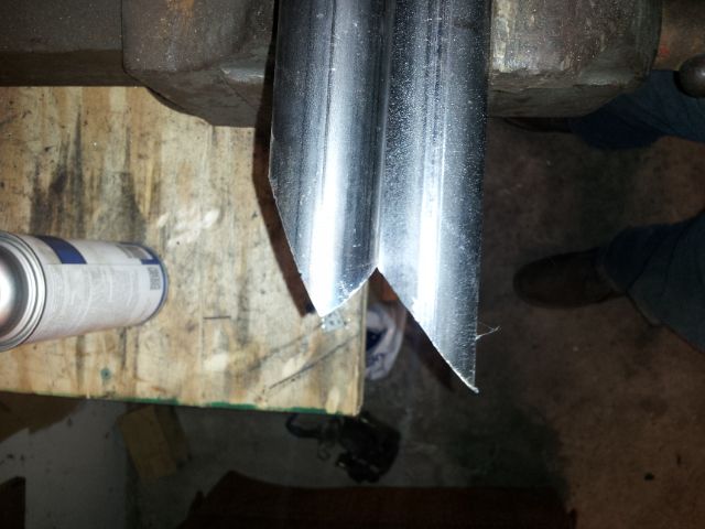

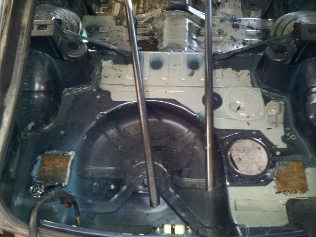

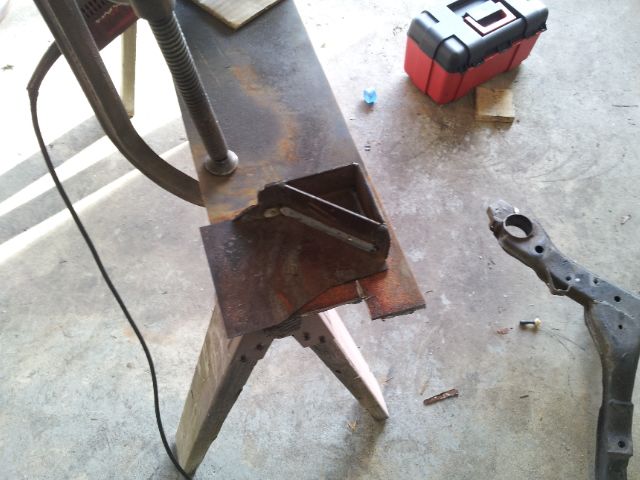

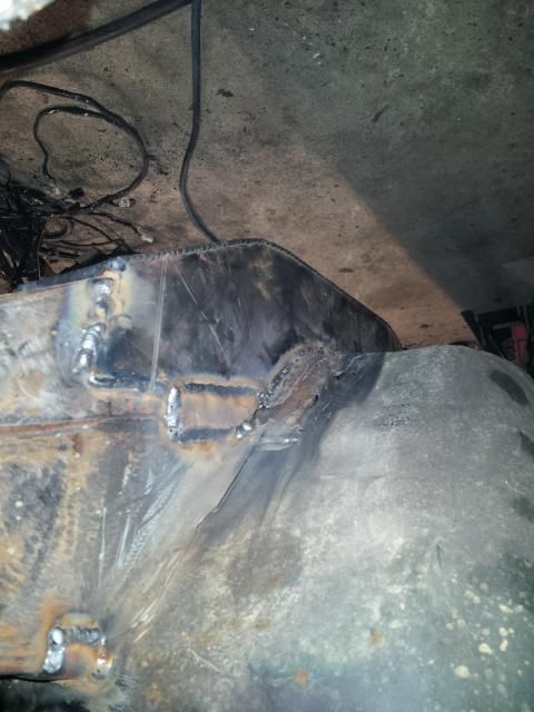

start of the bumper beam, gonna make some bends on the ends and notch the pipes for the mounts. i got some plate but i cut it to short at work

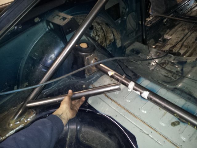

rear tie back mounts
one of the strut tower mounts. i was working on the other one but i just couldnt get it bent right so i gave up

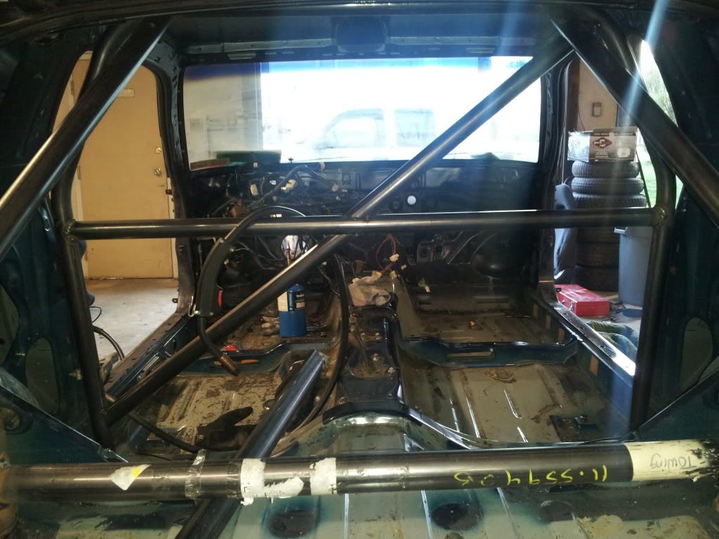

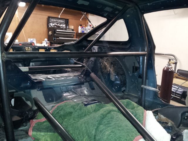

cut the cross-bracing for the main hoop. s&w nothed it weird, but there was extra so i just started fresh with the angle, just need to use the grinder and cope it to match the harness bar.

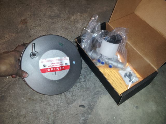

new master cylinder and brake booster

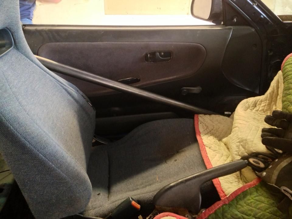

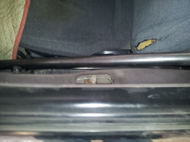

door bars fit with door cards
gonna add this bracing and another one from the strut tower to the rear tie backs further up

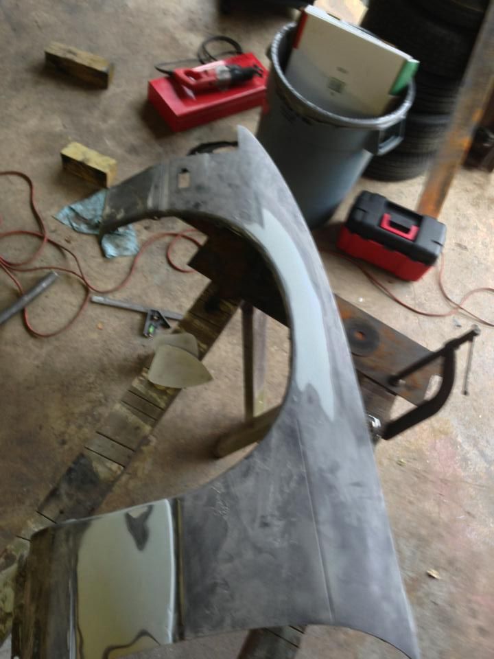

little bit of fender work

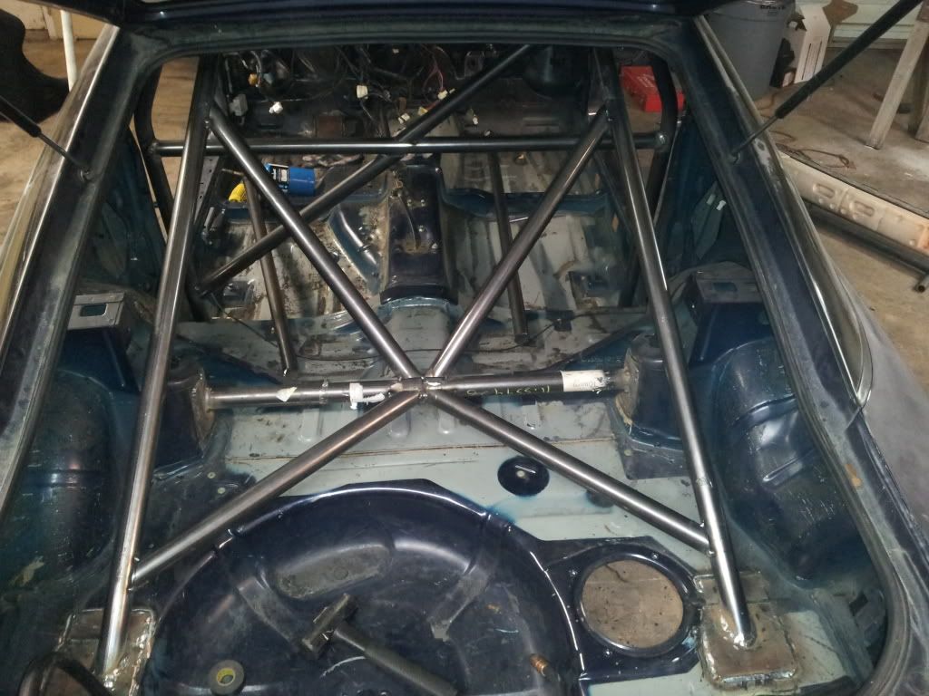

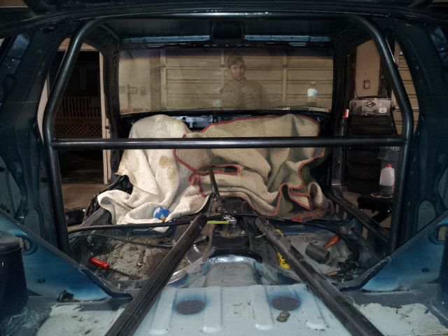

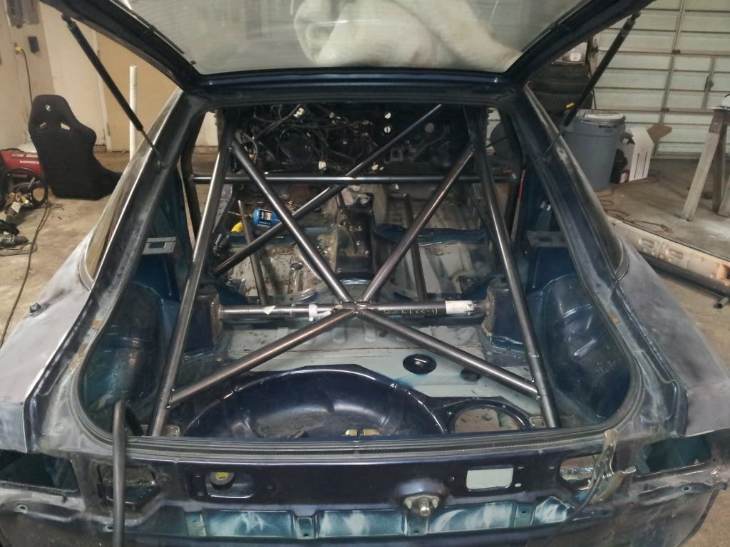

rear of the cage in final, just need the full passes and its complete. on the fronts the door bars mounting plates need to be fully welded as well as the door bars them selves, along with the main hoop

i dont remember if you said or not, but was the cage custom or a pre cut, needed to be fit kit? looks great either way!
rocknrace03 is offline   Reply With Quote
Old 04-30-2013, 10:03 PM   #219
hammtheman
hammtheman's Avatar
Join Date: Oct 2009
Location: Boyertown, Pa
Member #15004
1989 240sx
it was a cut to fit kit, but i totally changed up and modified it to fit my needs and looks. so the bars that tie back to the rear frame were actually meant to be the door bars because the original kit was ment to tie right to the rear strut bar but i didnt like the design (sharp angles and no frame tie-in in the rear) so i tied to the rear frame and x-braced in it a funky sort of way.

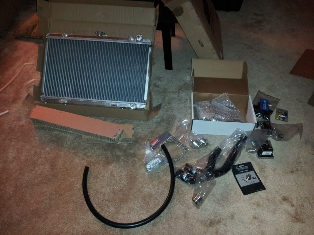

placed another big order today, got everything i need to redo the rack and pinion, brakes, shifter linkage and short shifter for the z32 trans. all i need to order is fuel lines and fittings, brake calipers, clutch/flywheel, and my aem ecu. just need to put everything together at this point...
