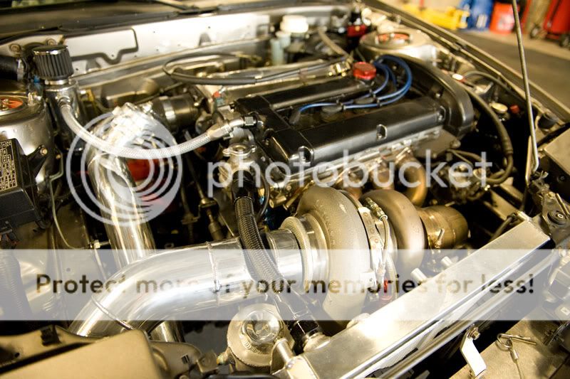

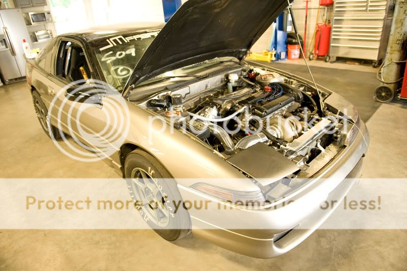

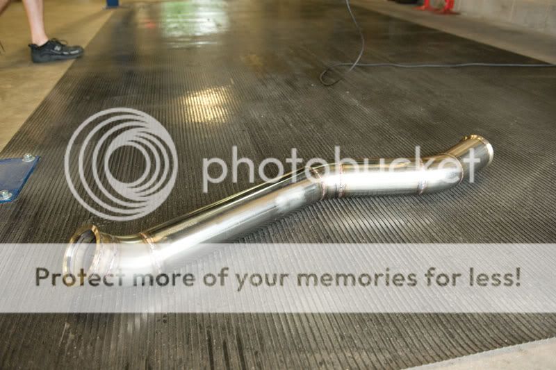

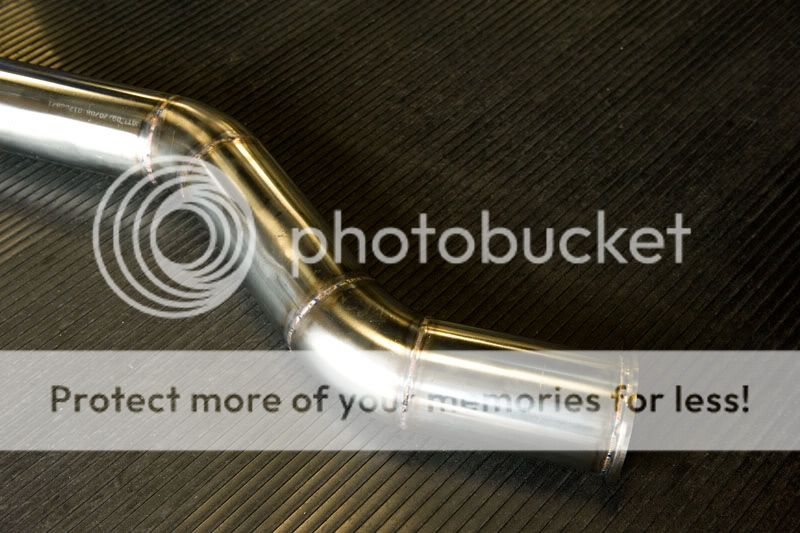

Spent the afternoon down at JM Fab yesterday so they could build a custom 4" midpipe on my Supra. I had tried a 'bolt on' setup previously but it didn't fit right so I got the fab components together and headed over to JM Fab to have them make the magic happen. I already had the downpipe and the catback, but I needed to have a midpipe made that would fit them together properly.
The finished product came out really nice, I'm really happy with the results and its awesome to finally have a proper fitting exhaust on the car.

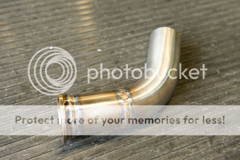

One awesome thing they did was adapt one of my standard Vibrant 4" vband flanges down to fit up perfectly with my (metric sized) HKS Ti 95mm catback. Previously the flanges were slightly different sizes and it resulted in not having a perfect seal, but JM machined the vband down slightly for me so now its a perfect match.
Otherwise just good quality exhaust fabrication which you'll see in the photos below, and I also had them make a dump tube for my EWG as well since I still didn't have one.

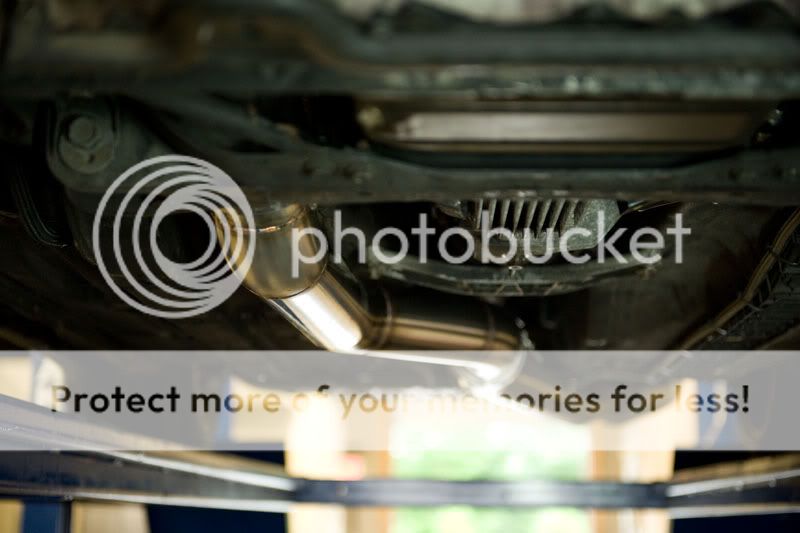

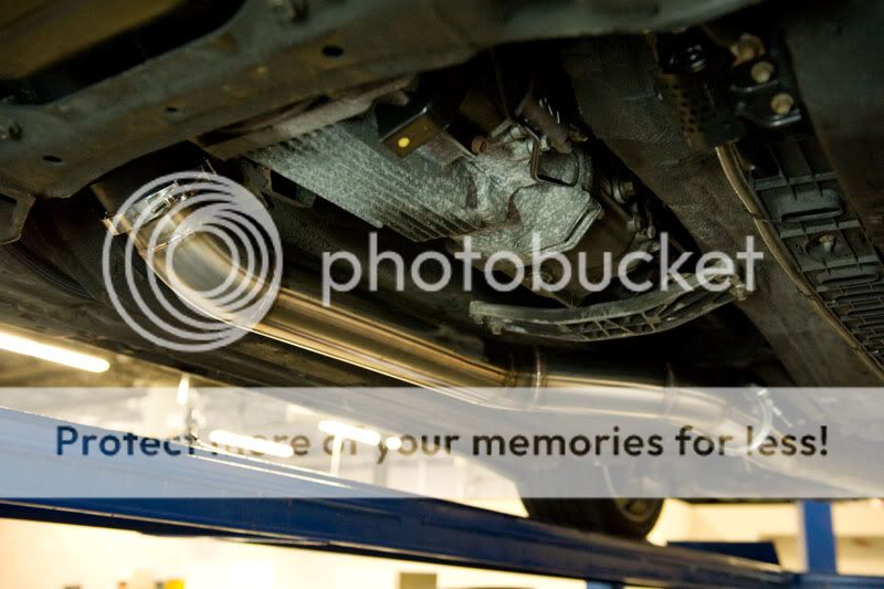

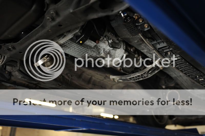

before
before
before

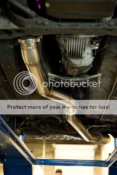

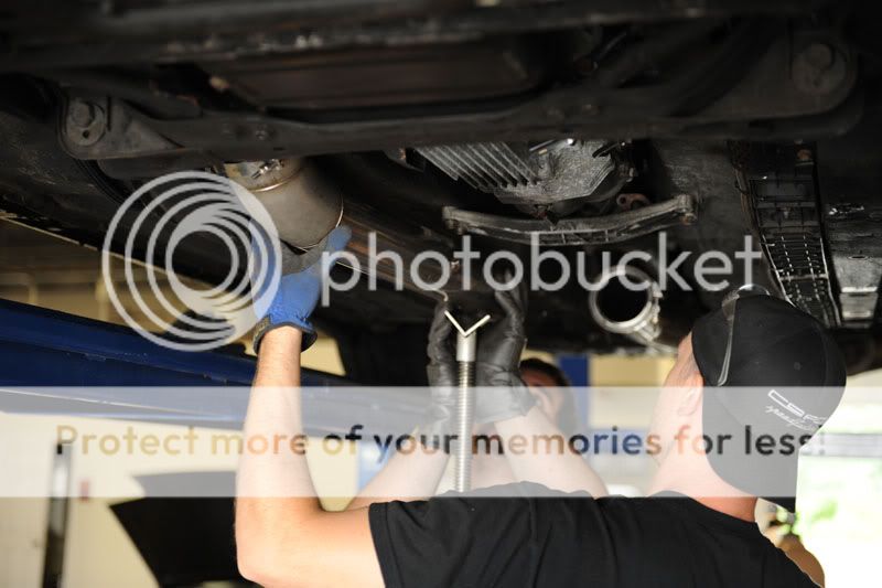

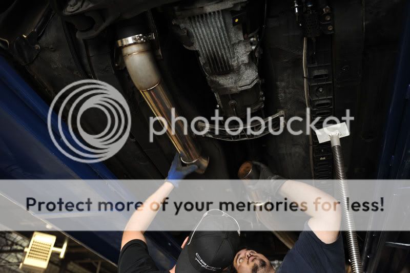

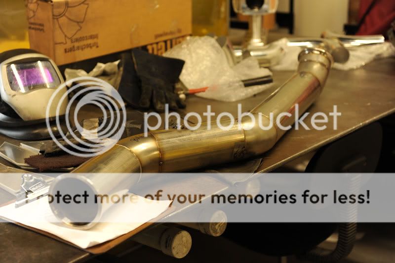

fitting the first elbow to turn back just right. careful balance of fitting it up tight under the car without bent too close
everything tacked up

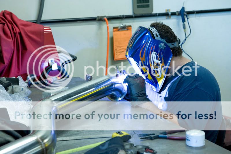

giving the exhaust a nice brushed finish

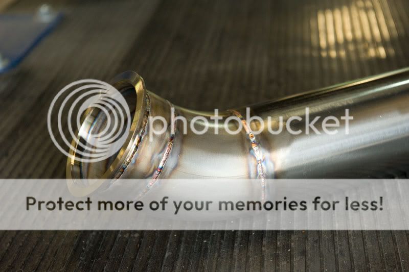

tigging it all up

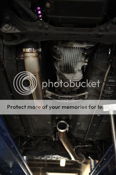

finished product

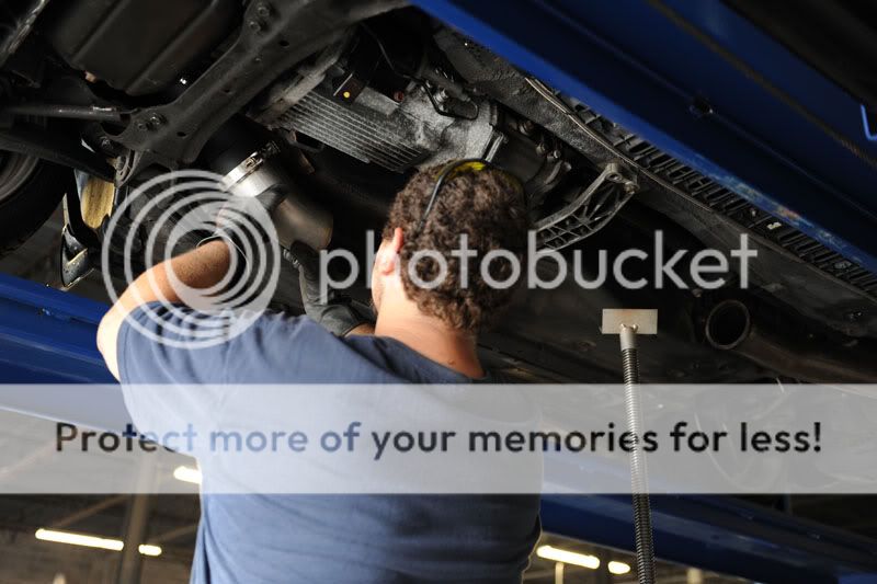

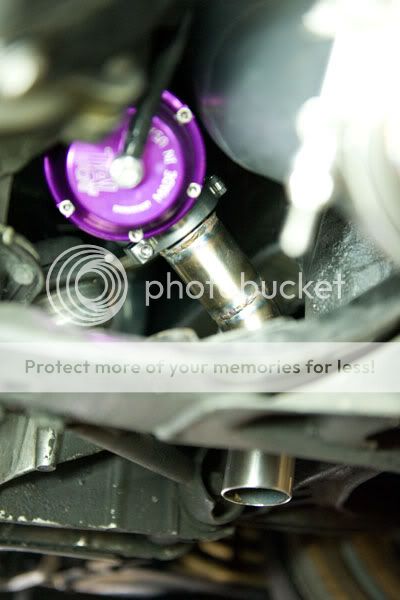

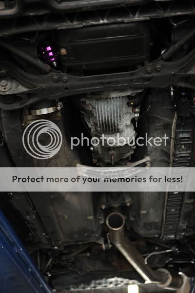

installed on the car and checked to make sure there were no leaks
and the dump tube

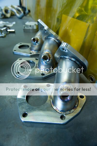

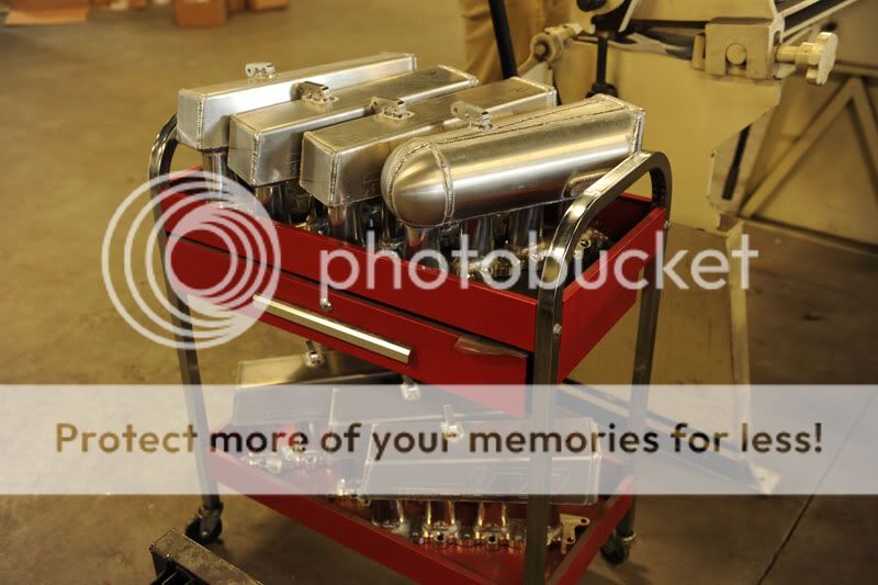

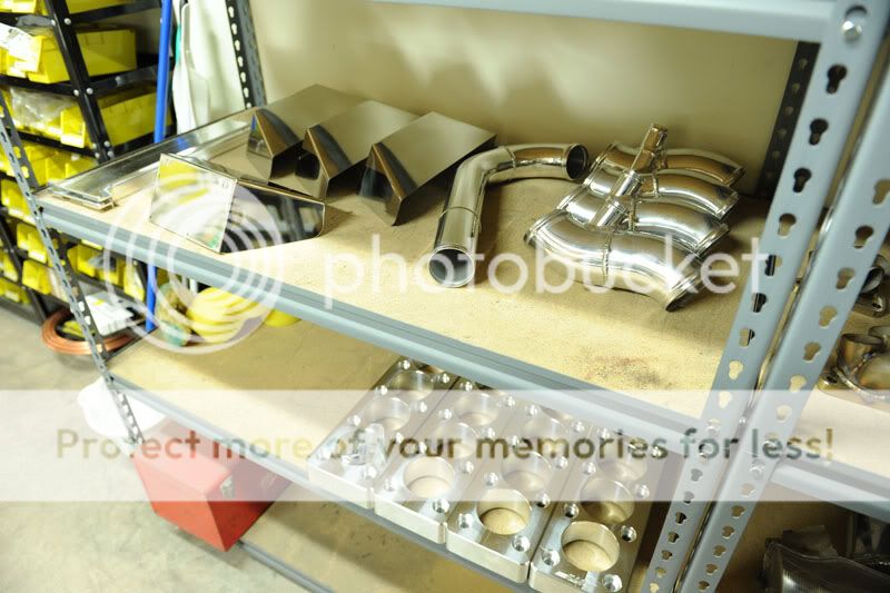

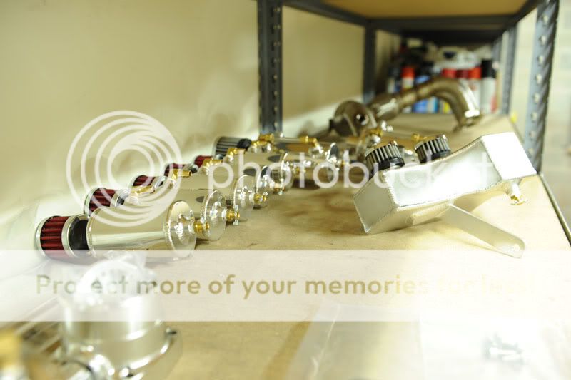

evo manifolds headed for australia (not finished yet)

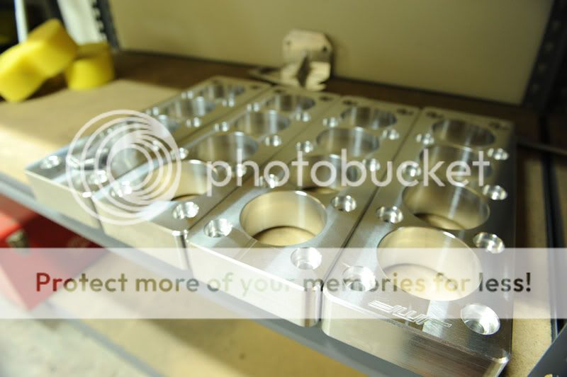

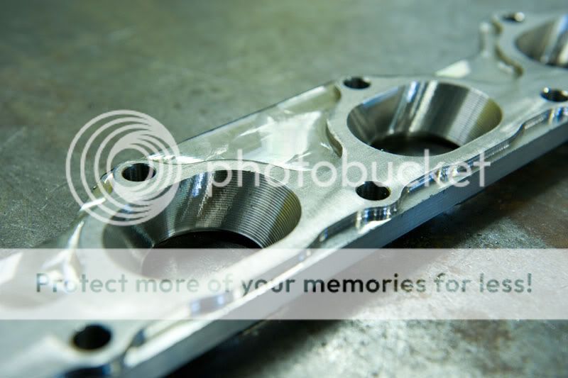

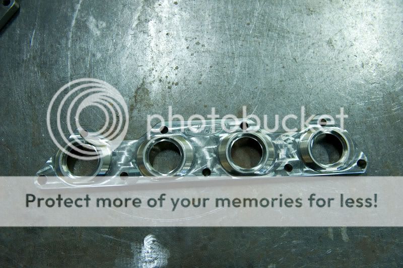

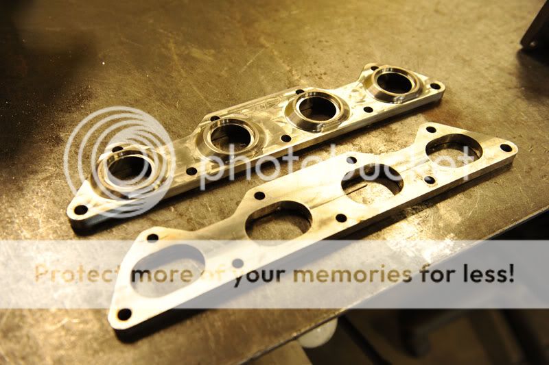

new head flange... i think for an evo but correct me if i'm wrong. i'll let them go through the benefits of it if they want...
