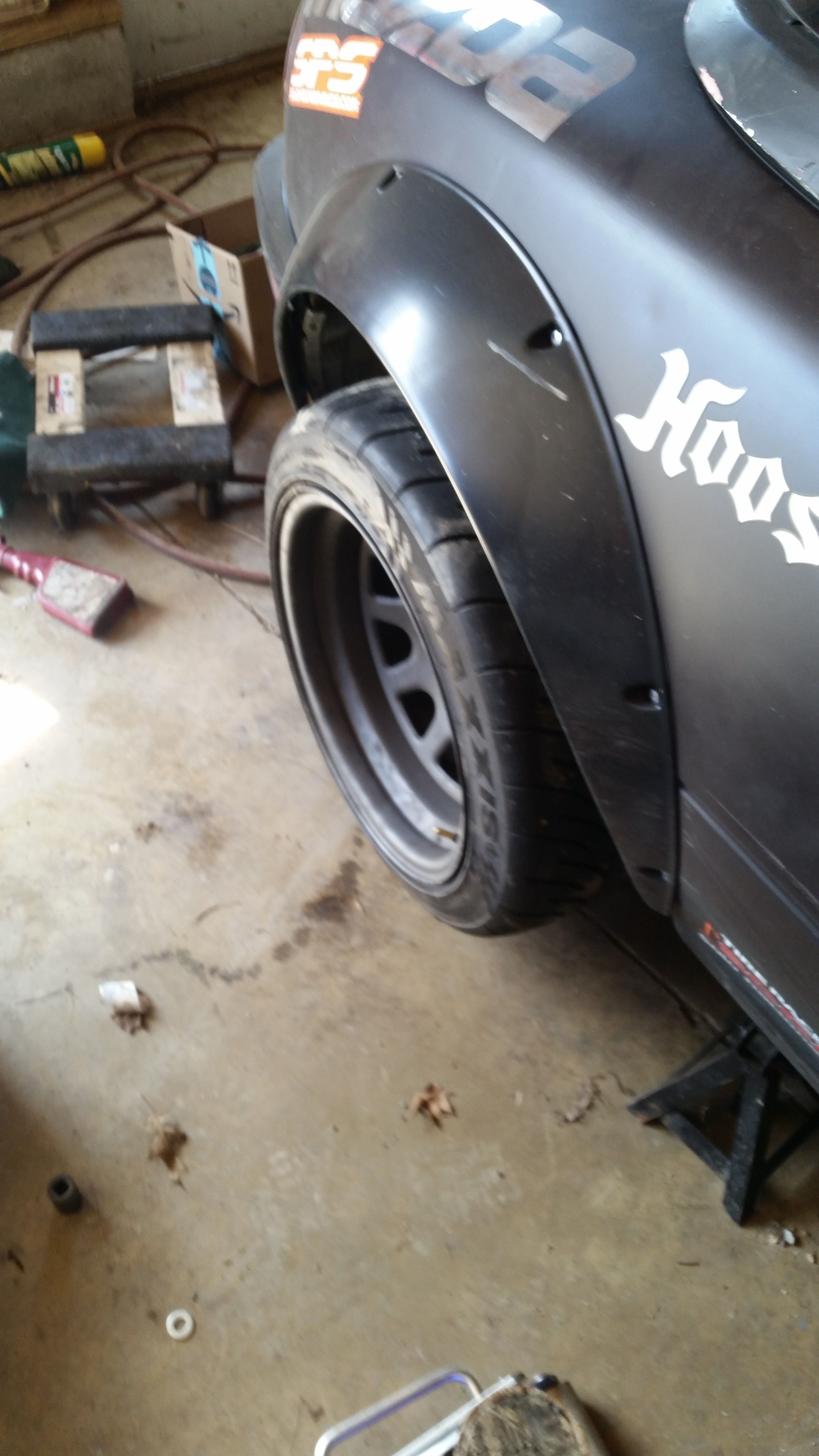

I think I did a poor job explaining the tire clearance issue. For me, on a NA, its all about clearance at the outside back of the wheel well. Especially that stupid tab that sticks out.

It's still crazy to me you can run tires this wide. I'm surprised the power steering assembly and rack can move all that grip efficiently!

Skreet tires were mounted. Some comparison shoots 245 vs 275 vs 295.
