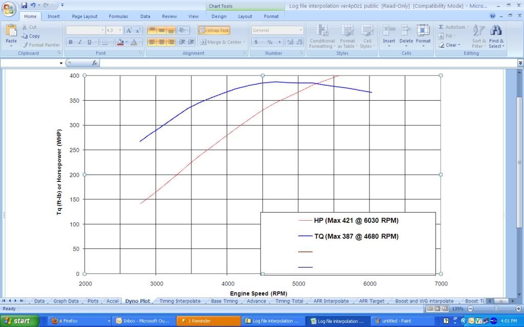

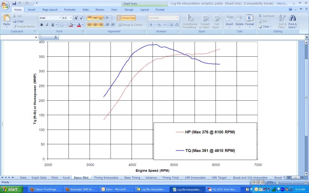

This is a previous customer i had tuned a few weeks ago who now added an ewg setup and wanted me to get a little braver on his tune. Previous tune his car made 376 whp but the wastegate was doing some funky stuff due to divorced dp divider hitting flapper so he switched to a tial 44 ewg. went up a little on boost a little on timing and leaned it out to about 11.2 11.3 afr
Vehicle:2010 Sti
Boost: 22psi
Flash Method: Cobb E-TUNE
Mods: Dominator 2.5 XTR, 850cc injectors, Walboro Pump, Turbo xs Fmic
old tune doing funky wastegate crap

looks good Ray, how do you like that turbo, say, compared to the dom3?

Wow, that's one sweet looking curve. Must be really fun to drive!

This turbo is amazing, it spools earlier than the standard dom 3 and also seems to be holding better boost and such.
