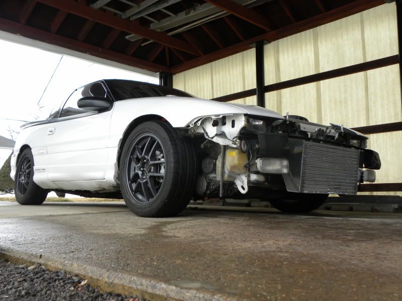

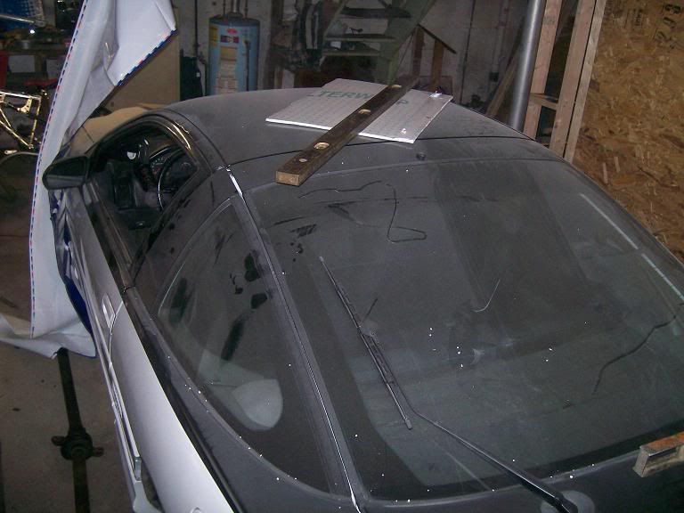

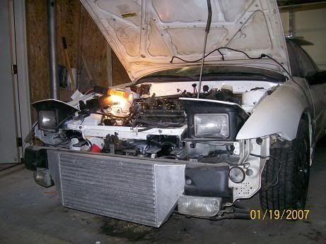

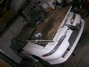

I don't have any pictures of when I 1st got it because my camera was broke at the time. This is a picture about a month after I got it. I started to do some remodeling on my house and the car became a tool shed.

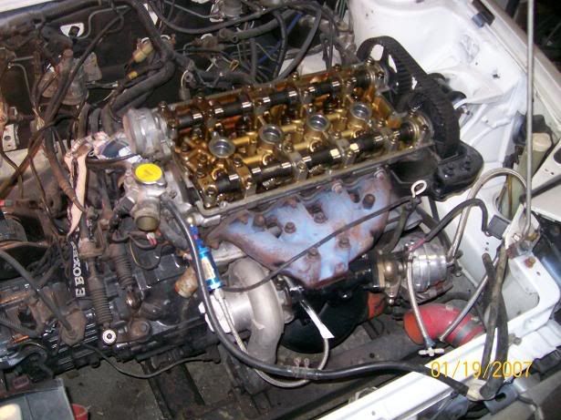

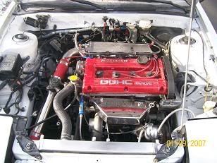

I was smoking alot and did a compression test. Ended up being the head gasket. New Headgasket, FP2 cams and picked up a gt-12 for a great price.

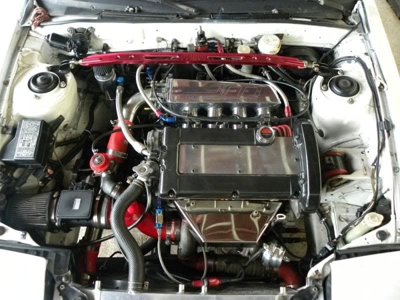

Now skipping a few years (lost a lot of pictures)
Gt-12 BB Turbo
SBR FMIC
Fluidyne Radiator & Slim Fan
2g mas and 3.5" rigged intake
Ported and Rebuilt 90 TB
JMF SMIM
FIC 650cc Injectors
Walbro 255 Pump
Aeromotive AFPR
Earls Fuel Filter
SS Feed and Return for Rail
Ported 2g Exhaust Manifold
RNR O2 Eliminator Downpipe
3" Custom exhaust with Megan Muffler
Tial External Wastegate
SAFC
MMCD Logger
****ty Trans
3 Bolt Rear
Stock Struts and no name springs
3g Eclipse Wheels
I also deleted everything I can under the hood and moved some things around to clean it up. Added Manual rack, deleted all emissions and relocated the battery properly to the rear.

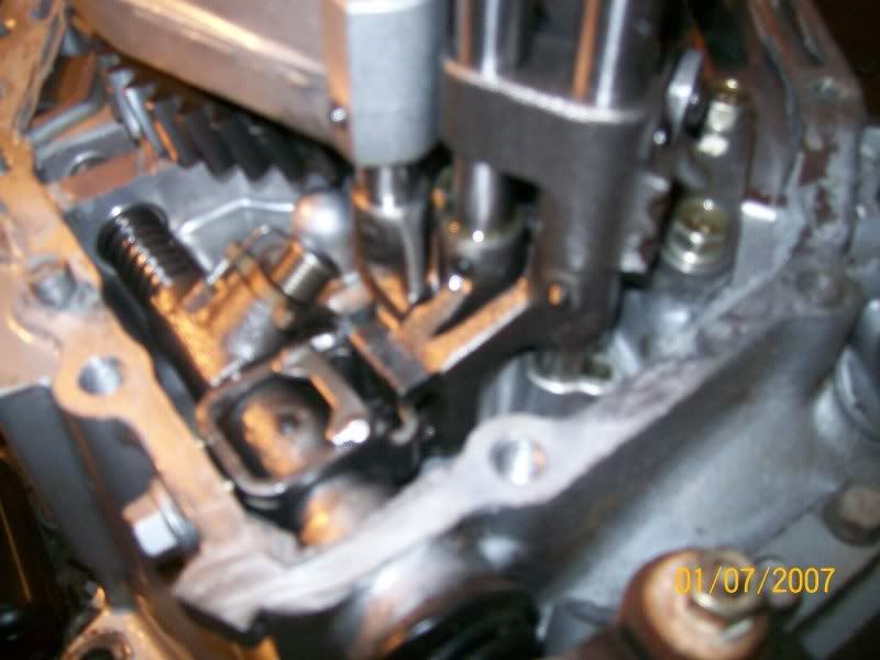

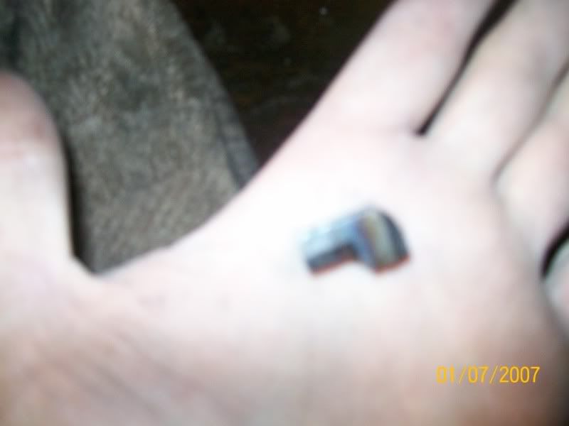

Throughout the season I had trans problems. Could never hit second, continued to race and broke a shift for. Got the car in 3rd gear and drove it about 60 miles in 3rd gear. Burning the clutch when needed to get going. Got the car home, removed the trans and burn ACT 2100.
Sent my center diff out to be welded, TRE double syncros and new evo forks. All the bearings looked good so let it go. I got the new trans in and did one hard 2-3 and broke a shift rail. Removed the trans again and replaced the rail.
Put everything in again. Banged the 1-2 like butter, shift to 3rd and griiind. I was pissed. Got in a parking lot, launched it and snapped the rear axle. Picked up a 4 bolt from a friend.

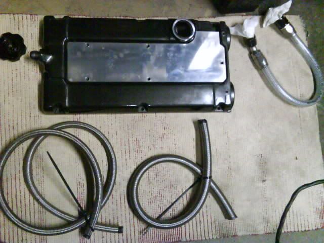

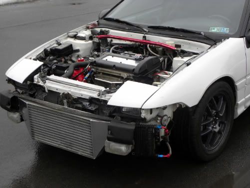

Over the past few months, I've been working on it more then ever. I was using a Coors Light can for a catch can for some time. I finally got a nice shaved and powdercoated valvecover with -10 AN fitting welded on.
I also picked up a Dejon intake pipe to clean up the old setup.

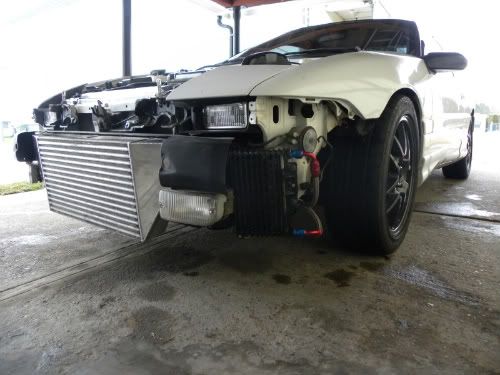

I recenty removed my bumper and hood for some more room. While it was off I polished my end tanks and removed the oil cooler from between the radiator/intercooler. Got some AN fitting and relocated it on the drivers side where it can get some air.

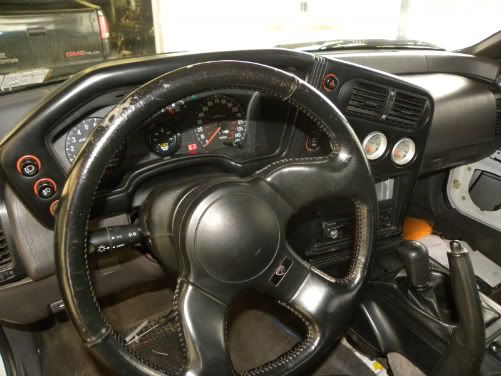

I was hoping the get DSMLINK in a few months so I picked up an AEM Wideband. I removed the gauge cluster and removed the stock oil pressure gauge. I did some trimmed and slid the AEM in its place for an almost stock look. While on the gauge subject I removed all my heating knobs etc and built a plate to hold my boost, water temp and oil pressure gauges. I kept the heat in the car because I like to drive it in the winter. I have control of fan speed and temp only.

Nice, man. Loving what you did with the guages, very similar to my set-up.

Nah, plastic if off and the WB doesn't have the bezel on it. It's unfinished, but functional, haha.
