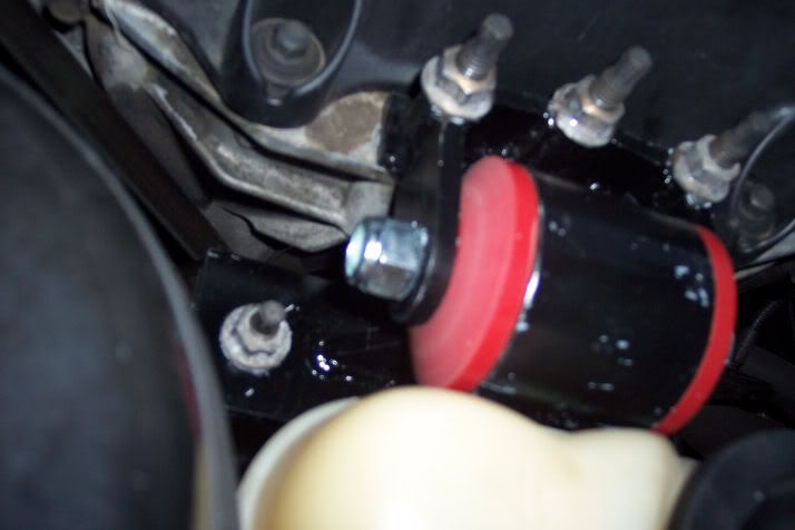

Oops.
I knew it was going bad, I just thought I had a little more time until I started the car this morning. XD
(That's my torque axis mount...or what's left of it.)

Nope. This mount is 5 years old and completely custom.
Stock mounts are garbage. It's almost 100% solid. The poly was 96a(?) shore. Maybe 95. It's whatever the highest is.
What it looked like new:
Stock:

There were only 5 of these ever made. I have the 2nd one. They're all the same, and they hold up REALLY well. But apparently when they fail, they fail.
And noise was an understatement. At first it sounded like my hood prop fell out of its bracket, but it got progressively worse. I drove Hoss to work today instead of the Satillac.

Poor design - remake it with a solid delrin or urethane bushing (no halves) pressed in and WASHER on either side so the bolt and bracket aren't the only holding points.
I really dont know why there WASNT a huge ass washer on there. All of my mounts have ginormous washers.

Yeah you need them to hold the bushing otherwise you just end up deforming it. I have urethane bushings in control arms and such and have huge fender washers.

6" length for $36 and about 45 seconds in a lathe. This is assuming ~2" diameter. Center drill on a lathe, turn down to ID of sleeve, fender washers and a bolt and nut. Simplest thing ever - hopefully you didn't pay too much initially. Its 95A duro, if you want harder than that you need nylon 6/6 or kevlar nylon - about $17 - $60 a foot in 2".

Forget the lip. You want a solid single piece that you will press in and have ~1/16" of an inch longer than that sleeve which will have fender washers on either side. The two piece design is why it failed. You also want to drill a hole down the center and press in a stainless "sleeve" through the bushing to let the bolt ride in snug-like vs just tearing the bushing material.
Like this:

I don't want to go any more solid than the hardest poly. (95a, 96a?). This hardness already puts all engine vibrations into the cab. Being that this is the mount that my engine torques off of and it's bolted to my TCC, I don't want to risk going any harder.

The tube that it was meant to fit was 2" ID long. The bushings consisted of 2 bushings on either side that went in 1", and stuck out around 0.25", with an OD on the "lip" of 2.5"
From the e-mail
So, from this, I get 2" ID, 2" long.
And from the now-defunct "lip", 1/4" thick and 2.5" OD.
I think the lip was there to keep the bushing from sliding, if it were to happen. Keep in mind this is transverse, so the engine torques to the firewall, which may or may not have some effect on the bushing and sliding.
