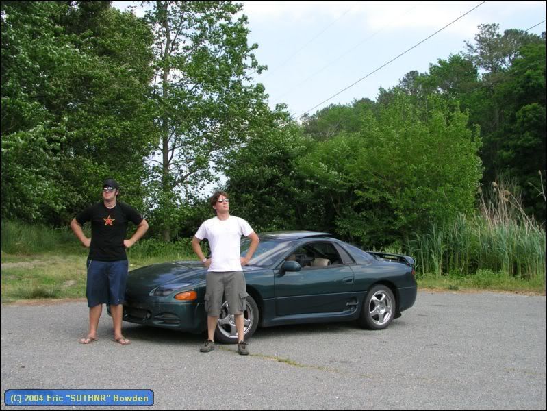

This looked like fun, to create a thread about what the car's been through, where it's at now, and to post progress as it is made.
The car's short history:
Bought it in June of 2003. Just got home from my freshman year of college and saved up some money, sold my Acura Legend and borrowed $2k from my parents to buy the car. $9k w/ 120k on the clock.
After replacing the leaking BOV, bad plugs & wires, and installing a testpipe it ran like a dream. Then it started to get harder and harder to shift into 1st, so the tranny came out and apart and in went a new 1-2 sychro, 1st gear, 2nd gear, reverse gear, and reverse synchro (yes it's synchro'd on the 3/S). Also a new TOB, clutch, resurfaced flywheel, and 3" downpipe.
Drove the car like that, with an intake and MBC for a couple years. Ran the 12.7 @ 109 at Island in the spring of 05.
Spring of 06 I decided to take the car down to rebuild the engine, fix a reverse blockout issue, and install my 13T's and 550's. It went down in March, and in May it was back together. But, I didn't re-shim the end tapered roller bearings when I put the tranny back together so it melted some internals. In october I finally got a new tranny in, and a friend of mine (Hans GZP) dyno'd it. Some stuff wasn't hooked up right and the newly rebuilt engine spun a bearing.
Fast forward to spring of 07, sold my motorcycle to buy a new OEM shortblock. Brought the car to Philly and installed the new shorty, drove it home to Williamsport in June/July.
Since then, I have replaced my radiator & thermostat, tranny fluid twice, oxygen sensors, and installed an SAFCII, greddy profec-b, etc etc.
Now I am dealing with a fuel leak around my pump assembly gasket and either a boost leak or a bad EBC solenoid. In addition to the damage caused by the hail in Muncy ... which Geico is trying to screw me over with.
So that's the deal, hopefully I'll have a new hatch on this weekend and a -AN converted fuel pump assembly on a new gas tank soon after. Then I'll be tuning for ~16psi on the 13t's and 11's at the track.
-Ryan
