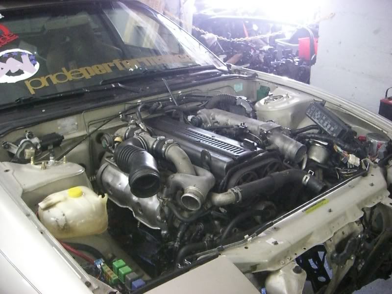

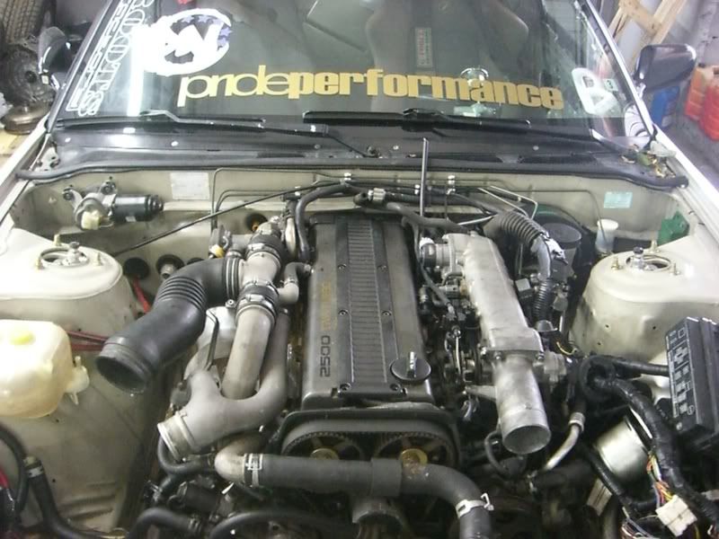

Ok so i have posted in a while so i thought i would give you guys an update on my car. I just sold my RB20 for 2500. I went to jdm engine depot and went shopping. Lets see if ne one can guess on what motor i got
Pics will be up soon

no way, are you really doing that? haha... i was expecting an RB25 but figured i'd go out on a limb.
so are you really doing a 1JZ?

yea i was seriously thinking about doing the rb25 but after doing some research i was set on getting the 1jz...so i have it sitting at my shop...i have everything to put it in except for a front sump oil pan, i have a rear sump on the motor now

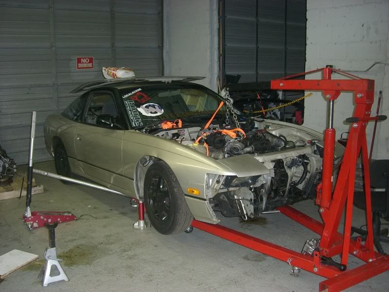

ok so told i got some work done, not to much cause the power went out in the shop and we had no air compressor or welder.
srry for the crappy cell phone pics.

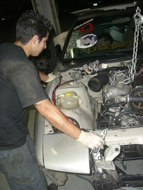

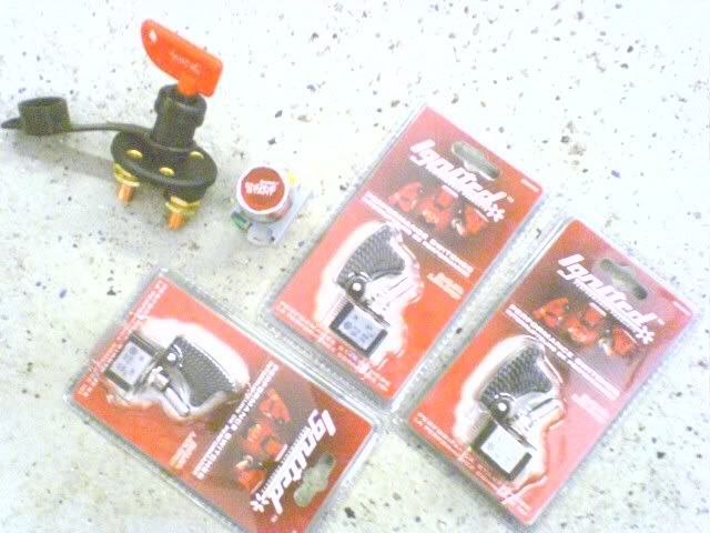

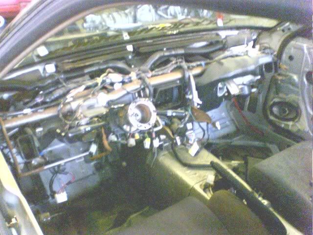

Took out the dash and started removing the body harness, we are planning on deleting most of the harness to run the only the necessities..
Kill switch, push button start and my switchs were running:

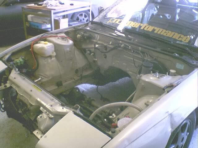

Still in the process of removing everything out of the engine bay:

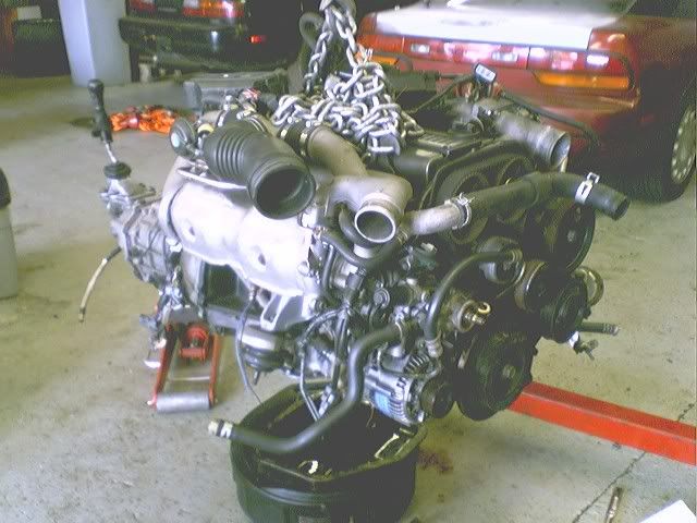

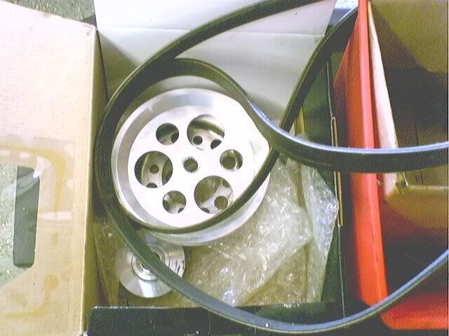

just got a set of unorthodox pulleys, they were originally on our lexus sc300 shop car:

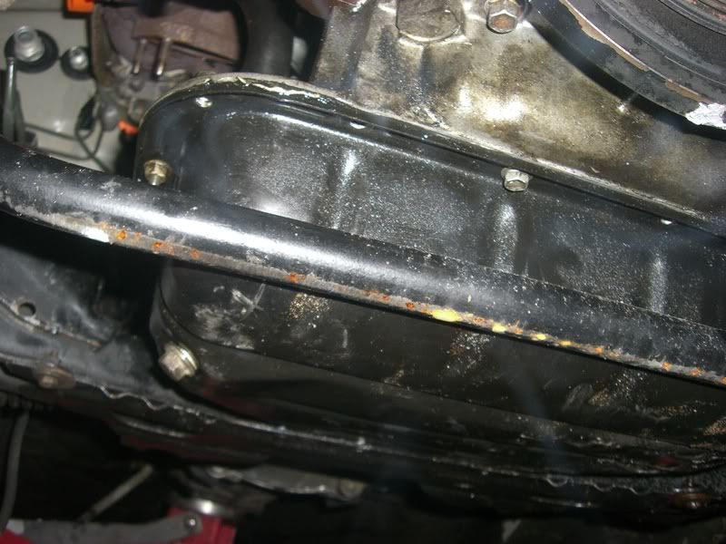

Last thing is i removed the rear sump oil pan and waiting on getting a front sump oil pan this week:

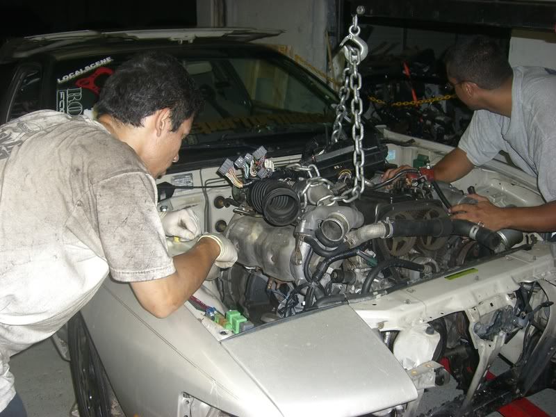

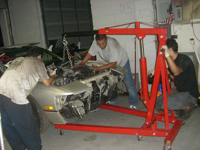

so heres a little update over the last couple of days...i havent really had time to work on my car due to the fact that we are swapped with customer cars but heres what we got done.
Us trying to figure out how to mount the motor:

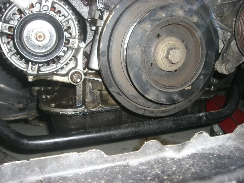

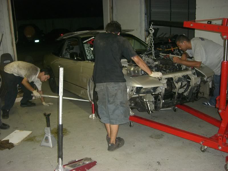

we finally got it in but i wasnt to comfortable with the way the oil pan was sittin, according to Tech 2 you have to space out the sway bar so you can fit the oil pan. I said **** that and started marking the pan so i can notch it to make it fit:

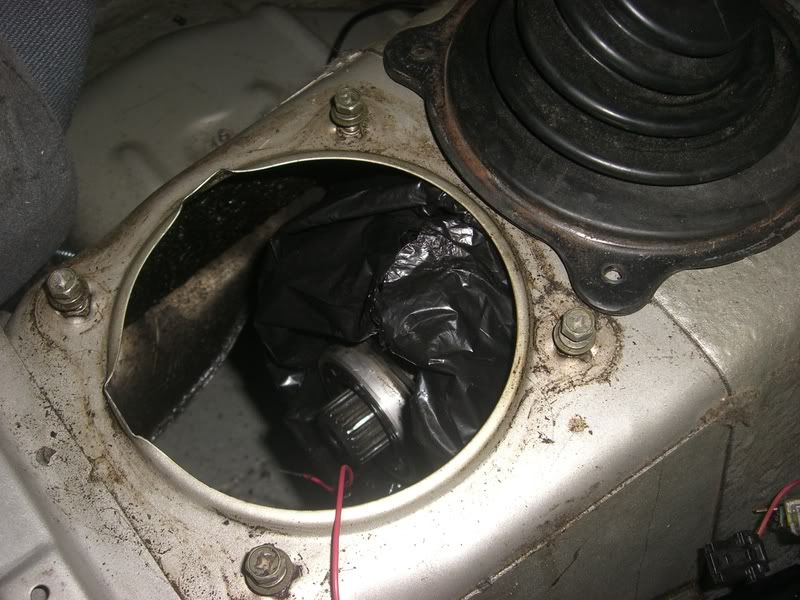

next up is the shifter, here is where the stock location would be on the r154 trans. Im in the process of fabbing up the shifter extension:

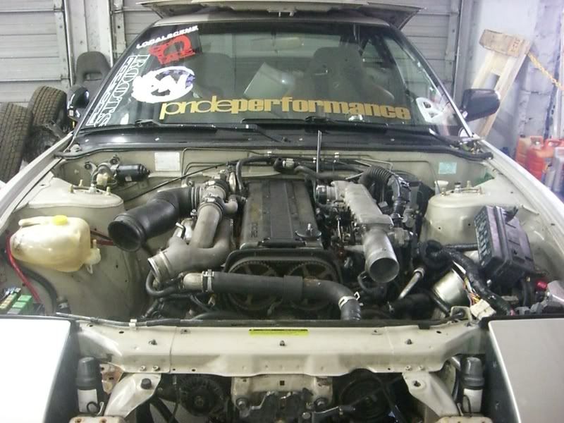

So we took the motor back up and made a mock up oil pan and put the motor back in:
And wala heres how the motor sits, we have it on 2x4's on the the mounts so we can mock up the mounts tomorrow:
