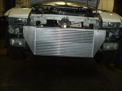

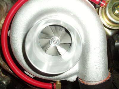

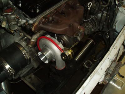

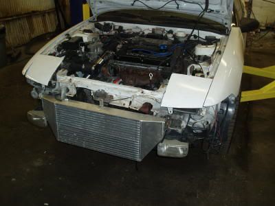

My car has been undergoing alot of changes over the past I dunno 2 months since I dropped it off at Precision Dyno Tuning.... The car should now be ready to drive and break in all the new parts by this coming weekend to bad I'll be back at school by then... but I was there today and took some pictures and got to drive Americas fastest Evo IX at the moment.
New fmic: Buschur core and custom endtanks
New turbo: PTE 4431
turbo and evoIII exhaust manifold with a spacer so the turbo can clear the block
Motor shot
TurboTrix tuned

must be nice when the turbo is big enough for the need of a spacer for the exhaust manifold

what front bumper is gonna fit that front mount or are you just cutting it out?

the front bumper is at the paint show right now, when it gets back Nick at precision will just be cutting it fit has needed
