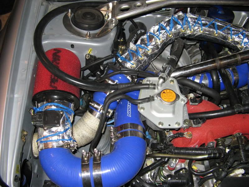

I just found an old pic I remembered... this was before Perrin released a fix, other guys were doing things like this and finding that they worked. Its just basically tweaking the design before and after the MAF to help ensure a consistent reading...
