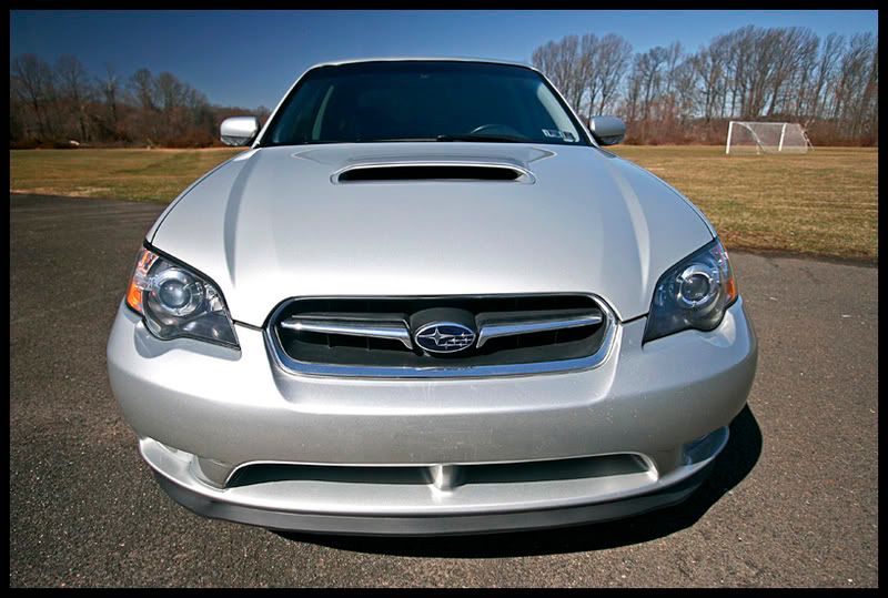

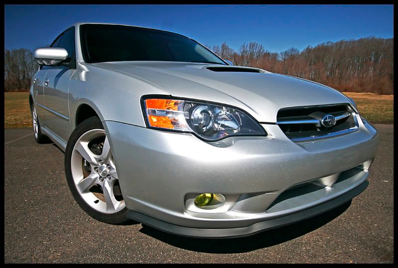

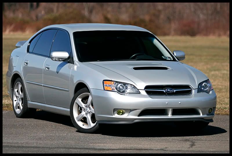

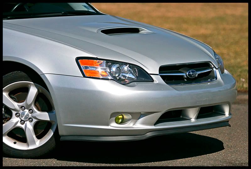

got bored tonight so i made a trip to home depot to get the parts to make the lip since i've been wanting one but don't have the cash for a real one. i like how it came out, no weird creases or waves in it. i'll take real pics tomorrow after i clean it. let me know what u think

He used the rubber material that is made for garage doors. Looks real clean

thanks guys. i love how it looks and you can't beat it for about $10 bucks if u take the time to line it up right. like vypurr said its a garage door sealer from home depot. ill have good pics up tomorrow to really see how it really looks outside. hopefully it looks as good and better than it does just in the garage

i used the 3M super heavy duty double sided tape and no screws cuz i didnt want holes in my bumper

took me about 10-15mins including the prep. i wiped down the rubber and bumper with rubbing alcohol first then used a hairdryer to heat up the tape to make it stick better
