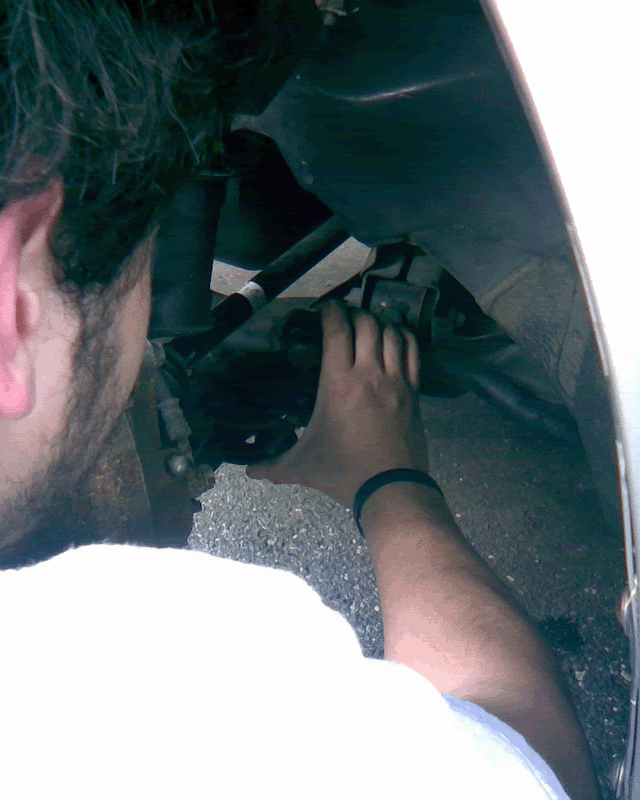

well to those who said endlinks, you were correct. i just got done replacing them (and cutting my fingers on every part i could find in the process) and drove around. clunking seems to be gone, and i compared the new ones to the old ones, the older ones had a lot of movement....new ones did too, but the new ones were nice and tight, compared to the old ones that were more loose and felt like a joystick
Old 04-19-2007, 06:09 PM   #19
At work doin a test-fit
old link
unscrewing the new bolts to install
