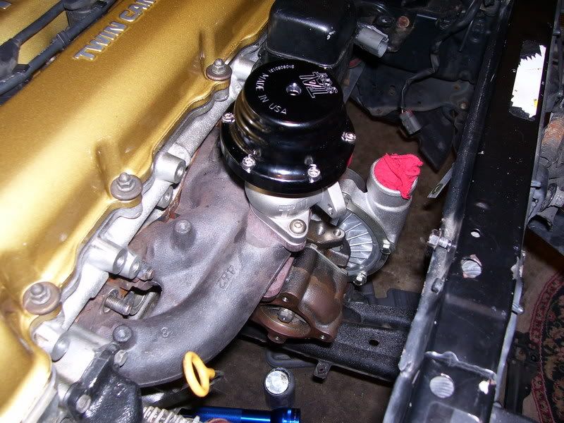

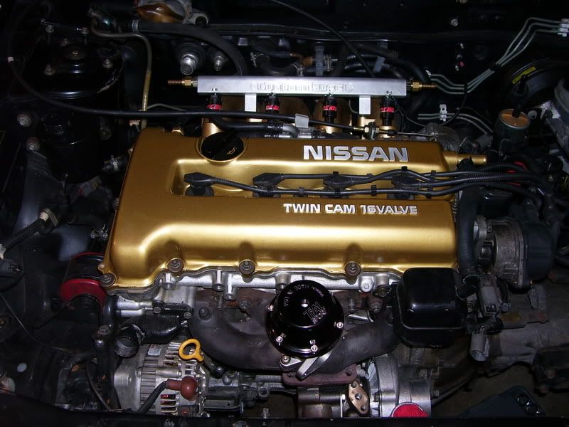

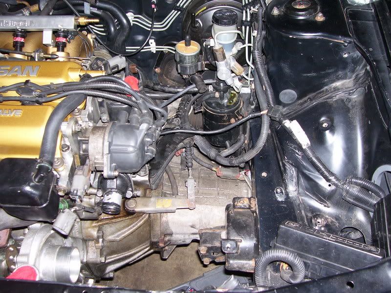

More progress...Turbo set up is complete for now ;) Pics on page 2
Bought this car for $400 bone stock and no motor under a year ago, and it's coming along quite nicely.
In the last few weeks I have Installed S4's and mocked up my fuel and turbo setup. I have also been trying to hide as much of the harness as possible, and tidy up the vacuum lines. In order to get the turbo to clear the block I had to do a little grinding, oh well. Hopefully I'll have it running by the new year.

phat ... specs?
Stock block SR20DE
JWT s4 cams
RC 550cc injectors
GTI-R manifold modified for t3 turbo and external gate
z32 MAF
T3/T04E
Tial 38mm
3" turbo back dumping out the side
As for power, anywhere between 3-400 depends on how much the injectors can take.
