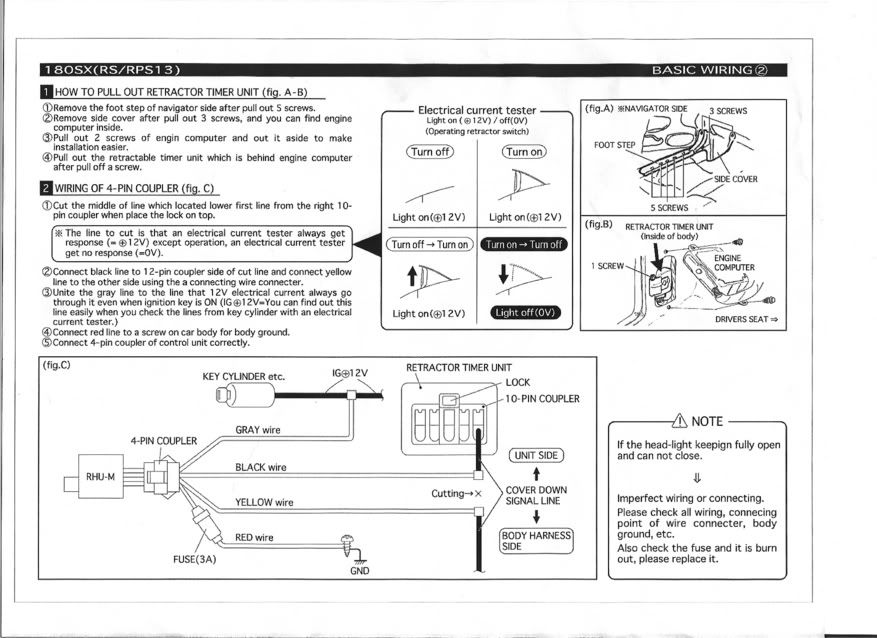

seein if anyone had succesfully installed a pivot controller for a 240sx ,the directions are for a 180sx so everythings backwards.
heres the directions -
i cant find the retractor timer unit,and i dont no where to plug the yellow wire at,it just shows the yellow wire being pointed to the body harness side?????
hopefully someone knows, any help would be great thanks

Find a little black box located inside the driver's side kick panel.
Cut the pink wire.
Connect the black wire to the pink wire toward the box.
Connect the yellow wire to the pink wire toward where the wire coming from.
Let stand in microwave for 2 minutes or until cool.
Done & done.

yeah, me and a friend of mine figured it out yesterday,had everything hooked up,but one of the fuse's is burn't out.
