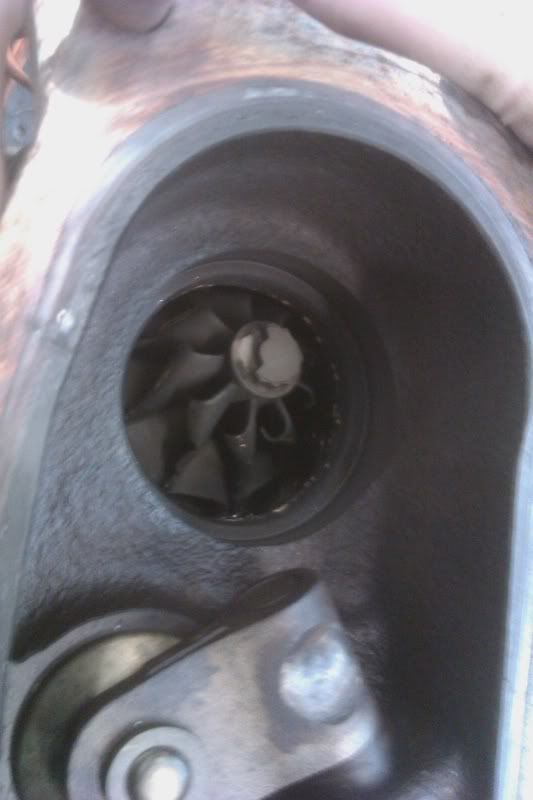

So came across a chance to pick up a 2005 Subaru Legacy GT for a really good deal, and just couldn't pass it up.
The problem with the car though was that the turbo went bad and in the process all the oil was expelled out the exhaust. Don't know if it was driven with no oil pressure or not. Only when I started it, it ran and the oil light didn't go out. Knowing these motor I did a leak down in cyl. 4 and sure enough 38% leak down. So the costumer traded the car in and I bought it. Now the good part. FREE turbo. The turbo was actually under parts warranty as the previous owner had it replaced 6 months ago in Colorado. had the oil change receipts and it was covered(they knew the turbo was covered before they traded it in).
old VF40

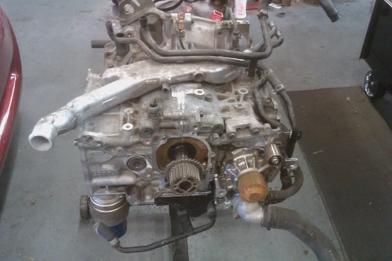

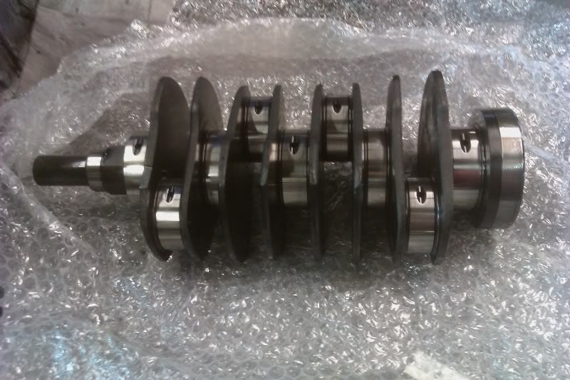

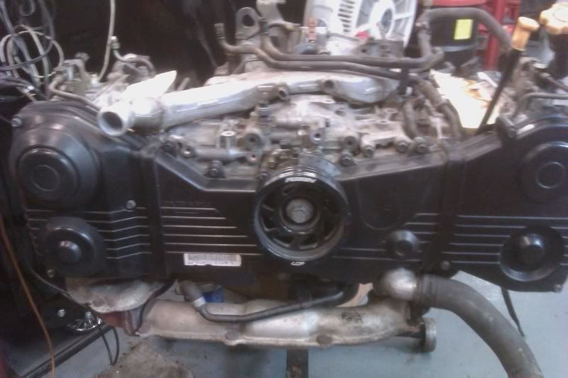

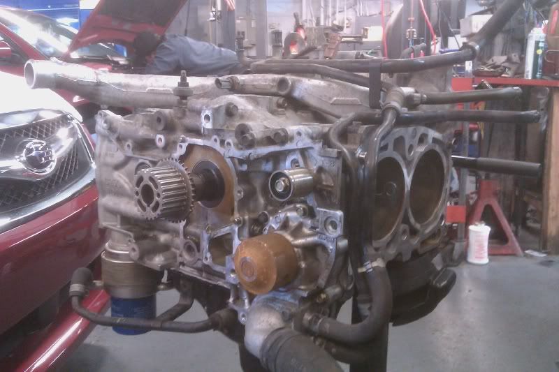

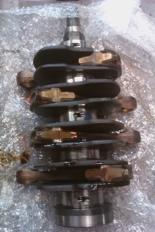

So pulled the motor apart and the oil pump was shot, the crank was scored and bearing material in the oil pan. All the oil rings were stuck and some of the compression rings were as well. Time to order some now parts. Ordered a 2010 Sti nitride-treated crank, ACL main and rod bearings and oem rings(on and budget can't go all out)
ACL rod bearings and oem rods installed
Once I got the block all cleaned up and checked out it was reassembled.

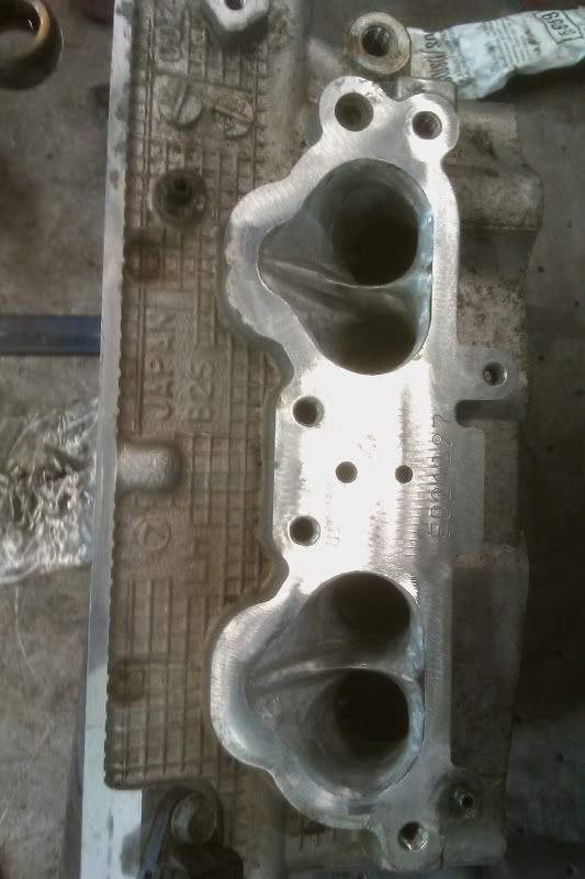

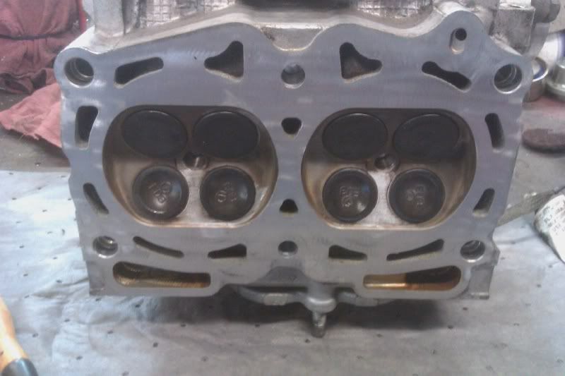

Cleaned the heads up and relapped all the valves and moderately P&P the intake and exhaust ports.

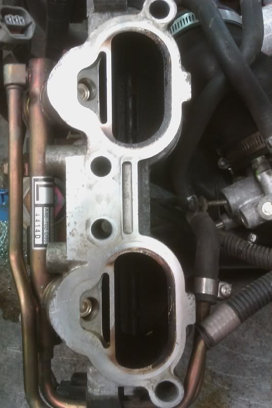

Since I had the intake off I did a TGV delete.
with/
without/

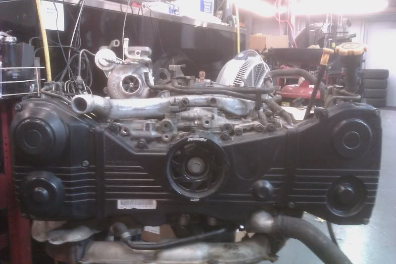

Finally reassembled took about two weeks cause of waiting for parts.

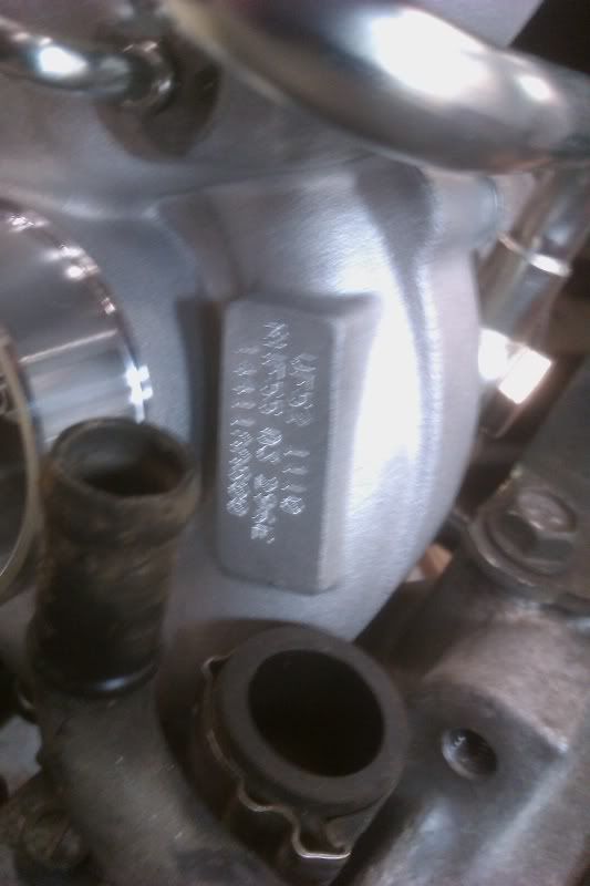

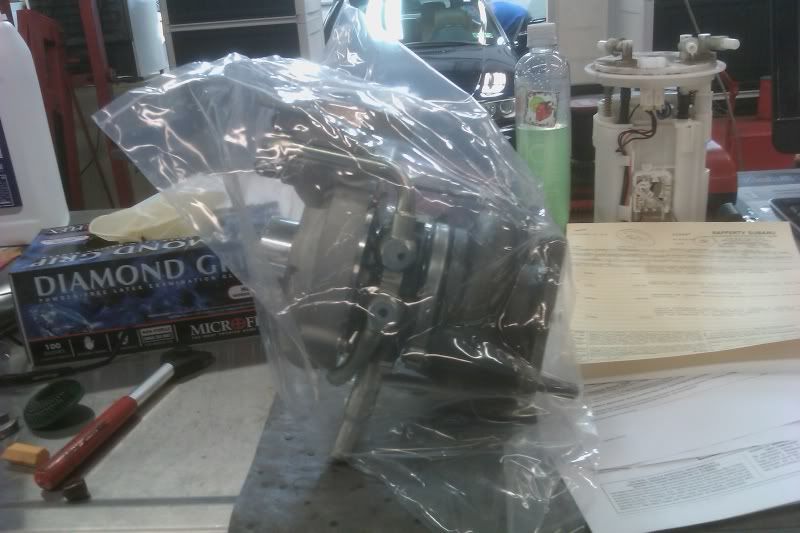

turbo came in too.
Funny this turbo says VF52 on it not VF40. (sorry bad picture)
Got the 40 and handed it back in and HELLO VF52
While I did the motor I also installed a Walbro 255 to go along with the larger turbo. and a that point I was done. Put the motor in and had Ray from turbotek send me a safe break in flash and no codes so I could get the car to pass pa emissions. oh and no more bug shield

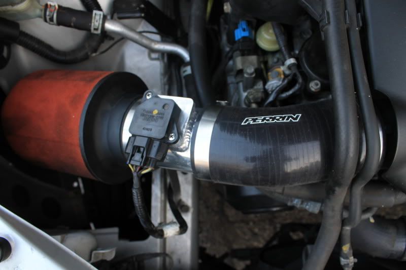

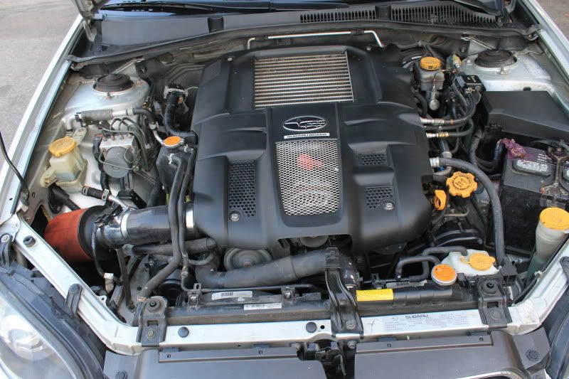

Just picked up a Perrin short ram intake and got it installed

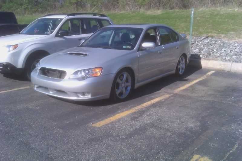

I'm in Glenolden. Hoping now that its getting nice out to make it to the Monday meets.
I'm hoping to get it lowered and tinted for the summer.

I'll make the silver work for me. I think lowered with the right wheels and I won't even care about it being silver. I pretty sure there are the wheels I'm going to go with.
18x8.75 +35 Chromium black. I will need to get my fenders rolled but I think it'll be worth it.

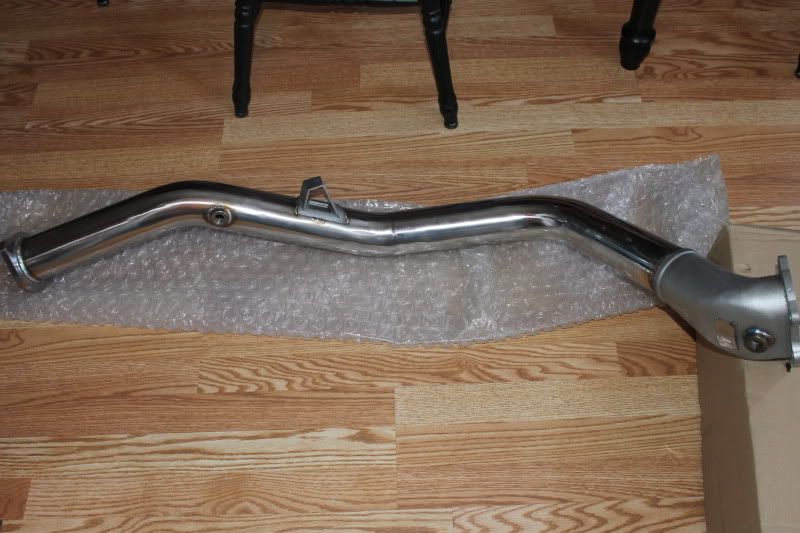

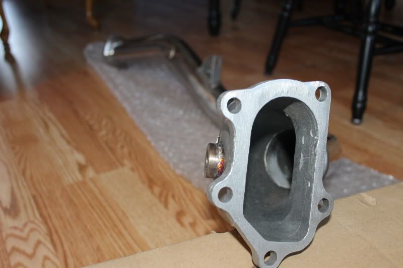

Got my down pipe yesterday. should have it on tomorrow with my cat back exhaust as long as I have time.

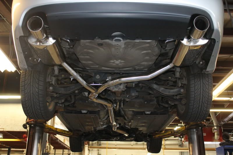

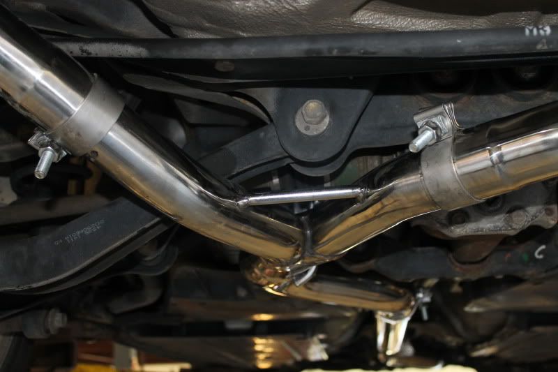

Yeah I was able to get the down pipe and Cat-back on. Still need to mess with the CBE a little more. Not happy with the way the one muffler sits. I'll take care of that next week. I'm happy with the way it sounds though.
Once I get the mufflers straightened out I'll get the pipes tig welded to get rid of these clamps.

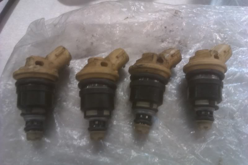

Got some more parts on the car over the past couple week. Installed a set of DeatschWerks 740CC injectors. Had Ray from TurboTek Tuning do a road tune for the car. It feels great now. Nice to be able to open it up and enjoy it.
