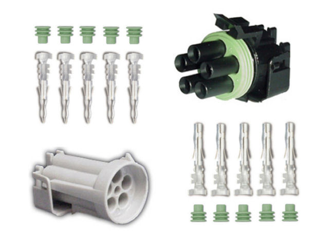

So finally had to some time to work on the car today. Started to working on the standalone harness today.
The carboard cut out is the template for the mounting plate that I'm going to installed where the old ecu was. I made sure that I have space for another relay for an e-fan for sometime in the future. The fuse block just made it in, once I bolt it to the mounting plate everthing should be nice and neat.
This is where is going to get mounted
And laid out some wires
Little update, pretty much done with the engine harness. All that's left is the red and blue wires where are for the injectors. The rest of the harness that you see is the CAS, tps, air and water temp. The only one you don't see is the my ign coil terminal which it's already connected on the other side of engine bay. I might change the shrink tubing that's between the water and air temp and replace it with the asphalt loom. But I might not since you won't be able to see after I install the intake manifold.
I'm waiting for this to finish my injector harness. If I ever need to change injectors it would be easy.
