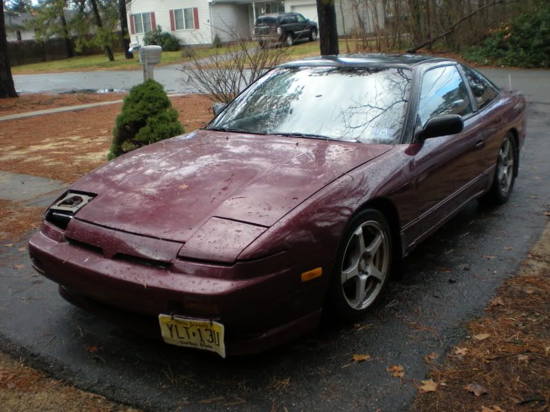

This is her when I first picked her up

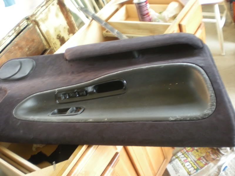

I removed the tach, swapped steering wheels, swapped in S14 seats, did the headunit wiring, removed the nasty cloth on the door panels, had my gf make me a banging bandanna shift boot and cleaned the **** out of everything.

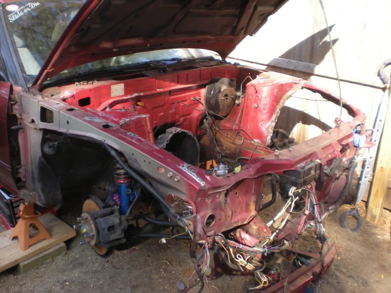

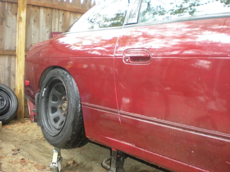

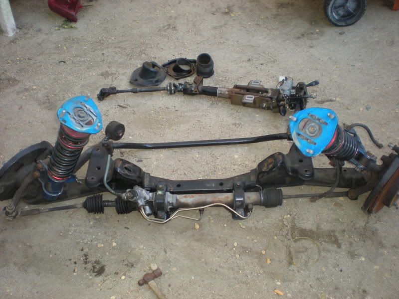

Then I got the car up on jack stands and started tearing her apart
And I'm left with this..

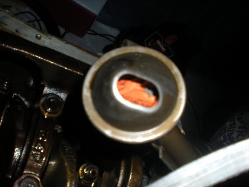

Anddd around here is where the engine blew....not even 200 miles after it was swapped
The engine was 'refreshed' I pulled the usual stuff off didn't look bad so I put it in. Turns out revious owner RTV'd the **** out of everything(front cover, oil pan, upper front cover), and it came off on the inside and completely plugged the oil pick up tube...

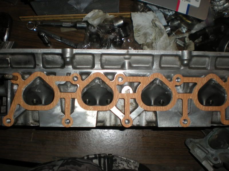

Started some porting on the head
Pre surgery
The start(again)

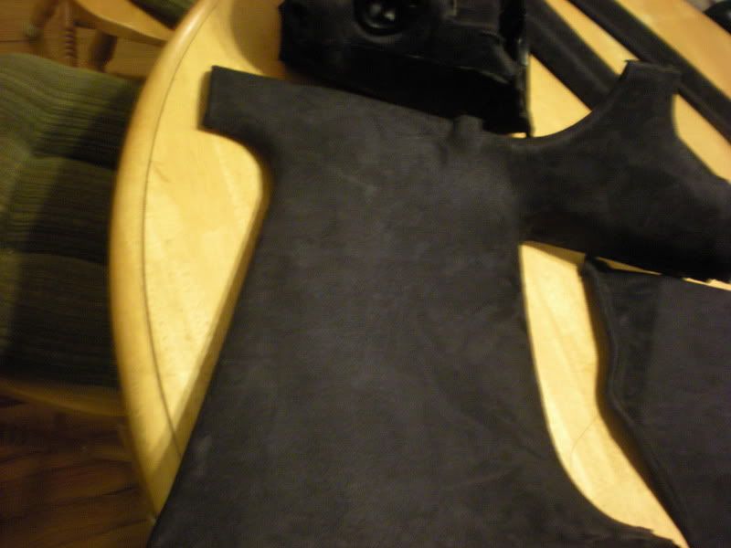

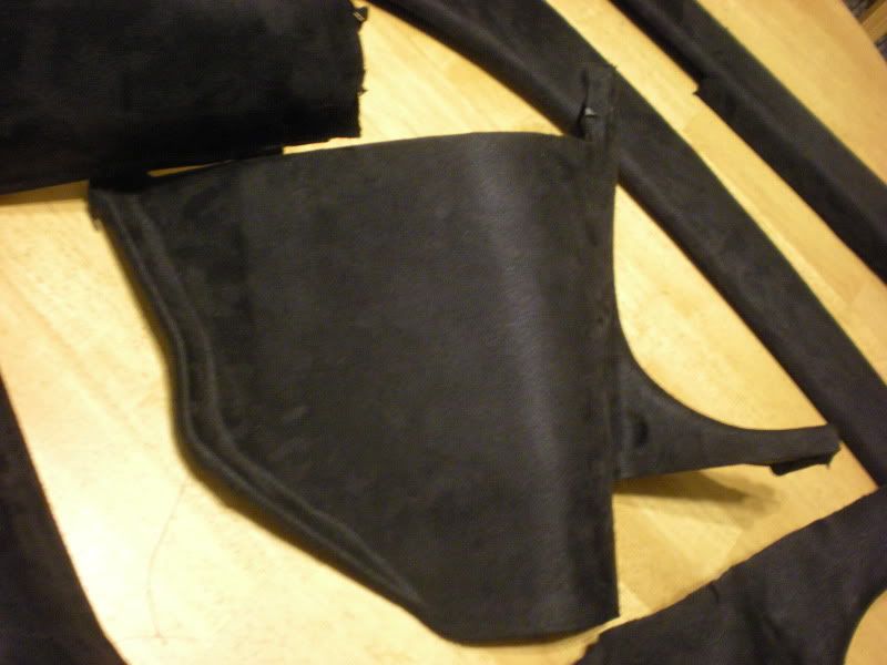

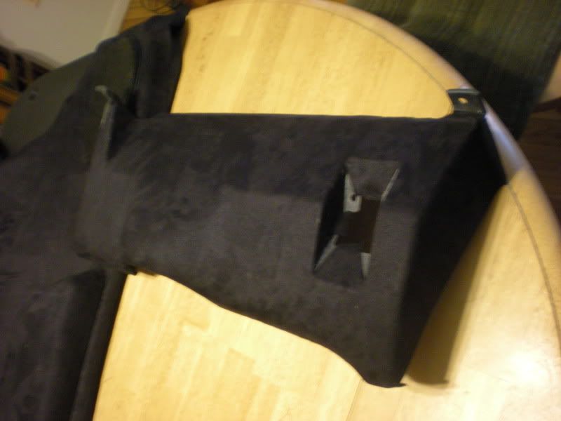

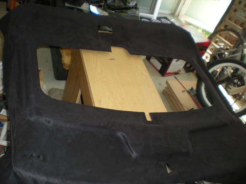

Decided to do all black suede so started that..
(still needs the insert done, doing it gucci)

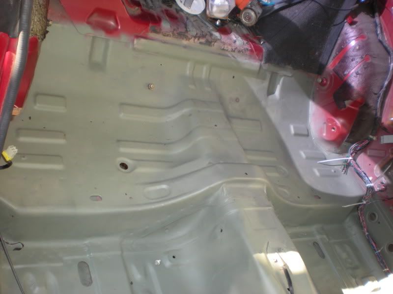

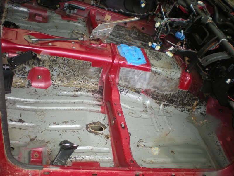

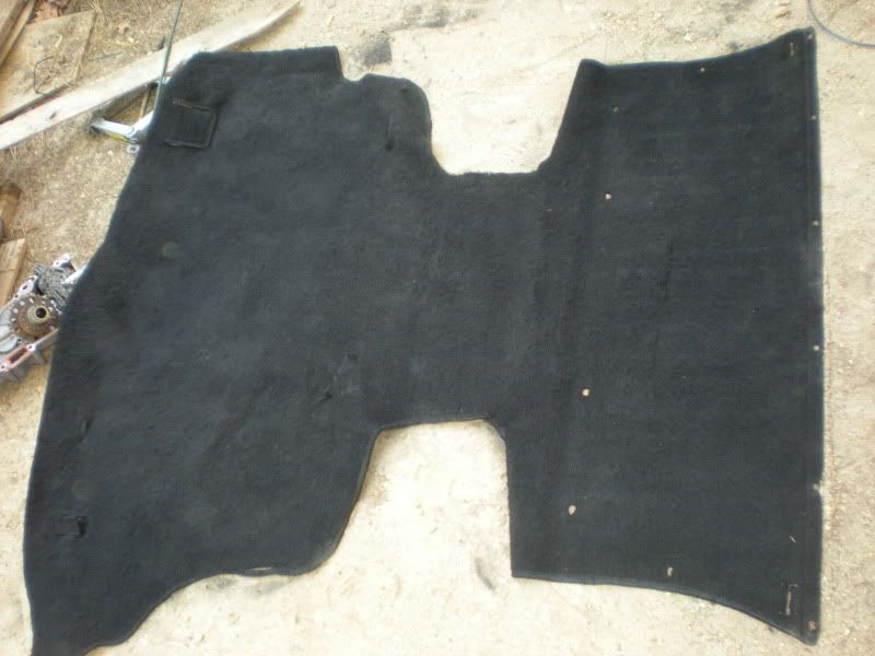

Pulled the carpet and stuff

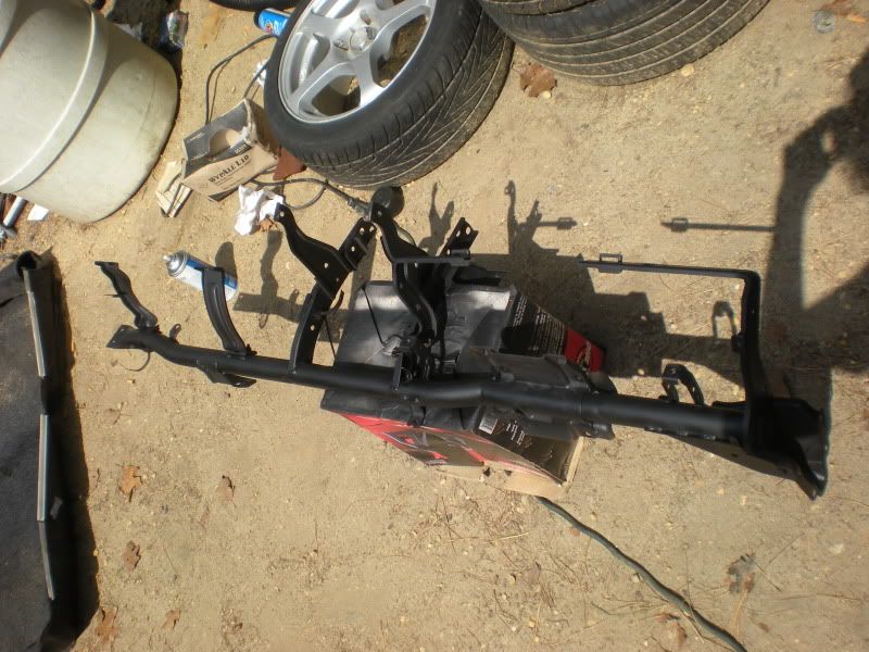

Painted the dash bar
And dyed the carpets

It was fully wire wheeled, don't really have any pictures of it..
Then primed
Rust cut out

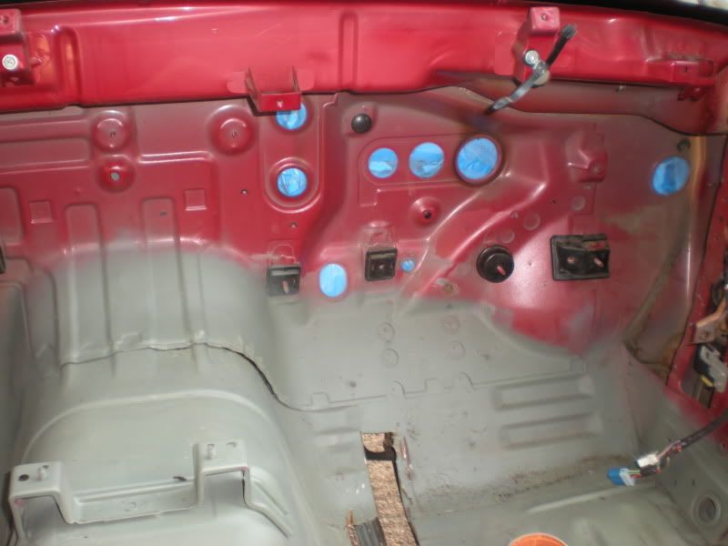

Relocating the fuse box under the dash/by the toe boards..
One half
Andd the other

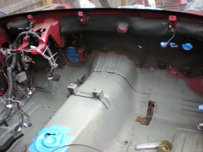

Stripped most of the **** off the firewall...did I mention I'm stitch welding the inside and engine bay also?

Member #15353
how did you get the suede to go around the dash so good? i thought you had to stitch the corners?
s2kguy17 is offline   Reply With Quote
Old 06-07-2010, 07:23 PM   #8
OMGshawn
OMGshawn's Avatar
Location: Toms River, NJ
Member #10187
87 Rx7 T2, 88 Rx7, 90 S13
Send a message via AIM to OMGshawn
Yeah, it can't be one piece around the corners, it just won't work. I cut it and over lapped the edges, it's noticeable but not badly...I'm getting a HUD dash to go with the cluster and am going to redo the suede but with red stitching this time

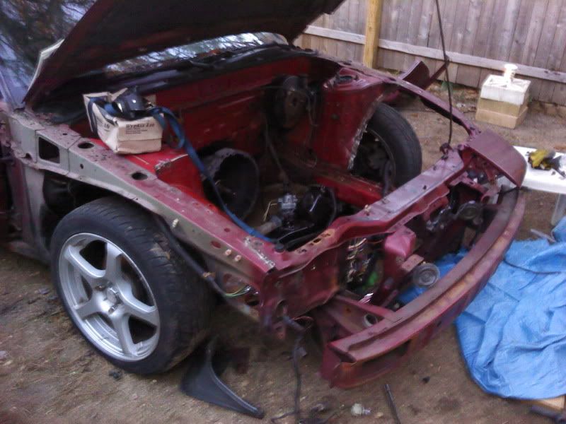

Engine bay currently..

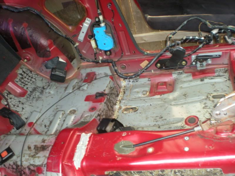

Started pulling the rear apart..
Wow..can't believe I cruised at 110mph for over 2 hours with this thing >_< I really hate PO's
Gonna redo it, completely...

Stripping out the rear wiper, antenna, the rest of the seat belt system and anything else I come across
Stripped and laid out(somewhat lol) on the table, pulled the front harness off it because this will be done soon
What was pulled out so far, still didn't get to the dash side of the harness
