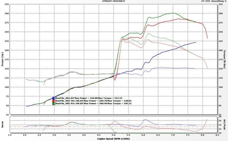

so baseline pull was a little low than some of my old runs.
220whp/153wtq
first nitrous pull 50 shot
jets 34n/24f
284rwhp/238rwtq
2nd nitrous pull
jets 42n/34/f
300rwhp/245rwtq
they gave me a VERY limted supply of jets in the kit so the 80 shot was PIG rich in the low low low 10's. once i get a 33 or 32 jet installed i expect to see a solid 325ish at the tires.

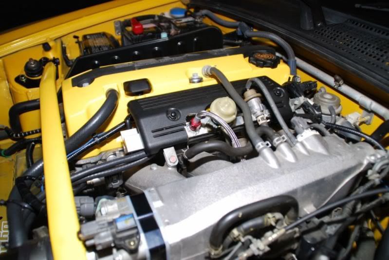

fuel tap, have on order a 90 degree as it slightly hits the hood now

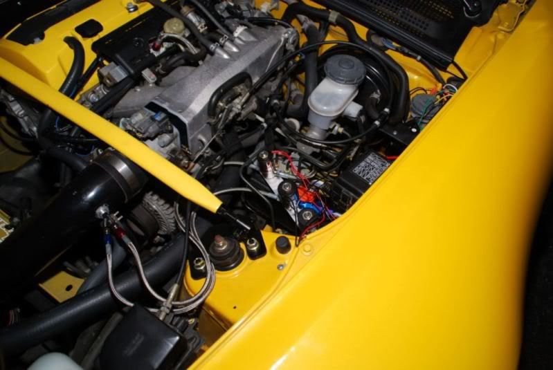

solenoids, lines, window switch is mounted up under the edge of the fender

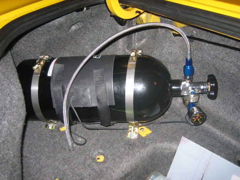

bottle, blow down, gauge, heater with pressure switch

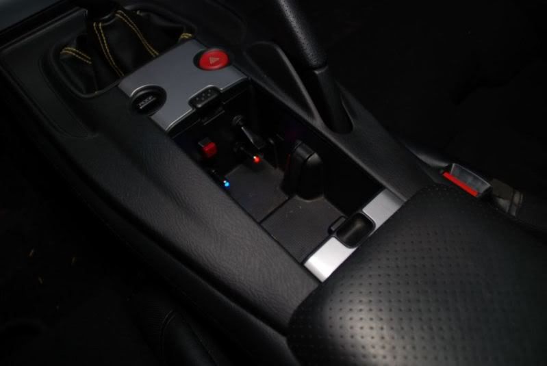

switches in center console. bottom two left side lit up blue for arming, right side red for heater. top left is purge and top right will be for the other stage if i decide to wire it up.

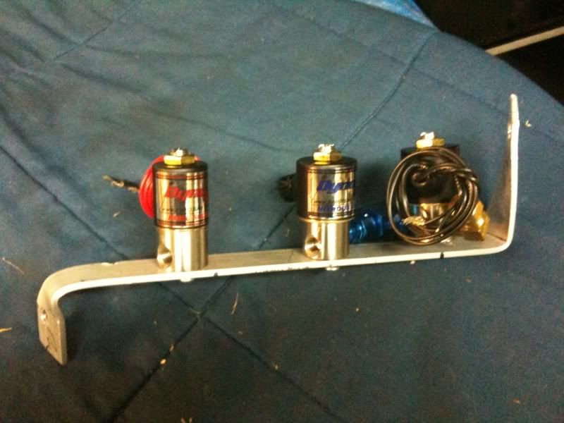

here's the bracket i made for the solenoids. its mounts using actory bolt holes in the car.
