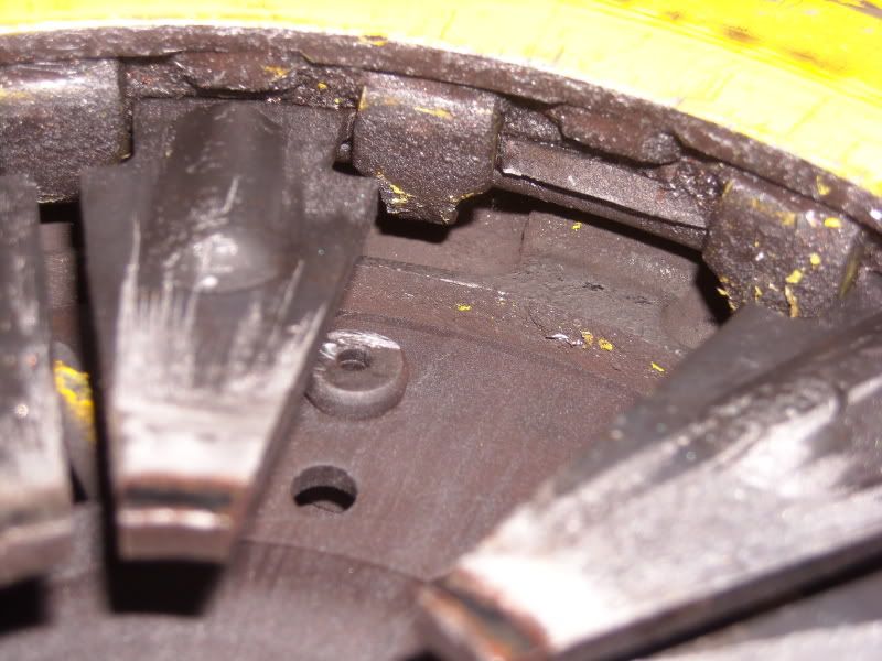

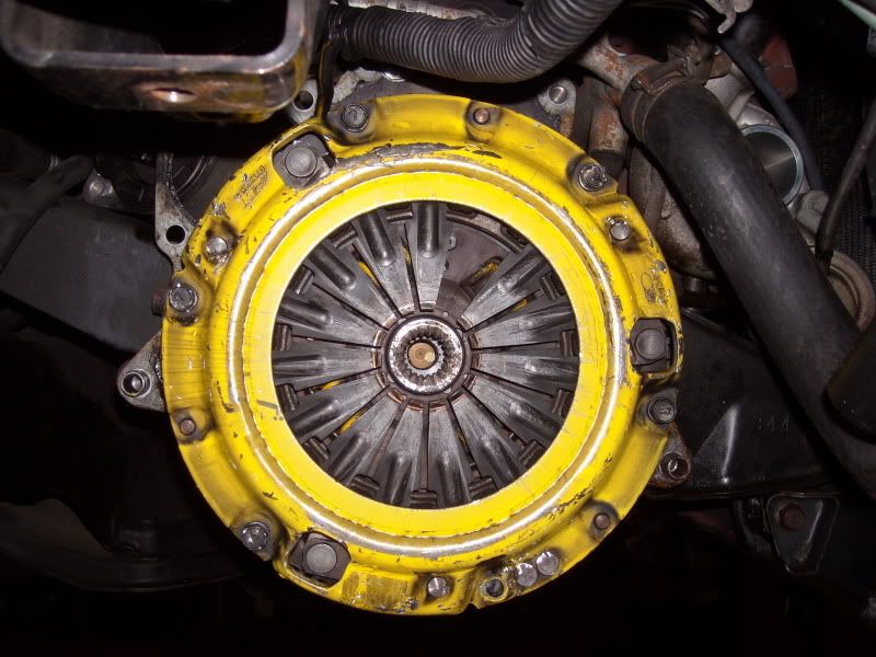

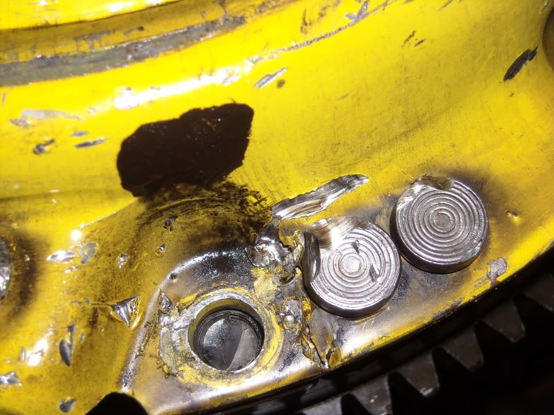

Clutch failure and resulting carnage

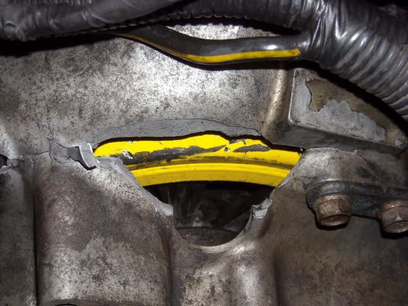

All I did was start the car, and I heard the bang. I got halfway to the Oaks meet when I saw the smoke and pulled over. This is the first thing I saw when I opened the hood.

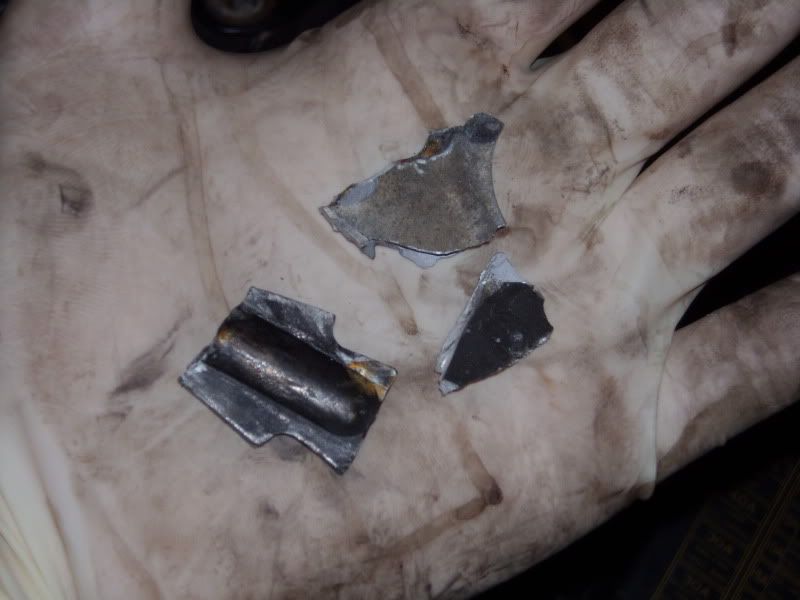

These are the parts I found just lying under the hood.

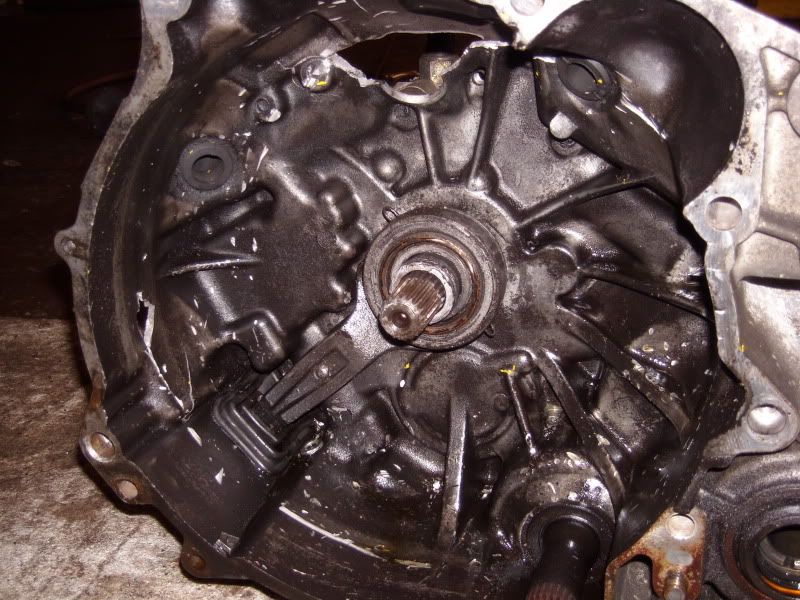

So I pulled the transmission, and the rest speaks for itself.

And it is (was) a 2600 lb pressure plate. I contacted ACT and they are going to warranty the clutch and flywheel. They said they might help me out with the trans repair, but I haven't heard back about that yet.

i would hope they help you out with the trans! Pressure plate fingers aren't supposed to snap off like that. All of the damage to your trans housing/case is probably due to that one little finger breaking off. It probably got wedged somewhere which explains why you could drive it until it must have moved again and just blasted right thru the case. that is crazy. def never seen that before. :D
