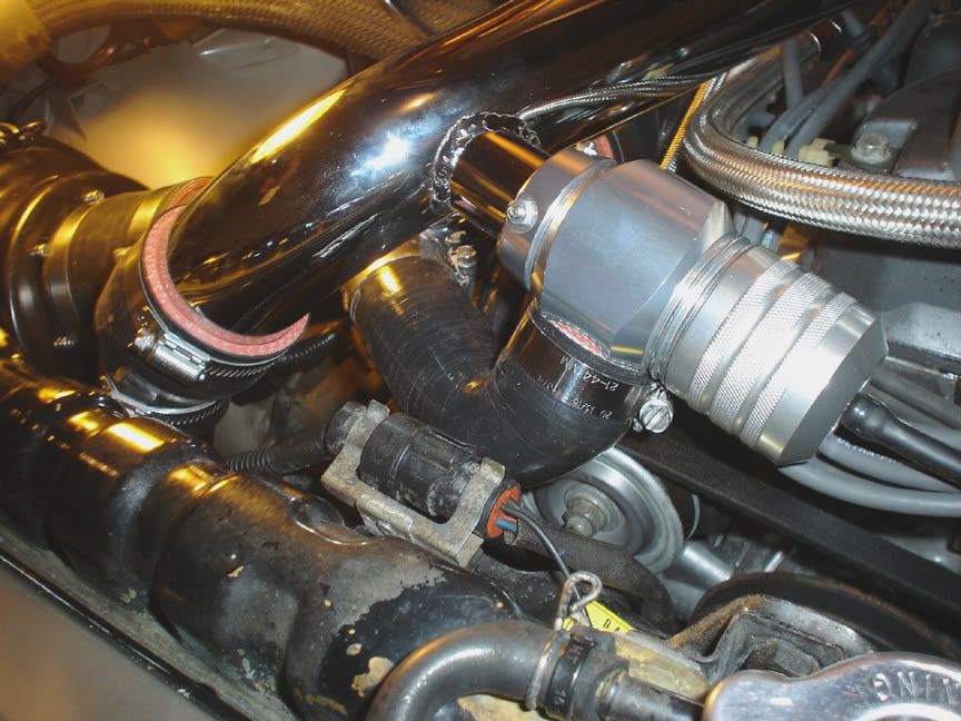

Wanted to add: The car has an aftermarket BOV with only a small vacuum line running from it on the end. Some [Honda turbo] friends are telling me that this is incorrect, as it needs to recycle air from past the MAF with a larger tube? Something to that regard...

i agrea with 1_2befast, sounds like a leaking injector. did you have them cleaned when you did the rebuild? the bov wouldnt play any parts with this it only releases when the tb shuts. what are you running for fuel pressure? are you running a stock ecu?

Hmm, injectors were not cleaned from what I am aware of. Supposedly this is supposed to be a sealed system like this:
Which it's not.. mine looks like this (pardon the crappy camera phone shot at night):
Stock ECU and no idea on the fuel pressure, but it's supposed to be at stock.
What you just have shown is a recirculated setup, which your right. Your's is not. I dont know much about these, but VW's and some subie's prefer recirc. Not too sure about these
