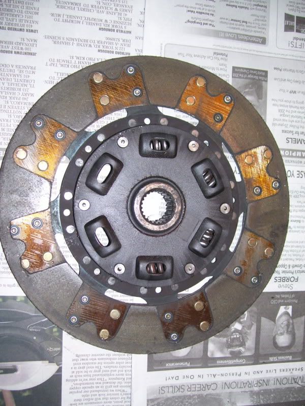

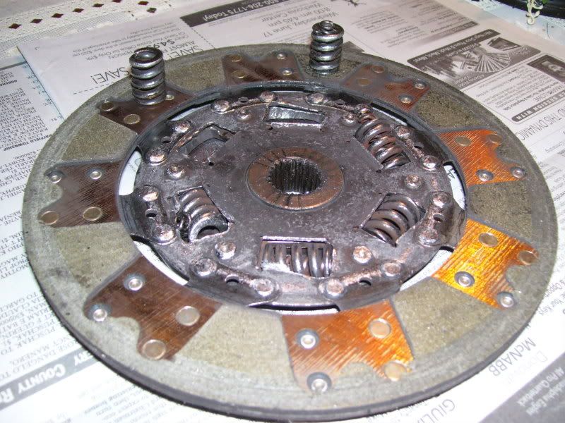

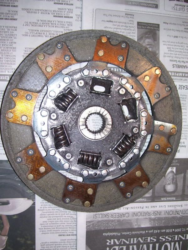

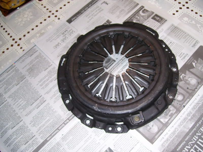

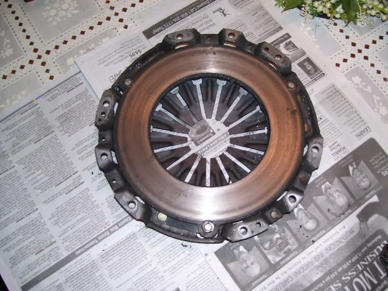

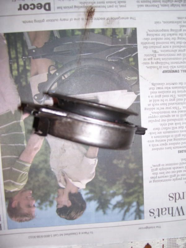

popped springs on clutch disc

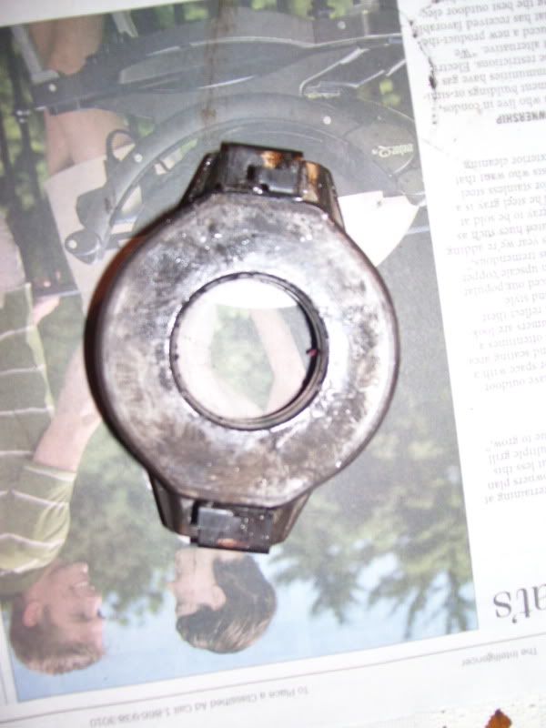

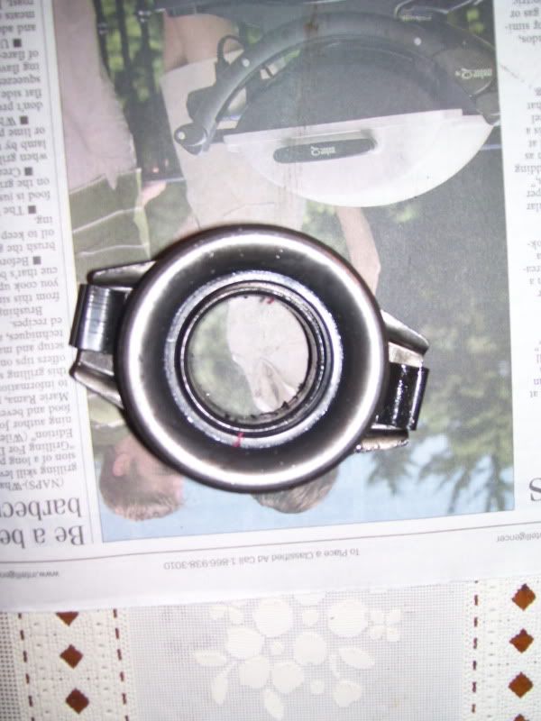

so my clutch somehow popped the springs outa the disc. any idea on how this happened? im at a dead end with how it happened. my trans did have a bad bearing on the input shaft and a little bit if fkuid was leaking in the bellhousing. so if that helps, i really have no idea.
this is pics from my competion clutch stage 3
pics:

****ty clutch, or to muc power.....i had that happen to me with a few exedy clutches.
yeah it has to be a bad unit. since there mass produced, theres bound to be a few bad apples out there. but with the power im making, i highly doubt power was to blame.
what did it sound like...i think im experiencing this myself
honestly im not 100% sure. i do know that my old trans that was on the car had a bad input shaft bearing and that was making lots of noise. there was a strange "tink" like noise that i thought was chatter.

It's most likely not a bad unit. Sprung clutches are notorious for doing this unfortunately. It's a well versed topic in the DSM community, and the manufactuerer ACT is very well-known for this happening with their sprung units also.

Had that happen twice on an exedy stage 2 in a civic. The springs somehow got broken into fragments and got jammed in the PP and it felt like I lost the clutch all together.

samething happend to me, with my Prelude. No symptoms, until all the sudden i coudlnt shift. We took it out, two springs were missing.

His sounds defective. I looks like its still in pretty good shape.

In my NA eclipse one of the springs came off the oem clutch and ended up where the flywheel bolts are. The bolt heads were pretty mangled.

yeah thats where mine ended up, but the heads were fine. sucks im still waiting on replacement parts
