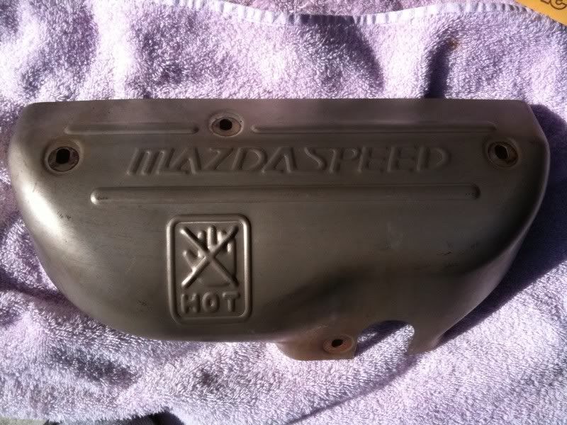

Hey I have the Turbo Heat sheild off my Newly Acquired Mazdaspeed Protege.
was wondering if you could PC it Black but the raised letters(mazdaspeed) and the line below it Orange?
like this orange

as for your heatshield sorry you cant powder coat it since the heat will discolor it,flake it, peel it, and so on.
we can how ever ceramic coat it for you let me know if that would be something you would want.

Originally Posted by LPC View Post
hey sorry been busy but im back and forth replying to all post and quotes.
no problem, and really? VHT has a super high temp spray paint thats rated up to 2000degrees i don't the heat shield would get that hot that the PC would flake off, i could be wrong tho
it can, standard powders might hold a temp of maybe 500 degrees and that might be pushing it the end result of pushing a powder over its edge can be anything from discoloring or bubbling or flaking off.
there is also a hi temp powder that i have used before but in my opinion its not even worth a pile of dog crap. just about every part i ever coated with it did not last too long, it might work on your heat shield but it might not, we can try if you want but i rather not have you go through the process for it to fail and then redo it in ceramic and having to pay twice for it
Hey man i totally appreciate the honesty I might try the VHT spray and if that doesn't work that well i'll send it for ceramic coating, Thanks man!
