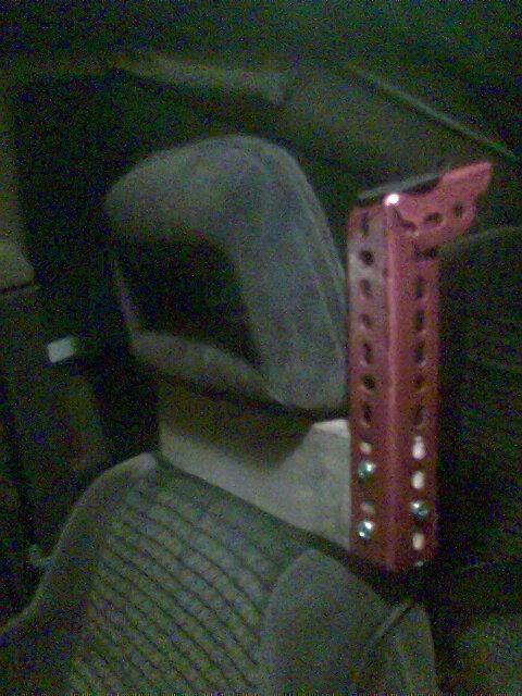

btw this is what i was testing out. and yes, i got the wiper death on camera LOL
