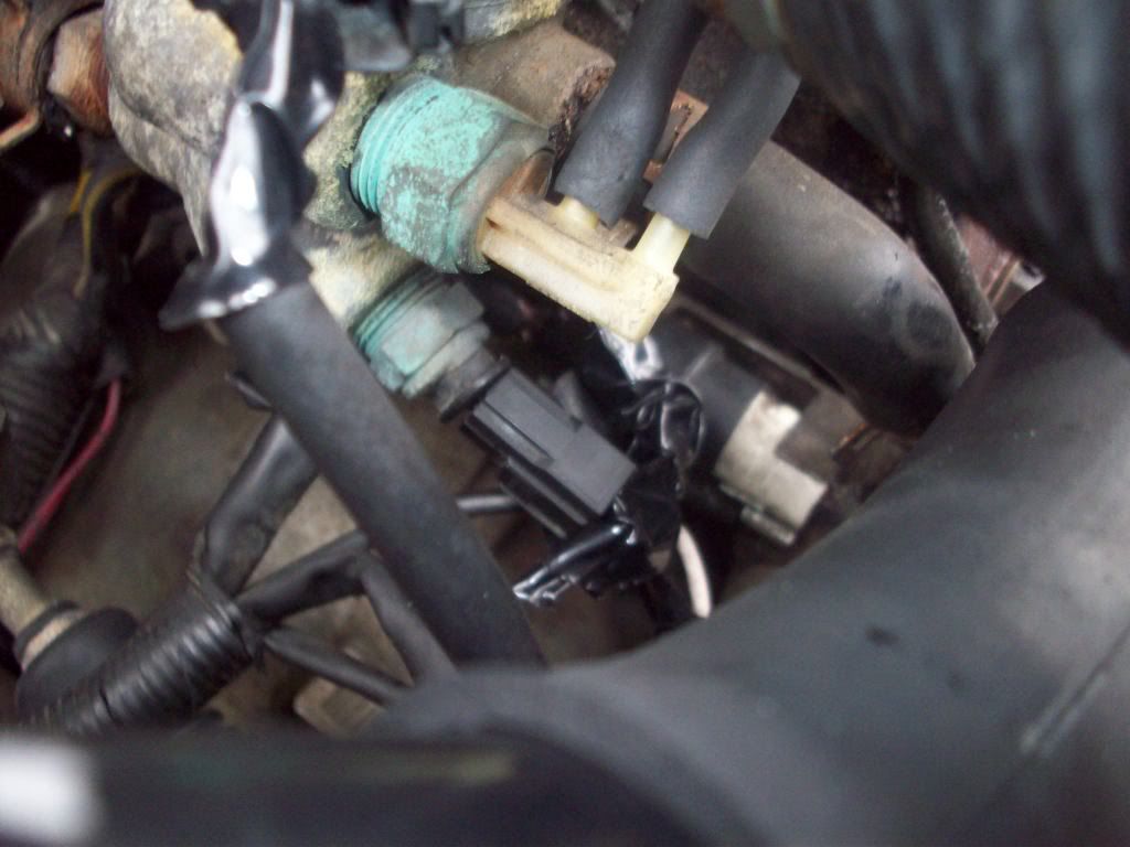

1995 Eagle Talon TSi AWD
If you can't get the light diagnostic to work you can get it scanned at Autozone for free, just ask them at the counter.
For reference, the coolant temperature sensor is the bottom plug on the last picture you posted. If you just got the CEL after the wire tuck, and that is the one you broke/rewired, chances are that is the problem.
