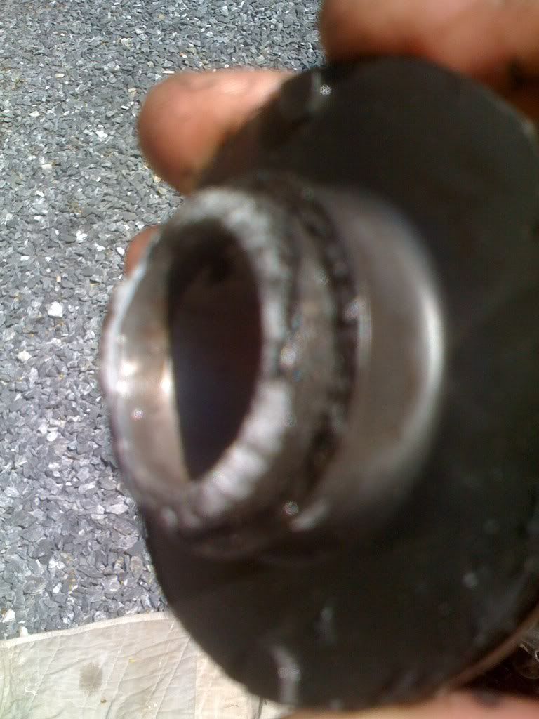

This happened sat afternoon the act throw out bearing shattered

Thats weird that the bearing retainer broke like that?? Are the block to tranny dowels there??

The dowls were there one of them broke off at the block, im gonna have to see if i can weld that bitch back on

does anyone know if i can just weld the piece back to the block, theres no hole its just that piece is needed for the tranny

The dowels go into 2 holes on the block. One in teh front and one towards the rear. I take it the front ear broke off?? If you stiff have the ear, the way to actually have it doen correctly is to have the trans out and weld the ear back on. When there is no doel present the trans will rock back and forth from the tq. With the ear broken off it will cause the trans to flex and rock.
It is definately something that will need attention.

yeah i have the ear, but can they weld that?
