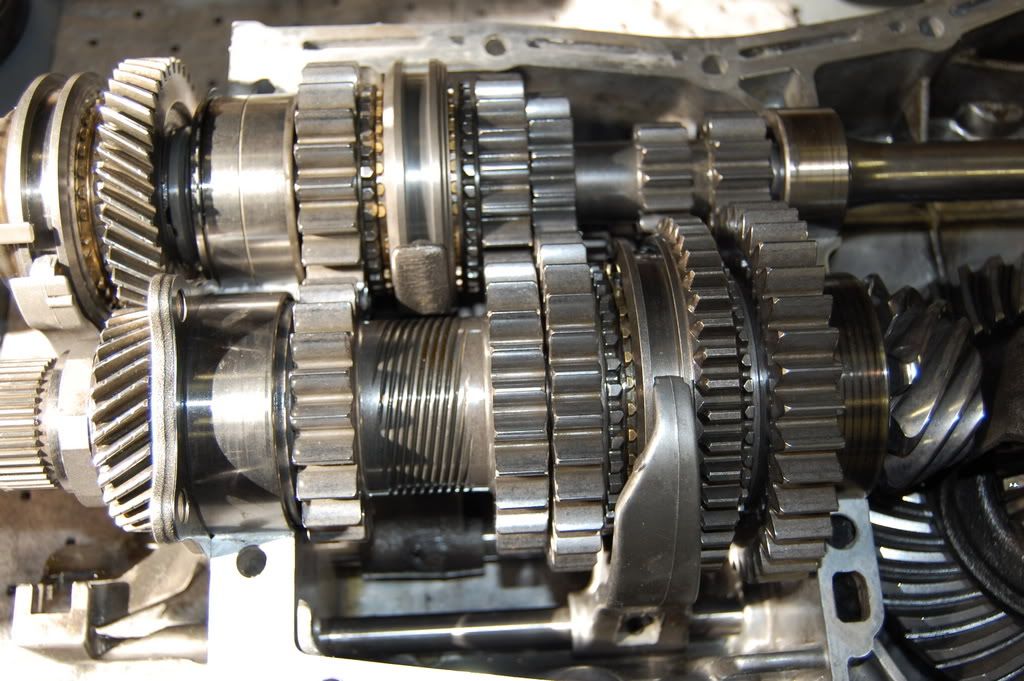

Well, about 2 weeks ago my gearbox started making some odd sounds. But only in second. I knew I probably chipped a tooth or something. Anyhow tonight I was driving home from work shifted from 1st to 2nd then got on it a little, when I did that there was a small bump in the road, I went over the bump while making power, boom. O well, I guess Im going PPG. Might as well get all my dccd working while Im at it. Now the question in Syncro or Dog..... hummm. Its going to be straight cut regardless.

Yep.. Took everything apart today. 2nd gear. Oh well.. I have to order a set of PPGs for my sytle "older" gearbox so it my take a few weeks. Hopefully not tooo lonnng. Im probably going to do the LSD and get a new clutch while Im at it.

I repaired it with this. But I couldnt afford the diff, so I'll have to do that later on down the road.

mmm its so beautiful. if you have it apart again in the future i have two billet ppg shift forks that are kind of 'left overs' that i should probably get around to selling.

Awesome. I just didnt want to buy the shift forks because of the cost. 300.00+ But if the price is right. I will be taking it apart again in the future for the LSD.
