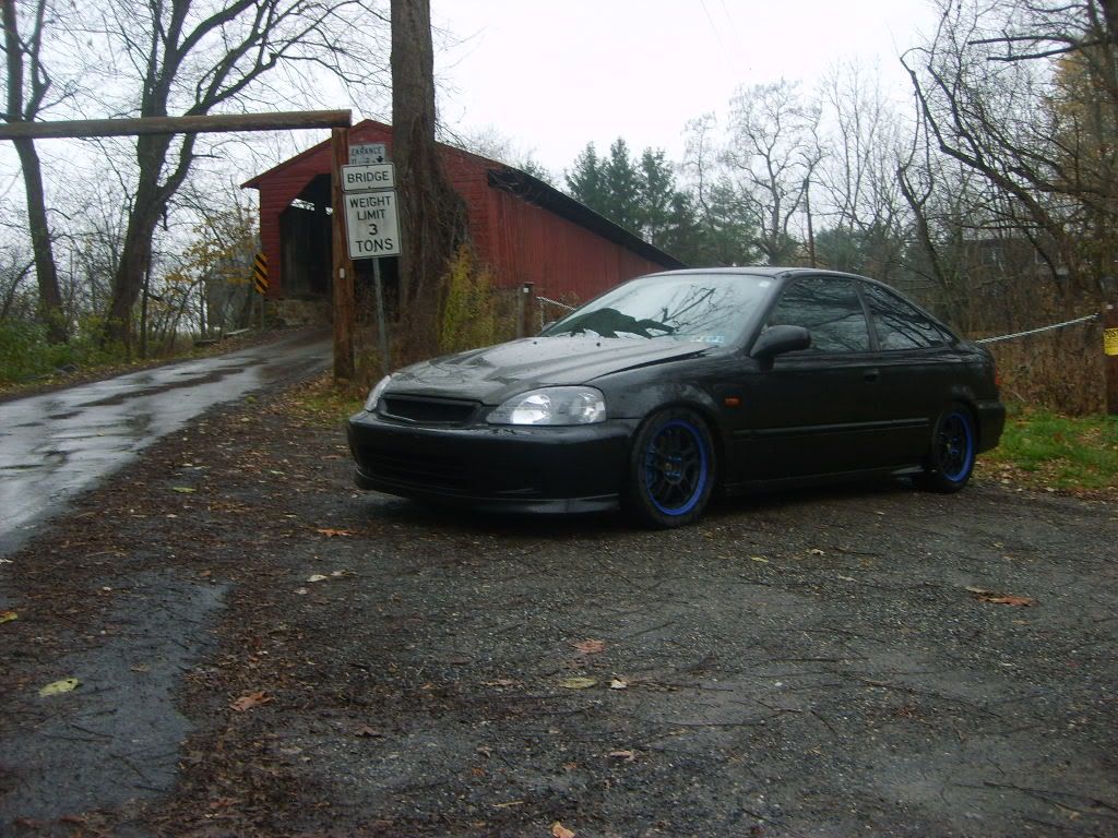

I already have small mods done. neuspeed spec r springs, dc header, skunk2catback, ebay intake, fidanza stage 3 clutch, fidanza 7lbs flywheel, jdm fenders, CF invader hood, CTR replica headlights, konig minuz wheels. It is a B16B. The motor is getting manley 10.3:1 comp pistons, eagle rods, bored .20 over, decked for compression, supertech dual valvesprings, supertech titanium retainers, supertech high compression valves, PNP head, racing valve job, skunk2 stage 3 cams, rc 440cc injectors. Hopefully the motor is in and John at JK Tuning can have it tuned on chrome with a p28 ecu in 3-4 weeks. That is all I can think of right now if I remember more I'll post it.
Sorry they are so big, I don't know how to make them smaller.

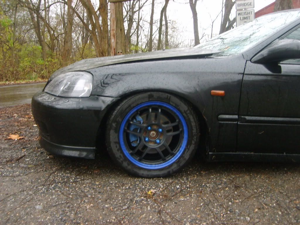

Looking good. I have a soft spot for Black Si's tho. Someday I'll own another one. Whats with the hood tho? Why does it stick up in the back?!? Got any better shots of the rims?!?

I agree on the hood looking goofey.
But the rest of the car is nice.

Yea I know the header needs changed but it was cheap and I was short on money when I got it......when it starts to look bad I'll get another one. I was afraid to go much high with the compression on pump gas. It is gunna be a daily driver so I need it to be reliable. The hood lift is an inside joke me and a couple friends have.
That is the best one I have.
