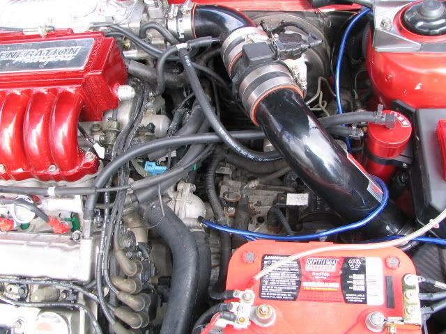

aww **** this is my clutch going out isn't it?
i was at a light today and realized i was ideling at 2krpms, i pumped the clutch and it dropped down to normal idle (about 750 ) then i noticed while driving, if i shift into neuteral to coast my rpms stay were they were OR EVEN GO UP MORE. i was driving home, got to a hill at 3krpm and shifted to neuteral then as i coasted down my rpms steadily rose to 4k.
is that my clutch saying "**** you, replace me." ?

no. thats an idle air problem or vacuum leak.
does the clutch slip while under boost?

yes but the clutch has slipped since before i went f/i, it's a stock hyundai clutch
but vacuum leak.. i just installed a catch can about a week ago and thought i heard a hissing / whining sound under acceleration but figured it was the blower. and my vac is showing -23 sometimes, as far as i remember it was showing -20 before
thank you for your help, i also just threw a p0030 code for one of my o2 sensors and am worried ill have to take the car to the dearlship, i really dont have that much money to be blowing right now since i need to save for a clutch and still owe $900 on my ireland trip

18-20 inches of vacuum is normal. 23 inches is not. def vacuum leak.

okay, what should i do just spray a couple cans of fix a flat in my intake?
kidding, i'm using an AMW can, i figured it was quality but i guess it's probably the source of the leak. should I seal it with some silicone stuff or just some plumber tape ?

well the how do you have the can routed? normally the open crankcase vents arent a problem. I'd take a look at the intake gaskets. Spray carb cleaner at the base of the intake mani/supercharger. see if the idle comes down.

i didn't realize when i did it that i was only catching the oil from the front so i was about to go out and switch it so that both valve covers went to the catch can and then the catch can went straight to the intake

torque down the intake manifold bolts some more.

Most of the time a leak in vacuum lines will decrease the amount of vacuum being pulled in the intake manifold. Pulling more vac now then before doesn't lead me to believe that vac leaks are the problem.
I would diagnose your idle controlling parts. IAC, FIAV, ISC, etc.

What kind of catch can is that? looks nice. sorry ot

it's an AMW can

23 inches of vacumn under decel is normal.

I'd rather have 23 inches of vacuum than 18-20. If there was a vacuum leak, the number would be lower, not higher.
Like the others have said, spray some brakekleen around the intake manifold and see if the idle comes down.

yeah I def got that backwards lol.
another thing.. what EM are you using?? the timing could be advanced to far advanced possibly. Hmmmmmmmmmmm... this one is really puzzling
