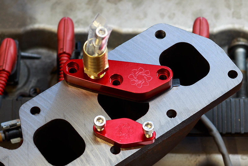

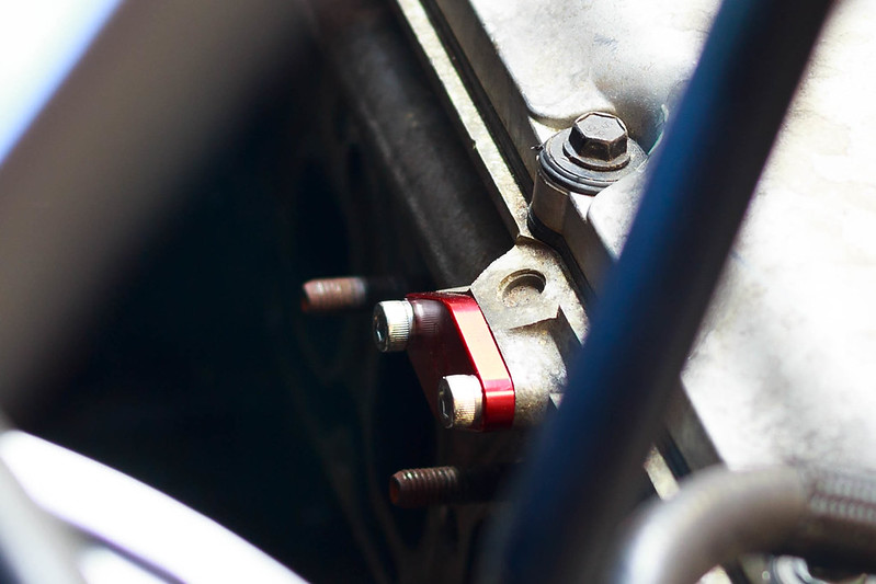

Sunday I did some little stuff to the car. In the box of parts included with it was a rear wiper delete. I would have done this myself, so it was nice to already have it. I threw that on. Also included in the box of parts was a poly insert for the bottom subframe motor mount. I threw that in for now, but I think I'm going to ditch it for a different unit when I inevitably do all three motor mounts at some point this summer. I want things to be quite stiff. Here are pictures of the before and after of the wiper delete. I didn't grab a picture of the mount insert.
IMG_6039 by Pat, on Flickr
IMG_6043 by Pat, on Flickr
IMG_6045 by Pat, on Flickr
IMG_6046 by Pat, on Flickr
