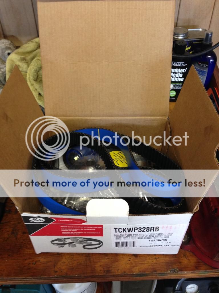

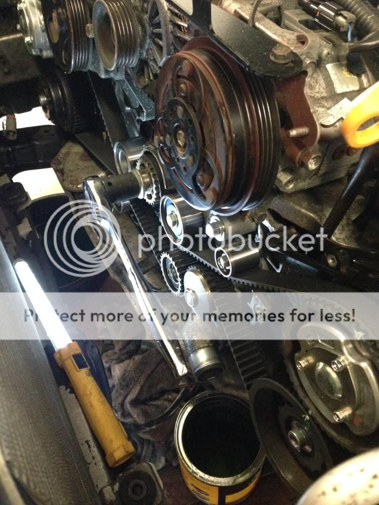

I tore into the Fozzy a bit more this weekend. Thankfully I checked the belt out as soon as I did. It was very obviously just recently replaced with an OEM belt and WP, however, they didn't properly clearance the belt guide, so it was eating the belt. I redid everything just for peace of mind, including all pulleys, WP, etc.

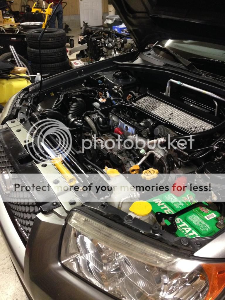

All done! I really need to find an STI TMIC or something, these fins are smashed. Also mildly annoyed that I don't have the engine cover.
Some fool tried replacing the ball joint that is falling off of this thing with no luck, so instead of drilling it out, heating it, or easyouting, or all three, they opted to weld a nut back on said broken bolt and leave it. I just put on a new OEM wheel bearing in the left rear too.
