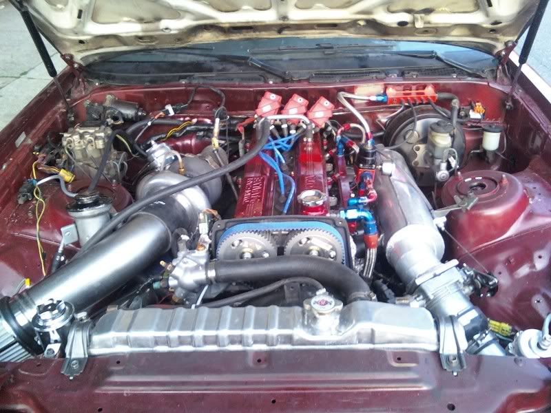

alright well to whoever knows who i am, this is what i've been upto since November, many trials and tribulations but either way i'd like to share.
Not really big on "build threads" but since im bored and i did take pics,not as many as i'd wanted, so i will post
and it began with this. November 2k8
What the car looked like before it went under the knife...basically wat its gonna look like when im done, lol...

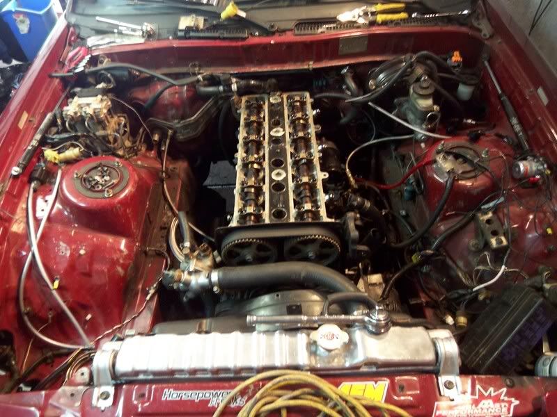

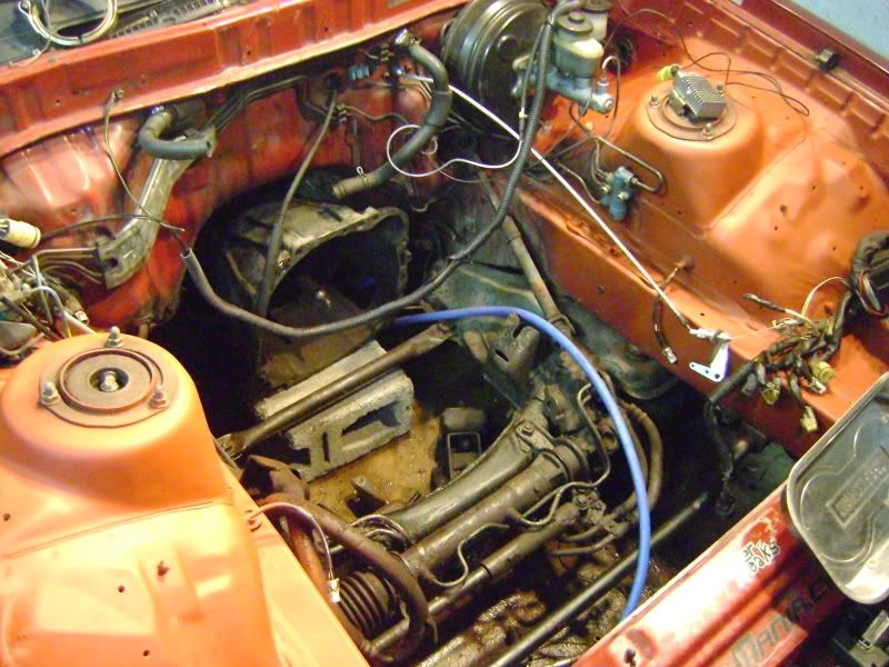

Engine...

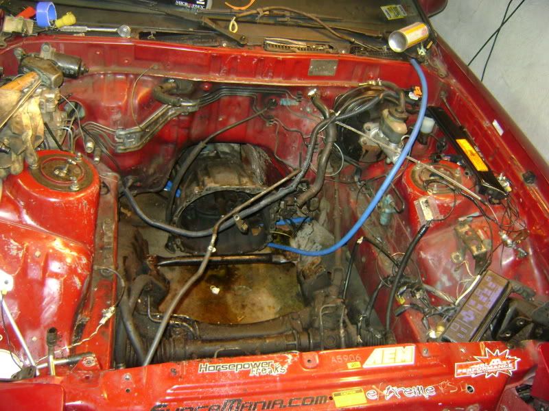

Operation, get the old engine out.
Followed by a few pics of a few parts...
New Block, Arias pistons, Eagle Rods, etc...etc...

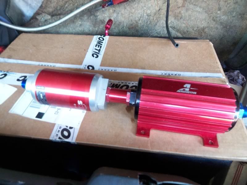

A1000 Fuel Pump
16gal Cell.

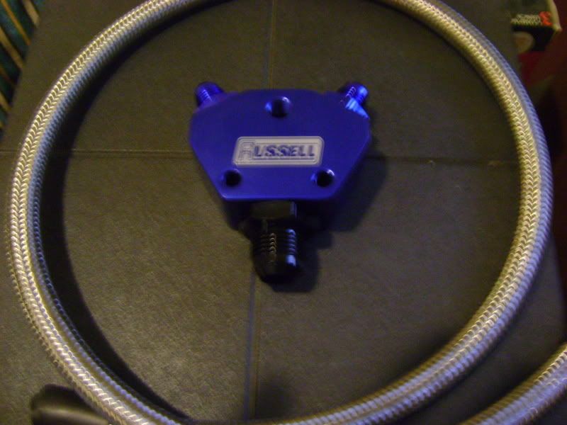

Splitter, -10 to 2 x -6 feeds, the return is -6

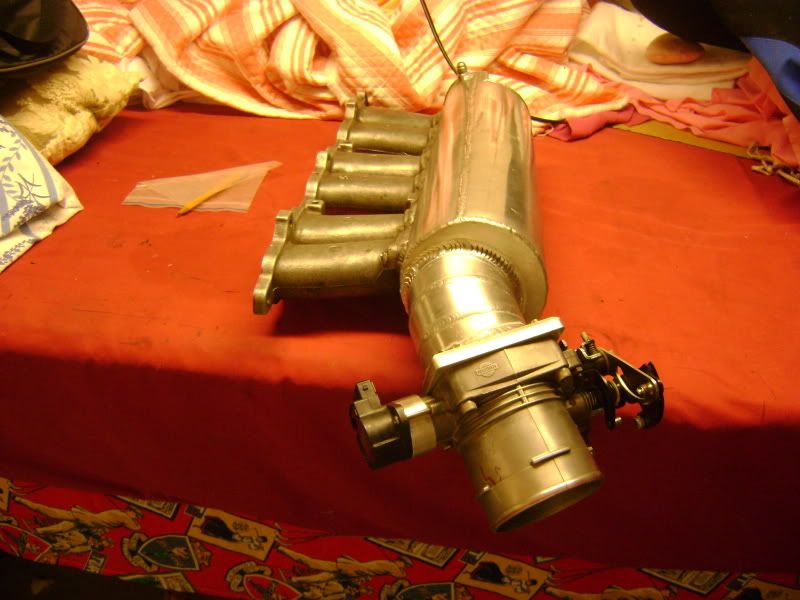

Manifold Outfitted with q45 TB...
Things being replaced that i have no pics out of car...
550 injectors replaced by PTE 780cc Injectors

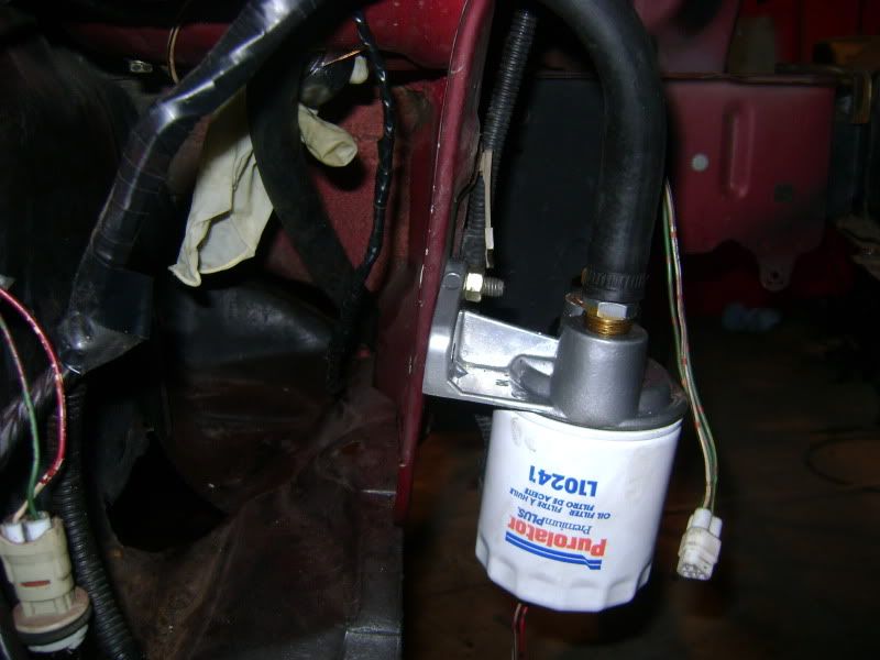

Oil filter relocation **** + 11"X 7" oil cooler and 180 tstat.
Manley +1mm OS valves, Regrind 274 Cams + AEM Cam Gears
Gates Racing T-Belt
Other info to come.

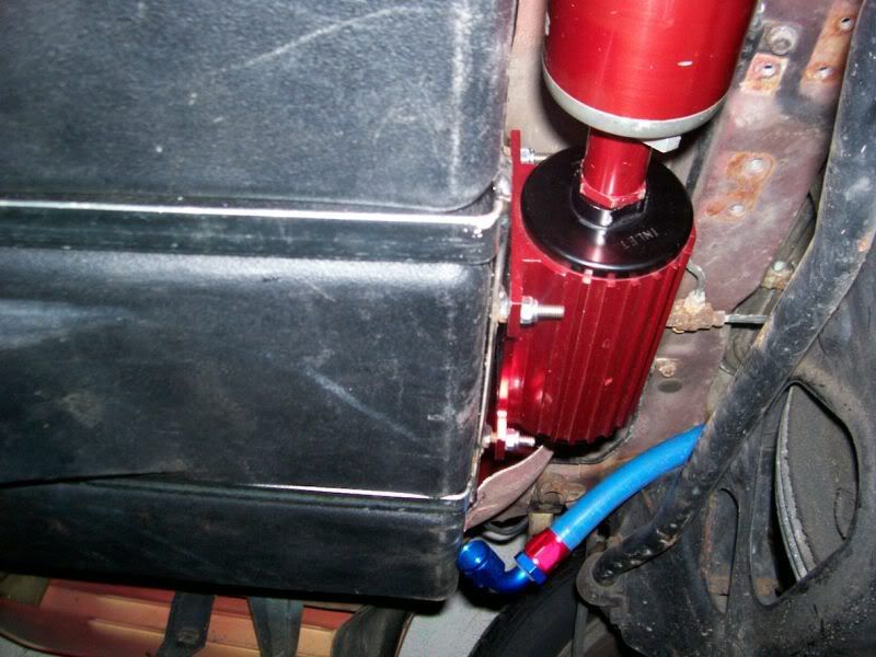

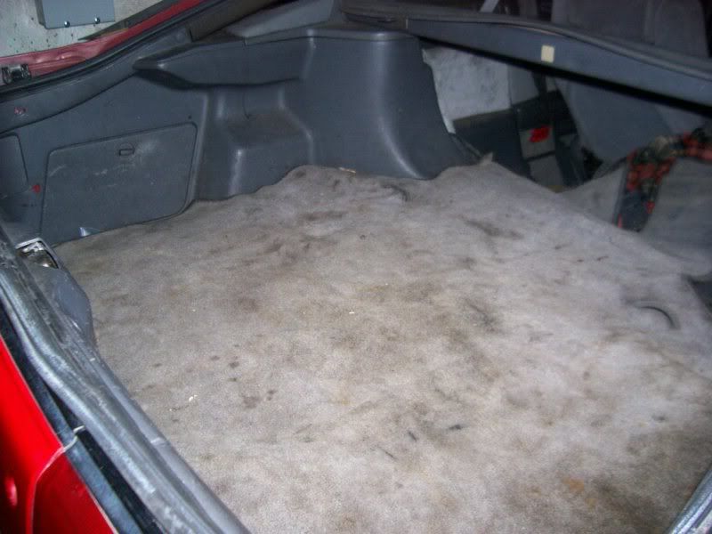

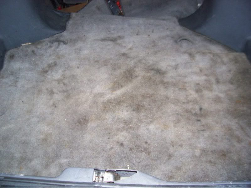

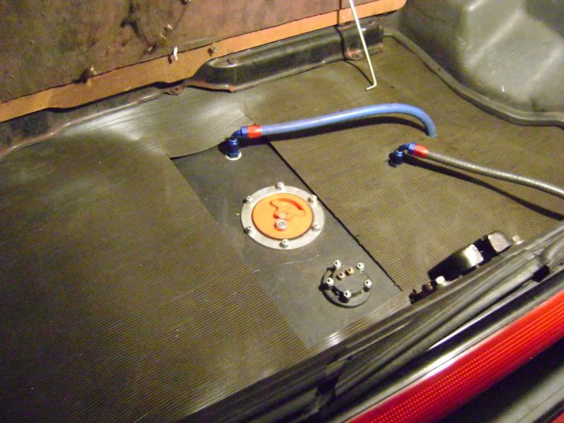

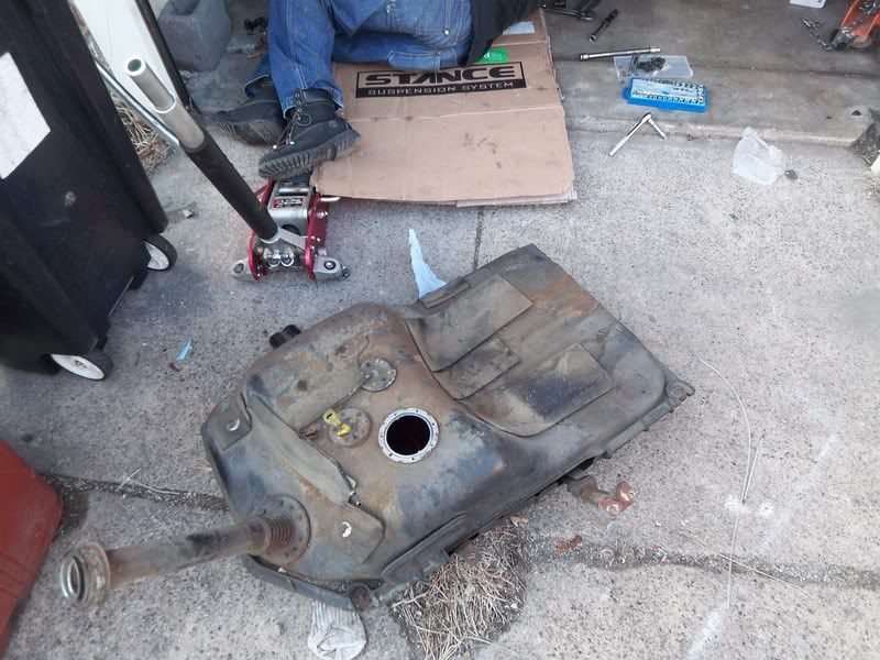

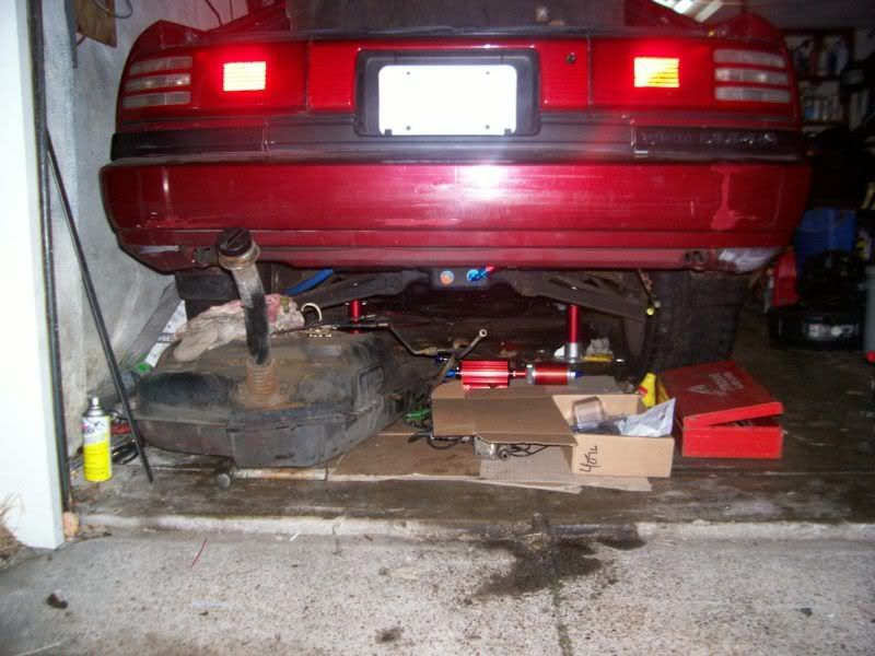

Making room for the fuel Cell...

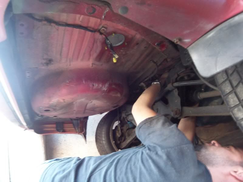

Many people asked me, why not just sump the stocker...well first of all i wasnt comfortable welding on the old rusty gas tank and the thing is just so grimey.
Anyway....let skip a few steps since i didnt take much pics.

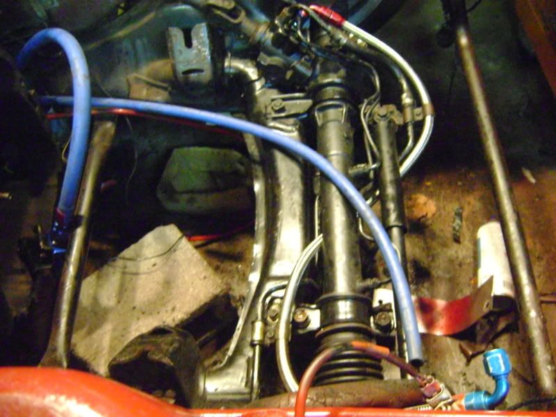

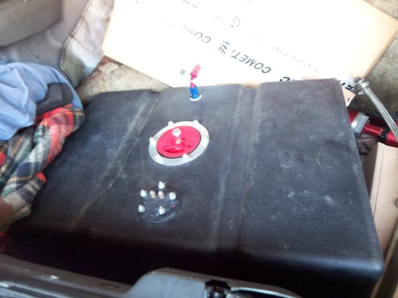

Cell being test fitted after cutting the hole, which was needed for me to run the lines.
Feed and return being ran.

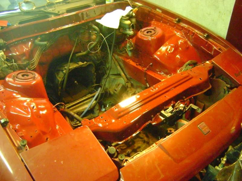

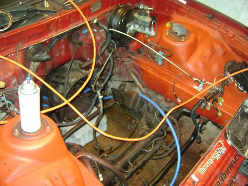

While i'm at it, why not clean up the bay a little. Started to prime it.
Think i was doing priming here...
Some OEM matching paint...a little too well of a OEM match lol

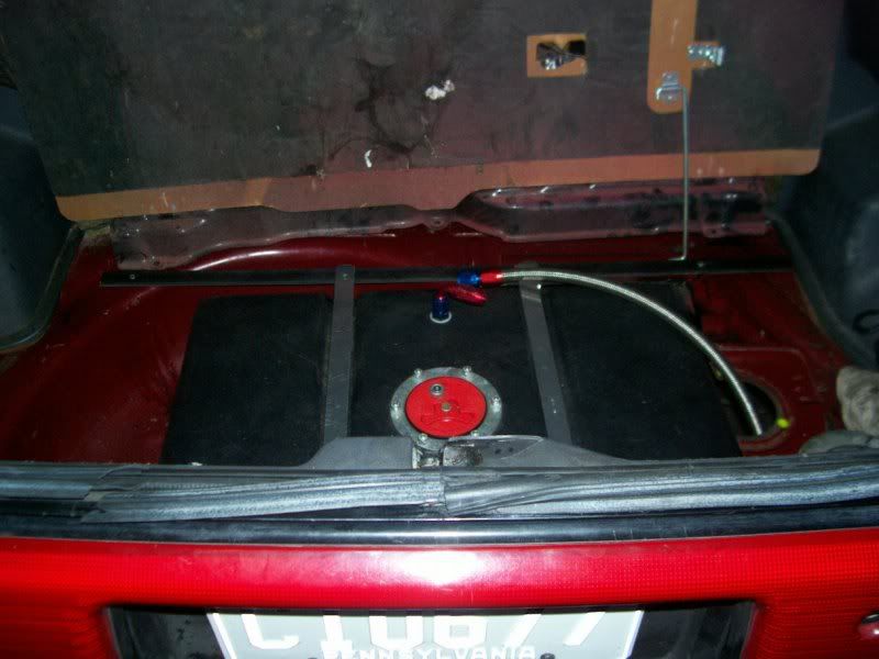

Ok back to the fuel system...
We welded on the supports and installed the mounting brackets.
Also welded on the studs for the fuel pump and filter.
Fuel pump/filter mounted and started to connect lines.
What fuel cell? heh i will try to get a metal cover going instead, but this should work for now.
Under i used weather stripping and some rubberized under body coating.

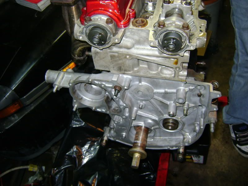

Fuel system was pretty much done...on to the assembly of engine.

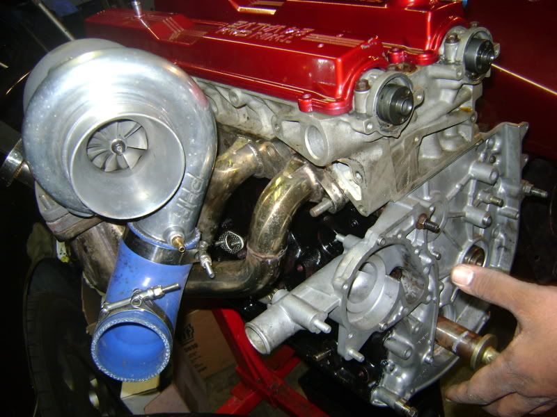

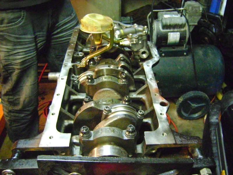

Installing the oil pump.
Front partially on and head on.
Also used a 2mm HKS Stopper Metal Headgasket for extra measure, even tho the block was o-ringed which were installed also.

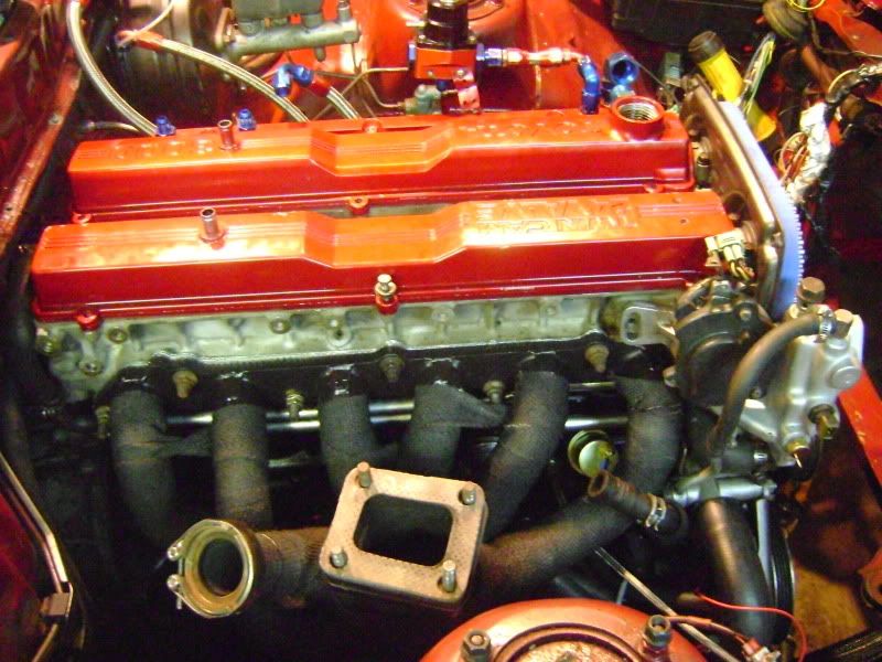

Things being test fitted, i also powder coated my valve covers and fuel rail myself.

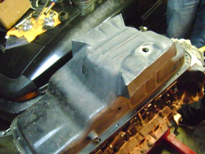

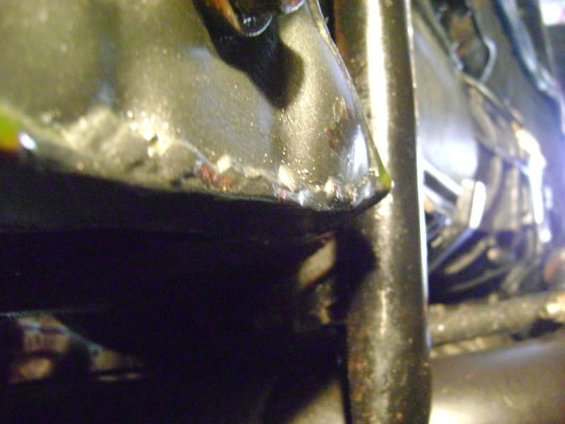

I had a guy on the forums weld me up a bigger sump on a stock pan, but i didnt know he was gonna be the worse welder of all time. I'm a little embarrased to show these next pics as i was pretty pissed but i did decide to use this pan....worse thing i ever did, even after i checked for leaks.
It was later replaced by stock pan, story to be told soon.

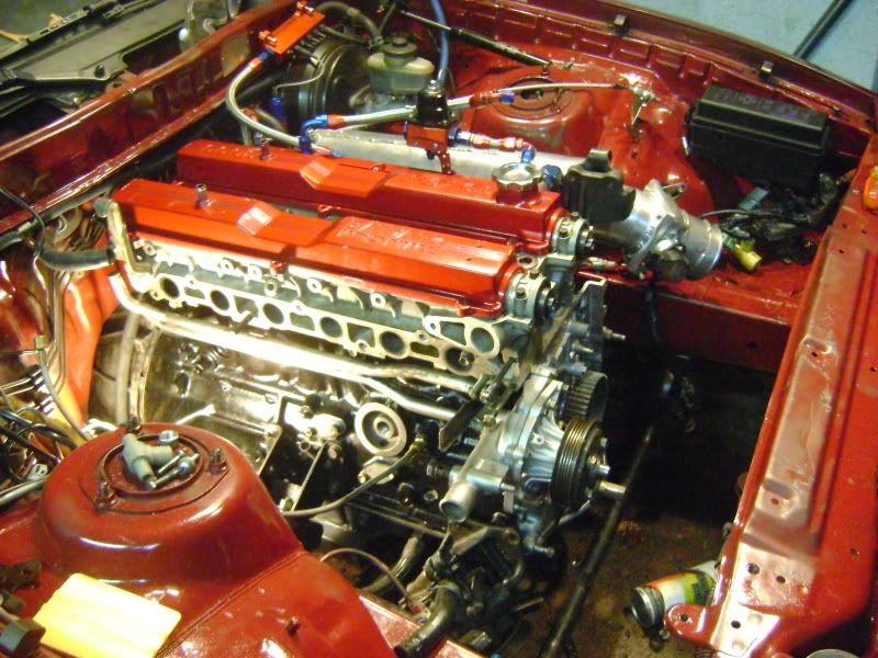

Before engine going in i replaced the steering rack with a low mileage re manufactured one along with a SS PS feed line.
After massaging in, engine was in...stupid me did it with the newly coated valve covers ah well, live and learn.

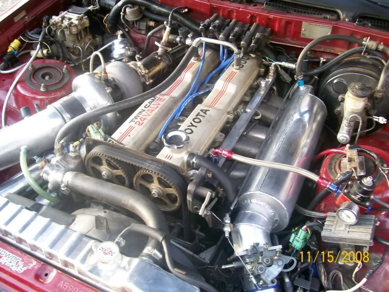

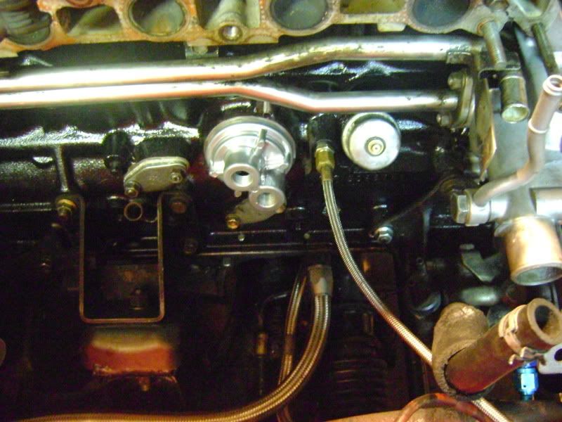

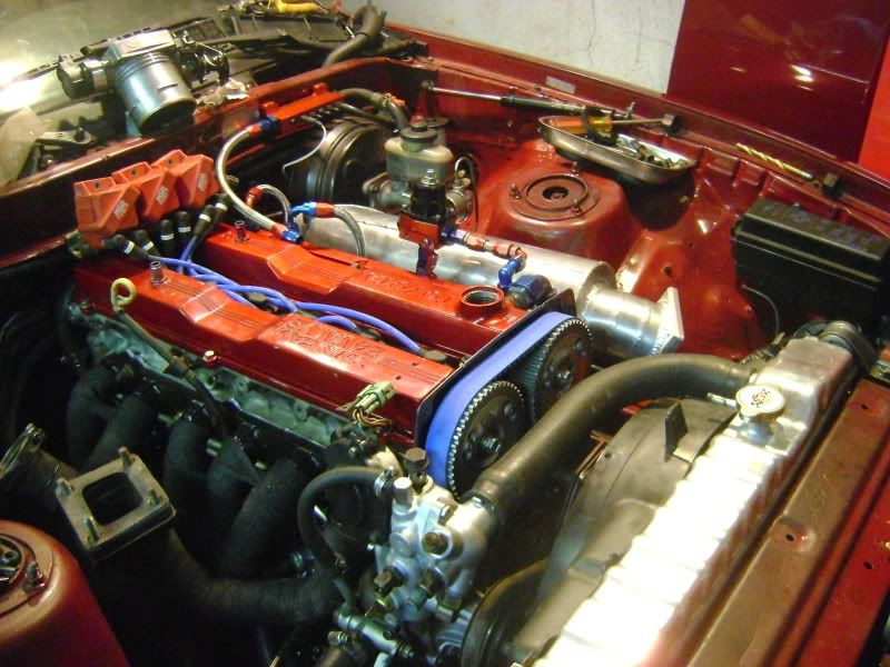

Started to work on oil filter relocation and cooler.
Much easier.

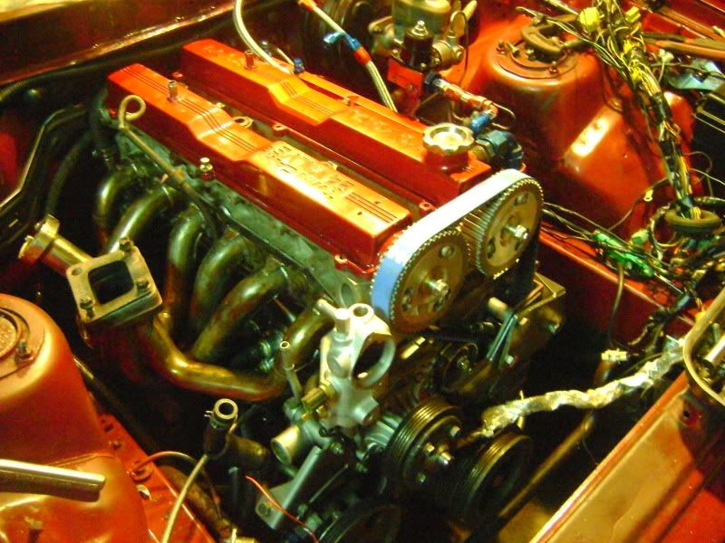

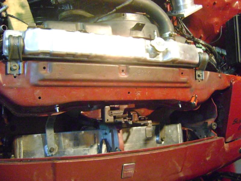

New Intercooler installed. Overall Size: 31"x12"x4"

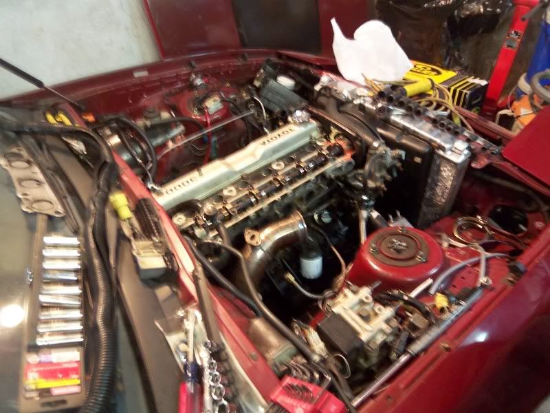

Manifold and cam gears test fitted.
Manifold and upper dp wrapped.

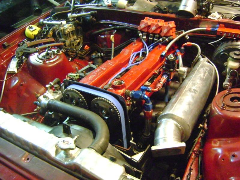

More things installed, including radiator and fan.

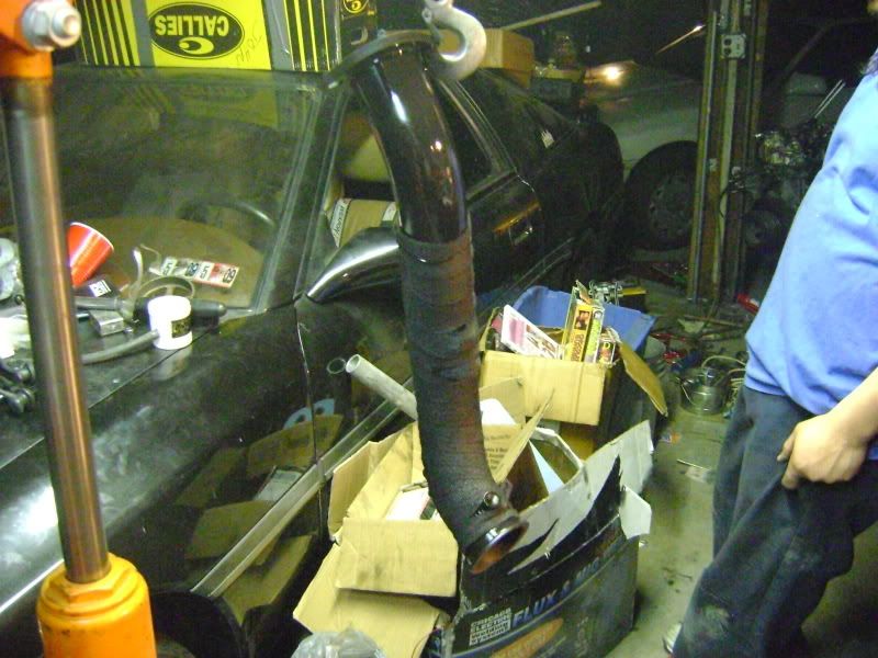

and more...coils, turbo, dp...
Wiring, fuel rail, AFPR, vac lines being ran.

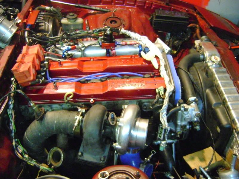

after most of it together...
First start on new block!!! Almost starts right up. Need to tune AEM for coldstarts and such.
And then we had better luck the next day. Forgive me the intake filter set up, had to cut it. Also stock cams were installed for the break in period, they need adjusting but will wait till the new cams are installed.

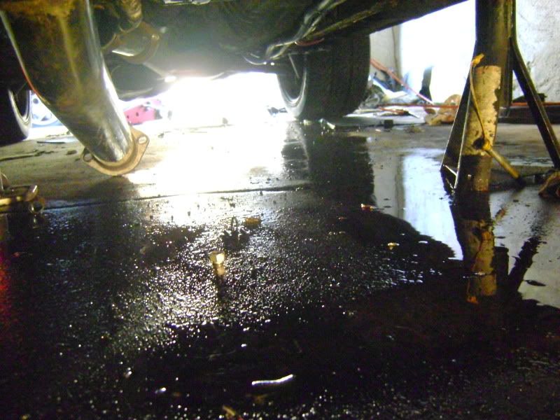

ok so i had a leak, pan was not done by someone, whom name i choose not to mention....
Bad leak...
A really bad one...
After a few days no oil was left in the engine...Time to pull out engine to replace the ****ty one with a stocker, which i should have done in the first place, ah well...took me a while but we got it done.

intake manifold, yes. such a better set up than stock.

i'm sure the Q45 TB helps out a lot too. Nice custom fab work there.
