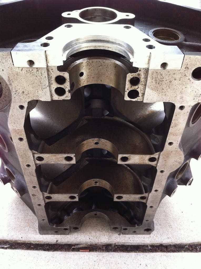

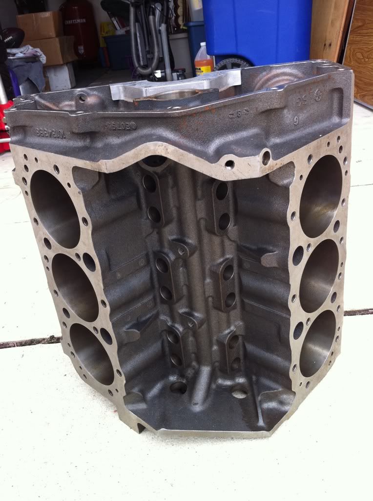

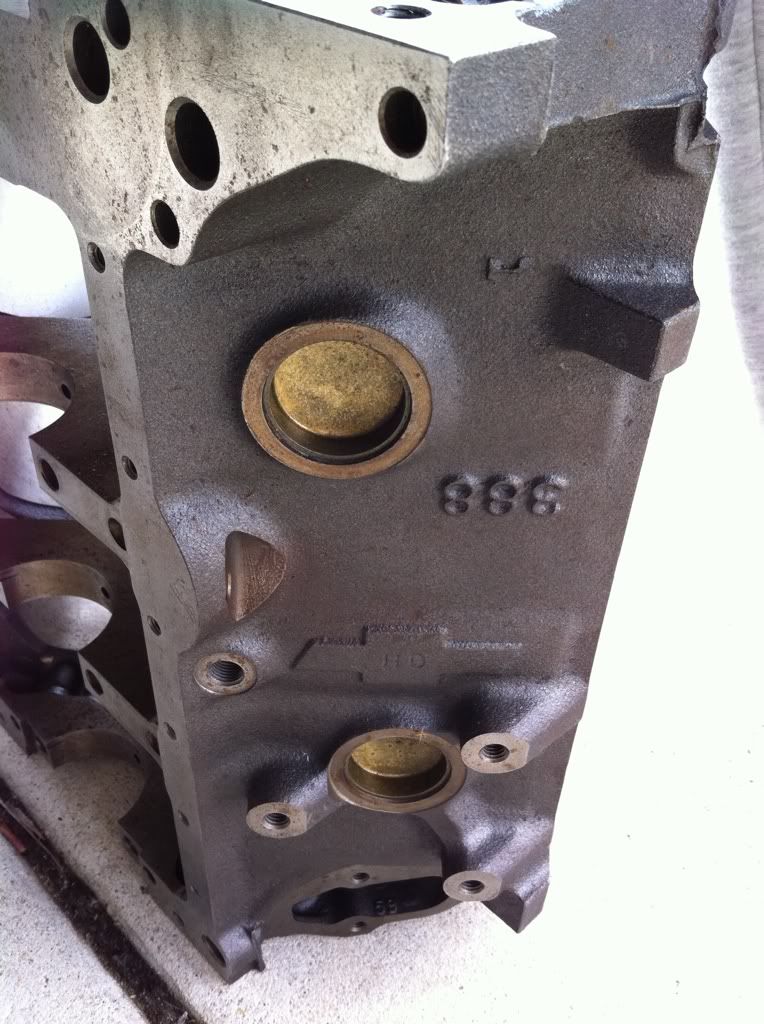

Starting with a factory new Bowtie block 4 bolt splayed and will also get a half fill to give it even more bottom end strength. These blocks have already been 7 sec and are like finding a needle in a haystack

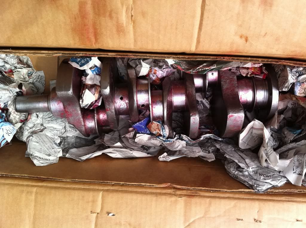

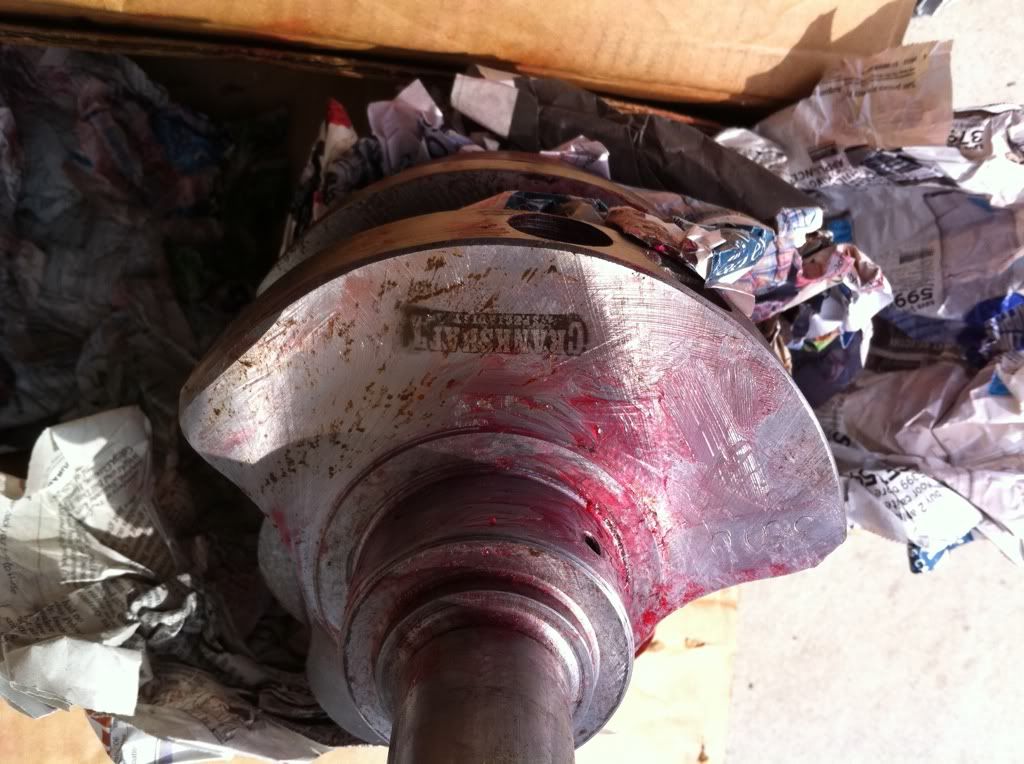

Next up is crankshaft specialities crankshaft small strocker crank ( thanks Harry)

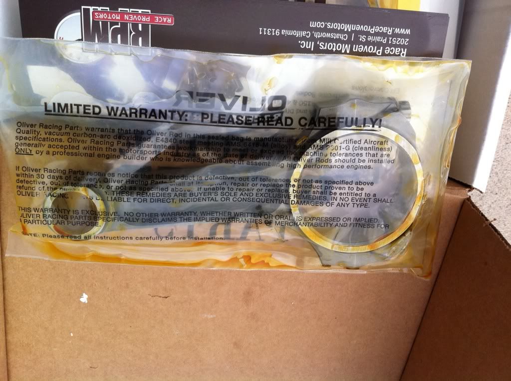

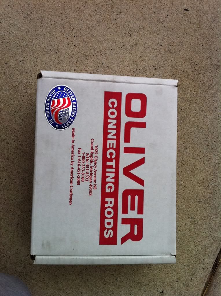

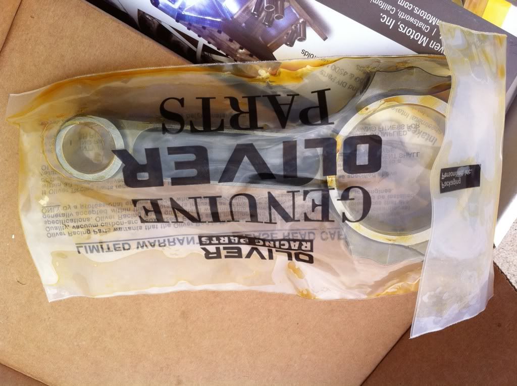

To connect to the crankshaft i picked up one of the last set around right now of Oliver rods from Mike Lee

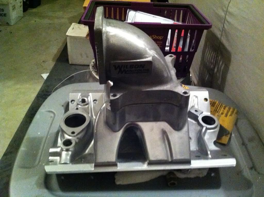

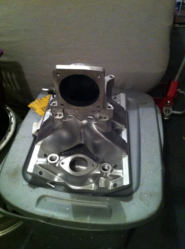

Upper and lower intake Pontiac/Brodix converted for EFI an Wilson 90mm upper intake

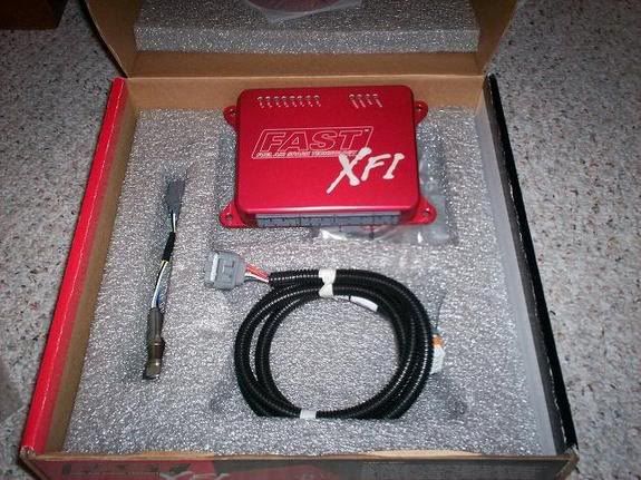

To control it all I got a FAST XFI system

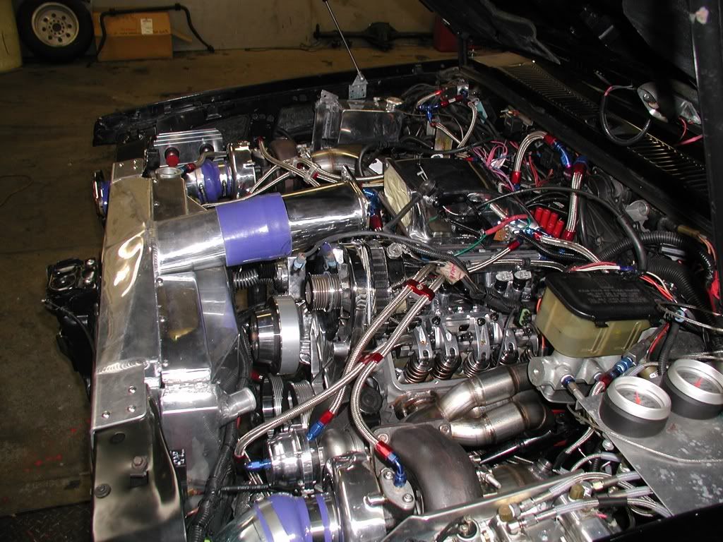

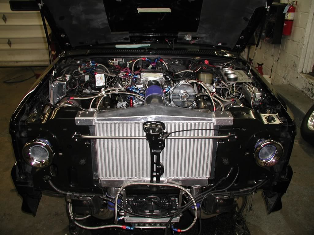

I just picked up from Ed Hess his old front mount intercooler setup that is built as part of the radiator support ( while it was a little twisted from the wall contact we already gotten it straightened an rewelded like new thanks Ed)

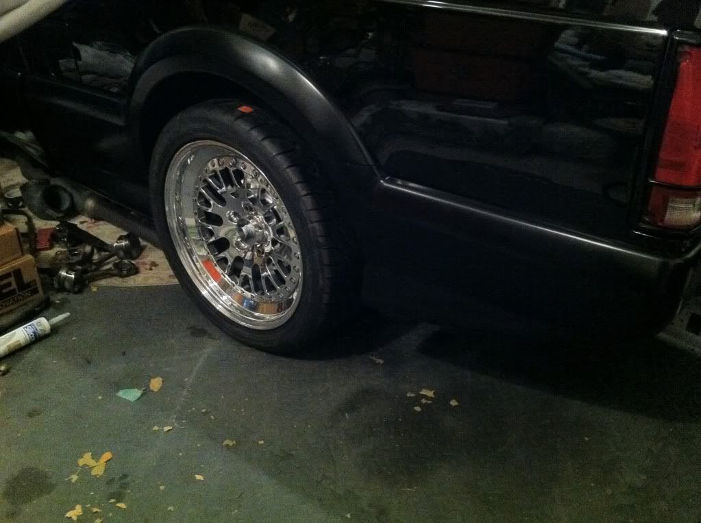

Up front went with Rpm coil overs, Edelbrock end links

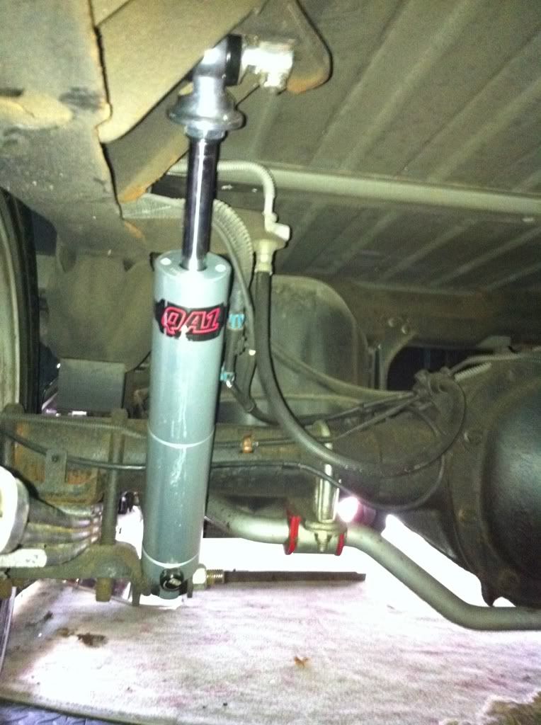

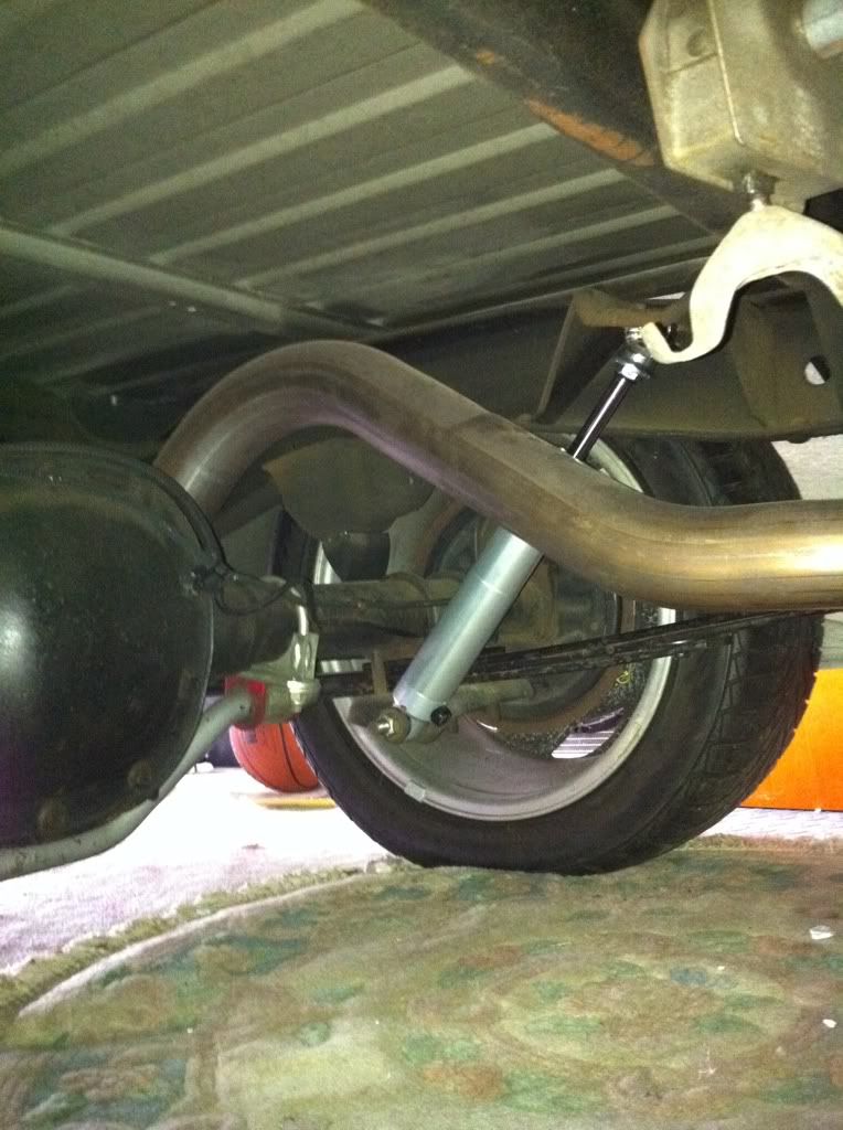

Out back a set of Qa1 12 way adjustable setup has been just installed with a Belltech 2 drop springs and rear sway bar. Caltrac were also just purchased and are I'm the mail.

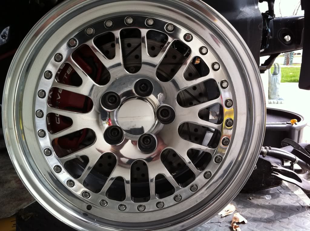

Also installed C5 Zo6 calipers with Baer 14 inch rotors. But just yesterday I got a hold of a set of C6 Zo6 6 piston calipers and have been told they will work with my cbr brackets so they will going on.

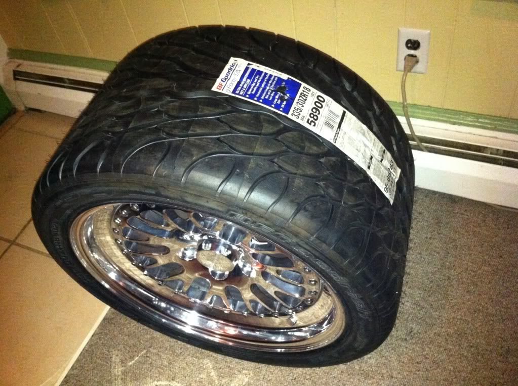

Wheel and tire combo is CCW Classic wrapped in Bfg KDW rubber 18x11.5 out back with 335/30/18 and 18x9.5 295/35/18

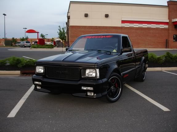

I'm assuming a whole vehicle pic would have been helpful. Truck has 28k miles on it. She has NEVER EVER seen rain and I've had her for 11 yrs and it has NEVER been washed. That will have to change this year as the paint is smoother then most 2011 factory paint jobs, the paint is 20 yrs old and has some fine scratches, so she will be going to OAKS Detailing for a full detail.

Love it!! I would be pissed if my crank came wrapped in newspaper.
