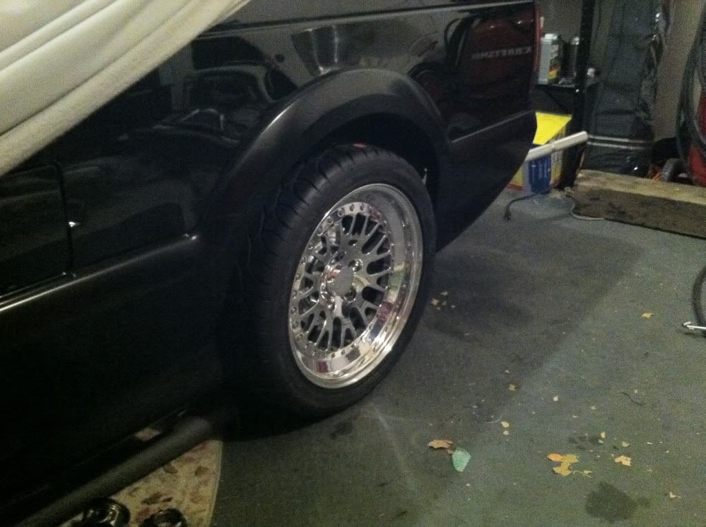

Well u ran into my first hurdle today. The 335 rub. Currently on the sy I have 2" belltech lowering leaf spring and qa-1 12 way adjustable shocks in the back so some told me with a 335 you could run into this problem. So I had some aluminum 1/2 think washer from another project laying around an I out them on between the wheel and the hub and problem solved. So Monday I'll be order 1/2 spacer for the backs.
And here they are just mounted up on one side for test fitting
Sorry for the bad lighting it was in the garage with iPhone 4
