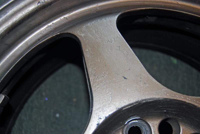

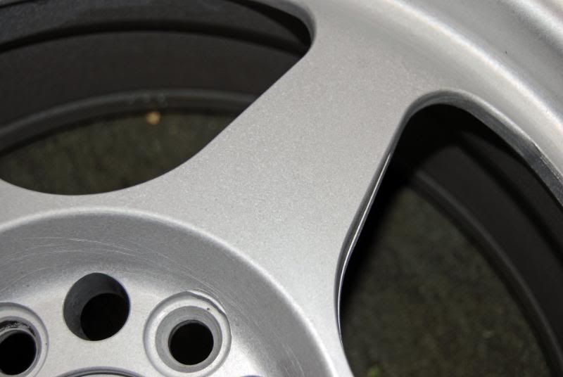

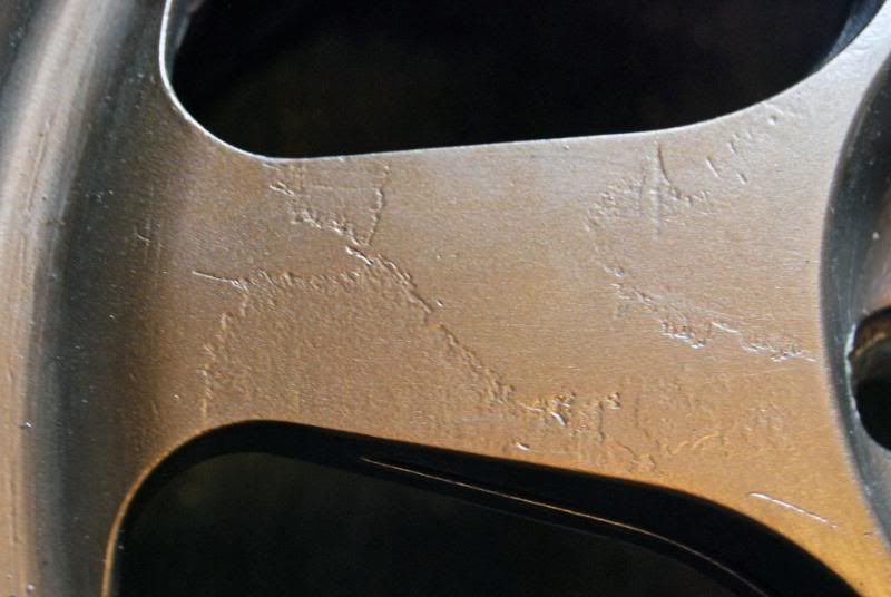

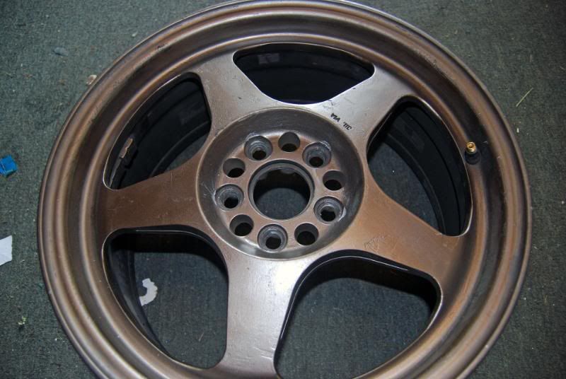

Heres my costumers wheels when he dropped them off. he bought them from some one else and it looks like they used an automotive spray paint on the wheels. Not that i got anything against rattle canning your wheels i actually have seen some that came out pretty good but the longevity is not all that great but as for these wheels they came out looking like CRAP!
http://i12.photobucket.com/albums/a2...20pics/ba1.jpg
http://i12.photobucket.com/albums/a2...20pics/ba2.jpg
http://i12.photobucket.com/albums/a2...20pics/ba3.jpg

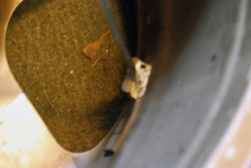

First thing we do is wash the wheel off and get any dirt or grease off.
We then cut the valve stem off and remove any weights.

Once cleaned we then submerge the wheels in a chemical stripper for 15 to 30 minutes to remove any rattle can or factory paints that are on the wheel.
your end results is a clean bare metal wheel and notice that before the crappy paint job made the spokes look like the the metal under the paint was scraped or damage well that is not the case.

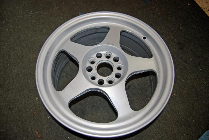

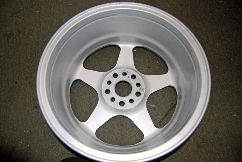

Now that the wheels are cleaned and bare metal we can now media blast the wheels to give it a slight profile. A light media blast profile will help the powder bond to the metal once cured.(Before we media blast we inspect the wheel for any minor curb rash that need to be fixed but with these wheels that was not the case)
As you can now see in the picture the wheel on the left is one that just came out of the chemical stripper and the one on the right was media blasted.
http://i12.photobucket.com/albums/a2...20pics/ba9.jpg

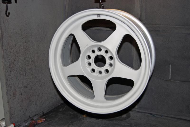

Last step before we coat we spray an Iron Phosphate coat which will protect the metal from rusting and also improves the powder bonding to the metal and making it even stronger.

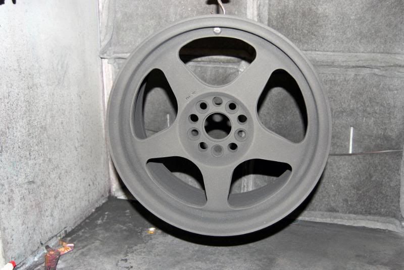

OK we are now ready to shoot the wheel.
http://i12.photobucket.com/albums/a2...0pics/ba10.jpg

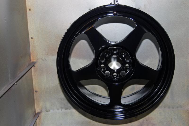

Since this is a two stage coating we first shoot the ink black powder.
http://i12.photobucket.com/albums/a2...0pics/ba11.jpg
off to the oven it goes to flow out and cure
http://i12.photobucket.com/albums/a2...0pics/ba12.jpg

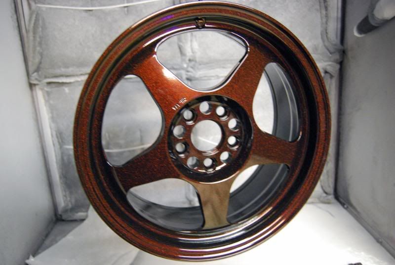

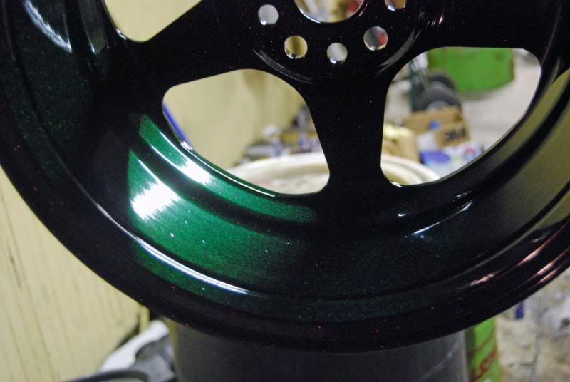

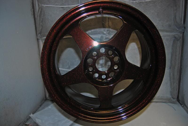

Once the ink black cures and cools off we can then repeat the same process with the moon dust orange which is a clear coat with a color changing flake in it.
I cant get the pics to come out as good since this color changes orange , red , green , gold pics do not do it justice but here is the final results
http://i12.photobucket.com/albums/a2...0pics/ba13.jpg
http://i12.photobucket.com/albums/a2...0pics/ba15.jpg
http://i12.photobucket.com/albums/a2...0pics/ba14.jpg
