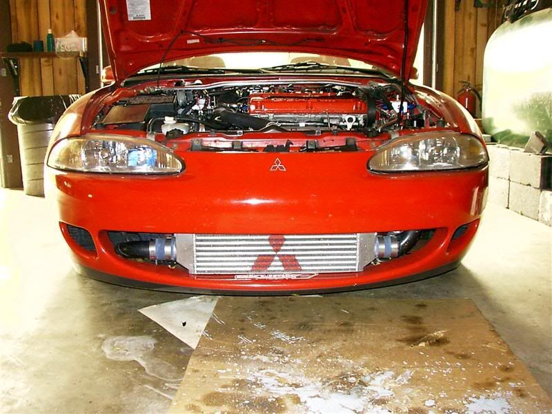

Next mod was a K&N Filter and removal of the factory airbox. I also replaced a intercooler piping resonance chamber with a straight piece of pipe. The mods came to at this point, I made a 2.5" exhaust system with a Greddy muffler and a cold air intake box. Phil remembers that quite well. I also purchased a Spearco FMIC from a friend and made the piping to install it on my car. Road Race Engineering upper IC pipe with 1G BOV. I installed a Greddy Profec B boost controller, 660cc Denso injectors, HKS EGT gauge, SAFC, Walbro 255HP fuel pump, and built my braided stainless fuel system with Aeromotive adjustable fuel pressure regulator. I also removed the balance shafts with a kit I made myself. Lowered with a set of Skunk2 coil overs. All this and still on the stock turbo, I was ready for an upgrade.

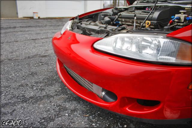

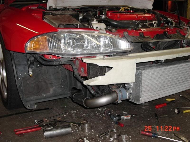

IC Piping fabrication.
http://i85.photobucket.com/albums/k5...TrimMedium.jpg
http://i85.photobucket.com/albums/k5...0078Medium.jpg

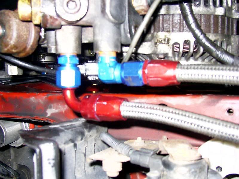

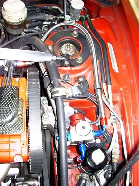

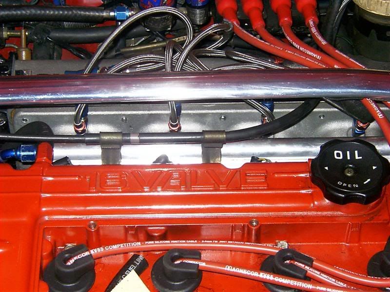

Adjustable FPR and lines.
http://i85.photobucket.com/albums/k5...0081Medium.jpg

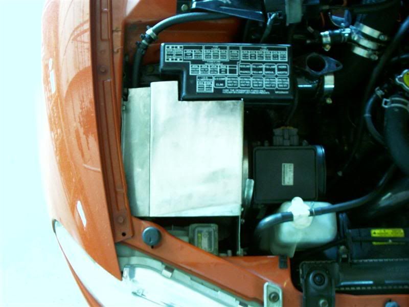

Cold air box.
http://i85.photobucket.com/albums/k5...0076Medium.jpg

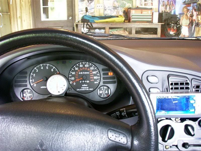

EGT gauge and SAFC.
http://i85.photobucket.com/albums/k5...0073Medium.jpg

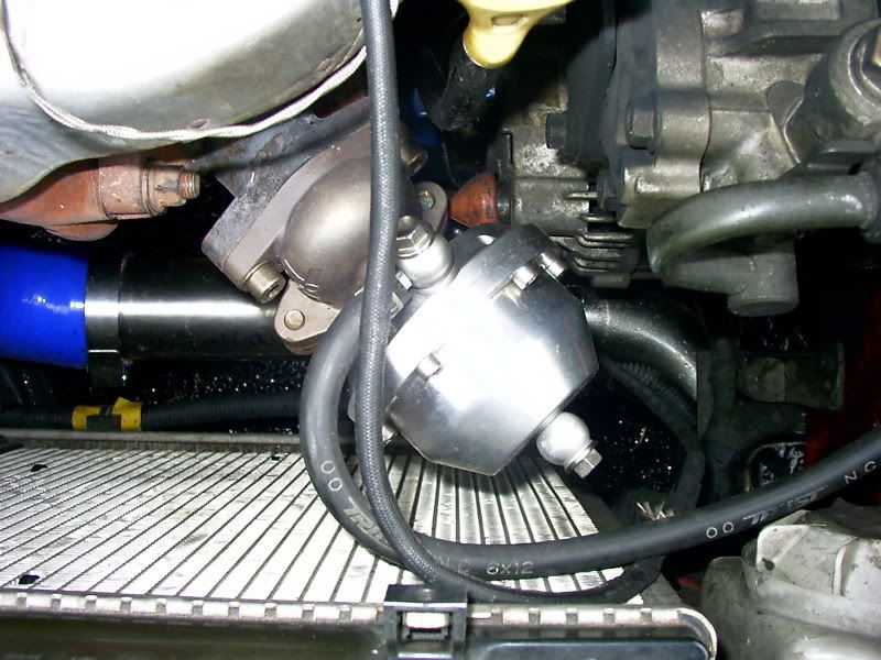

Wastegate dump.
http://i85.photobucket.com/albums/k5...ays/Gsx014.jpg

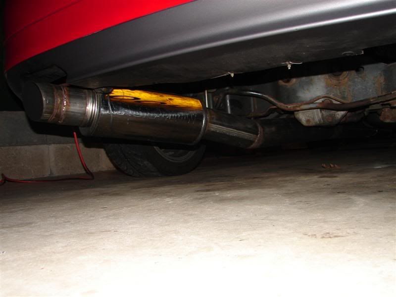

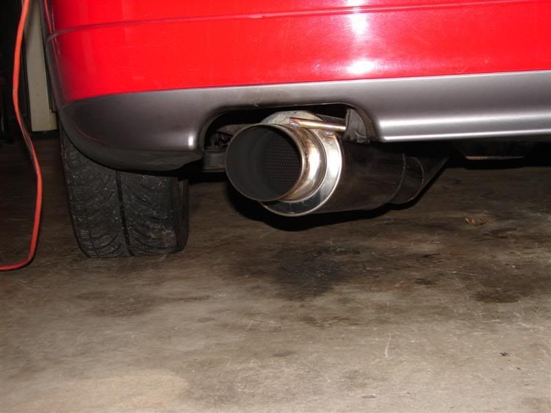

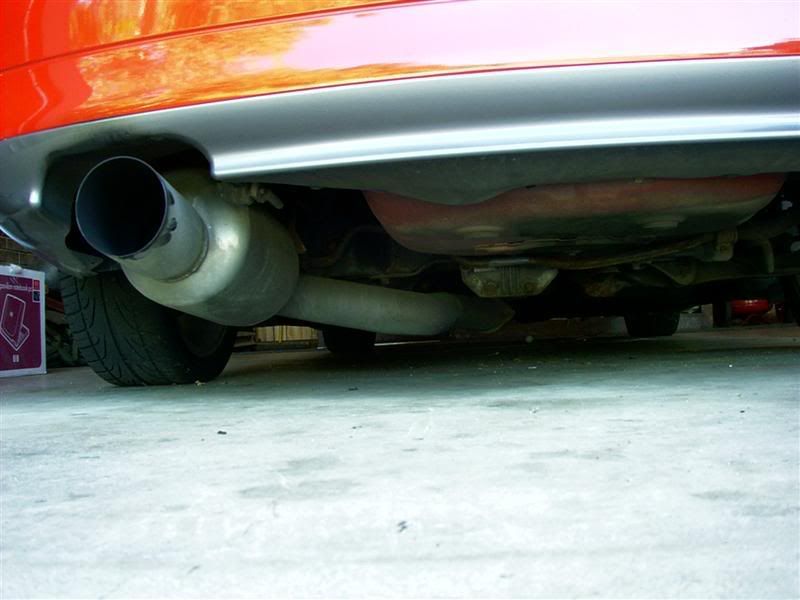

Apex'i Dunk exhaust.
http://i85.photobucket.com/albums/k5...0022Medium.jpg

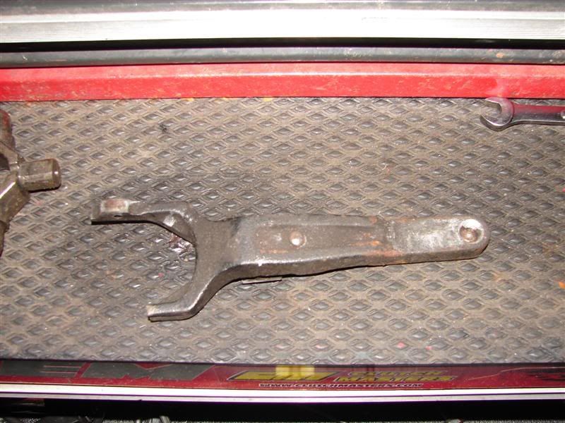

Broken clutch release fork.
http://i85.photobucket.com/albums/k5...2924Medium.jpg

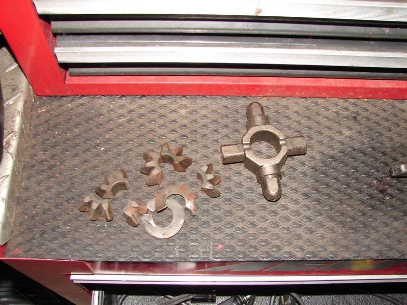

Broken center diff spider gears.
http://i85.photobucket.com/albums/k5...2923Medium.jpg

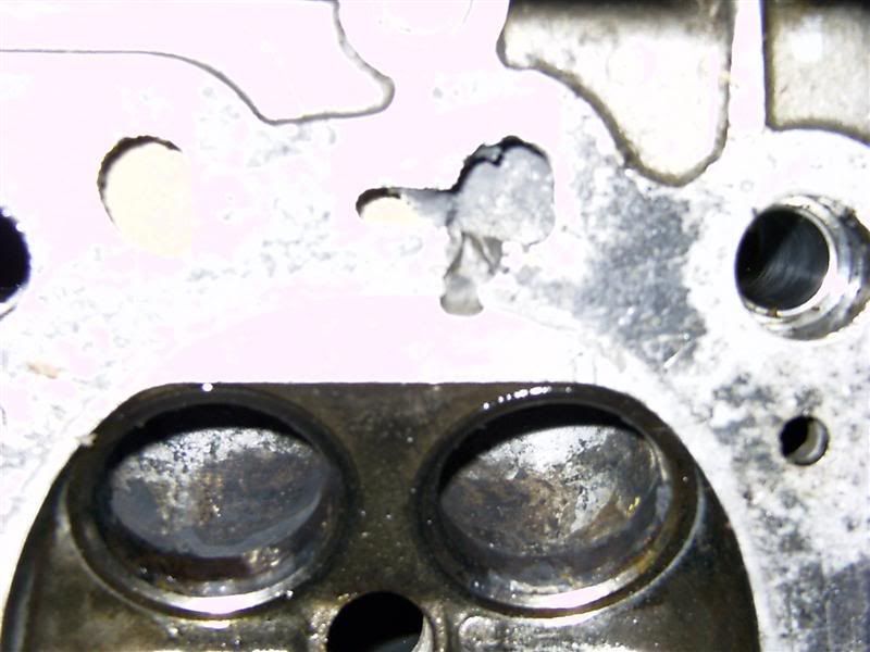

Melted head.
http://i85.photobucket.com/albums/k5...r118Medium.jpg

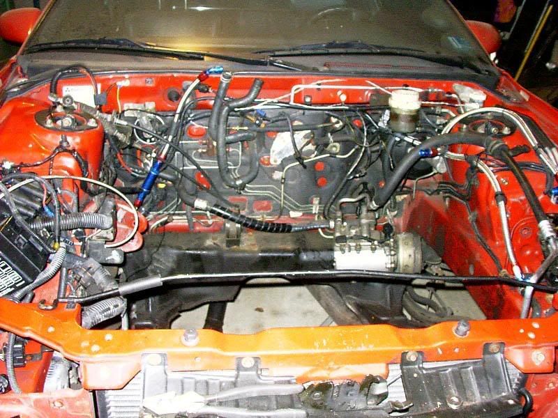

Pictures.
Engine compartment.
http://i85.photobucket.com/albums/k5...x025Medium.jpg

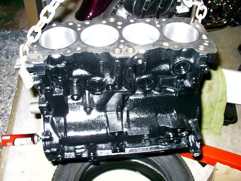

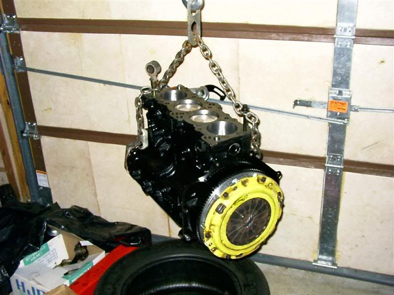

New shortblock.
http://i85.photobucket.com/albums/k5...x026Medium.jpg
Ready to go in.
http://i85.photobucket.com/albums/k5...r087Medium.jpg

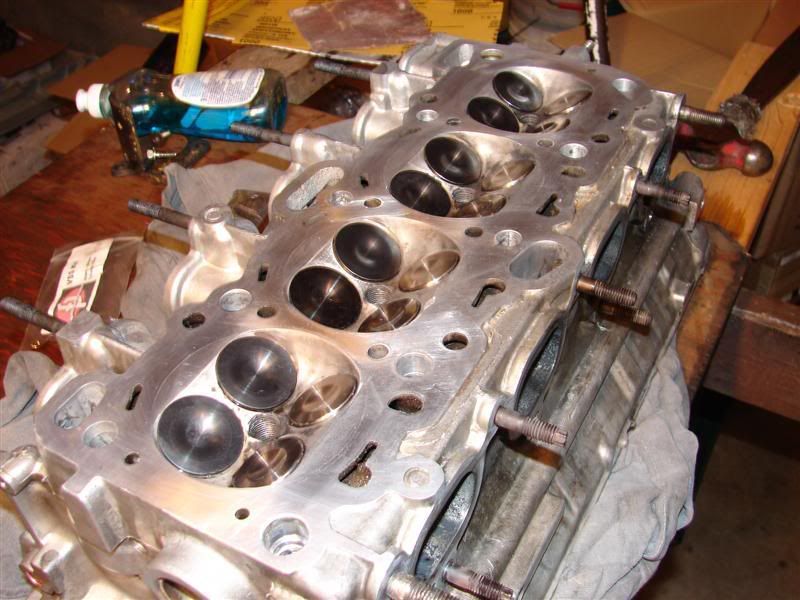

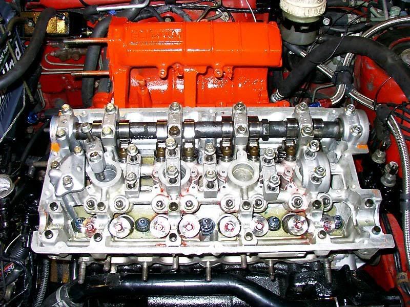

Head.
http://i85.photobucket.com/albums/k5...x028Medium.jpg

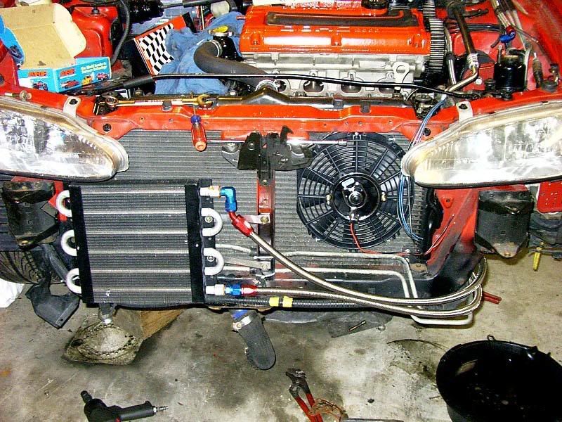

Oil cooler installation.
http://i85.photobucket.com/albums/k5...x023Medium.jpg

I decided to order up a ported head from one of the leaders at the time, Forrester Race Heads. I bought what he called a "stage 1" which included 1mm over stainless valves and new guides. It took forever to get the head, so Mr. Forrester sent me one of his big bad race heads with bronze valve guides, and 1mm over Supertech nitrided valves. He also included a $600 intake manifold for free. Fuel Injector Clinic also gave me one of their fuel rails to test fitment. Kinetic Motorsports was in the final stages of releasing a front mount intercooler kit for the 2G DSMs and I did final fitment with one of their prototypes, that was given to me at an extreme discount.
With all these new parts installed, the car was faster than ever. But still used oil, the detonation problem went away.

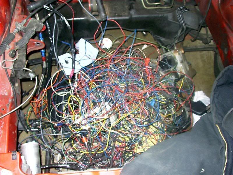

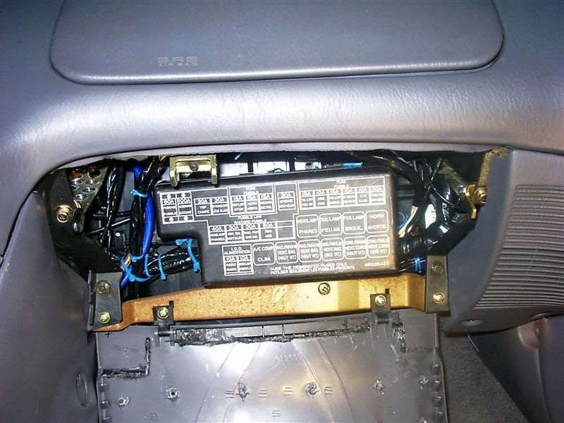

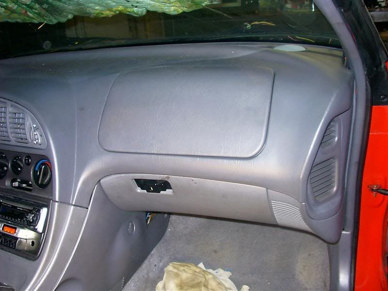

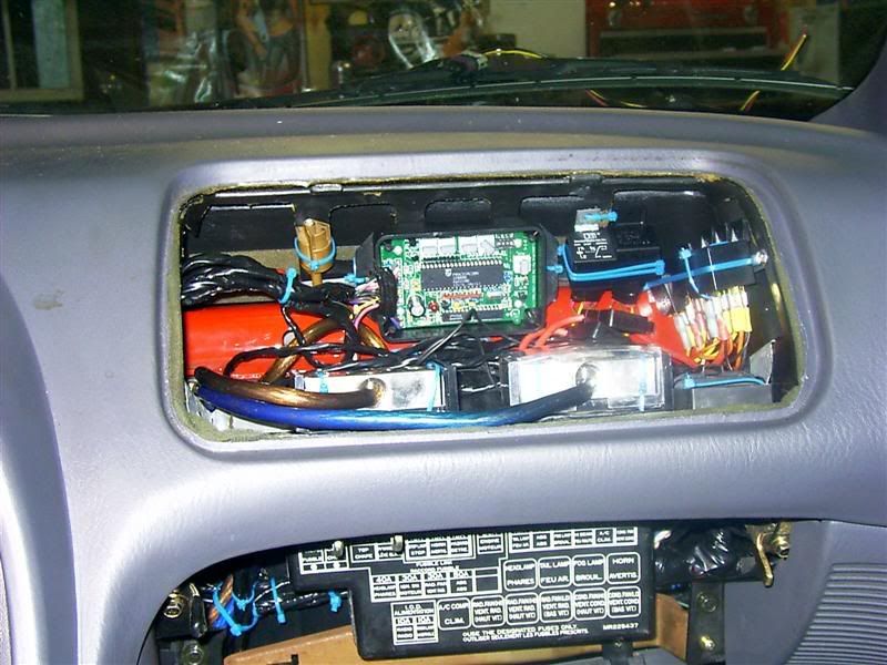

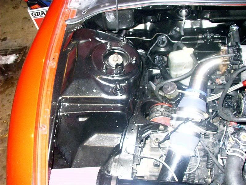

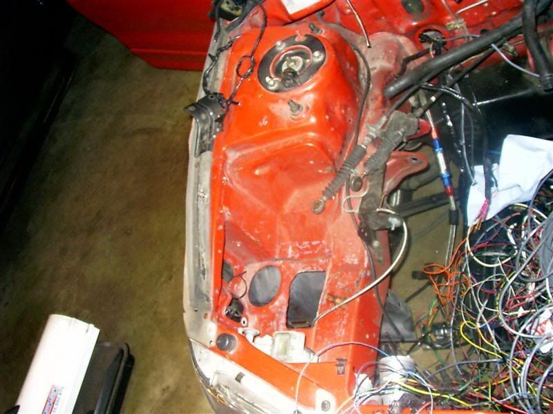

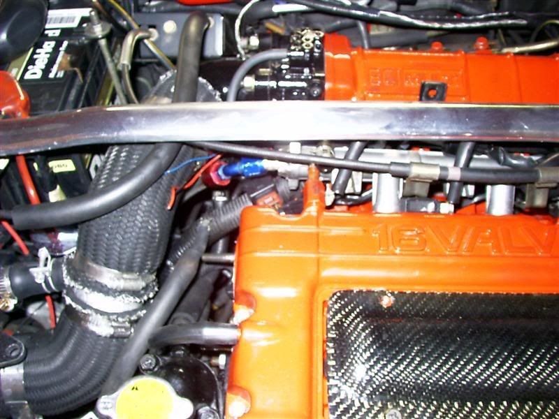

While waiting for funds to get all the parts I needed for reassembly, I decided on a few "free" mods. I removed all the sound deadener and insulation from the passenger compartment. I also decided to get the ABS system out of the car. It was heavy, and didn't work properly. I moved the fuse and relay box to the glove compartment and rewired the whole car too. I wanted the extra space for intercooler piping, and I wanted to clean up the engine compartment a bit.
The ABS removal wasn't too bad with the engine out of the car. I bought all factory Mitsu parts for a non-ABS car, removed the old lines, and installed the new.
The rewire was a different story, that took 4 hours a day for about a month to complete to my satisfaction. I removed over 10lbs of wire from the car and routed the wire in a way that made sense. To my amazement, everything worked when I put power to it.
I also fabricated a twin intank Walbro 255HP setup, as I felt I wanted more available fuel flow when using the nitrous.
I also painted the engine compartment black with metalflake, and clearcoated it. All rattlecan so it's not that great, but better than the red it was.
Pictures.
Fuse and relay box gone.
http://i85.photobucket.com/albums/k5...d/IMAG0052.jpg
Behind the dash.
http://i85.photobucket.com/albums/k5...d/IMAG0028.jpg
Removed wireing and ABS crap.
http://i85.photobucket.com/albums/k5...d/IMAG0059.jpg
Fuse and relay box location.
http://i85.photobucket.com/albums/k5...d/IMAG0054.jpg
Main battery junctions, relays, ignition module, generator relay, and MAF-T box.
http://i85.photobucket.com/albums/k5...d/IMAG0057.jpg
Closed up.
http://i85.photobucket.com/albums/k5...d/IMAG0053.jpg

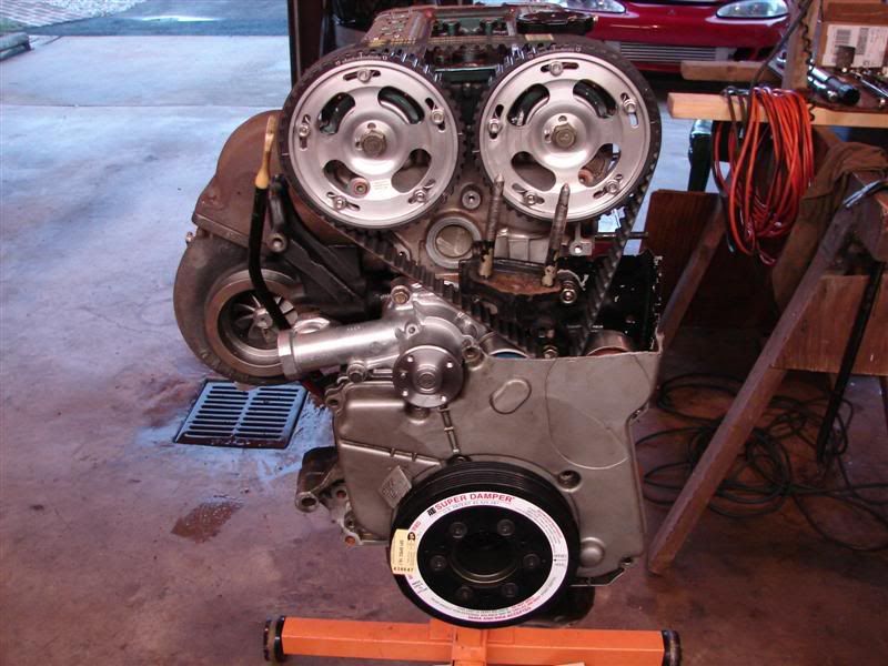

Degreeing the cams.
http://i85.photobucket.com/albums/k5...d/IMAG0064.jpg

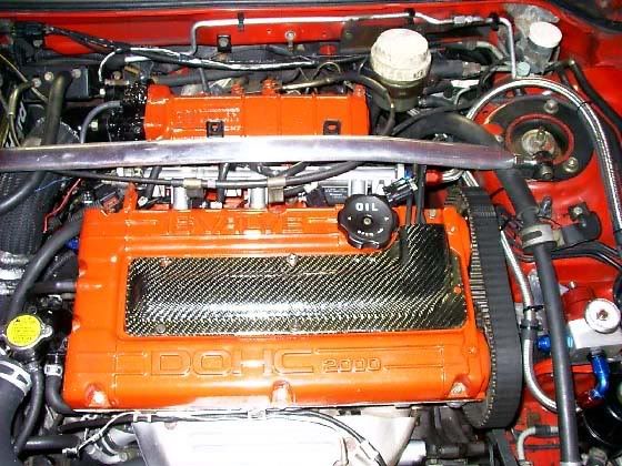

Completed engine compartment.
http://i85.photobucket.com/albums/k5...d/IMAG0074.jpg
http://i85.photobucket.com/albums/k5...d/IMAG0073.jpg
http://i85.photobucket.com/albums/k5.../IMAG00691.jpg

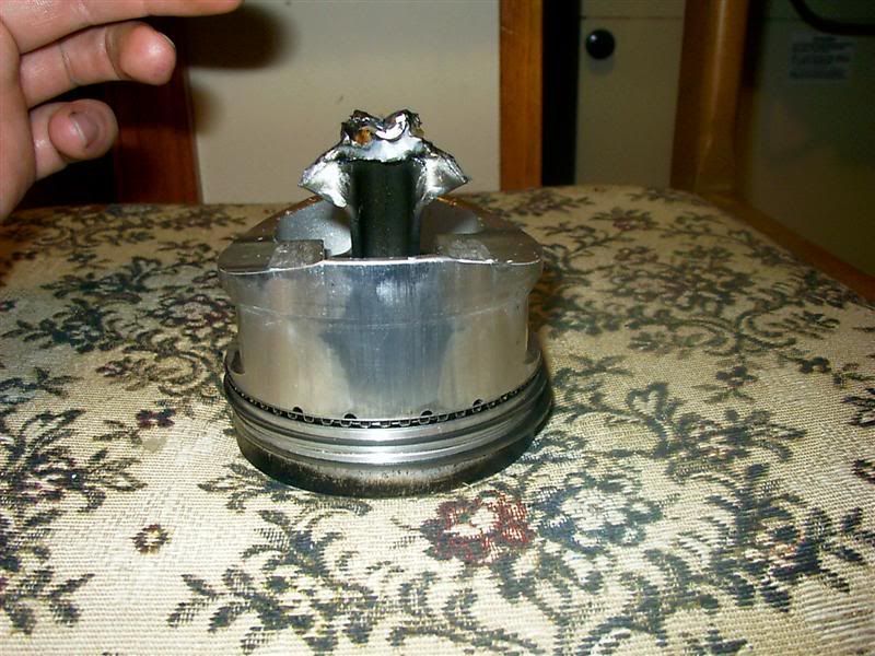

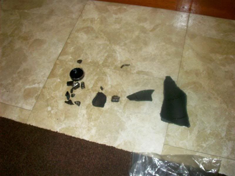

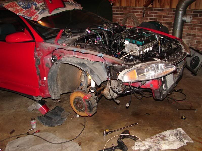

BlinkerFluid 01-13-2009 11:08 PM

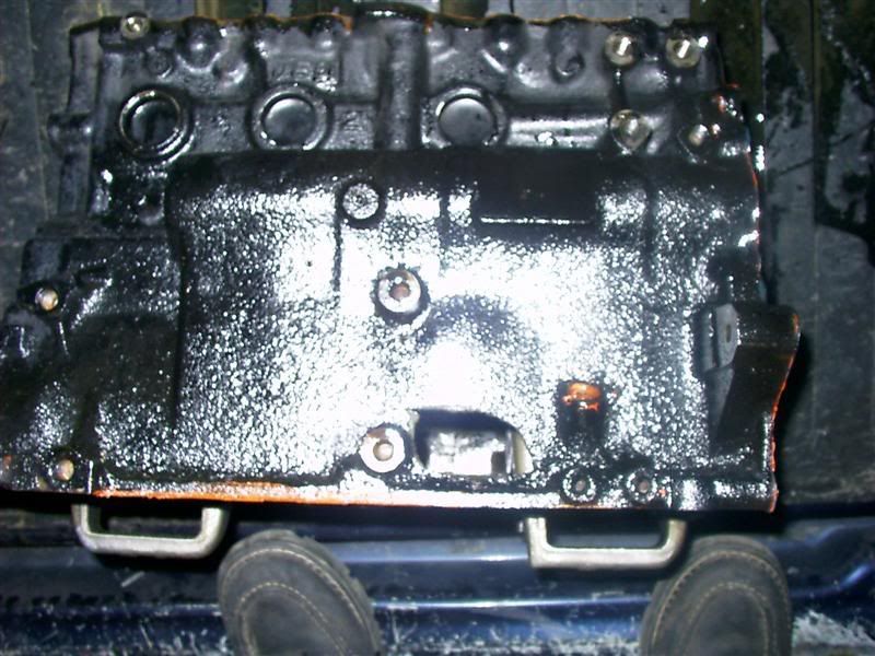

I got the car put back together and once again, it was faster than ever. It didn't even use oil anymore. I didn't manage to get it to the track like this though. Did a lot of stomping around on the street with race fuel, 30psi, and nitrous. I did get called out once, and then heard a lot of excuses.
One night out tooling around with my buddy in the passenger seat, I looked over and said, "watch this!" I should have known better. Armed the nitrous, hit it in 3rd gear, grabbed 4th gear. KABLAM, jingle jingle jingle... It sounded like I had run over a trash can full of marbles and beer bottles. I caught a glimpse of a fireball in the rearview mirror. My buddy thought the flywheel was coming through the firewall for his legs. During the pull, his seat had flexed back, and the inertia reel activated, locking the seatbelt very tight. In his panic, he tried to release his seatbelt and go for the back of the car. He was like a cat clawing at a fly on the other side of a window screen. I knew I lost a cylinder, but I still had power available. I pulled off an offramp and shut the car down. I was then advised that I should move to a different area due to some others activities farther up the road. I figured, "what the hell, can't hurt it anymore." It was very potent, the smell of hot oil and coolant. I guessed I set the piston ring gaps too tight and one siezed and pulled the wrist pin out of the bottom of the piston, or a bearing clearance was wrong and siezed on the crank, or a rod bolt backed out because I didn't torque it properly.
I jumped back into the drivers seat and hit the key, the thing fired on 3 cylinders, away we went. About 5 miles with no oil or coolant.

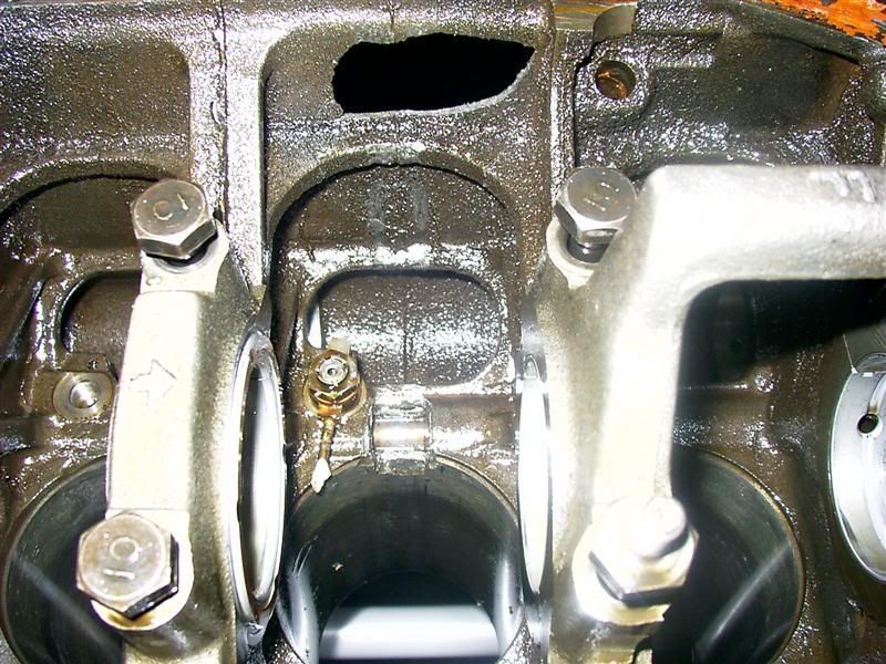

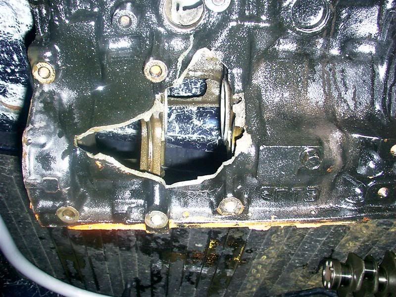

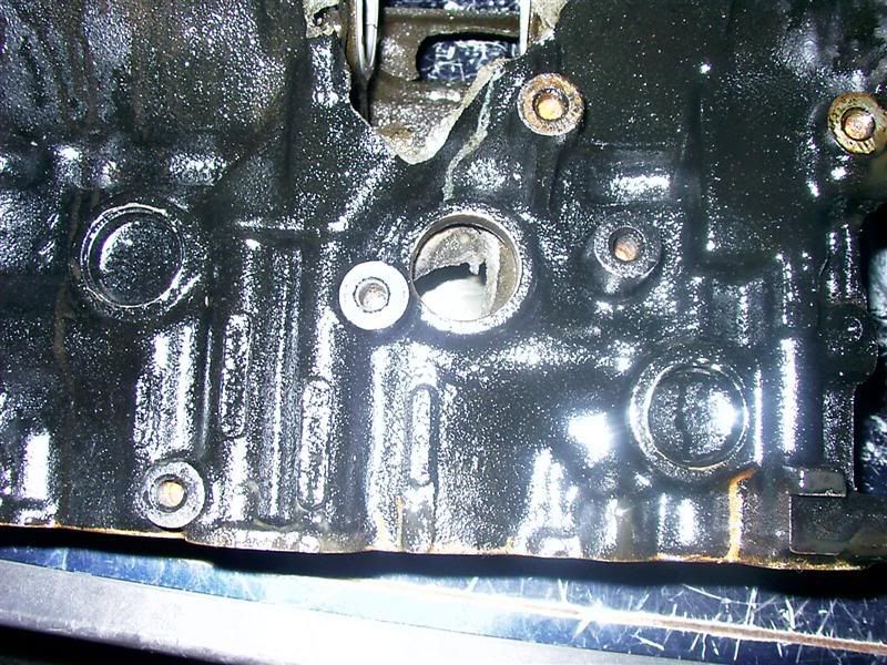

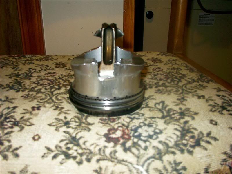

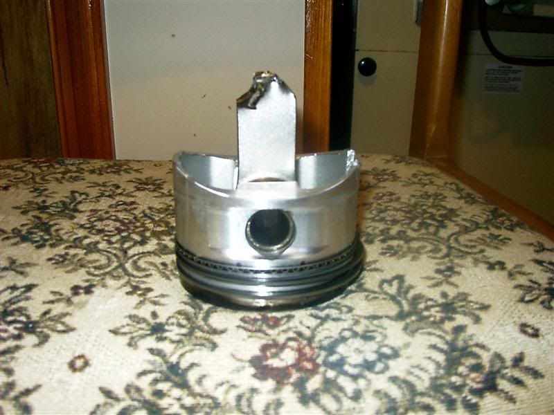

I dug out the tools and flashlight to inspect the damage. I immediately found a hole in the front of the block... and another hole in the back of the block. Investigation showed the broken connecting rod was still bolted to the crank, and still rotated on the pin. I pulled the spark plugs and checked the pistons, #2 was siezed in the bore. I thought I ruined the head also.
A call to AAA later I was in a roll back on my way home. I had the engine apart and on the ground in about 40 minutes. The #2 connecting rod had broken mid beam and gone right through the cylinder wall, locking the piston in the bore, it took a hammer to free it. The piston didn't touch the head, I got lucky. Even after driving no oil or coolant, the crankshaft was perfect, I checked it for straightness, polished it, and put it in the new engine. There were no signs of detonation or a lean condition on the plugs, head, or pistons. Failure was a mechanical failure of the connecting rod, or a serious pre-ignition event which I doubt. I did notice the 3 remaining connecting rods had some machining imperfections in the same spot where the one broke. I could have possibly prevented this failure if I had performed a more through inspection. Not discrediting Eagle rods, but I will not use them again.
Pictures.
Engine block.
http://i85.photobucket.com/albums/k5...e/IMAG0071.jpg
http://i85.photobucket.com/albums/k5...e/IMAG0072.jpg
http://i85.photobucket.com/albums/k5...e/IMAG0069.jpg
http://i85.photobucket.com/albums/k5...e/IMAG0068.jpg
Piston.
http://i85.photobucket.com/albums/k5...e/IMAG0075.jpg
http://i85.photobucket.com/albums/k5...e/IMAG0074.jpg
http://i85.photobucket.com/albums/k5...e/IMAG0077.jpg

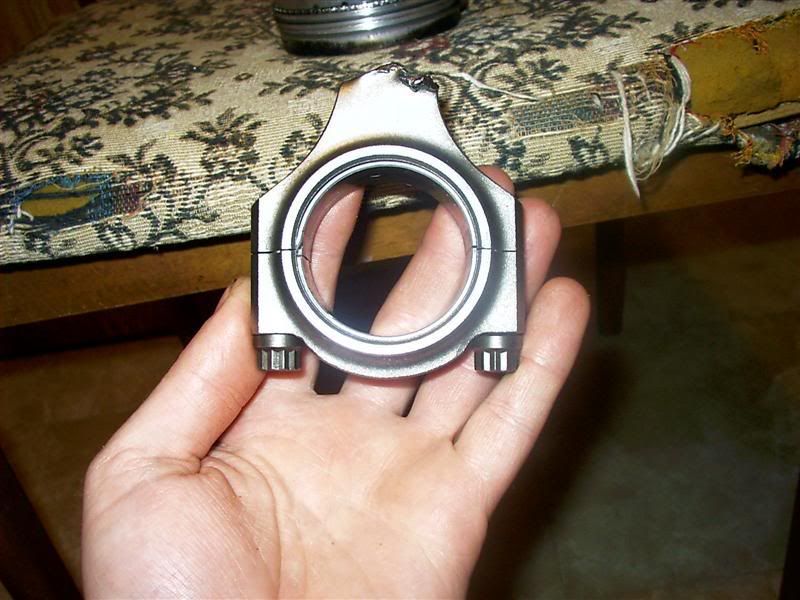

Rod.
http://i85.photobucket.com/albums/k5...e/IMAG0079.jpg
http://i85.photobucket.com/albums/k5...e/IMAG0078.jpg
http://i85.photobucket.com/albums/k5...e/IMAG0082.jpg

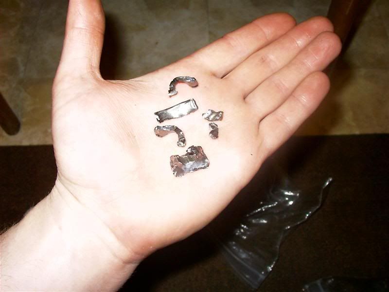

Pieces of rod.
http://i85.photobucket.com/albums/k5...e/IMAG0083.jpg
Pieces of block.
http://i85.photobucket.com/albums/k5...e/IMAG0084.jpg

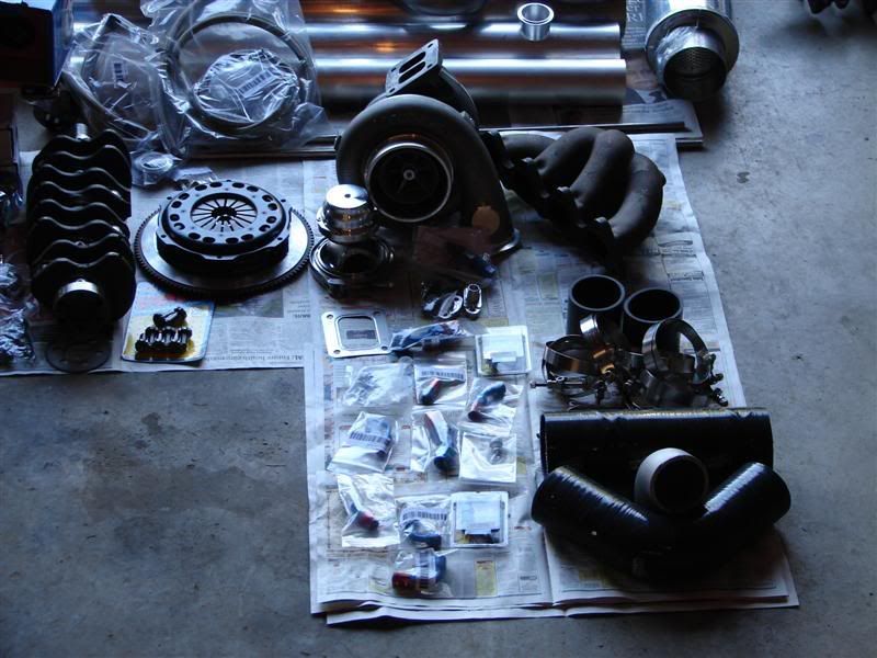

Enter another deployment before I could get the car together.

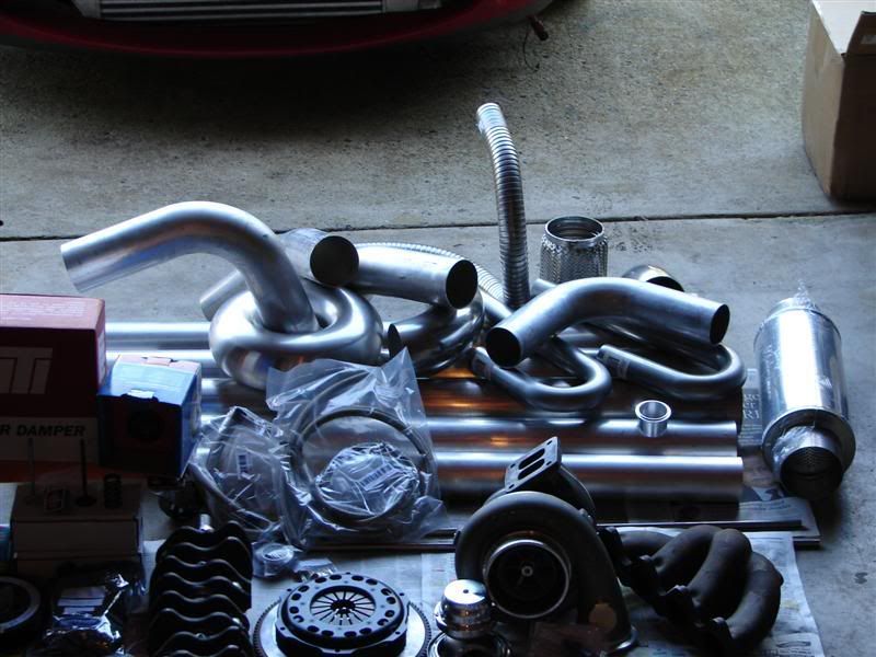

I spent a lot of time on the internet and phone discussing different options, trying to figure out what I want to do with the car. I finally settled on building a street legal race car. I was tossing the idea around of going to a 2.4L but decided I'd rather have a high revving 2.0. Now on to pick the pieces of the puzzle. I selected and purchased all the parts while I was 5000 miles from home, and to my amazement, they all fit together perfectly.

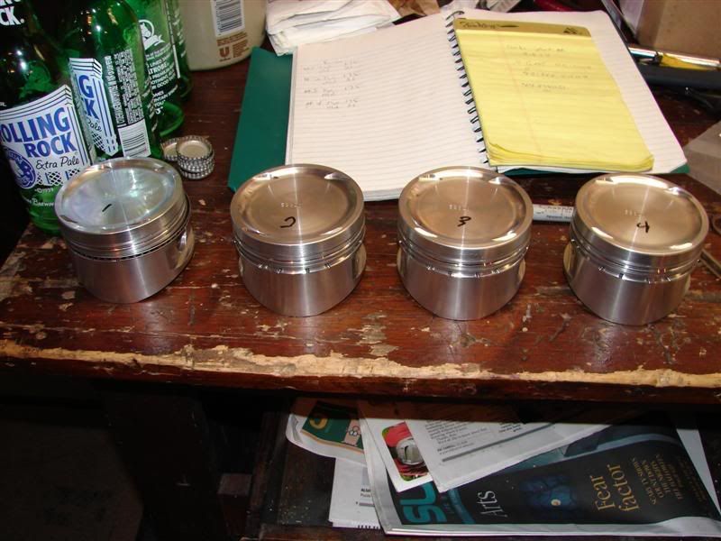

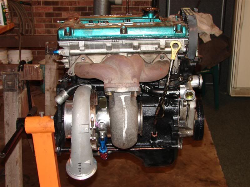

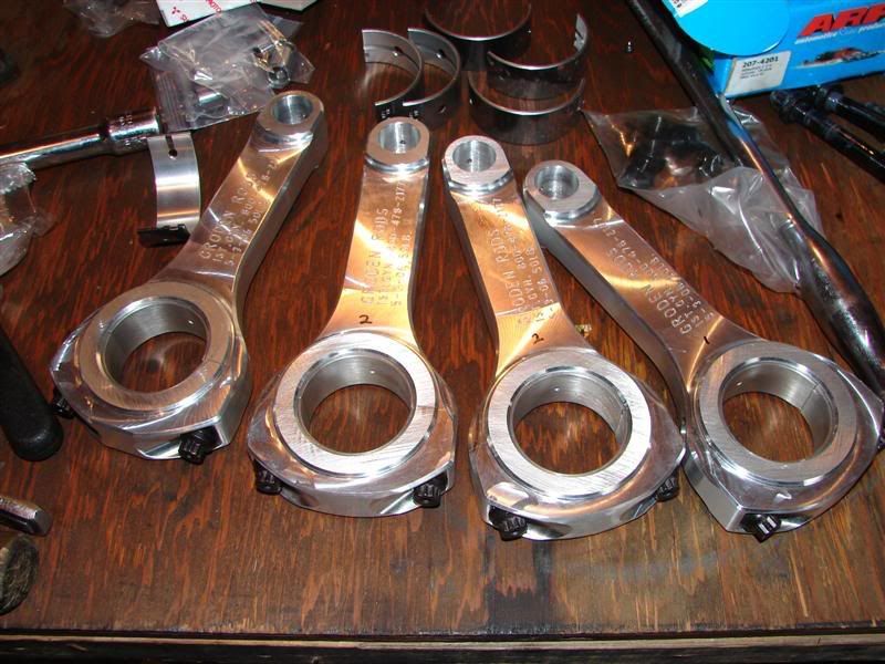

For the engine, I decided to try a set of Groden aluminum rods, that's right, aluminum. I decided on the same Ross .020" over pistons as they had taken a lot of abuse in my previous engine. I again picked the HKS head gasket as it is a great design compared to others on the market. I also decided to install new 1mm over Supertech nitrided intake valves, and 1mm over Supertech inconel exhaust valves. Supertech dual valves springs and retainers were also added. I used the crankshaft from the engine that had the rod failure, as it was perfect when I magnafluxed it and checked it out. I had to modify the main bearing bridge caps for clearance of the aluminum rods. I knew I would be spinning it to 10K so I decided on the ATI 4G63 harmonic dampener, as the stockers fall apart with time.

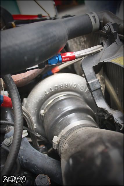

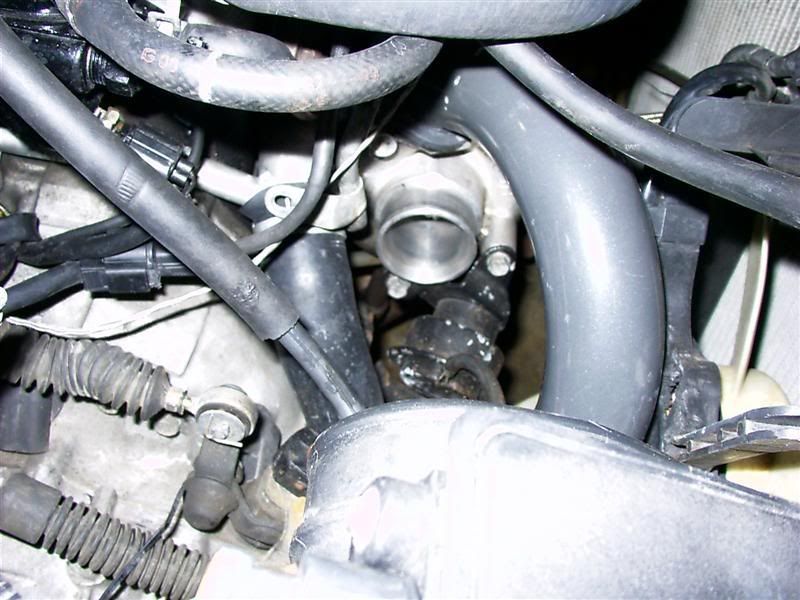

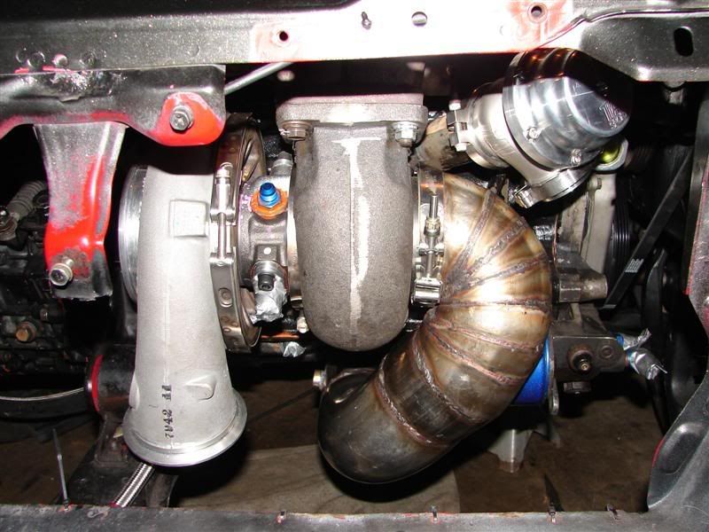

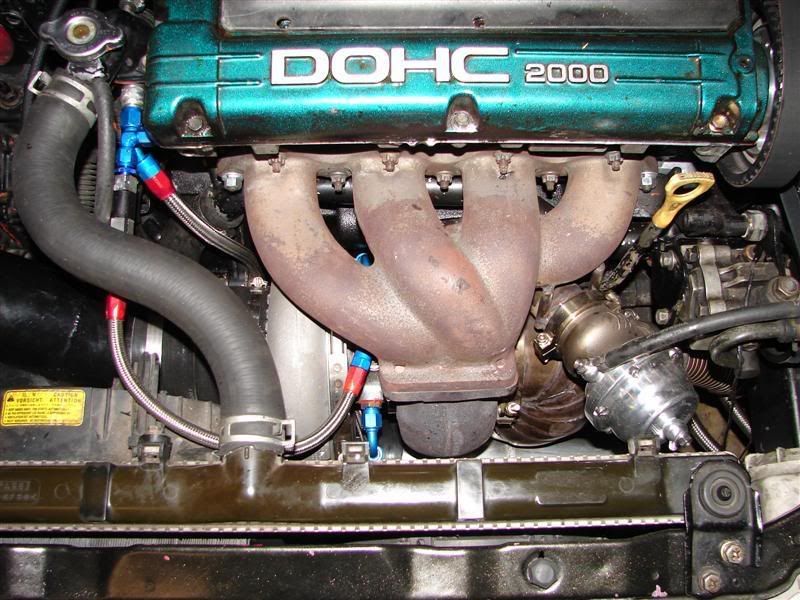

I originally wanted to use a 67mm inducer turbo, such as a Forced Performance 3575 or a T67 of some sort on an HKS DSM manifold. After seeing results from the 67mm turbos, I decided to go bigger and ended up with a GT4202R, which is a 74mm inducer. Amazingly the 42R fit in the 2G engine compartment hanging off the HKS copy manifold, even with the stock fan in place. I knew my current intercooler piping and exhaust would not mate with this behemoth. With the help of a friend, we made new aluminum IC pipeing, 3" from the turbo to the FMIC, and 3.5" from the FMIC to MAF and then on to the Infiniti Q45 85mm throttlebody. We also had to make a custom adapter plate to bolt that throttlebody onto my intake manifold. I built a 4" exhaust from scratch of stainless pipe and Magnaflow Muffler. I also made my own wastegate plumbing for the 44mm Tial. Oil and coolant are carried to and from the turbo via braided stainless lines and the proper fittings.

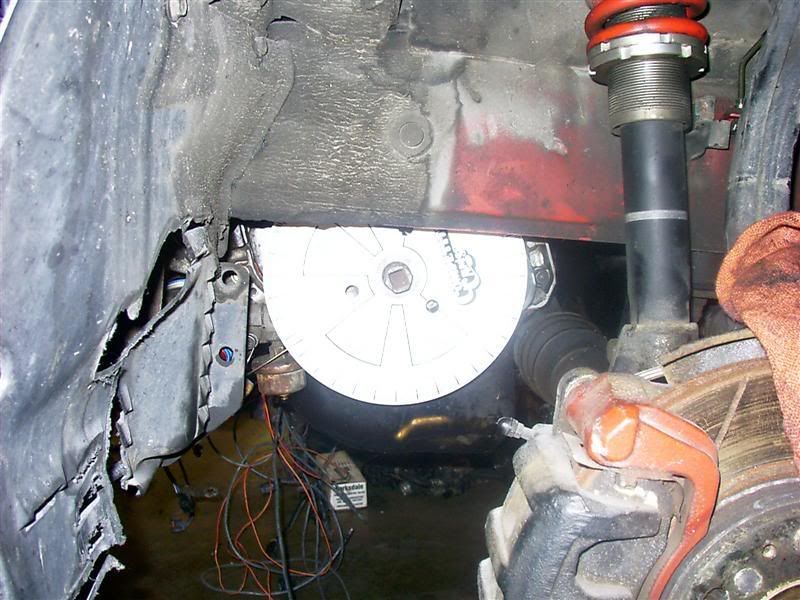

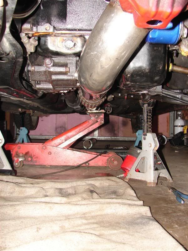

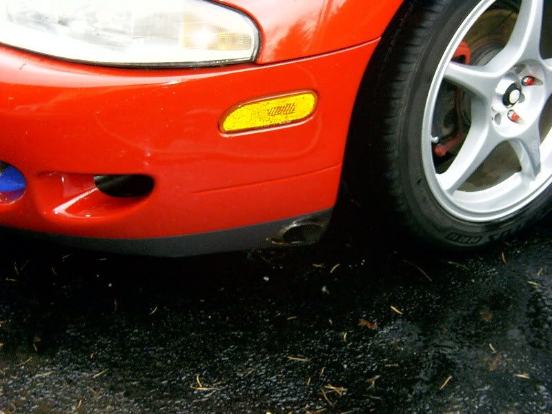

In order to make room for a 4" downpipe, I had to relocate the alternator to the rear of the engine block. I made a bracket and adjuster from stainless, it works flawlessly. I drove it from the inside belt groove on the crank pully, it's normally driven by the outside. This kept me from having to beat a dent in the unibody frame rail. I then had to slide the powersteering pump outboard 5/8" to use it to tension the belt that drives the waterpump in the outside groove of the crank pulley. Upon relocating the alternator, I had to do some more wireing to get the wire where it needed to be.
I also relocated the battery to the trunk in the past, and finally added the necissary NHRA legal battery box and external kill switch. I also removed my HKS EGT gauge, and installed an AEM wideband, real logging of AFR finally.
I had ideas of running E85, and I knew I would need up to %25 more fuel. I felt my twin intank setup wouldn't be enough to keep the new 1600cc/min injectors happy. I installed an inline 255HP to assist. Yes, I have 3 fuel pumps, yes, I need them.
I knew the drivetrain was going to take some abuse, I haven't mentioned how many times I had broken 3rd or 4th gear doing highway pulls. I needed something that would take a beating. Straight cut gears are strong, so is dog engagment. Goodbye synchronizers, hello crashbox. If you haven't heard my car while shifting, it's deffinately called a crashbox for a reason. Brian and I had to do a little machine work on the transmission case to get the input shaft to fit. From there I had to do other various modifications of oil troughs and the reverse idler gear linkage to get it all working. No instructions on this one, it seems I put it together properly.

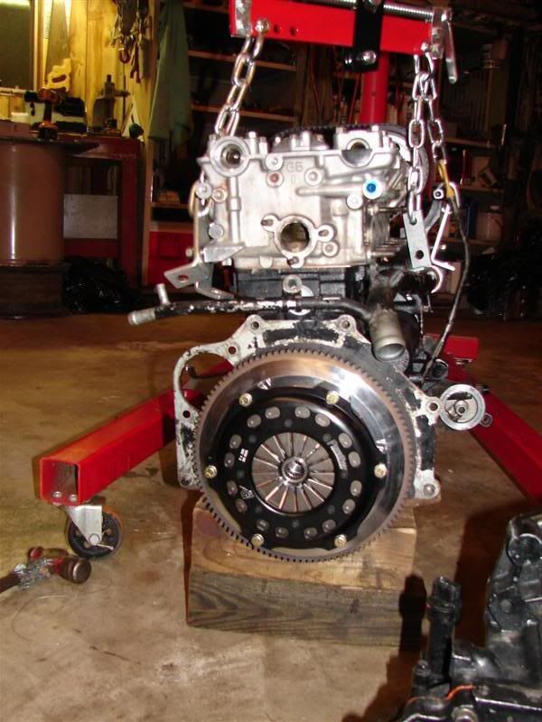

A clutch that could take the abuse was next on the list. I knew single disc wouldn't handle it. I went to Powertrain Technology and got my hands on a twin disc high torque rated clutch with the proper spline for my non-stock sized input shaft. Pedal feel and engagment is predictable and consistant.
The next drivetrain part that I addressed is the rear axles, they like to snap in a hurry at the first sign of wheel hop and high power. I replaced the axle shafts with the Drive Shaft Shop axle bar upgrade.
I also finally ditched the factory struts for some Tokico Illumas.
That's all I can remember.

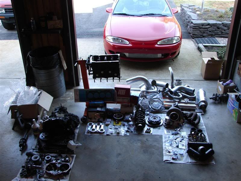

More pictures.

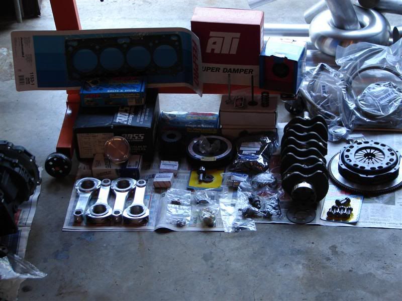

Parts, parts and more parts.
http://i85.photobucket.com/albums/k5...d/DSC02078.jpg
http://i85.photobucket.com/albums/k5...d/DSC02082.jpg
http://i85.photobucket.com/albums/k5...d/DSC02085.jpg
http://i85.photobucket.com/albums/k5...d/DSC02083.jpg

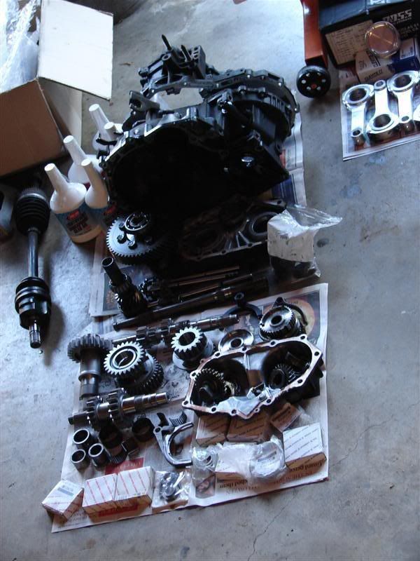

Dog box parts.
http://i85.photobucket.com/albums/k5...d/DSC02079.jpg
Flywheel, notice the safetywire.
http://i85.photobucket.com/albums/k5...d/DSC02130.jpg
Clutch.
http://i85.photobucket.com/albums/k5...d/DSC02135.jpg
Head.
http://i85.photobucket.com/albums/k5...d/DSC02105.jpg

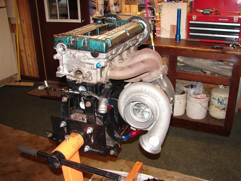

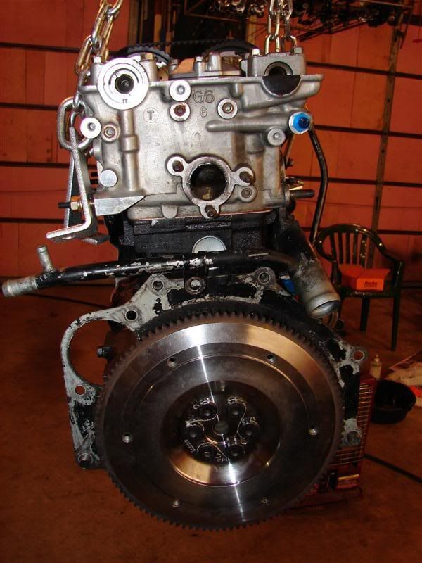

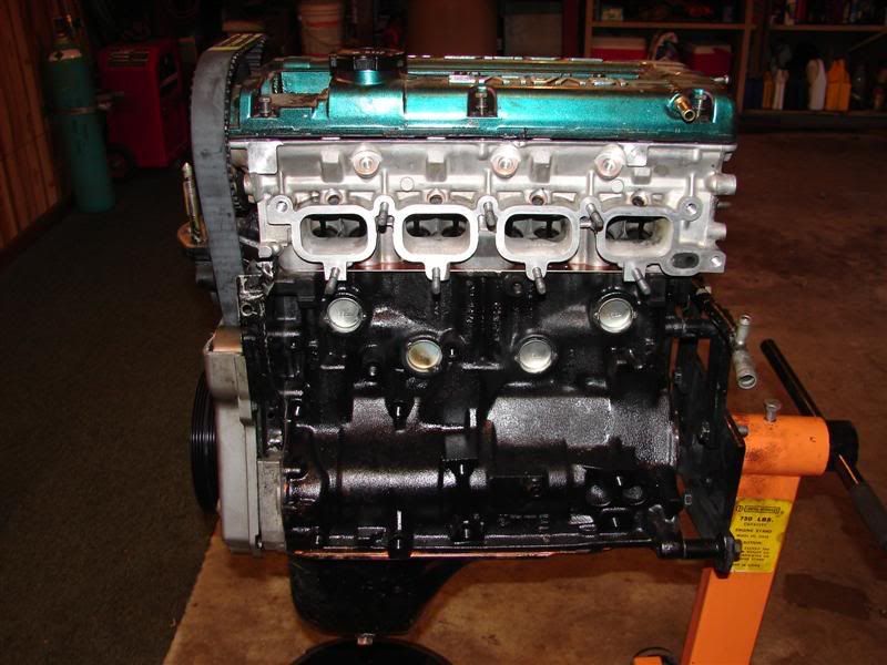

Engine.
http://i85.photobucket.com/albums/k5...d/DSC02115.jpg
http://i85.photobucket.com/albums/k5...d/DSC02122.jpg
http://i85.photobucket.com/albums/k5...d/DSC02124.jpg
http://i85.photobucket.com/albums/k5...d/DSC02126.jpg

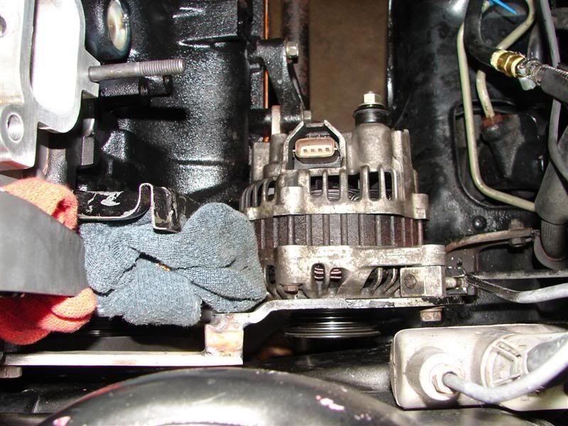

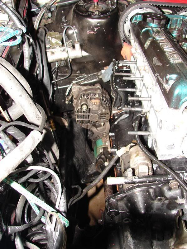

Alternator relocation bracket.
http://i85.photobucket.com/albums/k5...d/DSC02158.jpg
Alternator tensioner.
http://i85.photobucket.com/albums/k5...d/DSC02162.jpg
Relocated alternator.
http://i85.photobucket.com/albums/k5...d/DSC02163.jpg
Wiring the relocated alternator.
http://i85.photobucket.com/albums/k5...d/DSC02166.jpg

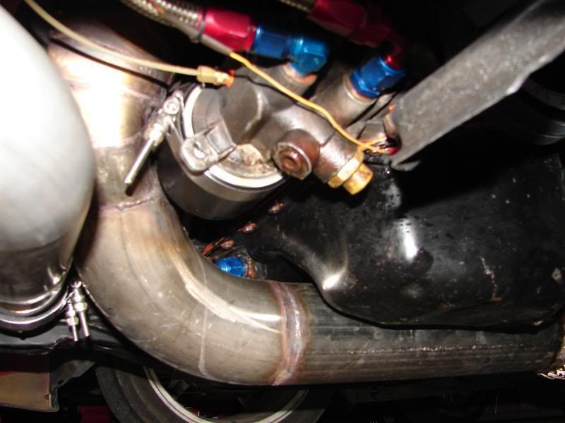

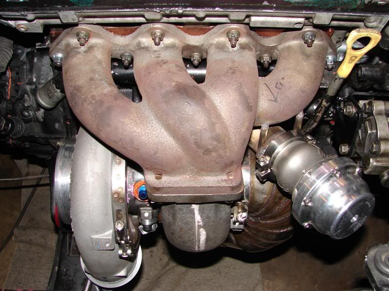

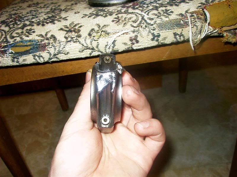

Fitting the wastegate.
http://i85.photobucket.com/albums/k5...d/DSC02170.jpg

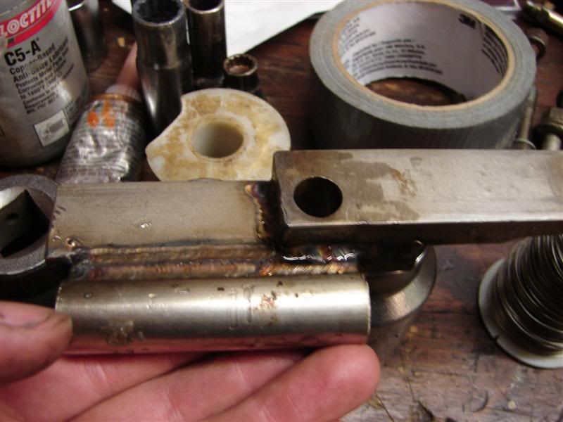

The first bend, this was very time consuming and tested my patience to the limit.
http://i85.photobucket.com/albums/k5...d/DSC02171.jpg
Exhaust back the car.
http://i85.photobucket.com/albums/k5...d/DSC02172.jpg
http://i85.photobucket.com/albums/k5...d/DSC02191.jpg
http://i85.photobucket.com/albums/k5...d/DSC02192.jpg
http://i85.photobucket.com/albums/k5...d/DSC02190.jpg

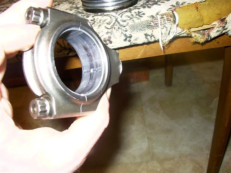

Forgot the rods, man did it pain me to take them to a belt sander when I balanced them, but they had to be perfect.
http://i85.photobucket.com/albums/k5...d/DSC02089.jpg
The pistons. My blueprint book is in the background.
http://i85.photobucket.com/albums/k5...d/DSC02091.jpg

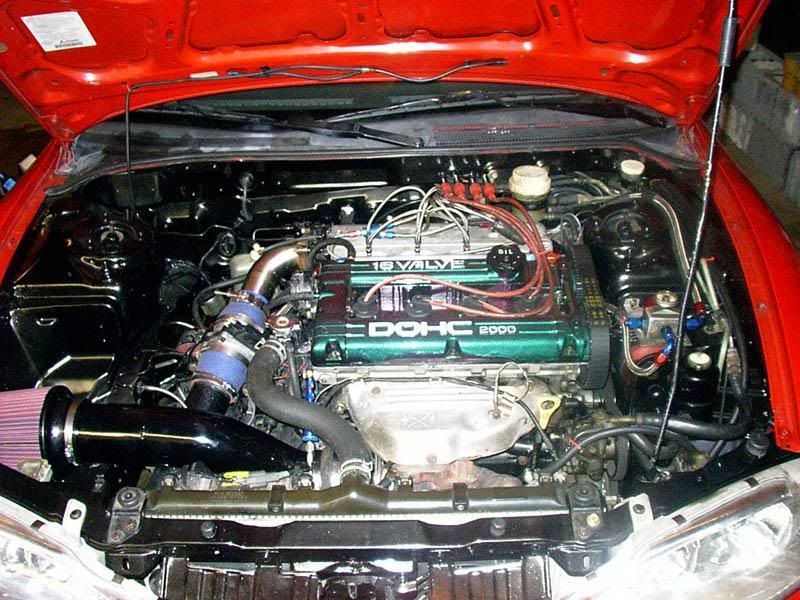

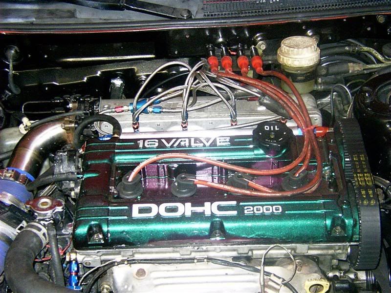

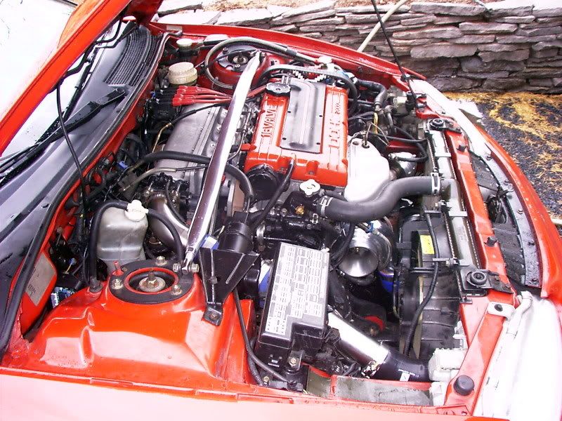

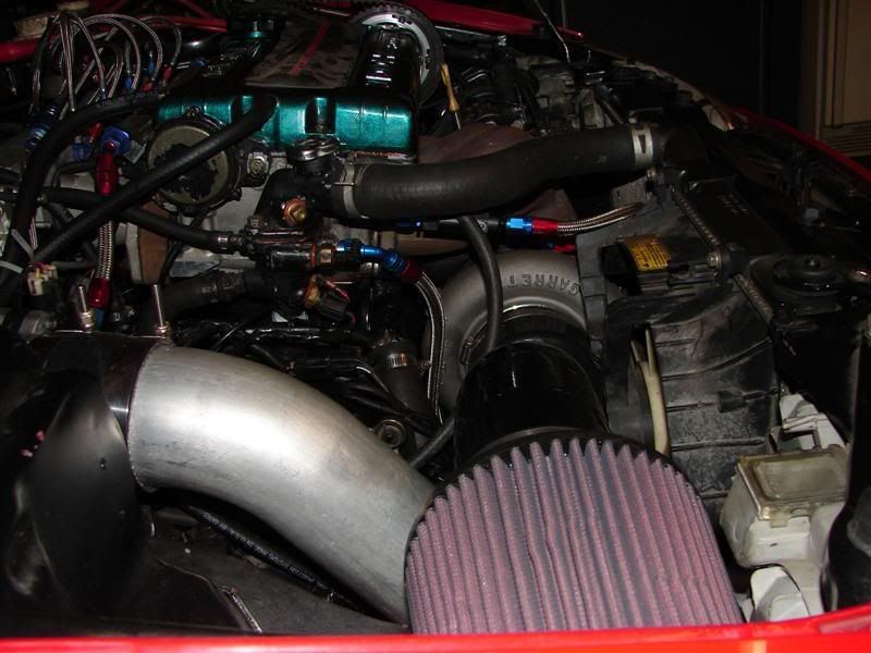

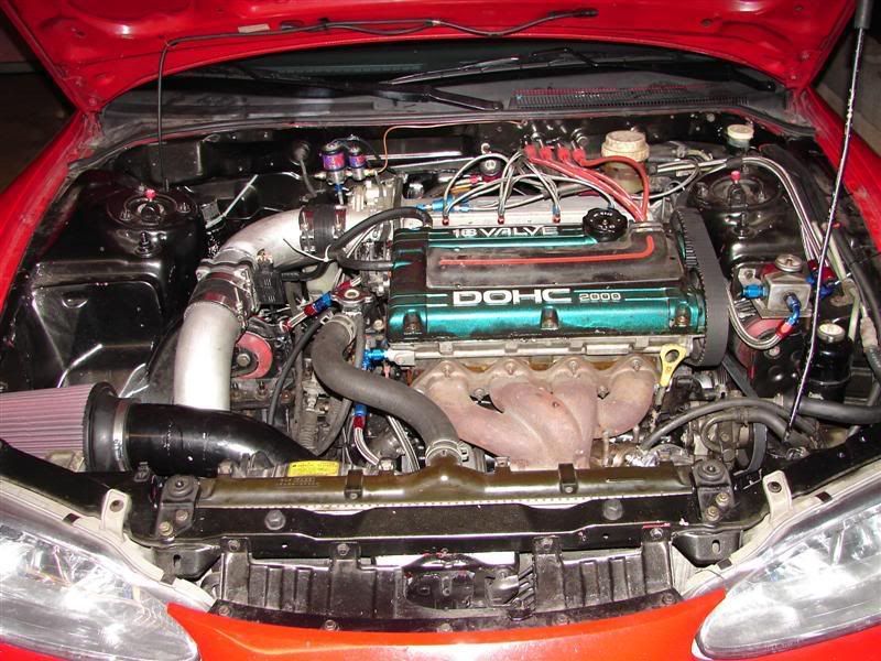

Here is what the car looks like right now, in it's driveable form.
Safetywired oil filter.
http://i85.photobucket.com/albums/k5...R/DSC02211.jpg

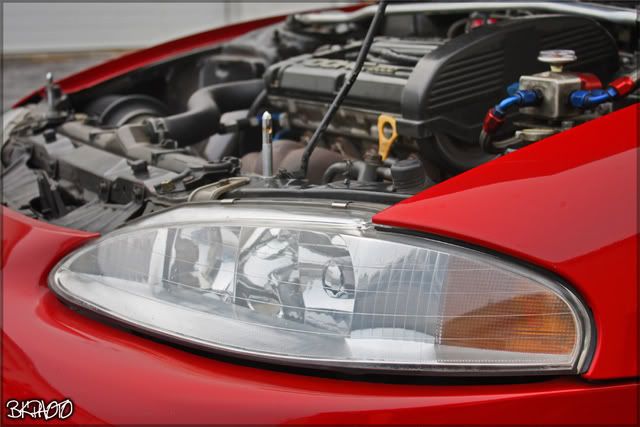

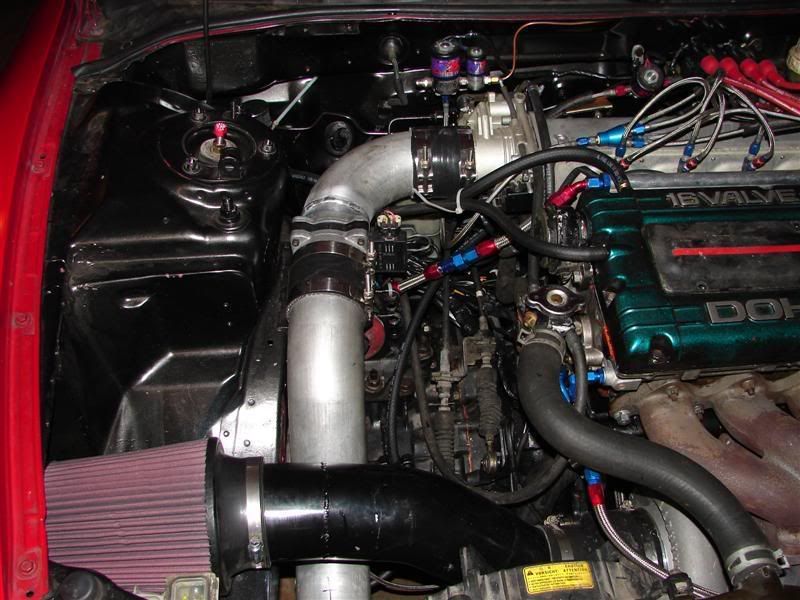

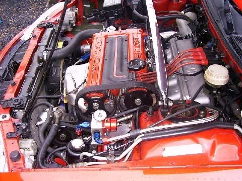

Engine compartment.
http://i85.photobucket.com/albums/k5...R/DSC02184.jpg
http://i85.photobucket.com/albums/k5...R/DSC02179.jpg

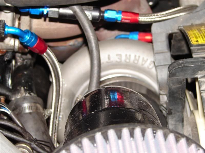

Turbo.
http://i85.photobucket.com/albums/k5...R/DSC02180.jpg
http://i85.photobucket.com/albums/k5...R/DSC02181.jpg
http://i85.photobucket.com/albums/k5...R/DSC02183.jpg

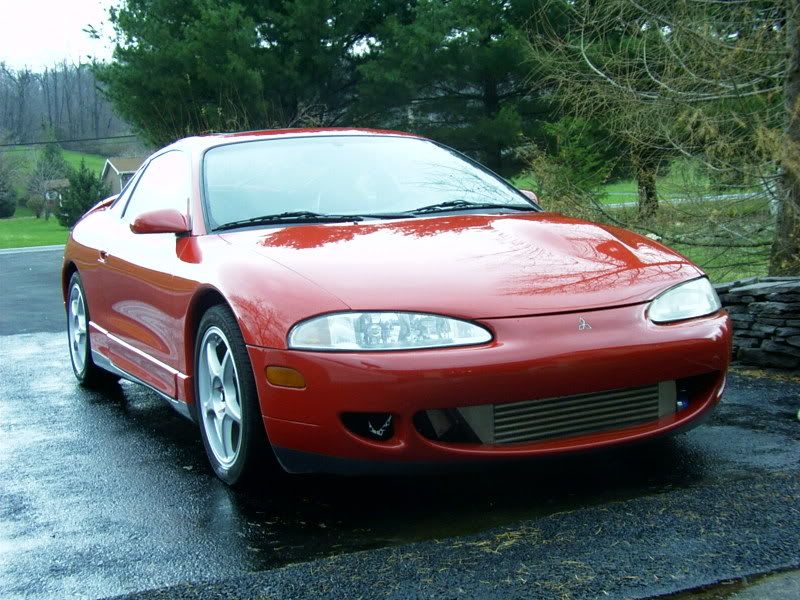

Exterior.
http://i85.photobucket.com/albums/k5...R/DSC02735.jpg
My sticker.
http://i85.photobucket.com/albums/k5...R/DSC02739.jpg

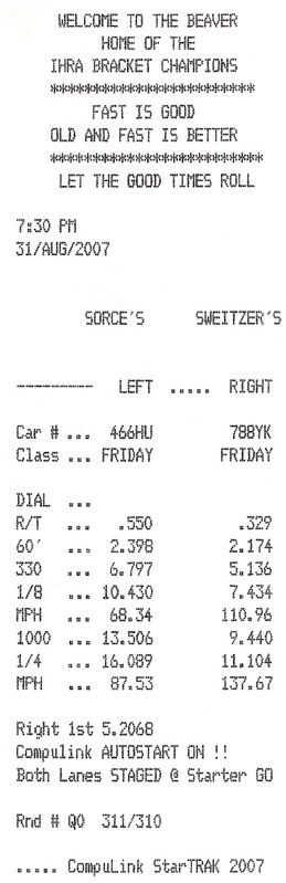

*Notice, this was written for another website in which there was some talking of trash going on.*
This journal is for all of those who think it comes as easy as handing your paycheck over to the nearest shop. It shows what it takes to do it by yourself, trial and error, and figureing out the unexpected along the way. To those who complain about the rumors about their cars, yet do nothing to quench them, is it really a secret?. To those that have never turned a wrench yet feel they are qualified to make assumptions about someone who can, and does run a number. And espeically to those who can make statements about what their car will do, when it's not in one piece. Tooch, I'm not singleing you out either, so take it easy, there will be many more coming to this website just to read this journal.
Don't take this as me insulting you. Take it as a challenge to do what you say. Get it to the track and whip my ass, I'll be the first to congradulate you. Then I'm going to go and do what I need to do to beat you the next time.
If you're learning, learn. There are people that may know more than you, and are trying to help, they may come off as abrasive at times, but sometimes you have to suck it up and drive on. You'd be amazed what you can learn by hanging around with some of these jerks that spin iron and spit wooden nickels.
I'll even post embarassing times and dyno numbers for my setup.
Don't forget, street tires and E85 for fuel.

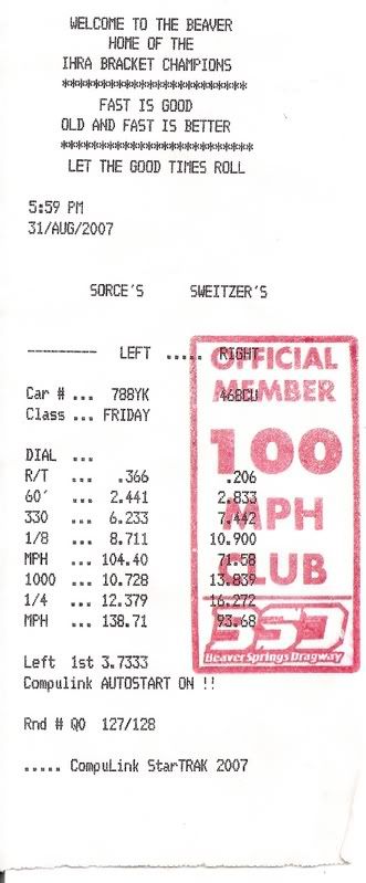

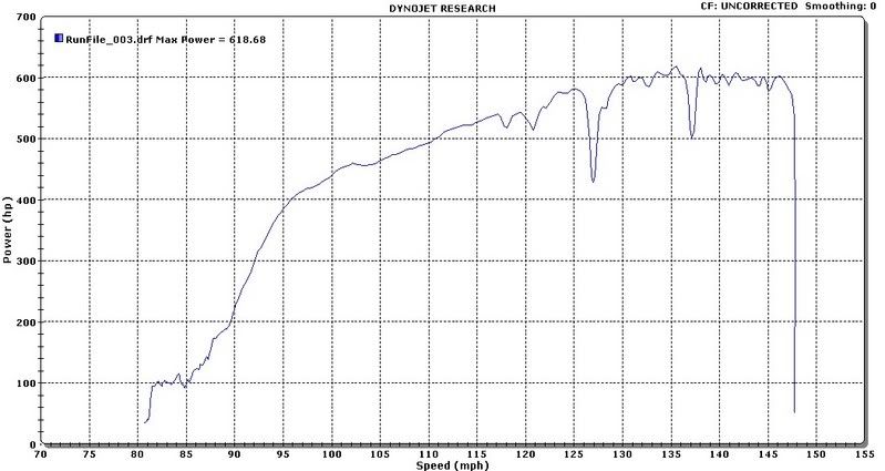

27psi and a air metering problem. The only time the car has ever been on the dyno, I was hoping for 500 at the wheels. When I got to the track, I was hoping for 135MPH trap speeds. Not one of you ever heard me make a claim of what my car will do, before it was done.
Track times were run at 32psi, with the metering problem fixed.
http://i85.photobucket.com/albums/k5...eslips/JRM.jpg
First pass with the new setup, ever. I'm 788YK
http://i85.photobucket.com/albums/k5...ps/BSD12.3.jpg
Second pass.
http://i85.photobucket.com/albums/k5...ps/BSD11.1.jpg
Third pass.
http://i85.photobucket.com/albums/k5...ps/BSD10.7.jpg
2 days and 3 passes later. I'm 79 here.
http://i85.photobucket.com/albums/k5...ips/SM6.85.jpg
I'm progressing along quite nicely, and the car still has a lot more power than most of you realize still to be found.

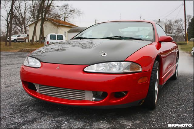

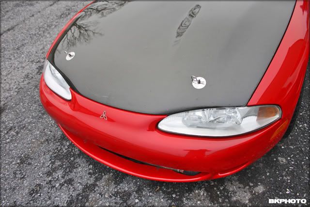

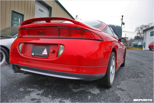

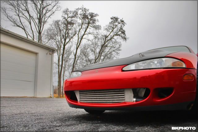

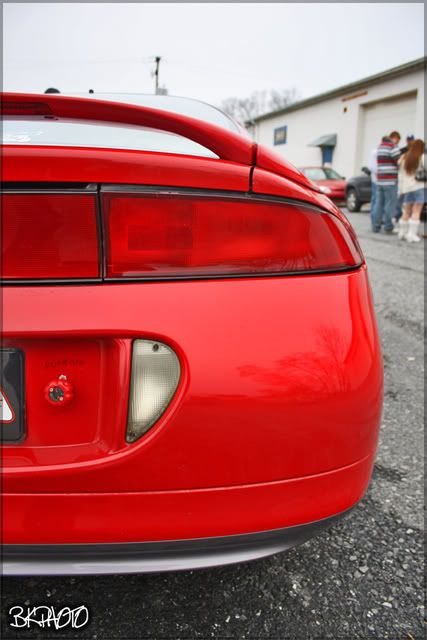

Some current pictures from when I was home for Christmas.
http://i85.photobucket.com/albums/k5...X/DSC_3998.jpg
http://i65.photobucket.com/albums/h2...x/IMG_6604.jpg
http://i65.photobucket.com/albums/h2...x/IMG_6609.jpg
http://i65.photobucket.com/albums/h2...x/IMG_6611.jpg
http://i65.photobucket.com/albums/h2...x/IMG_6612.jpg
http://i65.photobucket.com/albums/h2...x/IMG_6613.jpg
http://i65.photobucket.com/albums/h2...x/IMG_6619.jpg
http://i65.photobucket.com/albums/h2...x/IMG_6623.jpg
http://i65.photobucket.com/albums/h2...x/IMG_6624.jpg
http://i65.photobucket.com/albums/h2...x/IMG_6620.jpg
BlinkerFluid 01-13-2009 11:18 PM
I hope you guys enjoy, I know I have had a blast mostly every minute I've played with this car.
Questions and comments welcome!

assault187 01-13-2009 11:22 PM
Nice progress.
After removing the ABS stuff, did you have the ABS light on the dash? or did that leave with the ABS module?
I may have missed it but what kinda shot were you running when it popped?
BlinkerFluid 01-13-2009 11:36 PM
Thanks, no, no ABS light, it all went away.
100 shot on top of 30psi. when she came apart.
