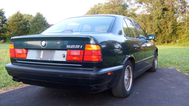

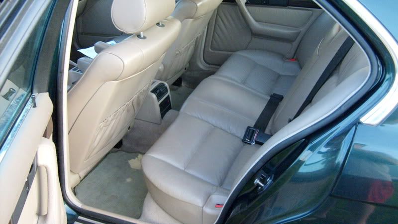

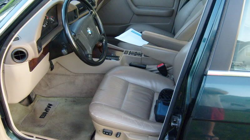

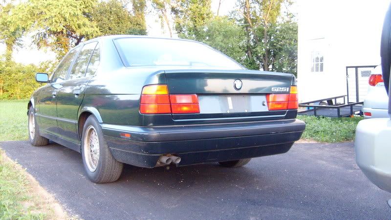

So I picked up this 95' 525i today. Car needs front suspension work, which is very common on all e34's. The plan is to clean the car up inside and out, the exterior needs a good wax job. Further more, I am going to be replacing the tires, and anything in the front suspension that is worn out. However, first thing to address is the valve cover leak.:o
http://i37.photobucket.com/albums/e5...i/S6301493.jpg
http://i37.photobucket.com/albums/e5...i/S6301492.jpg
http://i37.photobucket.com/albums/e5...i/S6301491.jpg
http://i37.photobucket.com/albums/e5...i/S6301490.jpg
http://i37.photobucket.com/albums/e5...i/S6301496.jpg
http://i37.photobucket.com/albums/e5...i/S6301497.jpg
http://i37.photobucket.com/albums/e5...i/S6301502.jpg
Edit: I found out this car is a 94', someone wrote the year wrong. Oh well they weren't much different between the years.

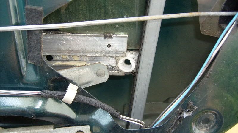

For some reason the drivers window was unplugged. I took apart the control switch and it had dirt in it so my guess is that it had a poor connection. I plugged it back in and it works. Further more, I took the panel off the passenger rear door to see why the window doesn't roll down. I found out the window regulator has came off the sliding clip. A new clip is on its way. Funny thing is that instead of buying a $2 clip, the previous owner tried to hack the window somehow to keep it up. Obviously they failed but did leave their mark.

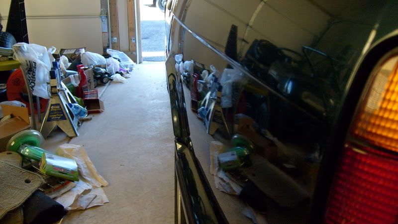

Today I decided to clean up the paint. It was very rough, so I used a clay bar and a few other products. Heres a pic for now, this is still without polish and wax.
http://i37.photobucket.com/albums/e5...i/S6301559.jpg
Just to give you guys an idea of how dirty the paint was, here is a pic I snapped after I finished the front fender.
http://i37.photobucket.com/albums/e5...i/S6301556.jpg

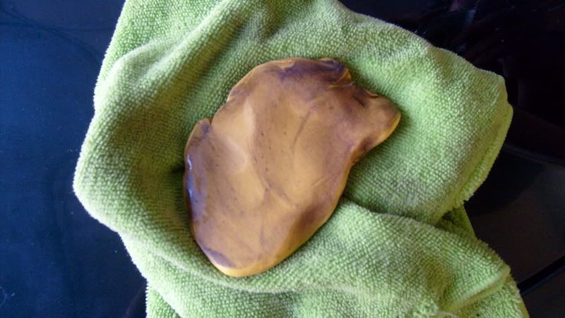

Also, the products I am using. The pic doesn't have Mothers Clay Bar kit.
http://i37.photobucket.com/albums/e5...i/S6301557.jpg
