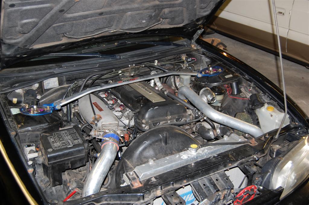

Under the Hood:
s13 sr20det B-Top
S13 SR FAN Shroud (2 years to find)
PE 850cc injectors
GT2871R .86 turbo
Brian Crower 264 IN and EX cams
Brian Crower Springs
Brian Crower Titanium Retainers
Apexi 1.8mm HG (comp is down to 8.05:1)
ARP head studs
HKS filter
HKS SSQ BOV
MR turbo mani
MR turbo elbow
MR 3" DP
MR 3" Test Pipe
Greddy EVOTT cat-back
Hybrid Development GT Spec FMIC
KoYo Al. Rad.
Mazda Miata Bat. in rear.
Greaddy Oil pan
Greddy Rocker Arm Stoppers
Greddy Oil Cooler/relo kit (still in the box :( )
Greddy Intake Manifold
Hondata intake gasket
Walbro 255 FP
NISMO engine and trans mounts

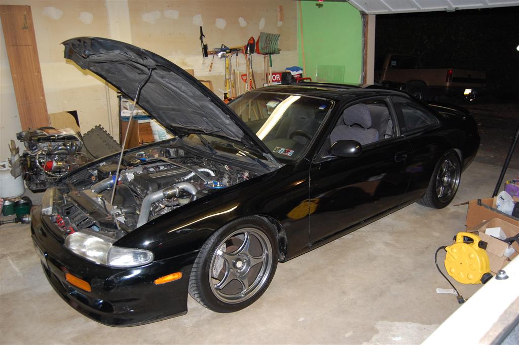

auk113 09-07-2007 06:47 PM
let the fun begin, i'm starting my swap on Sunday hopefully everything will go well, i'll post as many pics as i can

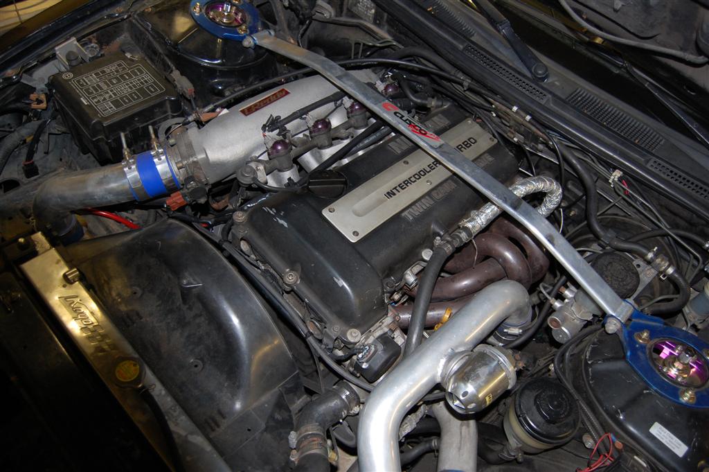

so i got it running but my FP drops like crazy and i get 30 knock at 1000 RPM, all the turbo lines need to be tightened up, and exhaust need to go back on it
auk113 09-18-2007 01:22 AM
Got it done :)
Bad o-ring on the 4th injector was causing the knock on the 4th cylinder. As soon as i replaced it, ran like a champ, 0 knock.
Tomorrow it of to R/T Tuning to finish everything off.

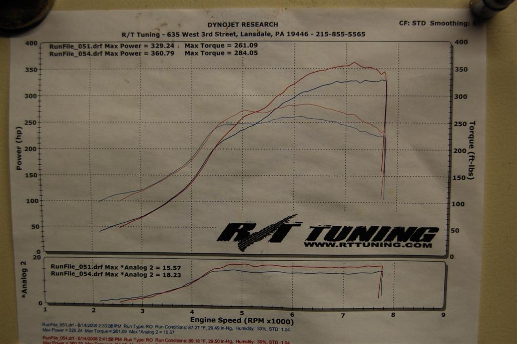

287hp and 252tq need larger injectors
