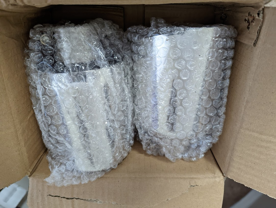

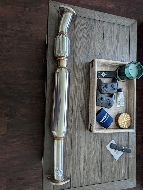

Picked up an XForce 2.5" resonated exhaust on Black Friday sale. Super happy with their exhaust on my RX-8, figured I'd try their 86 offering. Still waiting for my car to get here but whatever.

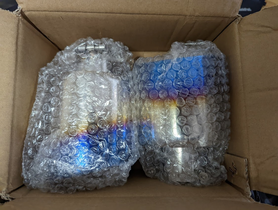

Came with two sets of tips, which is cool.
https://i.postimg.cc/MZCHzLwN/image.png

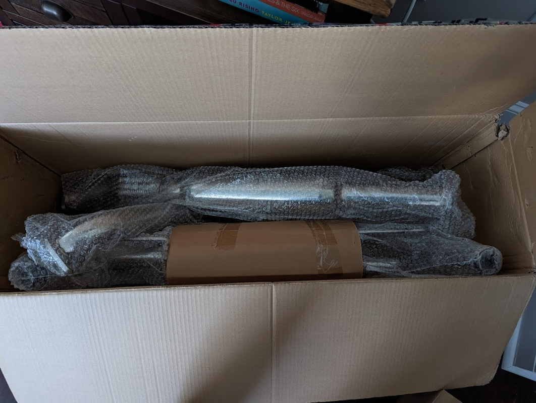

Packaging is, uh, "fine" at best. Half the cost of most 86 exhausts though...
https://i.postimg.cc/3wxJL5j4/image.png
Quality looks pretty good though! My RX-8 exhaust has held up well on track and daily driving so I suspect this will be good too. The RX-8 has a LOT higher exhaust temps than most cars and puts a beating on cheap crap.
https://i.postimg.cc/JhFmPy4v/image.png
2017 build date, guessing these don't sell quickly.
https://i.postimg.cc/xCVpfYsq/image.png

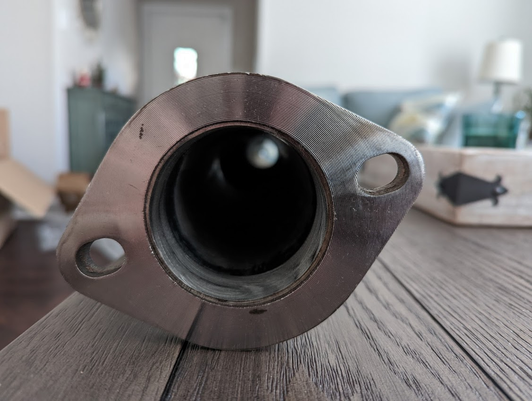

They mill the flanges flat after welding, a nice touch.
https://i.postimg.cc/5yRwtSxp/image.png
I just hope it fits as well as the RX-8 exhaust did! I did order some 1/2" split shaft collars like what Perrin uses so I can center the exhaust nicely in the openings. Otherwise, should be good to go whenever I get my car. I'll post videos and such.

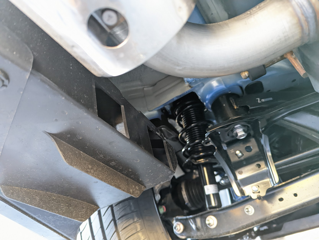

DocWalt 12-19-2021 05:35 PM
Boo, turns out the xforce exhaust doesn't fit :(

DocWalt 12-20-2021 04:22 PM

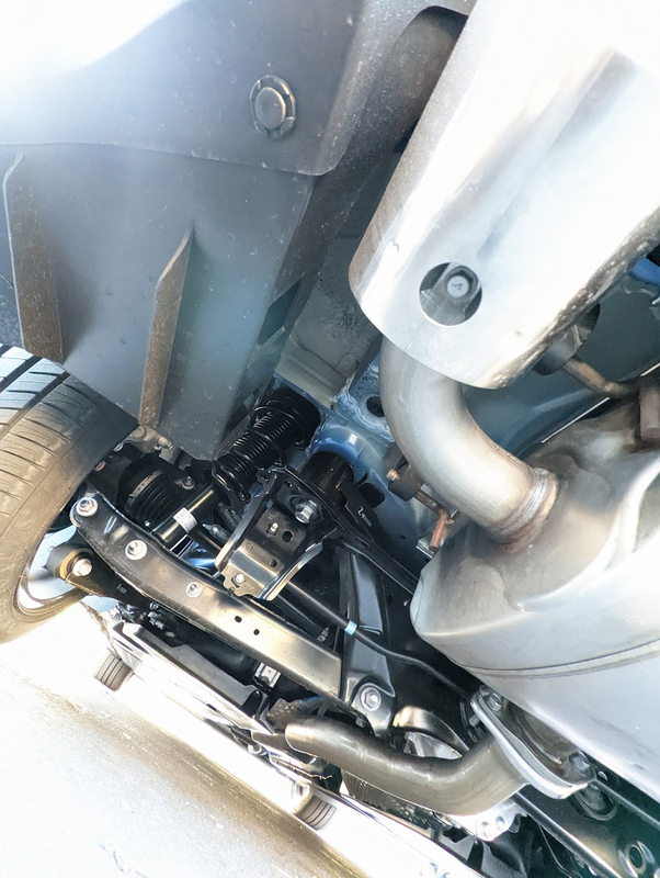

So the contact was the plastic piece with the two square holes in it. You can see how an exhaust with the flange off to the side could contact it, especially if the flange sits wider than the outlet pipe.
https://i.postimg.cc/xT5401cw/image.png
https://i.postimg.cc/QxhzGTxg/image.png
I've gone ahead and ordered a Perrin 2.5" resonated exhaust, it will take a while to get here sadly as they're not in stock.

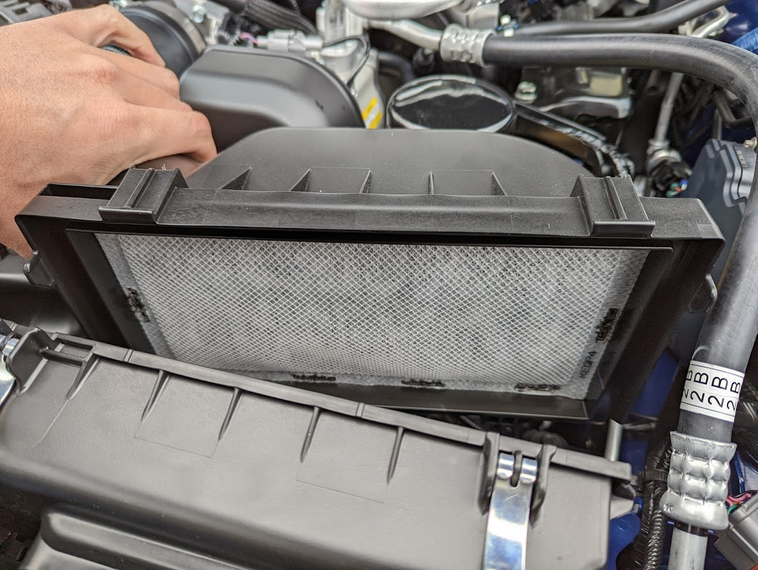

Measured and confirmed the 2017+ air filters will work, not that the drop ins really offer a power advantage anyway. There's a neat post air filter filter.
https://i.postimg.cc/KYXntWDT/image.png
