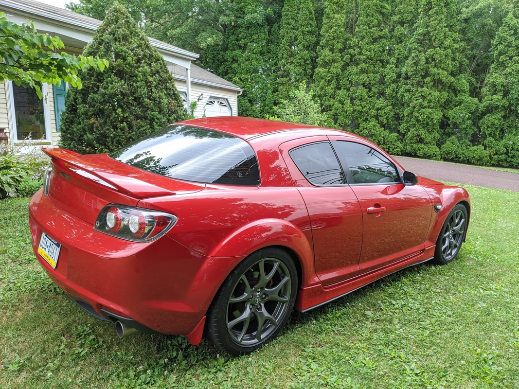

I bought an '09 RX-8 R3 back in the beginning of July. It had lots of weird issues... and apparently a blown engine. Spun bearings, so I can't even make funny apex seal jokes.
It had a pretty long list of mods, so not a total waste.
While I was replacing the engine with a friend, I did Hotchkis swaybars and fixed a LOT of other nonsense. Replaced the stupid spherical bearing Megan Racing lower control arms in the rear.

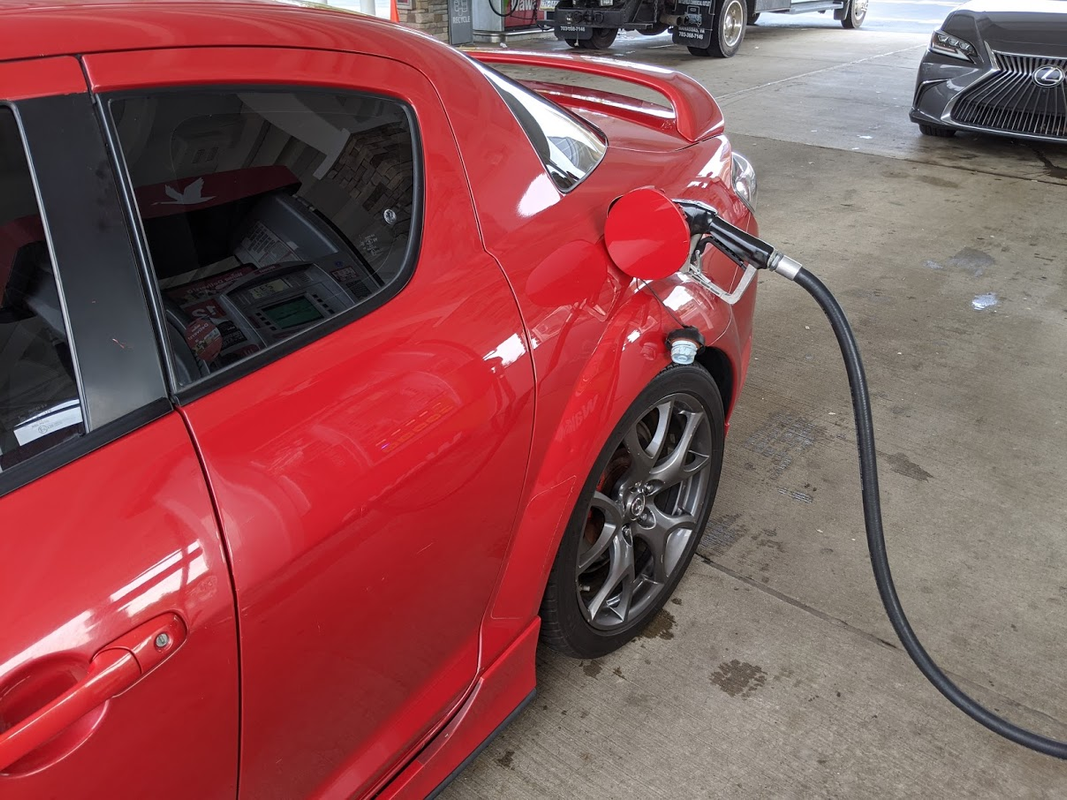

Typical rotary, visiting gas stations often :lol:

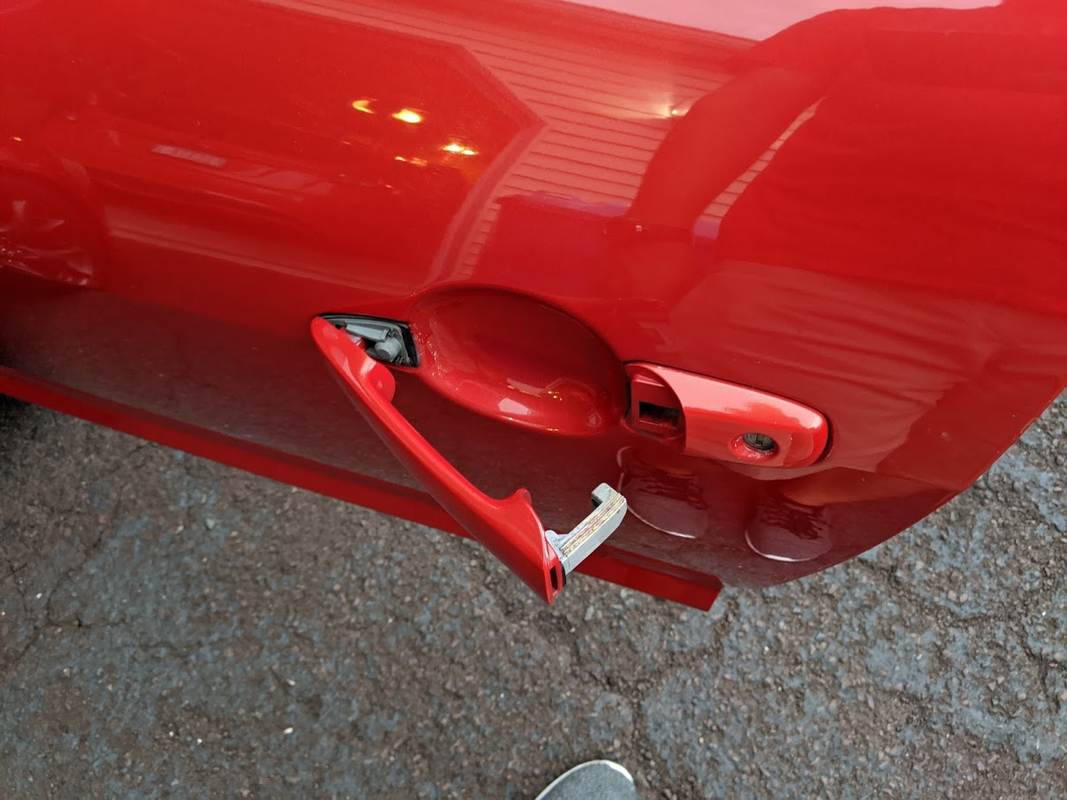

About a week after purchase the damn door handle broke. The fix involved trapping myself inside the car among other stupid things.
https://i.postimg.cc/SsSG6pP1/image.png

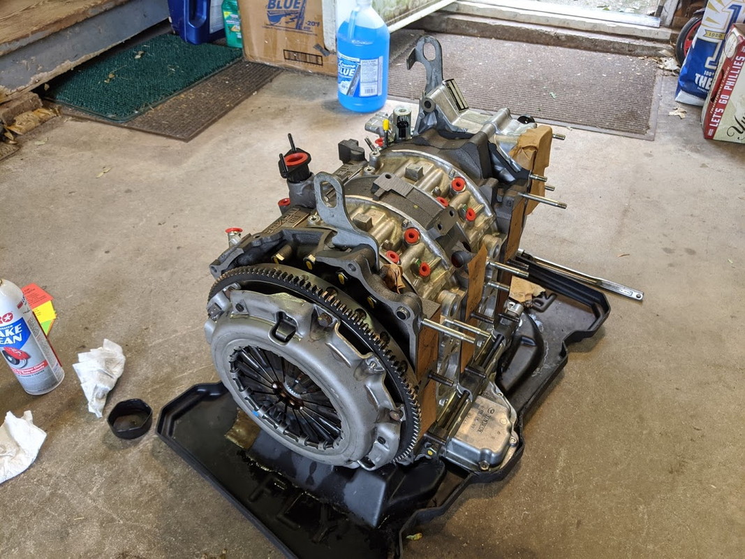

Pulling the engine a week and a half later

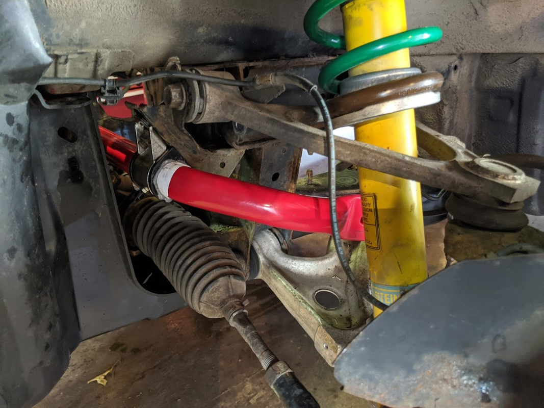

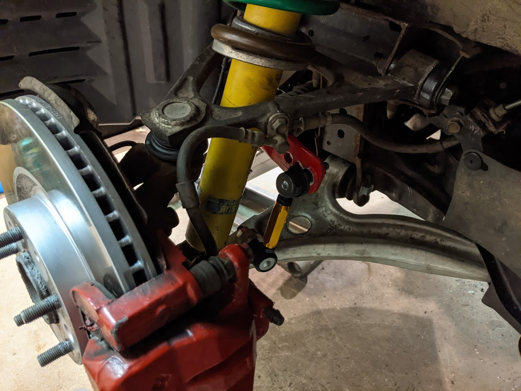

Hotchkis swaybar:
https://i.postimg.cc/htCmk7Zs/image.png

More swaybar goodness:
https://i.postimg.cc/hPc7h0HM/image.png

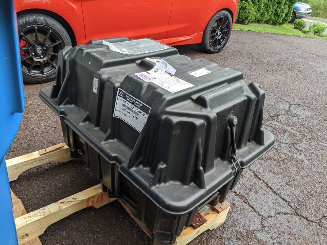

Reman Mazda engine arrived!
https://i.postimg.cc/Dz9ShQrr/image.png
https://i.postimg.cc/L87Xkk0c/image.png

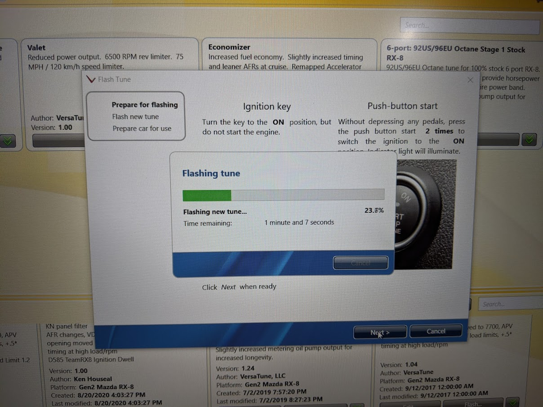

I've had a tune on the car, but it was set with stock dwell times even though I have upgraded LS2/D585 coils on the car. I tweaked the dwell table to "known good" values and holy crap the car is way smoother, faster, and more responsive. I'm still only part way through the break-in process so I'm only able to rev to ~7k RPM and it feels great.

Tweaked the tune to better match the ignition coil dwell times to what the upgraded coils on my car want and it's *so* much smoother, more responsive, and feels more powerful too. Huge difference in performance from such a simple thing.

I didn't say anything about it, haha. VersaTuner! It's odd, it's like playskool tuning in a way coming from MazdaEdit on the ND and MegaSquirt on the GTI.
*super* sensitive, so knock is definitely a "must avoid" thing. Not as bad as the turbo engines, but still horrible.

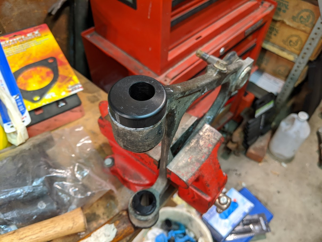

Got the car inspected and an alignment was attempted... Unfortunately 6 of 8 adjusters were stuck so that turned into an adventure with the sawzall and new bushings and new arms where needed. Unfortunately I got the front control arms out fine but they exploded trying to press out the camber bushings... so Jeff volunteered up his spare control arms. I did Mazdaspeed offset bushings in the front upper control arms for more camber while it was apart.

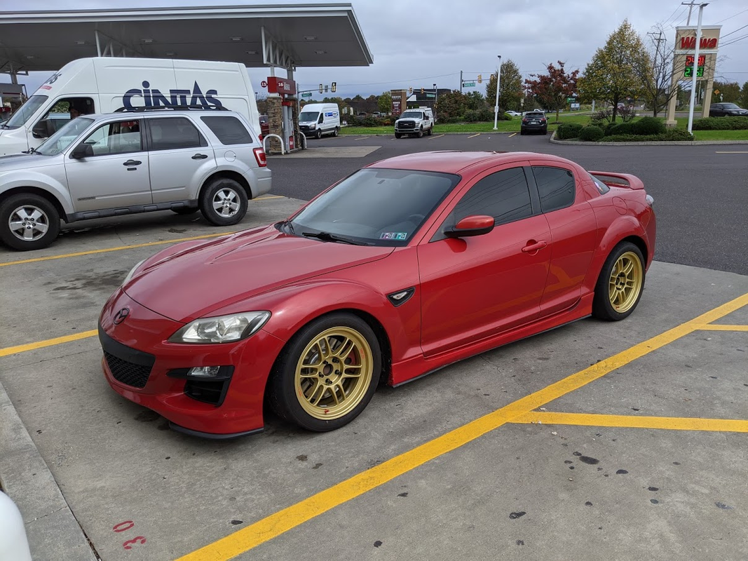

DocWalt 10-14-2020 12:01 AM
https://i.postimg.cc/ncw5bPxq/image.png
New wheels are on, used takeoff tires from my Miata.
Coilovers ordered...
