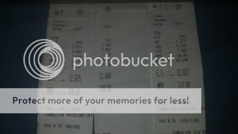

Very first pass against my buddies fox body I run an 11.67 @ 120. I knew the run felt good but didn't know it was that good. When I got my timeslip I was literally screaming at the top of my lungs. My buddy was right behind me and said the guy giving out the slips was like, "Do you hear that guy?" lol. I've been waiting almost 2 full years to best my 12.3 pass but could never do it until last night where I raped it.
Second pass I shifted into 2nd way to early and bogged to a 12.0 @ 117. Of course this was the only pass I have video of.
http://www.youtube.com/watch?v=4-pcj...1&feature=plcp
And on my 3rd and final pass I ran a 11.68 @ 118. Here is a pic of all 3 of my time slips.
http://i399.photobucket.com/albums/p...-34-44_147.jpg
This was only on 25 psi with 93 pump gas UNtuned. I want to get it retuned asap on 30-33 psi. My Holset is screaming at my for a rebuild so I will probably do that before anything right now. I'm also running out of injector with these PTE 1000's. I think I should get them flow tested because I shouldn't be maxing them out yet. I did buy them used. But all that aside I don't think I've EVER been happier. Nights like those is what makes all of the bull**** well worth it. Sorry for my novel, hope you enjoyed!

I think 2 things, one, if your injectors are almost maxed out now, might as well get new ones and save the time, i dont think you'll be able to boost 30+ on your current ones.
secondly, it looks like your leaving ALOT on the table. your 2nd run you hit 100mph in the 1/8.. Thats good for 125+ in the 1/4 and thats 10's territory with traction

Great job man. You still got a crappy 60ft means you can get a better run once you improve it.
Haha yea man thanks I couldn't have written it any better. At the end of the night I had no voice left becuase I was screaming "YESSS!!!" at the top of my lungs lol. And yes there is a lot left on the table. Like I said the injectors, turbo, and low boost are holding me back. But I am addressing them all ASAP. There is an event mid October that I'm shooting for and hopefully I get under 11.3. Or right around there I would be happy. And I saw that 100mph in the 1/8 mile and I was like "holy ****" haha.
Thanks man! And yea I know I didn't mind the 1.65. But I'd like to constantly be down in the low 1.6's, high 1.5's. Might have to actually set up the anti-lag and get some better street tires and let some air out. Almost every one of those launches I felt the tires break loose a bit. Especially on that 1.65 60'.
TalonTsi97 09-03-2012 11:35 AM
Good job! I wouldn't call those bad 60' especially considering the cars setup. You still planing on having K.P. Tuning dial in the car? Looks like it has some potential.

Thanks! Yea I didn't think they were bad just not as good as they could be. And yes I was gonna have him retune it this coming weekend but chances are I won't have my turbo back by then. He tuned it before but I unknowingly had a rocker that was in the wrong place, aka intake valve not opening. Since then I got that fixed, rewired the fuel pump and bumped up the pressure so the tune is all out of wack. Still ran the times I did though like that.
