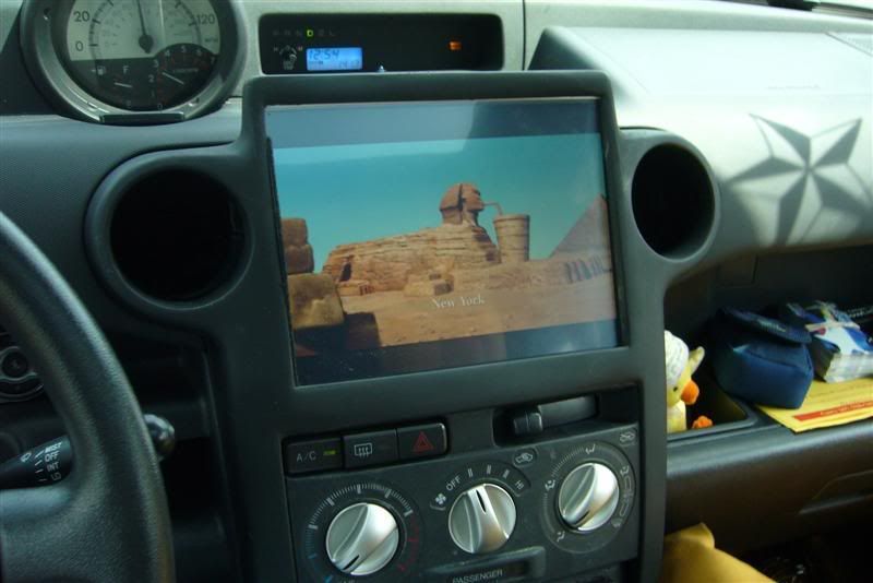

you could always use that double din screen kit, and remote mount your head unit, like in your glove box or something. When I molded my 10" touch screen in the dash of my 05 xB, I moved the radio down lower in the dash and just extended the wires. I ran the audio output of my car pc through the aux input on the radio.
http://i33.photobucket.com/albums/d5...0904Medium.jpg
BlackBulletTSi 07-09-2012 01:30 PM
Nice that looks really clean. I was thinking of installing the screen in the dash and molding it in there as well. Just I'm not sure how much work would be involved in moving my radio and if its worth it at that point. I was hoping a quick switch out of my current headunit with one that would allow me to just plug in a computer would make this a quick and simple job. This is just turning it into a larger job then I wanted haha. I do want to do it right though so if thats a route I have to go then I will.
