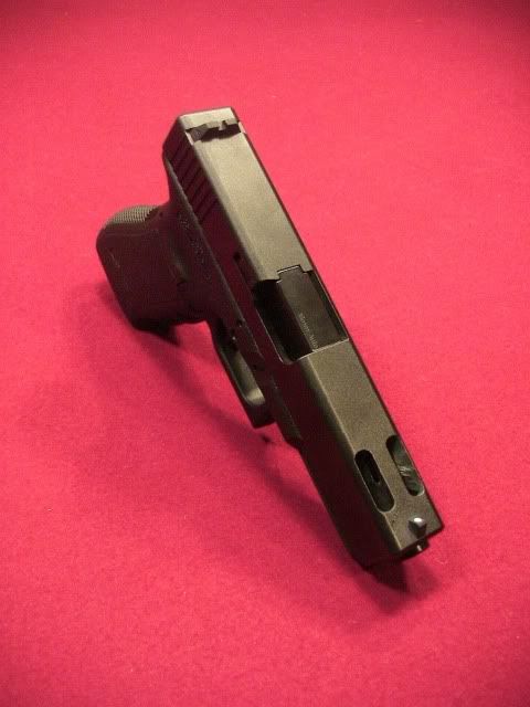

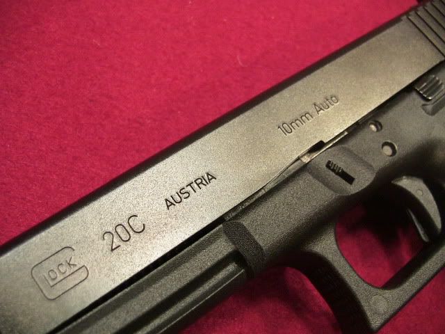

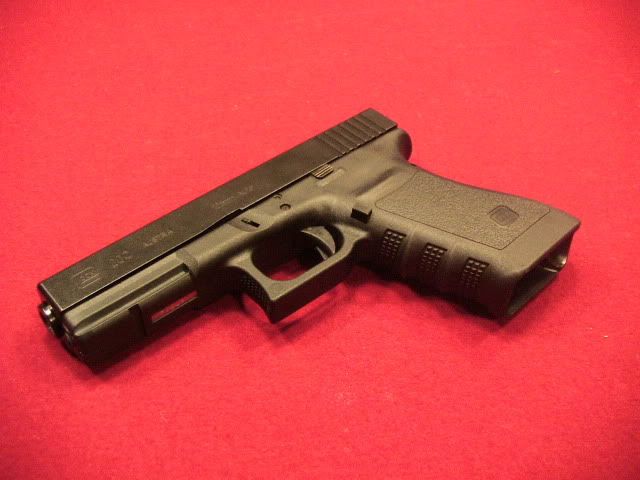

Thanks to angdefeo another Glock ive wanted for a while now calls my safe home
http://img.photobucket.com/albums/v2...k/IMG_1470.jpg
http://img.photobucket.com/albums/v2...k/IMG_1468.jpg
http://img.photobucket.com/albums/v2...k/IMG_1469.jpg

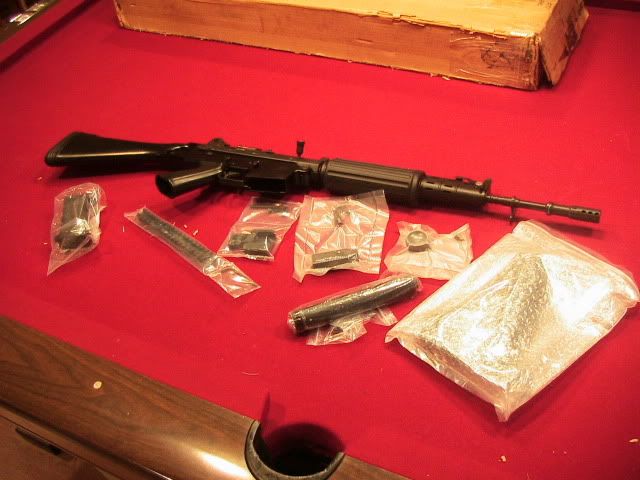

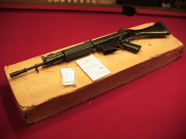

Brand new in the box FN FNC converted by Mr. Higgins only 10% of the rifles imported have a fixed stock.
Unfired with original box
http://img.photobucket.com/albums/v2...k/IMG_1478.jpg
http://img.photobucket.com/albums/v2...k/IMG_1479.jpg
http://img.photobucket.com/albums/v2...k/IMG_1481.jpg
http://img.photobucket.com/albums/v2...k/IMG_1482.jpg

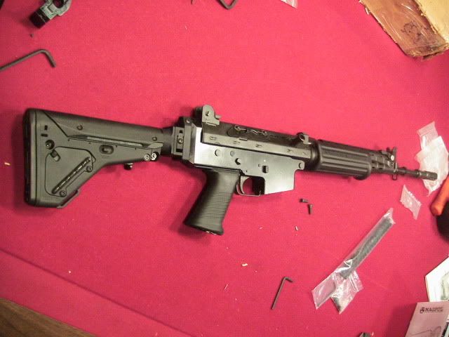

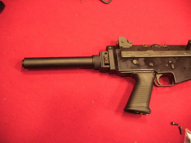

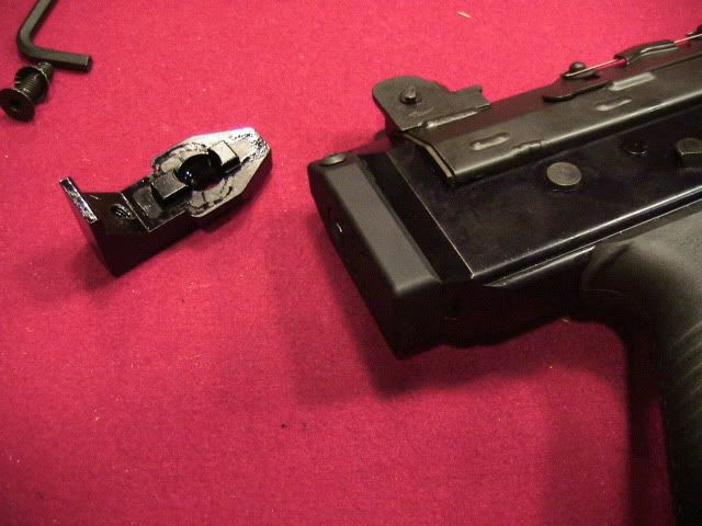

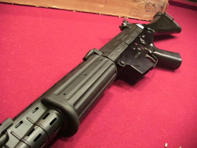

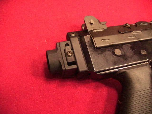

Since I can never leave well enough alone and stock hurts my body certain additions must be made, the FNC is a very nice rifle for some in stock form but to my liking it needed to be updated
http://img.photobucket.com/albums/v2...k/IMG_1480.jpg

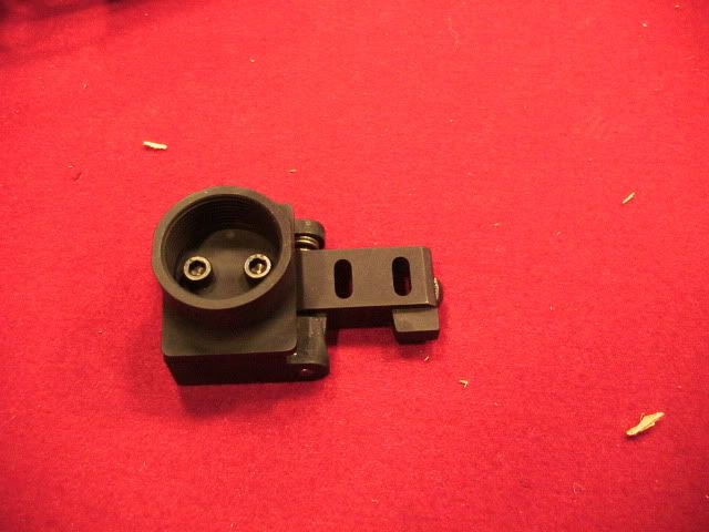

Made a visit to Stormwerkz and picked up Joshs sight rail, stock adapter and universal folder, also picked up a M249 SAW grip from DSArms and got a Magpul UBR stock to sit on the back. Still waiting for my railed foregrip to ship.

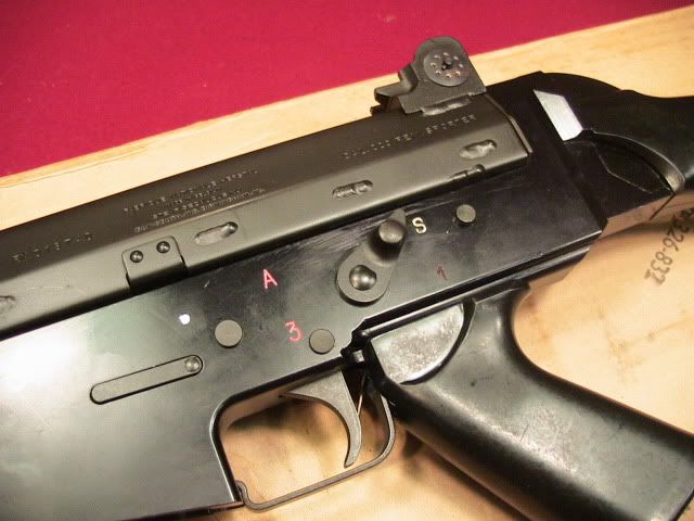

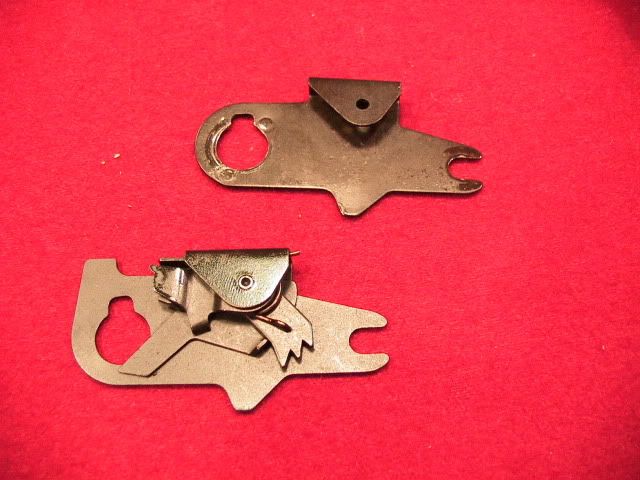

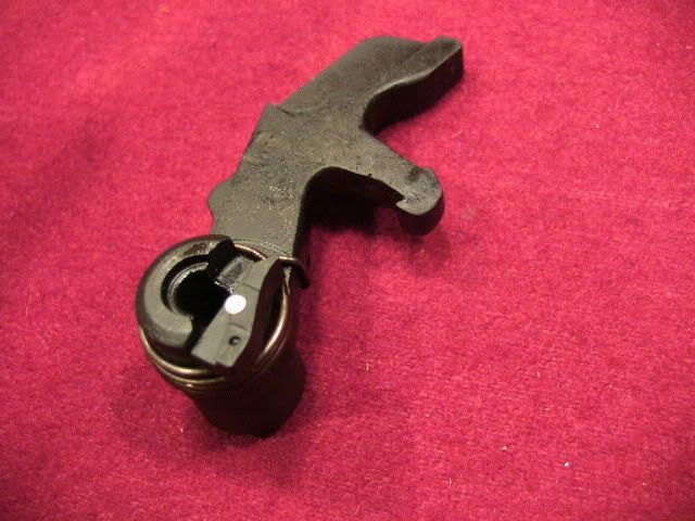

Also got a 3 round burst pack, having a "3" position on my selector and not having it functional is just not cool so that too must be remedied
If you have a FNC and want to do this addition fear not its extremely straight forward and took me about 5 minutes to install with function check

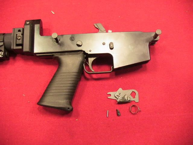

Kit comes with these 4 pieces, the burst assembly, hammer spring, burst pawl and pawl pin
http://img.photobucket.com/albums/v2...k/IMG_1493.jpg

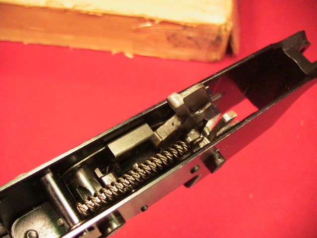

Lower comes off just like an AR
http://img.photobucket.com/albums/v2...k/IMG_1494.jpg
Hammer goes to 12 o'clock and out from right to left
http://img.photobucket.com/albums/v2...k/IMG_1495.jpg

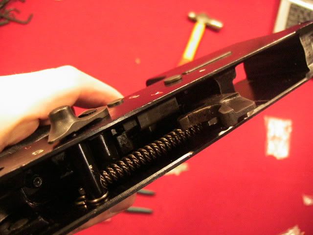

On non burst pack installed rifles there is a metal piece to keep internal dimensions where the pack would be, just slide it up and out
http://img.photobucket.com/albums/v2...k/IMG_1496.jpg

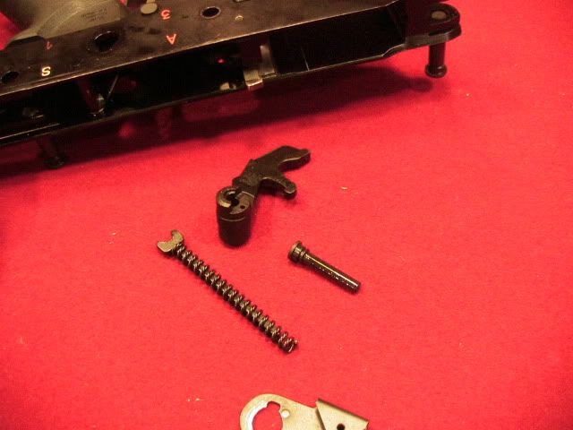

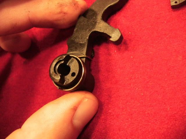

Hammer spring comes out and hammer pin comes out right to left then the hammer just lifts out
http://img.photobucket.com/albums/v2...k/IMG_1497.jpg
Hammer spring goes on
http://img.photobucket.com/albums/v2...k/IMG_1498.jpg

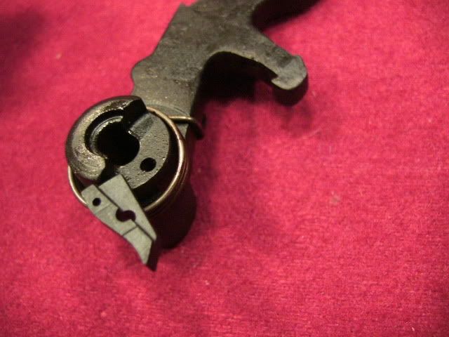

Burst pawl goes on, make sure the tip of the pawl is facing rearwards to it can contact the burst pack, if you do it backwards the pack wont fit in.
http://img.photobucket.com/albums/v2...k/IMG_1499.jpg
Pawl pin goes through the pawl into the hammer
http://img.photobucket.com/albums/v2...k/IMG_1500.jpg
Reverse the order, hammer goes in alone with spring
http://img.photobucket.com/albums/v2...k/IMG_1501.jpg
Burst pack drops in, selector goes through left to right
http://img.photobucket.com/albums/v2...k/IMG_1503.jpg
Making sure through all this taking apart and putting together a round didn't make its way into the chamber, do a function check. Set the selector to position 3, charge the weapon and pull and hold the trigger, cycle the bolt for "3 rounds" you will hear the sear catch on the 3rd round if you did everything correctly. If you rifle is back together smoothly to this point you have done everything right it WILL NOT fit back together it parts are in wrong.
Now its a battle rifle
